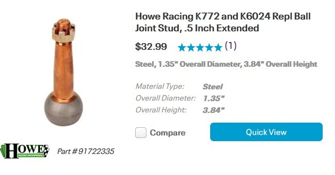

Instead of the stainless ball bearing you could adapt on a tie rod ball joint end like this and even make it replaceable. They come in different size balls and lengthsCraig Raynor wrote: ↑Mon Nov 16, 2020 7:57 amHello All my friend and I were going to attempt to replace the ball on a early front radius rod. We are thinking to cut the old one away on the milling machine drill hole in a inch and a quarter stainless ball barring. I can imagine some here must have tried this, and if not I still would like to hear what the thoughts are on this idea. Or is there a better way to skin this cat? Thanks Craig
https://www.speedwaymotors.com/shop/bal ... -470-18085
https://howeracing.com/collections/howe ... nts?page=1

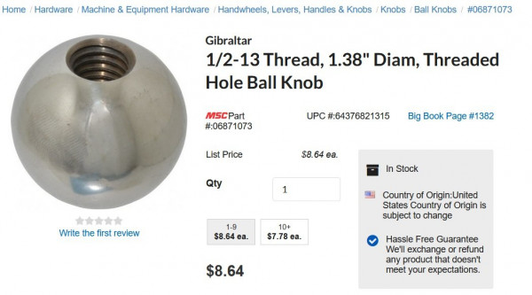

Allen, would a ball like this work? Don't know what size ball or material neededAllan wrote: ↑Tue Nov 17, 2020 12:11 amI use a different approach when saving early pitman arms. They are finer forgings than the repros available from the vendors. I do not cut the old ball off. Rather, it is ground and filed to make a 1/2" round stub which is then threaded. The stub is still larger than the neck at the back of the ball, so no strength is sacrificed/compromised. I use a new tie rod ball with parallel shank from the vendors as a donor for the ball. The shank is held in the lathe and the ball drilled and tapped for the same 1/2' thread. once the ball is threaded onto the arm, the shank can be cut off. i make sure it stays in place by adding a heavy tack weld through the cut end of the shank.
The same process could be used on any radius rod, but I do not know of a source of the larger donor ball required.
Hope this helps.
Allan from downn under.
Googled threaded ball end got some mixed results
https://www.mscdirect.com/browse/tnpla/ ... gL14fD_BwE
- Posts: 7145
Re: Front radius rod question
Frank, I think the ball needs to be 1.25" diameter. That style would work, but I would drill the hole clear through and thread it all the way. Then the ball can be welded at the outer end to make it captive. Nice to know such things are generally available.
