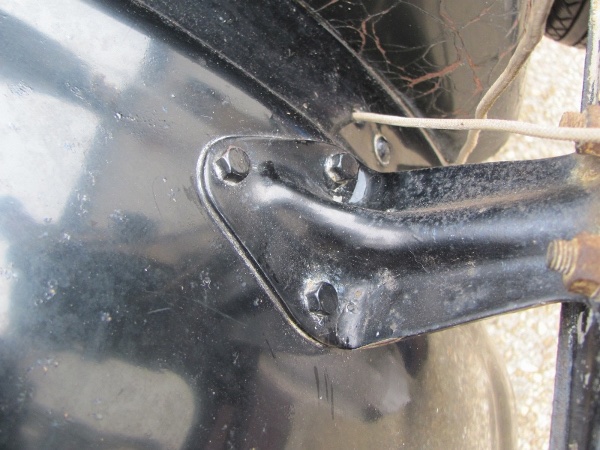

So I have to replace my taillight. Most of it was missing. I bought a new one from Lang's as well as the three bolts and support plate for the back. The question I have is: Where does the taillight wire come from to connect it? Should there be a hole in the fender or bracket? Does it just come out the back of the car and up the fender?

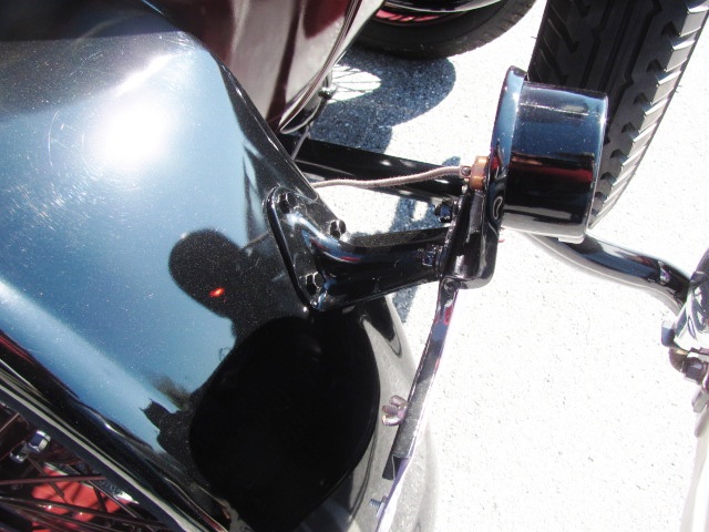

The touring rear fender won't have a hole for the tail light wire. So it wraps under the fender.
Have seen some '27 coupe and runabout fenders with a hole for the wire, as the fender doesn't stick far back from the body. Plus that style fender has a flare to the body

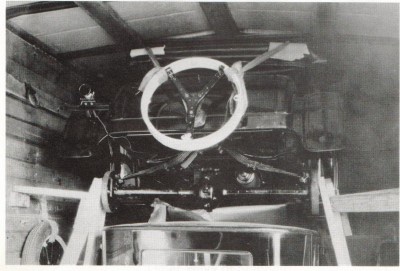

IMG_0747 (800x600) (600x450).jpg (130.75 KiB) Viewed 1690 times
This is Ford factory photo from loading freight car of a '26 runabout, on this one the wire just goes under the fender.
26 original road frame view - Copy.jpg (64.52 KiB) Viewed 1690 times

Very good pic of car in boxcar Dan. It also shows another important feature. Cars were shipped without a spare tire. Just the spare rim.
Very good work showing that pic. Dan

They were sold without a spare tire as well, unless you paid extra for one.
