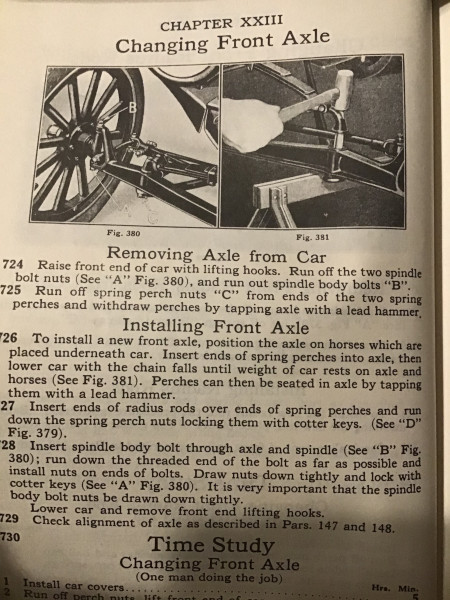

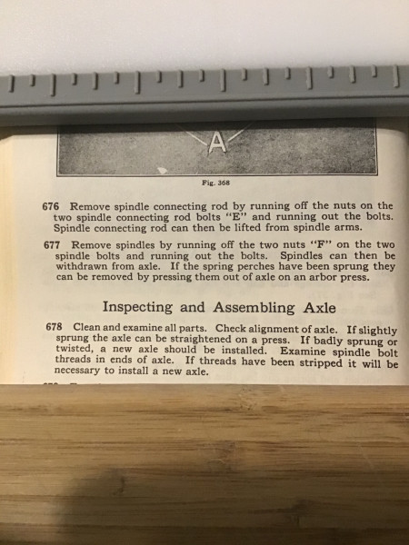

After looking at the Ford Service Manual I found two places where it’s mentioned about removing and installing perch’s. BUT it’s assuming that the cars are either in current production or maybe several years after and not with axles that are 90+ years old.
When installing a perch it recommends using a arbor press.
In removing a perch using the weight of the car plus using a lead hammer to loosen the perch is recommended.
No type of puller tool or press type puller is mentioned.
Evidently the aftermarket makers came up with a puller type tool that could be used.
