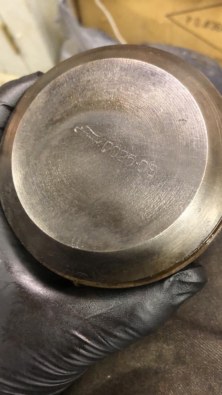

What size replacement cast iron pistons were available from ford back in the day? I pulled these from my 27 TT engines while back and just got around to taking the rods off them when I noticed that they were oversized. My 3-4” micrometer is out of commission at the moment and I can’t tell if these are 0.025” or 0.0025” oversized. Someone educate me!

The would be .0025 OS. Which is one of the over sizes that was sold.

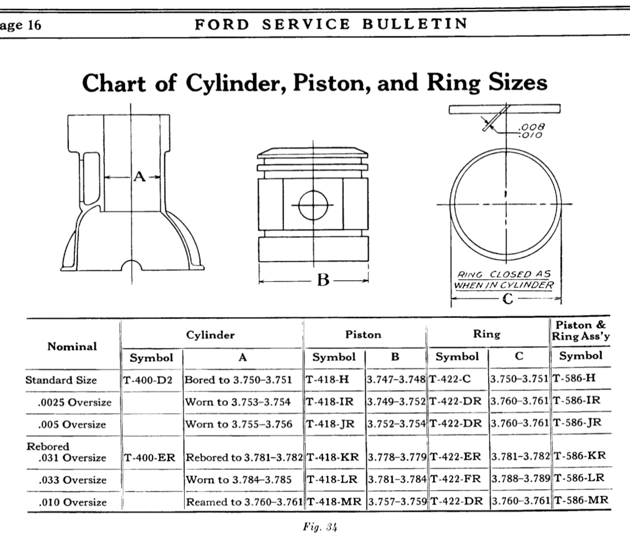

The 1921 parts book shows; 3-3/4", .0025, .03125 and .033. As Susanna said, this was in the days that many shops didn't tools like micrometers and were still using rulers.

Standard, .001, .002, 003, .003, .004, .005, .010, .015, .020, .025, .030, .033, .035, .040, .045
But rings was only, standard, ,005, .015, .025, .035, and .045
