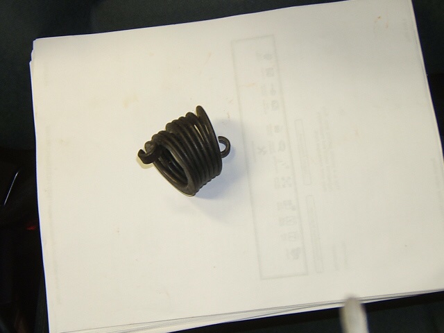

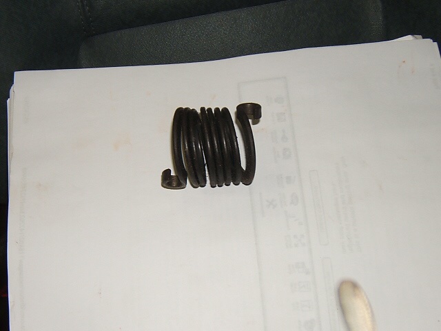

I sold my Model T in 1996 and after the buyer passed away in 2001, his widow contacted me and I bought it back for what I sold it to him for. In the time he had it, he converted it to a 12V system. In changing it back to a 6V system, I discovered the bendix spring had been destroyed by the starter by slamming the bendix gear into the ring gear. The first two photos show the spring from different angles. Note how the spring is distorted and the screw holes are on opposite sides. The forces necessary to distort a hardened bendix spring cannot be good for the starter, the bendix, the ring gear, or the engine in general. The third photo shows the new spring I bought to replace the mangled spring. Notice how the screw holes are in line with eachother. I would recommend you replace the spring and go back to a 6V system. With a 12V system providing power for a 6V starter, it will only get worse with continued use until something breaks. Jim Patrick.

Repro springs work fine as long as they are used on 6V systems. My pictures show what happens with a stronger original spring when used with a 12V system (it is only my opinion that original bendix springs are stronger. Of course I could be wrong) so, I shudder to think how much worse it would have been had my spring been a repro. If the bendix spring had shattered as the engine started, the hardened pieces could have caused massive damage to the engine. Jim Patrick

Post by jiminbartow » Sat Mar 04, 2023 11:51 am
jiminbartow wrote:
Fri Dec 11, 2020 8:15 pm
