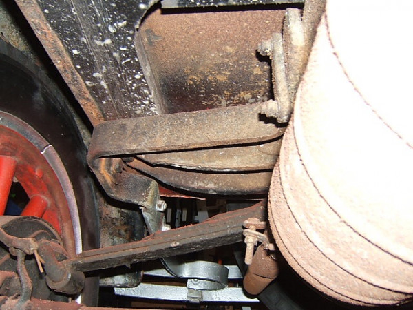

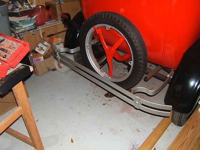

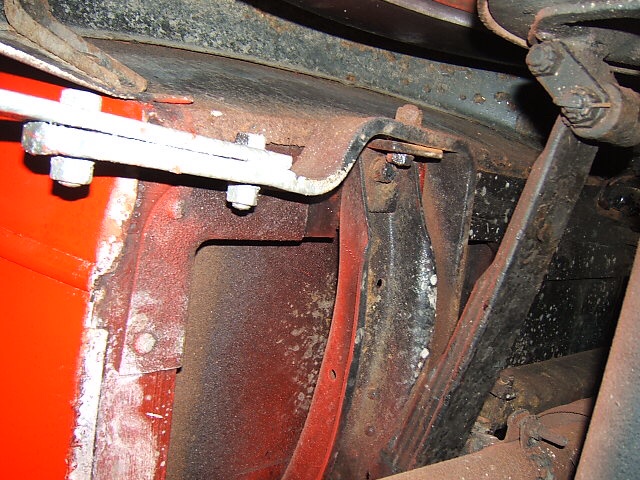

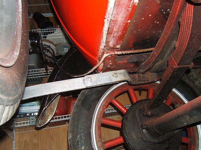

These photos are of the rear bumper on my ‘26 Fordor. I posted these photos several weeks ago in response to another question and someone posted that the bumper is a reproduction, but I don’t agree. Other than the red paint, the T Fordor has never been worked on has all the original bolts and nuts in place and is totally original. Even the top and upholstery are original and the body wood is very hard and solid. Jim Patrick
