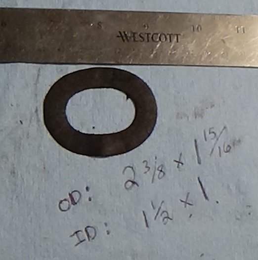

Mag coil insulators: Yea or nay? Why?
Topic author - Posts: 7411

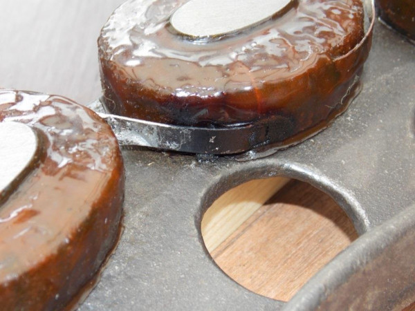

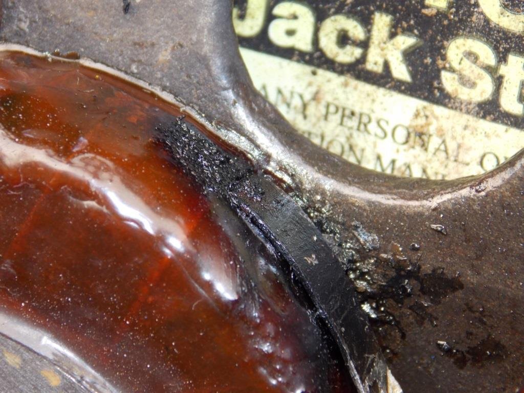

The later mag rings have insulators like this under the coils. The only double stack mag ring I've inspected is the one I'm rebuilding, and it was done before, maybe fifty or sixty years ago. It didn't have them. Should I use these? What are they supposed to do? The coils are already insulated with tape and varnish, so why these?

Yes but not like you might be thinking. I just went down and looked at the 2 I have. When the pair of coils are assemble, there is a insulator placed under the bottom coil and one in between the two. Then each pair of coils are wrapped as unit, not individual coils, so the insulators are in the wrapped pair, not on the outside that I could see. If you didn't put the insulator between the coils at minimum, don't think it would work because they would be touching each other. For the bottom of the stack, think placing one under should work the same as in the wrapped package.

Steve,
The insulating shield under each coil and the insulating between each single coil in the double coils are the most important.
The insulating shield between each single coil make the double coil working. If the insulation is no good the coil will make in the future an internal short and the loop will stop working.
The shield under each coil, between the coils and the coil frame, prevent a possible short of the coil to the frame.
Most of the time this short is due to debrit that is blocked at the coil out comming strip.

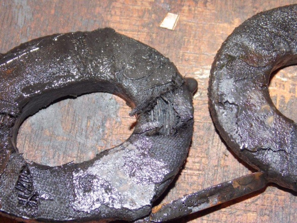

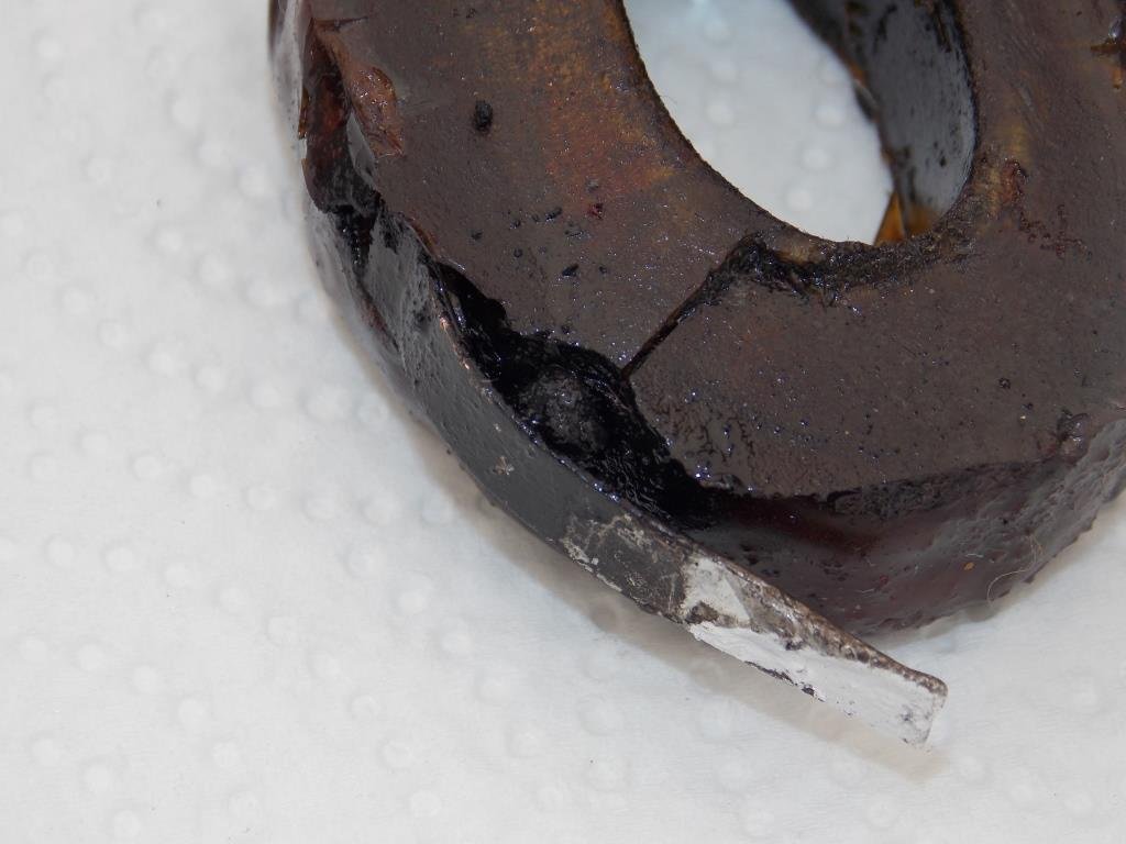

The photos are from a good looking coil ring that I tested as shown in the other post. During the test, in front of one coil the compass needle set parallel with the coil not pointing North or South. As soon as I shorted the coil ring (12V over the loop without the 21W light) at that coil a lot of smoke came with some flames.
The good looking coil loop was just good for a rebuild.
In that coil ring there were no washers between the coils and the frame.
On the photos you can see the "bad " coil and the damage.
So YES this shield is needed.
I make it out off 0.5mm gasket paper.
Snyder is selling them, I didn't use them jet ( made a few hunderds some time ago) but they will be part of my next order.
After assembled and tested the coil ring use a good coating to insulate it all from the oil and the engine debrit.
Good luck
Andre

Here is an other one without the shields.

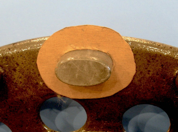

Re: Mag coil insulators: Yea or nay? Why?

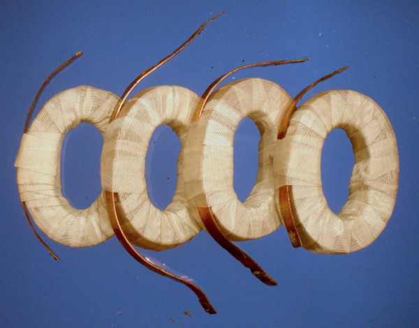

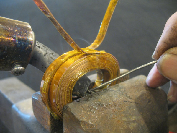

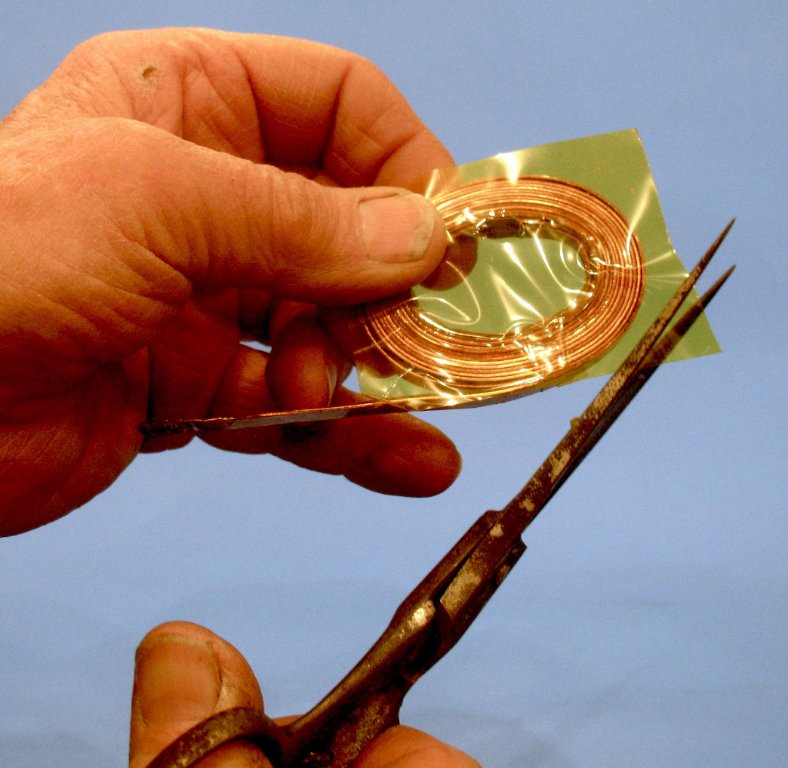

Insulation between coil halves: Yes, I have that.
Each half of the double coil has a layer of Kapton™ so that when the two halves are joined they have two layers of insulation between them.
The only place current can go from one half to the other is where the inside ends are soldered together.
Each double coil is wrapped in ½" fiberglass tape and coated with clear insulating varnish.
I don't understand why the cardboard is needed between the coil and the flat surface of the ring and not around the core that's part of the ring, but I'll go ahead and install it. The cardboard isn't thick enough to put the coils past the ends of the cores. The coils will be safely out of the .025" to .040" mag gap.

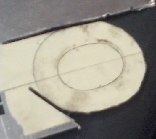

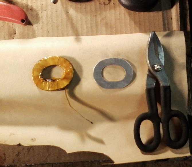

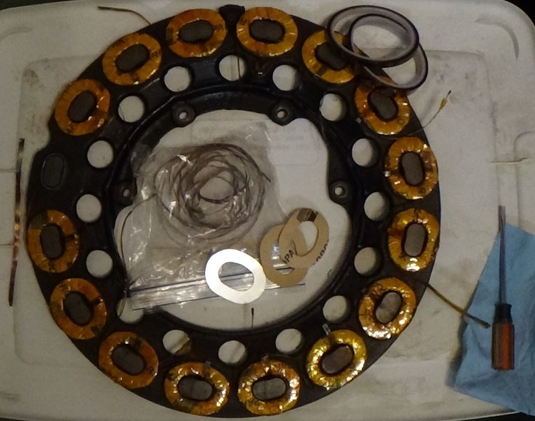

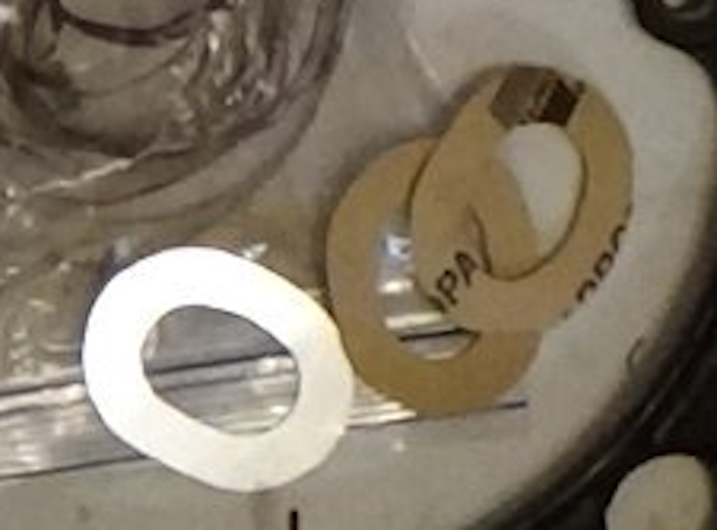

I've only tried this once but I used two paper insulators, one on each side, inside the wraparound tape, not external.
First I cut an aluminum template and then made insulators in mass from a gasket roll. Eventually, they were covered in red varnish.
Vern, how did you cut these? They look neater than mine.
varmint
- Posts: 1042
- First Name: Vernon
- Last Name: Worley
- Location: New Orleans, LA
Steve,
Found these pics to help refresh my memory.
I literally cut the aluminum template from scrap and ground the edge smooth.
Traced around it and cut with plain utility blade and cheap but sharp snips.

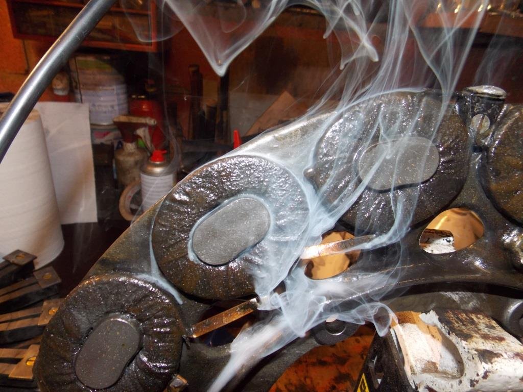

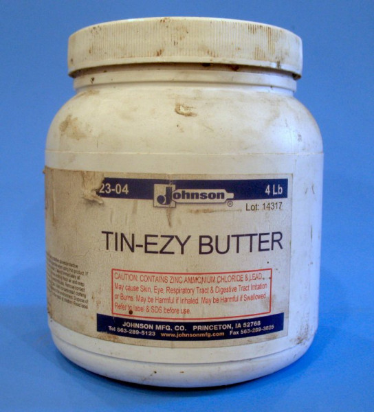

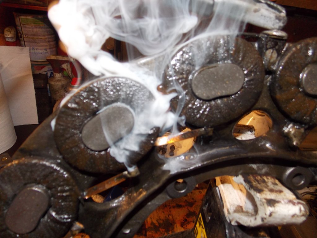

WARNING: DON'T DO IT!
Last night I received an email from a forum member who was kind enough to give me a heads-up on what I had done wrong. I'm posting it here because I don't want anybody to see what I did ignorantly and think it's a good idea:
I cannot overstate the fact that tinning butter is highly acidic and very difficult to properly clean and neutralize. Copper should all but tin itself and if it's clean a simple RMA no-clean flux should be all that is needed.
Tinning butter is meant to prep not-so-clean steel for the application of body solder which has a very wide plastic temp range and a very small liquid range.
Be really careful with the parts you have done and give serious thought to changing flux products.

Steve,
Can you elaborate on what exactly "tinning butter" is? I have used rosin core solder, which is made for electrical connections, there is also acid core solder, which is NOT for electrical, there is the grease-like soldering paste which I use for soldered, non-electrical assemblies and there are the fluxes used for auto body work, like Ruby Red. Are any of the above considered tinning butter? BTW, I don't see where you ever stated what you used.
Here you go, Jerry.
I bought it to use with body solder and mistakenly figured it would be OK for soldering mag coils, not realizing that it's corrosive to copper. It's not OK for that, as our friend explains. I mentioned it here viewtopic.php?f=2&t=18219, and I'm glad I did, or I would have put the car together with that stuff eating away at those coils.

That stuff reminds me of the dangers of mixing ammonia and bleach.
