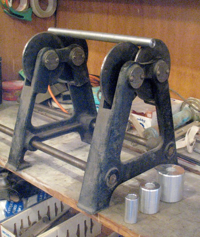

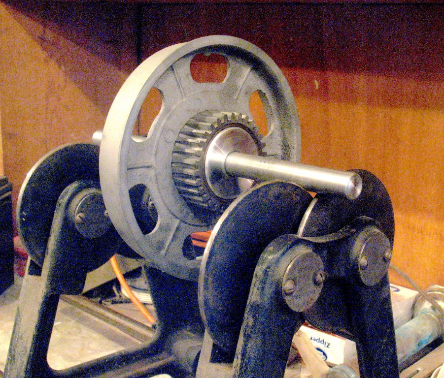

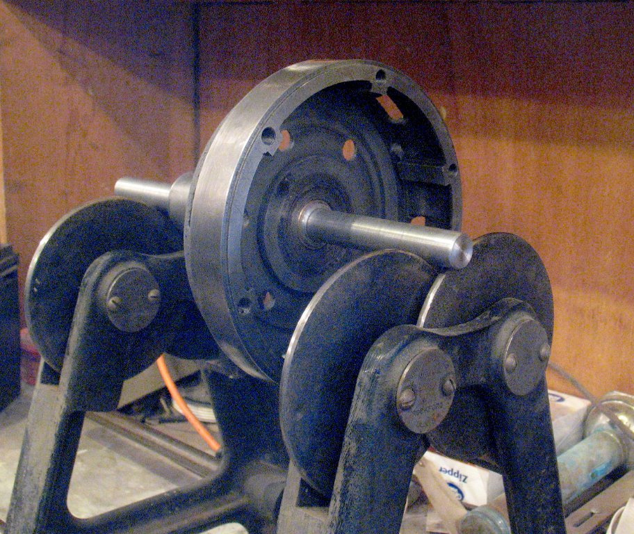

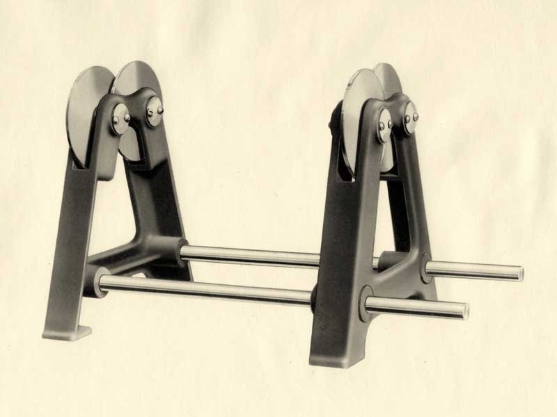

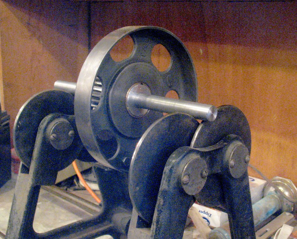

Post by RajoRacer » Mon Jan 18, 2021 3:30 pm

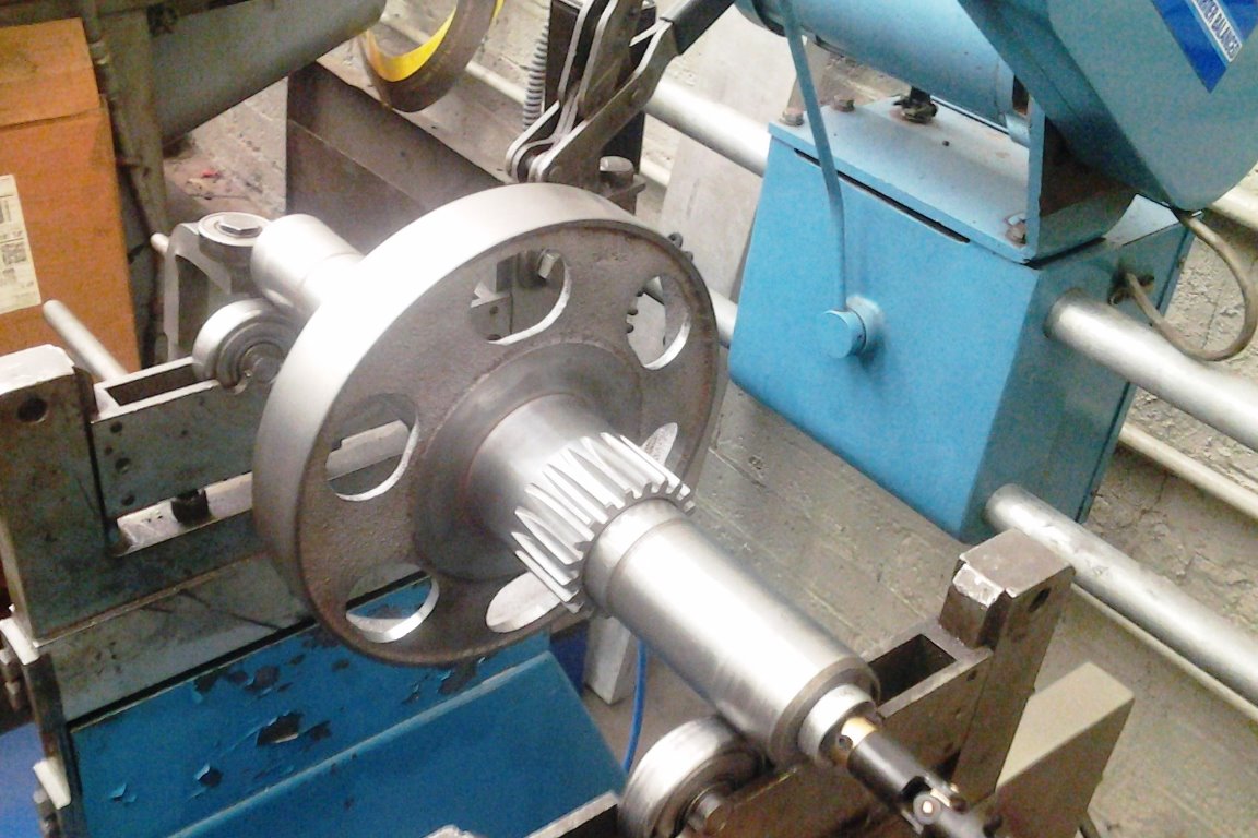

That's what I have & use for any part that rotates - mine is a Sundstrand balancer.

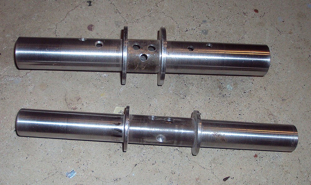

These are made from seamed pipe and I had to drill holes to balance them. I use 2 transmission shafts for the drake drum.

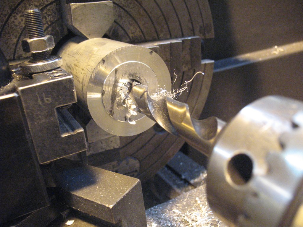

Post by Steve Jelf » Mon Jan 18, 2021 10:26 pm
I borrowed a lathe at the juco to make these.
I cut the rod from a scrap axle shaft.
