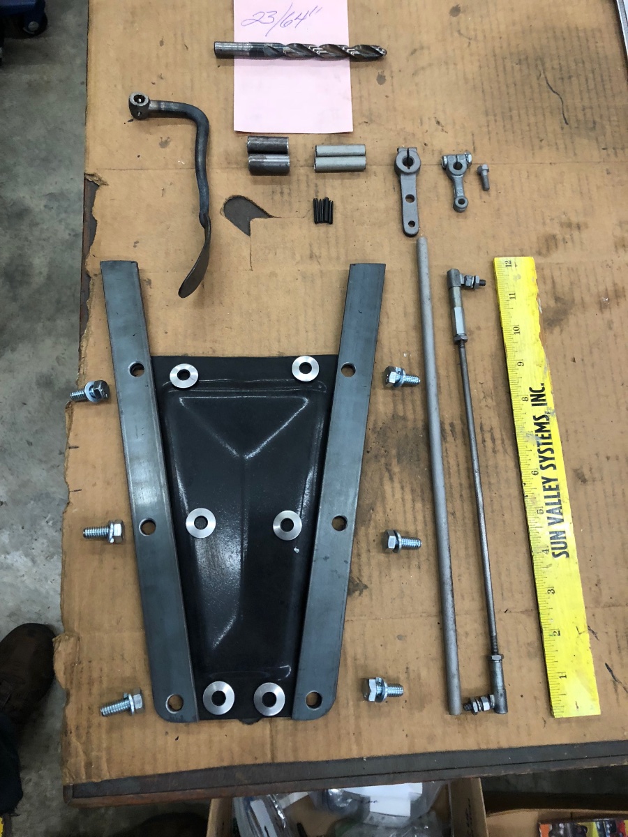

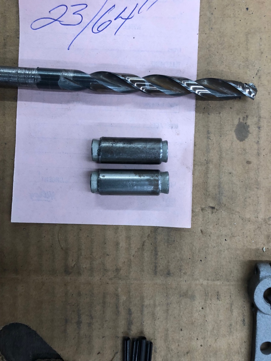

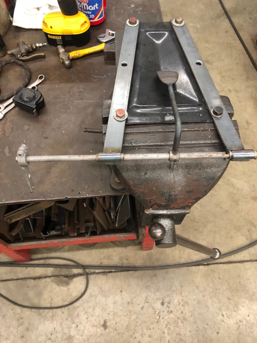

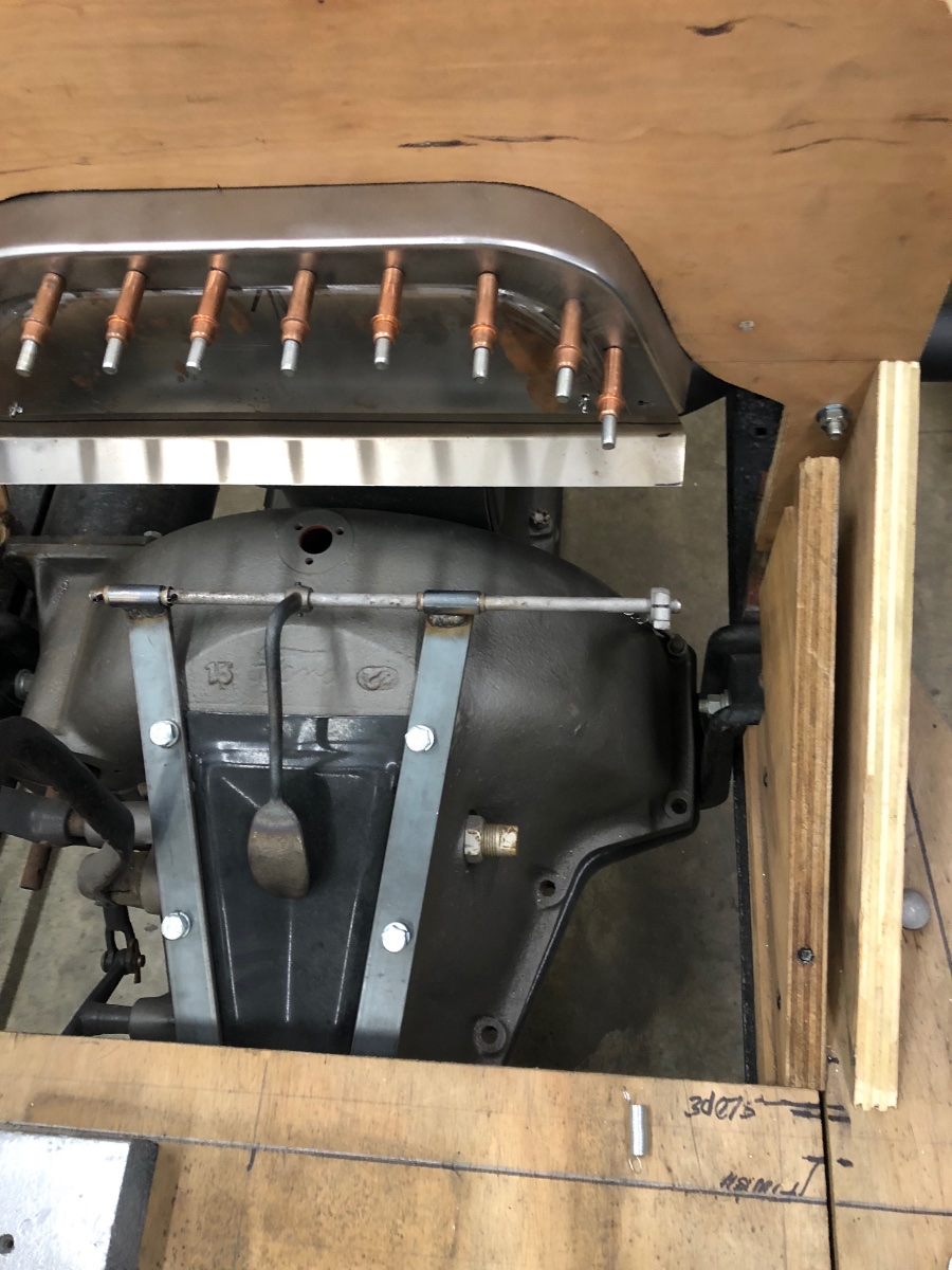

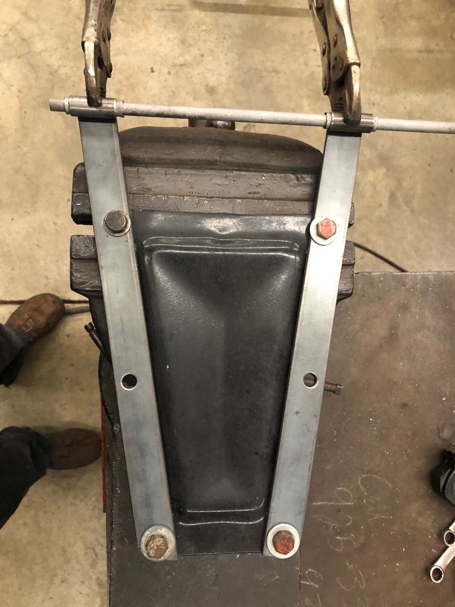

A little time is all it takes with minimal supplies. My Dad and I came up with this system years back, you can even make up a chain and bell crank to still use a hand throttle in conjunction with it.
Simple list of materials from your local hardware stores; 2 feet 1/8" X 1" flat steel (cut in half) , 2 each 3/8" ID steel tubing 1 1/8" long, 13" X 5/16" round stock, 2 each 3/8" OD steel fuel tubing 1 1/2" long, 1 each old spoon gas pedal (1930's Fords, etc.) 3 each 1/8" tension/split pins 3/4" long, 1 each 12" X 3/16" round stock, some light tension pull springs. I like using self sealing washers under the mounting plate to the transmission inspection plate. Really stops any leaks. The fuel tubing is installed into the heavier tubing to act as a secondary bushing and helps in any misalignment issues and you simply just flare the ends. You will also need two ends for the hook up at carb and pedal rod, the pedal rod downward arm can be purchased from multiple vendors.

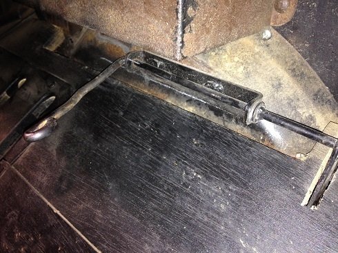

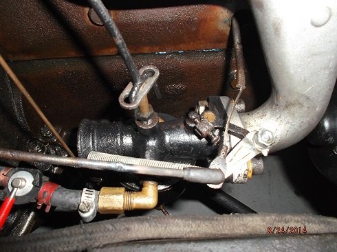

made mine simple
- Attachments
- cap grinder,foot throtle 004.JPG (47.86 KiB) Viewed 5278 times
- cap grinder,foot throtle 009.JPG (59.89 KiB) Viewed 5278 times
