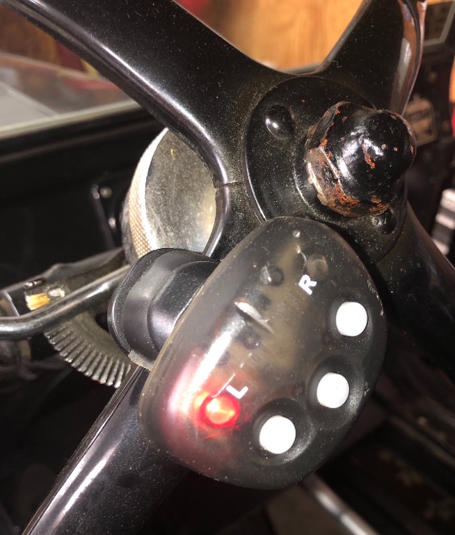

Good experience here. They are bright, and I use them in conjunction with hand /arm signal on turns, at a stop light they are nice to have so your arm isn't stretched out for 40 sec light change at the intersection
The LED's are very bright and the sequential action of the arrows gets attention from most behind you.

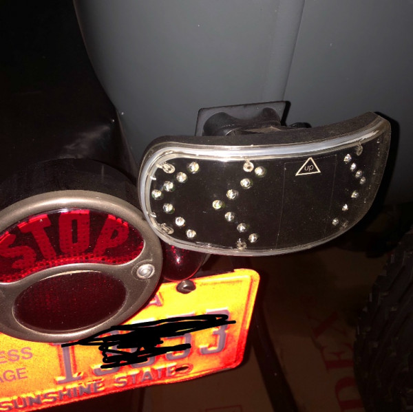

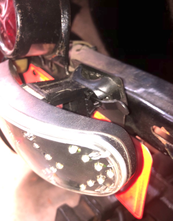

Mounted the unit to the back of the accessory '26-'27 stop lamp bracket, on my '27 touring, think you could do the same. Trimmed the factory bracket I recall or maybe I made it, been a few years.
For use, good to change the batteries every tour, as sometimes forget to turn the rear blinker off, and it can run down when parked overnight.
The steering column clamp works good, but made reaching the horn button awkward, but ok.
On my other T's, I got the made in China bicycle ones off eBay, and the mount for the handlebar fits right on the Ford steering wheel! And the China ones are inexpensive, but same blinker unit as Egypt Garage, the cost of theirs is in the long bracket for the rear and steering column. Bit of sheet metal bend, and a rear bracket is easy to fabricate.[/b]

- Posts: 4046
Re: Egypt Garage e-lights

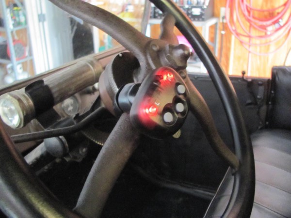

This is the same China version unit mounted on the steering wheel spider. The China version comes with this control for handle bar, but it fits neat on the steering wheel and simple access. Make your own rear bracket to mount. On the '24 made a mount to fit to the spare tire hanging off the center. The signal is centered on the T that way.

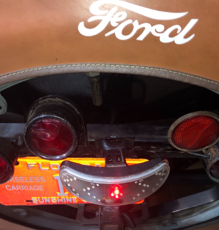

Any ideas on how to get the license bracket to fit with a vintage plate? I was going to use steel cable through the license plate itself but I’m worried about tearing the plate. Perhaps I’d add a bolt through the plate and tie to that? Or use a hard bracket instead of wire?
I’m not sure any of the brackets Egypt sells would work for my application. Again, the issues I have are a stock brake light and a vintage plate.
- Posts: 5474

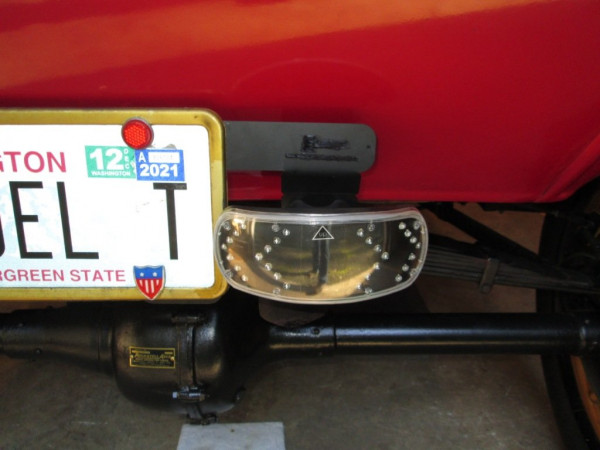

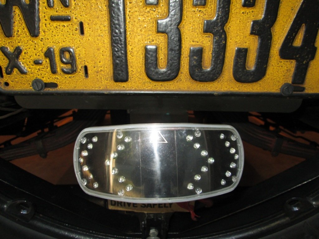

I use Egypt's brackets on both T's - I'll have to look & see if I had to modify the bracket as the Centerdoor has an original 1919 Washington plate that is longer than modern plates - on the '14, I attached the Egypt bracket to my original "Neverout" license bracket - I'll try & get a couple photos.

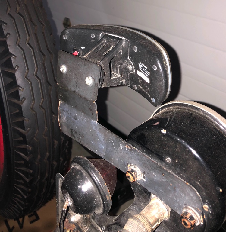

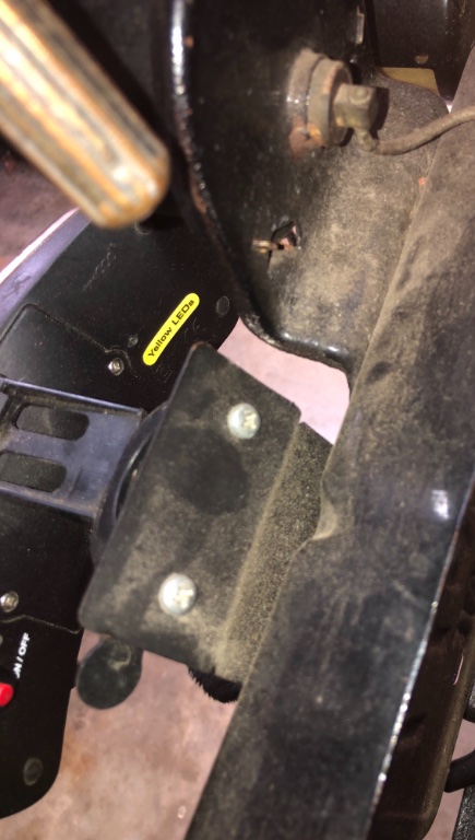

- Posts: 4046
Eldo
IMO wire mounts may wiggle and get loose, easier to use small bolts and nuts and add the mount to a bracket, fit the bracket where the Signal Lamp won't interfere with the body or fenders.
On this install of the China bicycle Signal Lamp, made a small bracket of sheet metal, bent it to present the lamp at level and marked and drilled holes to mount the sheet metal bracket to the tire carrier frame crossbar. Really not hard to make a sheet metal bracket for that plastic mount.
The plastic mount for the Signal Lamp has screws on the backside to use. That mount of course has the clip handle for instant off and on of the Signal Lamp, to change batteries, or to remove for safety to keep away slight of hand characters.
Back side of small sheet metal bracket fashioned and bolted to the crossmember of the spare carrier on the '24.
Control module on the steering wheel spider.

- Posts: 5474
Here's how I mounted mine Eido - Egypt Garage has about every type of mount you might need without "major" modifications.

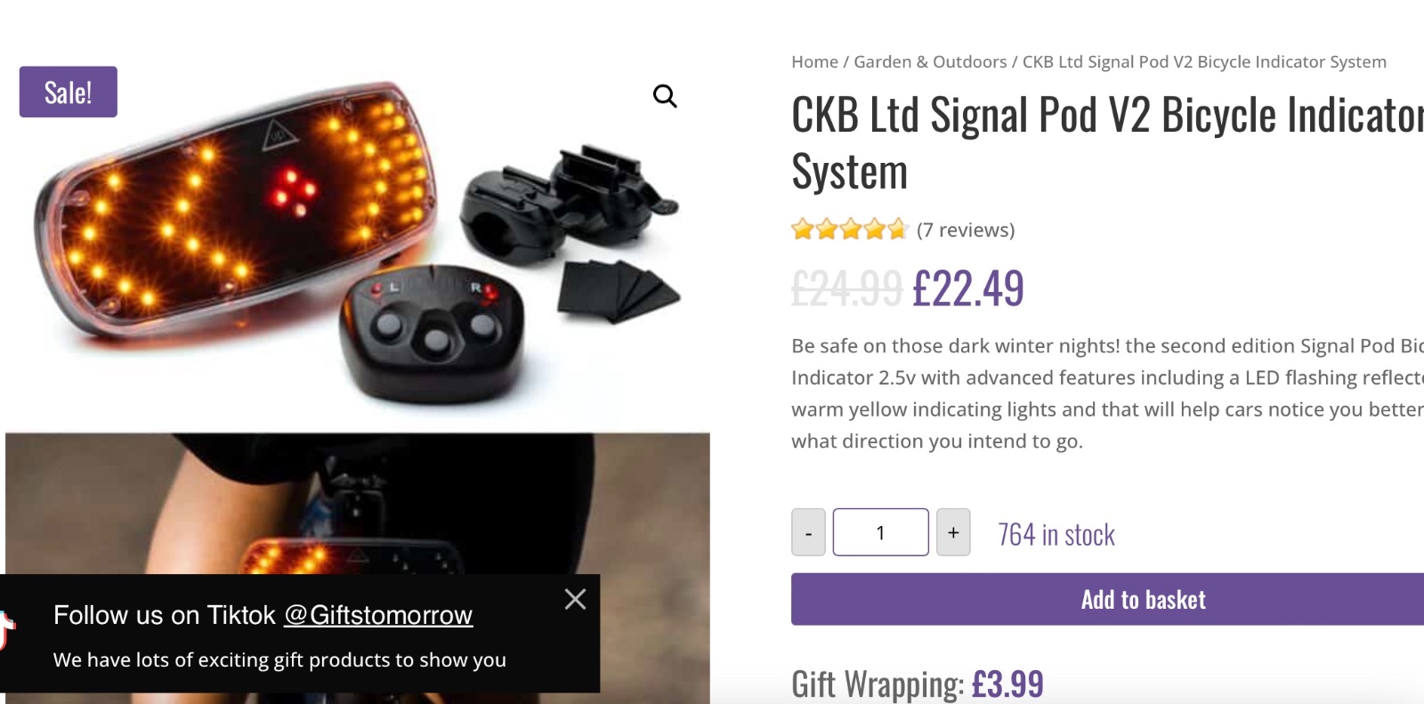

Where can one buy these wireless turn signals? My dad bought a set from http://www.theegyptgarage.com/some time between 2002 and 2012. The system board seems to have fried. I would love to know how or where to find another set…
- Posts: 4046
The brand I use in the posts and still works fine is the "Signal Pod", there are many other bicycle turn indicators, some are USB rechargeable, you find at bike shops or Walmart places, I prefer the battery type. The Signal Pod used to be avail in the US, but the last one I ordered came from the UK, they ship the unit for $10, as least the web site states. 23 Pounds Sterling is approx. US$29mireland wrote: ↑Fri Dec 06, 2024 12:15 amWhere can one buy these wireless turn signals? My dad bought a set from http://www.theegyptgarage.com/some time between 2002 and 2012. The system board seems to have fried. I would love to know how or where to find another set…
China made, imported to UK by CKB. www.giftstomorrow.co.uk or www.ckbltd.com
