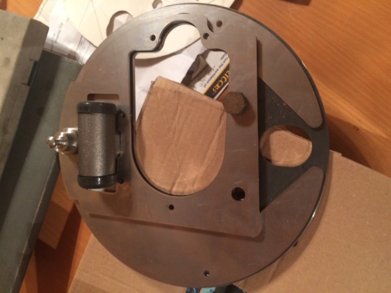

Post by Les Schubert » Wed Jan 27, 2021 12:10 pm
My backing plate designed around 67 f100
Just found this in my pictures

Les - Those plates look interesting. An original backing plate at the rear of them? Did you work out using an original cam setup for the emergency brake? Would like to know what you did to the shoes to keep them aligned on the front edge (right side in photo). Does that area handle e-brake duties too. This sure tempts me to want to see a picture or two of the completed setup ready to go but without the drum. I know you have other things to fill your life but you have me real curious.
I cobbled together some large drum rear brakes that work but are not as clean as I would like. The F100 brake shoes and hardware came in handy for me too. My two areas that I wasn't very thrilled with were the rigidity of the backing plate (I used a single plate that was thicker than stock but could have been stouter) and the hookup for the e-brake where I used the basic F100 guts and ran a cable that I scavenged from a Nissan. Works but not the cleanest effort. Would like to do better if/when I do it again.

Les Schubert
Posts: 1364
First Name: Les
Last Name: Schubert
Location: Calgary
Re: Who to Buy Disk Brakes From?
Post by Les Schubert » Wed Jan 27, 2021 3:14 pm
Walt
3 layers of steel pictured. The top layer mounts to the flange on the end of the axle housing. The second layer is around the flange and the third layer is behind and locates where the 67 F100 backing plate would be.
The internal parking brake and self adjustment linkage is used from the truck. A lever is created to operate it from the stock T parking brake mechanism.
So I get self adjusting brakes and all the benefits of the Bendix design (self energizing both forwards and reverse).
Hopefully this helps. Unfortunately I don’t have the time in my schedule to create this for sale. Too many of my own projects and problems to solve!!!

Post by walber » Wed Jan 27, 2021 5:21 pm
Les, Completely understand where these would fit in your stack of priorities. I appreciate your picture and notes. Good luck with that C crank engine, should really beat the stuffing out of a bunch of OHC engines.
