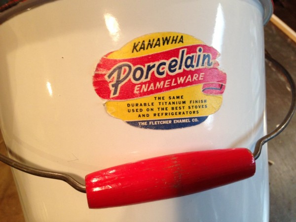

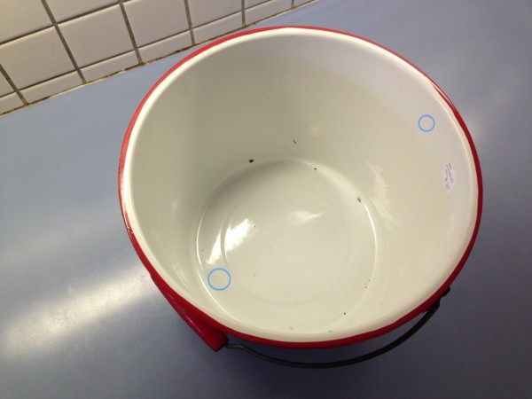

I need to drill two holes in this pail. One about 1" diameter in the bottom, and a second one about 1/2" diameter near the top.
I expect this coating will want to crack and/or chip — any suggestions for doing a neat job on this?

I have used porcelain bits in the past, starting small and going up. Easy does it kind of thing.

Using a small grinding stone in the area to be drilled down to bare metal is the key. Take your time and she will come out great.

I use a diamond coated glass drill bit.You will want to run cooling water when using a glass drill bit.

Thanks all for your comments. I'm going to start with Henry's suggestion.

I'd use a diamond coated bit as Daryl suggests.  I've used them on similar things recently and they work well.  Just keep a spray bottle of water handy and cool it regularly.
