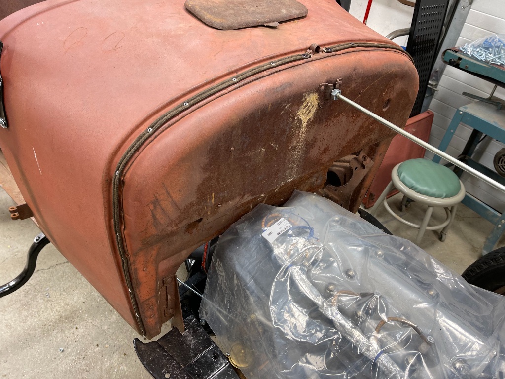

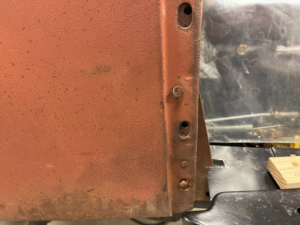

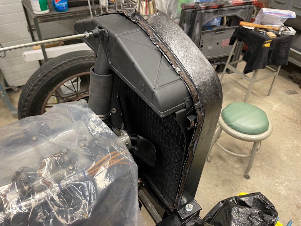

Radiator shell turned out pretty nice. Cowl lacing looks self explanatory except for the 2 at the bottom. Bottom looks easy as the back is easy to get to so the rivet can be split. The next one up seems like a rigid nail. What is the fix for that one?

Is there a hook like the model A has that clips over this?

No hook like an A. Been a while, but recall slipping in a piece of busted hack saw blade or something as the backing bar to force the split tangs of the rivet to seat on the backside. Those lower holes are a bear, the others are OK, if you have the gas tank out!
Think I used an ice pick to make the hole a bit bigger and spread the tangs just so, before insertion, that helped them spread open. Have Fun!

I found some earlier posts on this. You replied then. My fuel tank is out. A couple fellows said they used pop rivets

That probably was a job that the Ford line guys did before the body parts all came together so you could have nothing in the way to put the rivets through the lacing.

Post by dmdeaton » Tue Feb 09, 2021 9:27 am
John
I agree
Even with the dashboard and fuel tank out it’s a bear. I am glad I started to tackle this before I mounted the fuel tank and dash. I never gave it a thought, usually I’m the one doing things 3 or 4 times to get it done. 😁

Post by dmdeaton » Tue Feb 09, 2021 5:51 pm
Right or wrong I got it done 😁
1/8 inch pop rivets with washers on the backside
