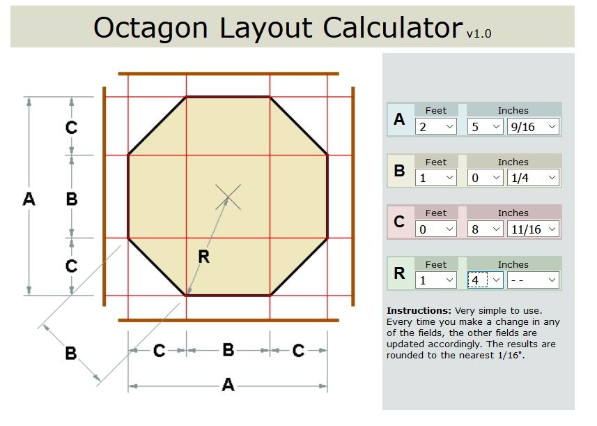

Here are a few links that will help you make one and use it. The calculator should really help to get outer ring dimensions. The only input is R. (30 inch felloe + 2 inch outer boarder) / 2 = 16 radius for outer boarder . Cut 4x4 with B = 12-3/8 (I rounded it down see instructions in chart) And the angle would be 67.5 degrees per the links. Would help if those who have made one can confirm the dimensions.
Use it - look closely at the pictures too
http://www.mtfca.com/discus/messages/257047/302832.html
https://www.youtube.com/watch?v=UKZ7Wrf ... plpp_video
http://www.mtfca.com/discus/messages/179374/183733.html
Parts http://www.mtfca.com/discus/messages/59 ... 1478991835
Octagon angle https://www.woodworkersjournal.com/angl ... al-pieces/
Octagon Calculator http://www.greensville.net/brian/info/o ... t_calc.htm

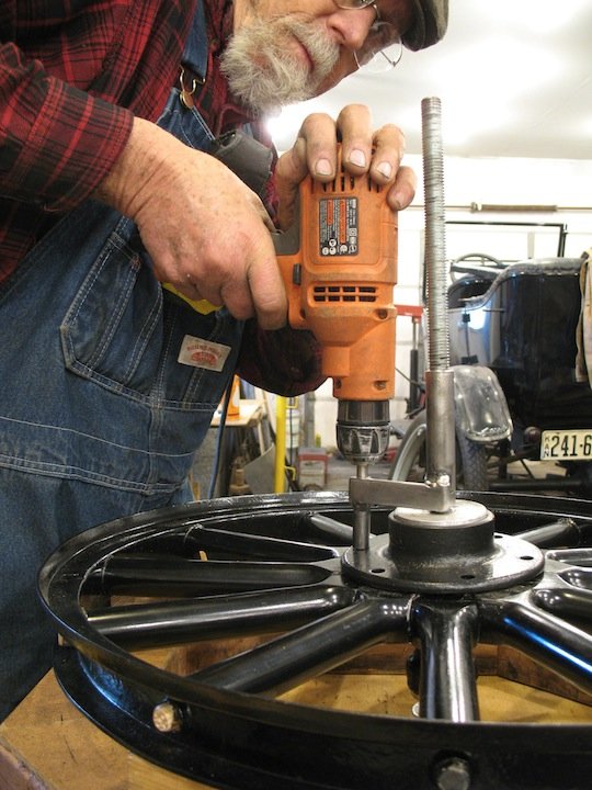

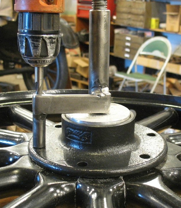

Post by Steve Jelf » Wed Feb 17, 2021 1:39 pm
Here are John's drawings for the Regan press. The PDF is better, but I can't post it on this software.
There are several versions of a drill guide. I expect you can find them with a Google search. Here's the one I posted recently in another discussion.
