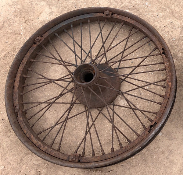

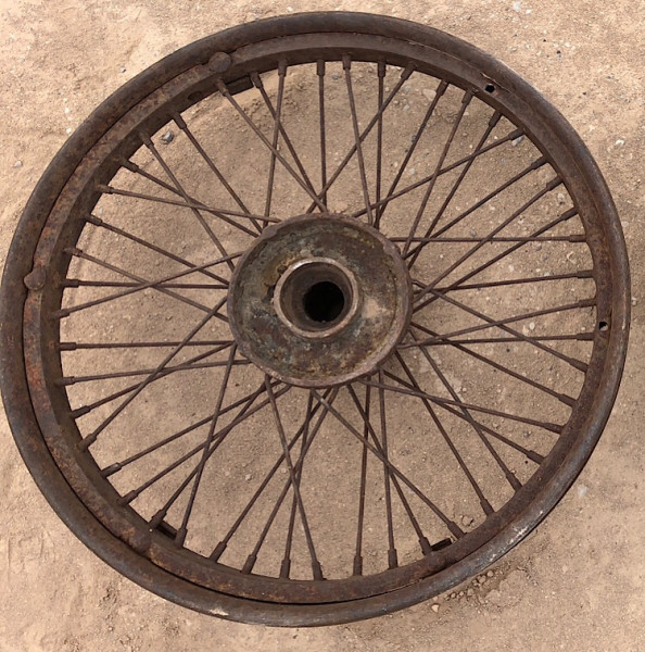

Unknown Wire Wheels
Purchased these 2 wheels at an auction a couple weeks back and have been unable to id them. They look a little like Hayes but have 6 mounting lugs instead of 4 and the outer hub is threaded to accommodate a 3” hub cap. The lug plates and bolts on the one wheel don’t seem to fit so I’m not really sure if they are right to the wheel or not.
Any ideas?
Any ideas?
Dropacent
- Posts: 3384
- Last Name: Morsher
- Location: Norwalk Ohio
Re: Unknown Wire Wheels
Pretty sure Spranger, made in Detroit. Pretty uncommon but a nice wire wheel. The lug nuts are wrong, I may have a loose one here somewhere. I sent a beautiful set to Australia, and a friend in meechigan has a set.
- Posts: 4086
Looks a match all right.
Wow, great id!
I just searched Spranger and found a couple more period ads but no photos of actual wheels.
I’m in the process of gathering up parts to build a speedster so I’ll be on the hunt for a couple of rears to match these. None of the lugs and bolts are correct so I’d be interested in what you might have Tim.
So, any Spranger rear wheels and hub caps out there?

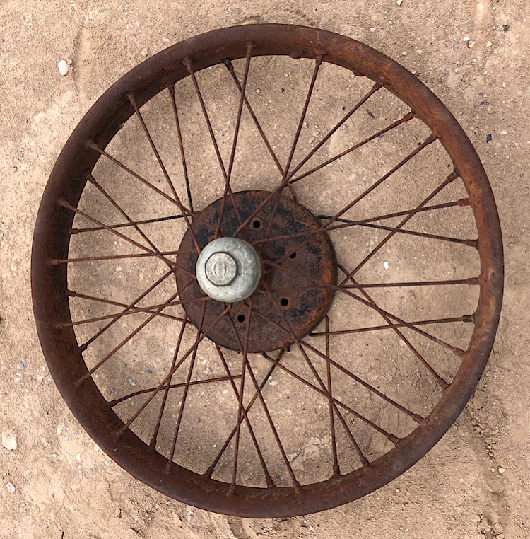

Thanks for the link Kevin, had no idea there were so many accessory wheels for T’s.
I did get another odd ball wire wheel in the mix at the same auction. This one luckily still had the hub cap still in place. It’s a “Universal Welding Co” wheel. To bad I only got the one though. I guess I can either hunt down 3 Universals or 2 Sprangers!
Wow Allan, great story, I think I need to start making more pitstops!
Anyone have 3 Universals...
Wallace
Here's an adv. on that Universal wire wheel.

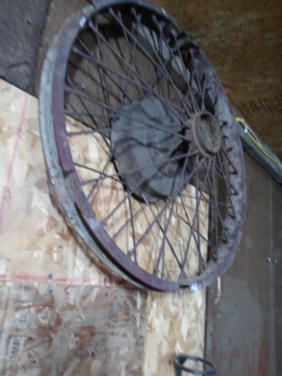

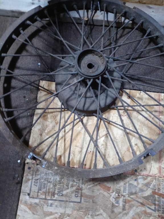

I am the other guy with Sprangers. You might have a tough time finding rears for the reasons stated. Sprangers and Hayes have built in hubs so the front and rears are different. Buffalo, House, Dayton wheels had a seperate hub so the wheels are the same...sometimes. There can be spoke count differences as well as size. Putting together a set of wheels can be a nightmare. Sometimes Hayes fronts are converted to rears.
I have some photos of Spranger rears so you can see they are different from fronts and a photo of the cap. I started with a full set but added 3 more fronts to the pile so I have enough useable rims, will have enough to make 2 rears and 3 fronts, one as a spare just to hold the extra rim and tire. Will try to post photos but on my phone and might have to do it later from laptop.
Tim, from the photos I thought the wheels with six stud holes may mount onto Ford hubs. The last advertisement gives that impression. I gather that is not the case from your response. If so, the hunt will be difficult. Even the more plentiful Hayes wheels pose a problem finding usable rear wheels.
You are correct Allan. The 6 lug wheel and corresponding advertisement is for “Universal” brand wheel. These are the inspiration for the McLaren wire wheel that are currently available, and of course... bolt directly to the stock wood wheel hubs
I kind of made it a little confusing by adding the photo of the Universal wheel that I got with the Sprangers. I wonder if the person who had these before was hoping to find another Universal and using them for rears, they would look a totally different but just a thought. I did take a wood spoke hub and set it inside the Universal and it fits like a glove with the wood spoke studs lining up perfectly.
Dan, nice ad on the Universal wheel. I looked on line for quite a while and never did find an ad for them.
Tim, that’d be great if you could post a photo of the rear hub of the Sprangers and maybe even of the hubcap. There’s really not much information on these wire spoke wheels let alone pictures of them.

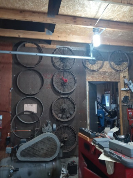

The rims have a piece of square stock with a hole for the rim bolt in six locations and that is why the wheels are notched out. Unfortunately if they get loose the rim rocks and wears out the hole or breaks off the square stock from the rim. On my rears the "fix" was to weld the rim to the wheel. Thankfully they only did that in the attachment area and not around the rim. I have cut that all off and gotten the rims off.
I started with a set of 4 that an old friend gave me. They were given to him by a mail delivery person who had them om the mail truck. They had solid tires that were like ring baloney and I had a terrible time removing the tires, a sawz all was the solution.
These 4 did not have enough to work so got 1 out of Canada and 2 from Australia (all 3 fronts). Tim Morsher made the new rim bolts and 1 cap. Rears are going to be the problem and I have been down that road with Hayes that are also hub in wheel.
I have 2 sets of Buffalo snap ring wheels done with hubs and caps in storage. Those were difficult also but at least there is no front and rear wheel, just hubs.
I might get on these this summer as I retire in a couple of months and drop down to just my private business. Should go fairly easy without not too much $$$ to spend now.
Funny, Hayes were made in Jackson about 30 miles from me and Sprangers in Detroit about 70 miles from me. They sure didn't want to stay around home.
Tim, your hubs look to be 2 piece, is that only on your rears?
My hubs are one piece but maybe that’s because they are fronts. Looking at your photo it doesn’t look too likely to be able to modify a front into a rear. I suppose anything’s possible but looking at your hub it appears offset for the brake shoes. It may be easier to machine new rears as was suggested by Kevin. My fronts hubs are a machined casting, probably ductile or cast steel. I’m sure the rears are the same.
Correct, the original rears are 2 pieces riveted together with the brake drums. Converting fronts to rears is possible but will not be authentic and will not be right. Rear Spranger wheels are going to be very hard to find and probably nearly impossible.
I once did a set of 19" Dayton dental drive drop center wheels for a customer, that is my ultimate goal to find. Matching up wire wheels is expensive and takes years.
