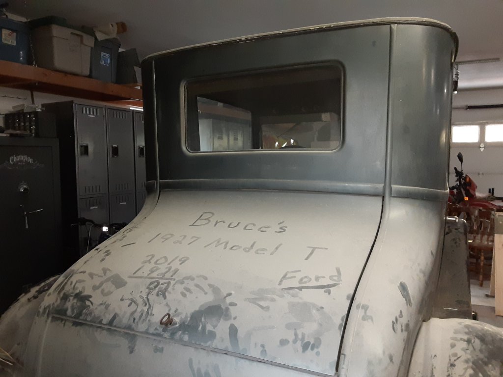

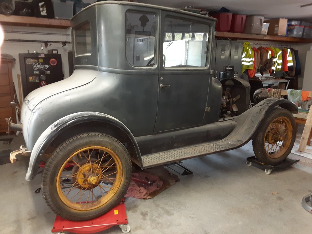

Fast forward to 2019/2020.

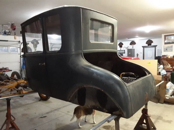

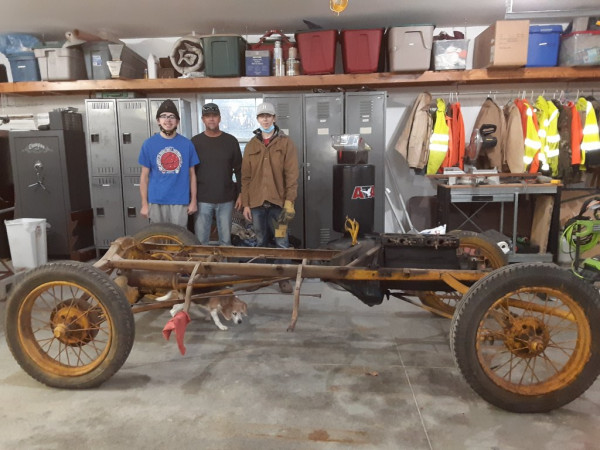

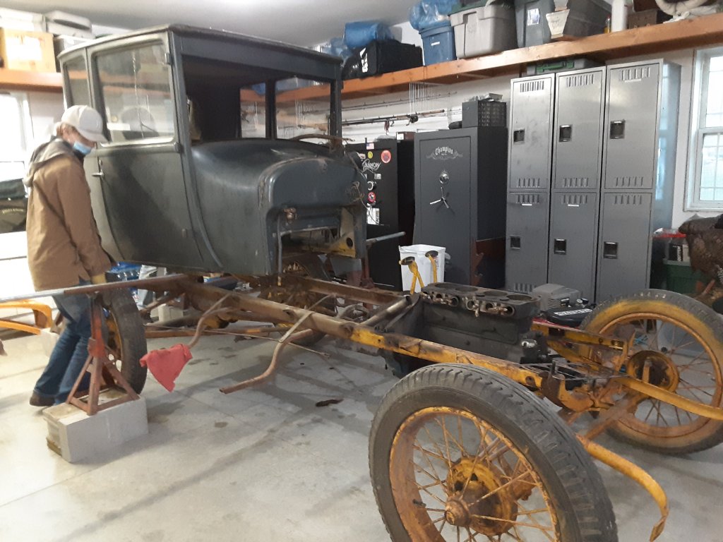

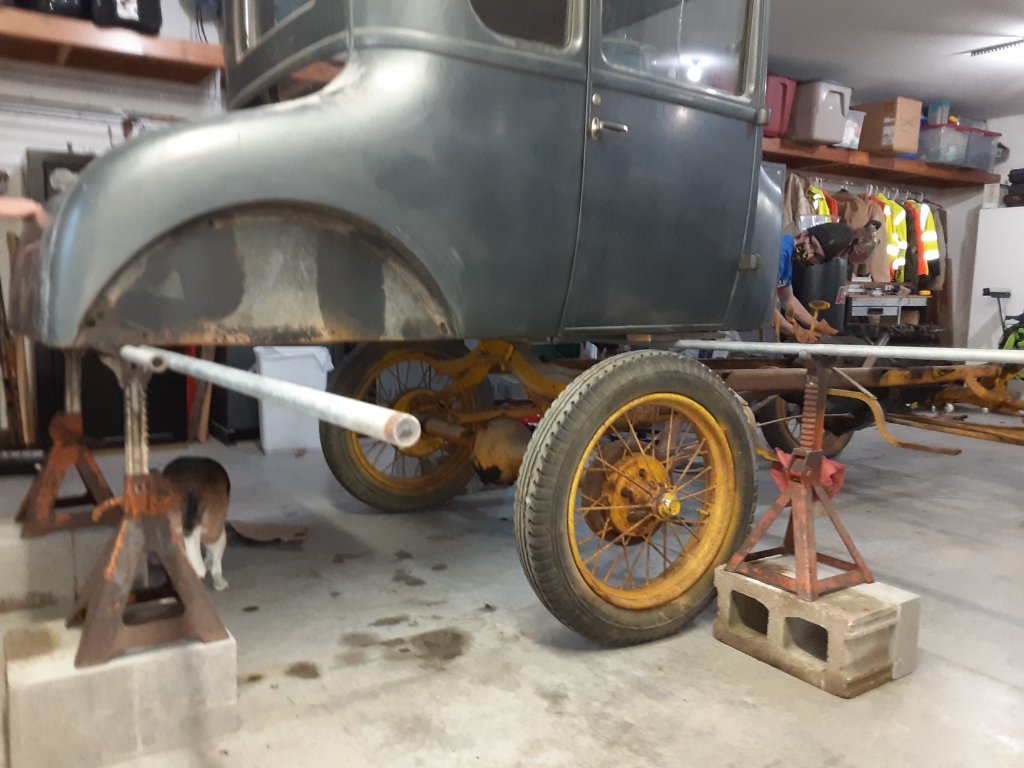

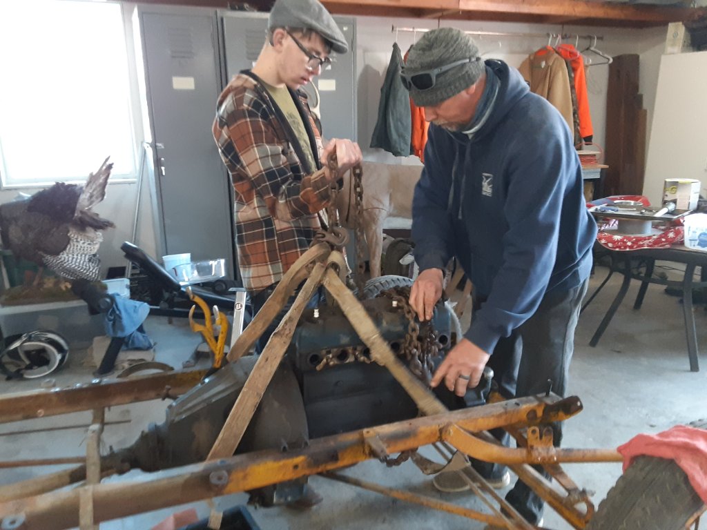

Getting ready to remove body from the frame.

Post by BLB27 » Tue Feb 23, 2021 12:21 pm

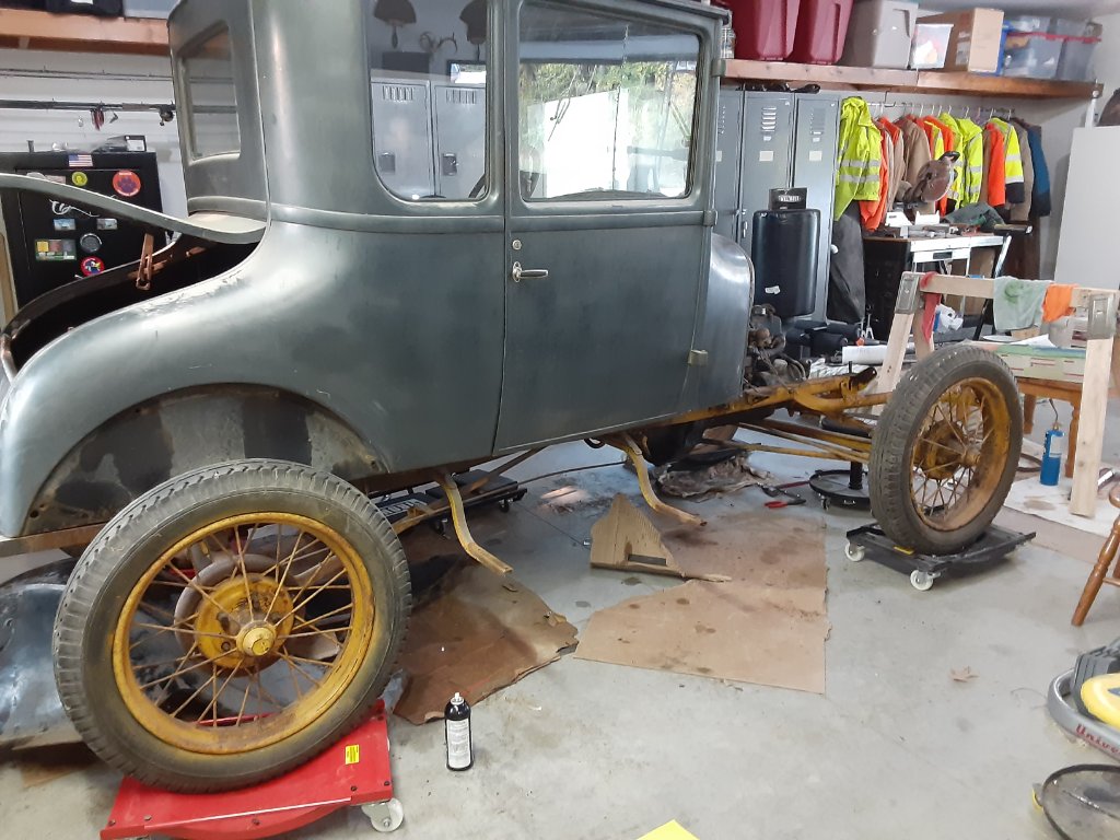

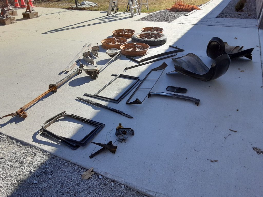

Continuing to remove parts.

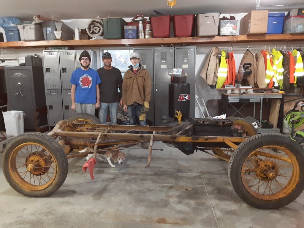

Got it off!! Now the work begins. We will need help from the MTFCA.

What a great project Bruce. Looks like you have good help to boot. Should be fun and keep the photos coming. I love to watch a project and follow along and I know others do also.

An interesting fact: The two right tires and the back left rear tire have never went flat in the 61 years since it was last run. The front left tire would go "completely" flat, and I would air it up each time the car was moved to different storage locations over the years. It would hold air for several months and then go flat again. You would think the tube would not have withstood going thru all of that!

I think the yellow trim was cute back in the day, at least you could see the peddles at night! Looks like a good crew helping and learning maybe some day they will be the care taker of one?

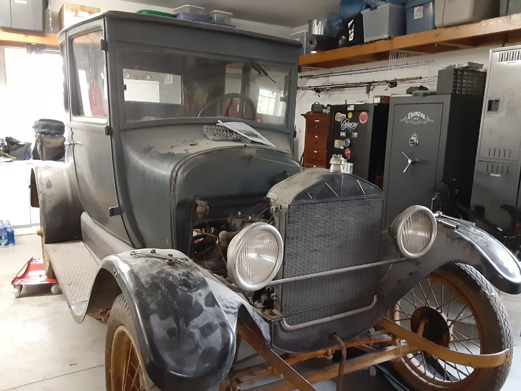

You are VERY fortunate!
What a beautiful original car to restore!
And it looks like it is in absolutely pristine condition!

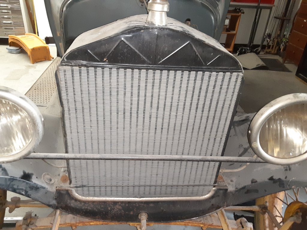

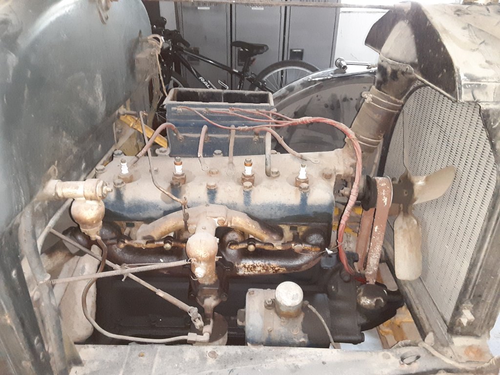

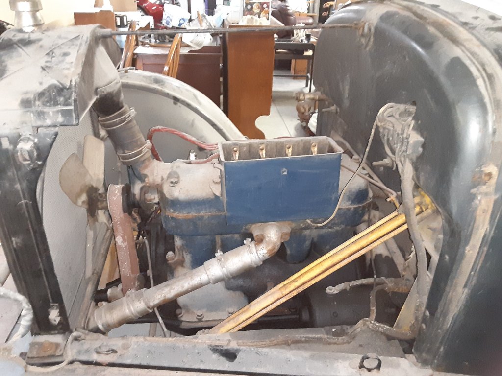

I cannot believe how nice the radiator looks! If that is the original, I am stunned! That is the nicest looking radiator I have ever seen on an original car!
Same with your engine! It looks more like it is 5 years old, than 90 years old!

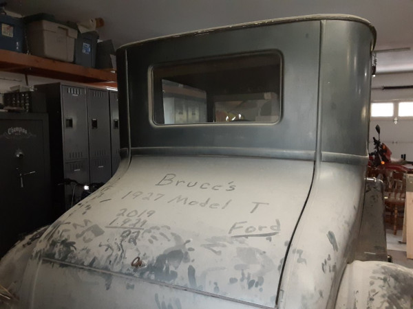

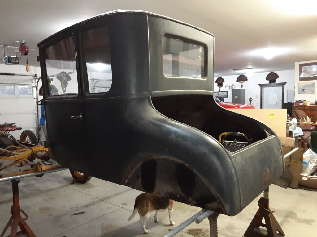

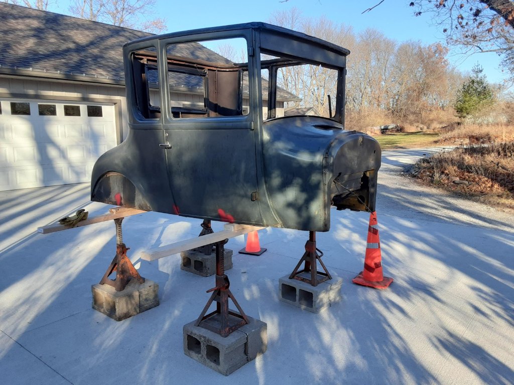

I would appreciate comments about how to remove paint from the inside and outside of the coupe and preparing it for painting.

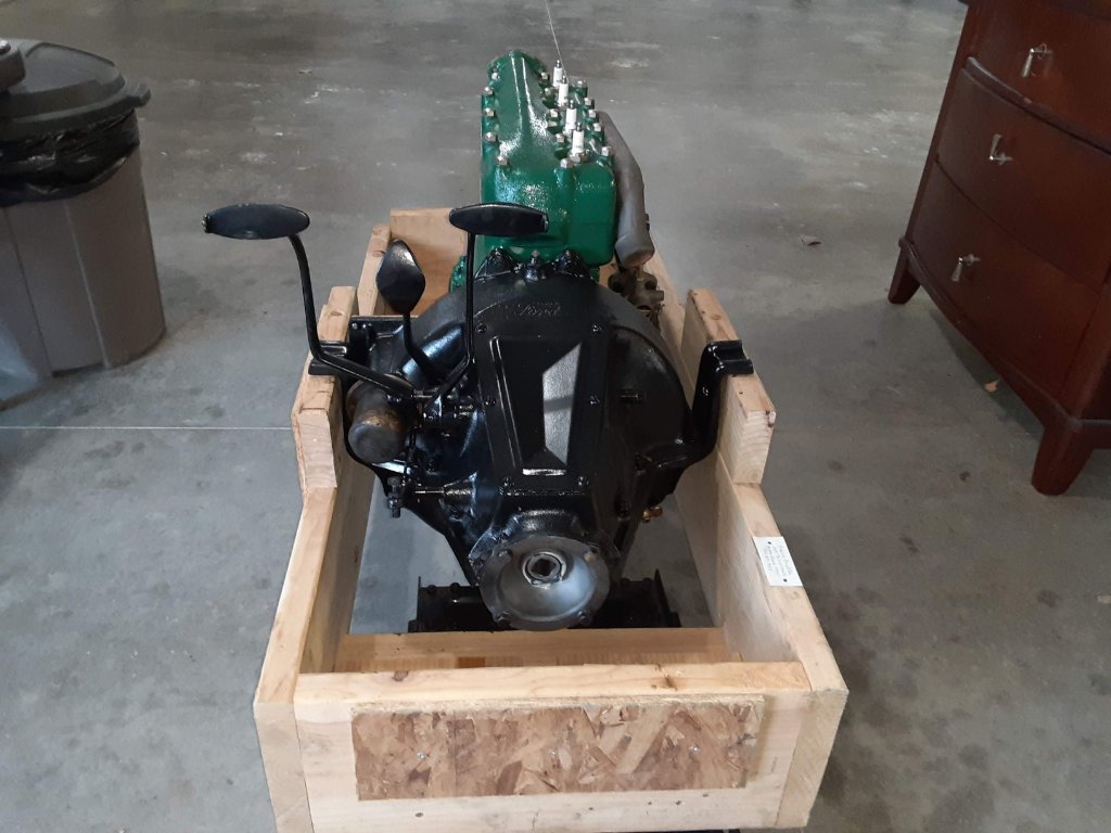

Post by BLB27 » Sat Feb 27, 2021 8:59 pm

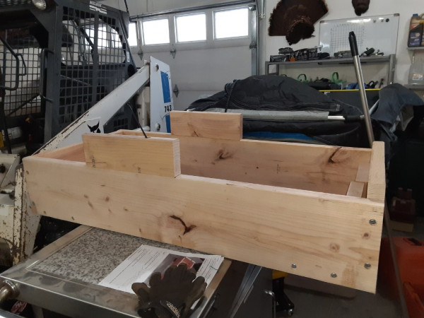

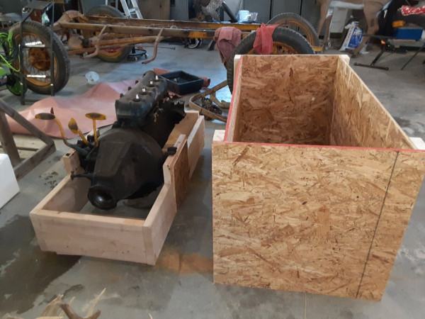

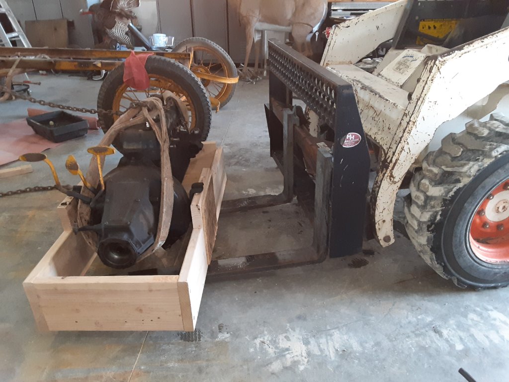

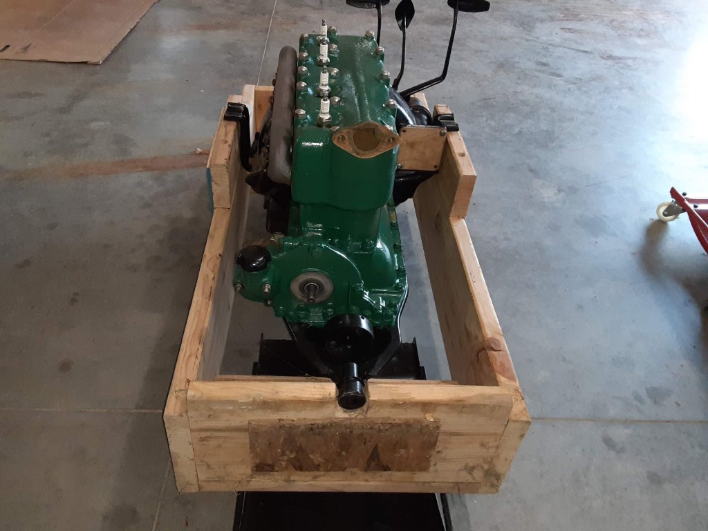

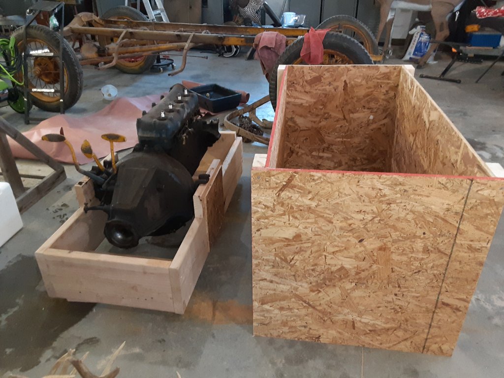

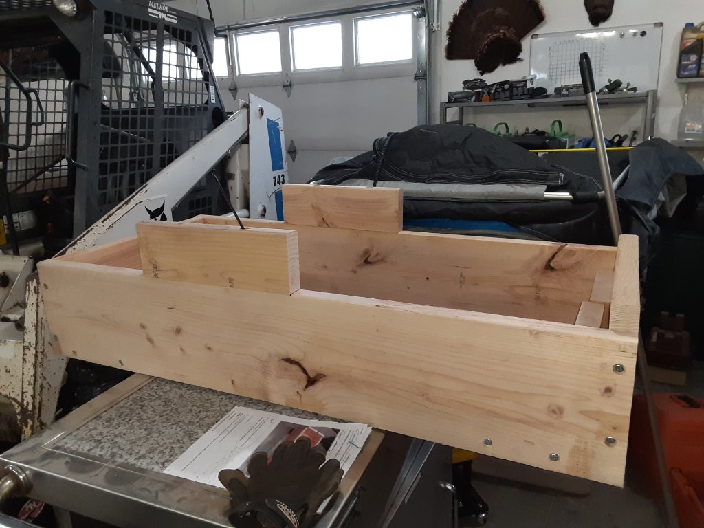

Getting the engine into the stand and ready for shipment.

The paint, though oxidized and covered by a layer of dust and grime still looks good to me. Wash it good then try compounding with Meguiars Ultimate Compound (not the polish) until attaining a mirror-like shine then wax with Meguiars paste wax. You may find you don’t need to re-paint, unless you are tired of the color and want to change it. If the body is solid and there is no need for body work and you do decide you want to paint it, there is no need to strip down to bare metal. You can wet sand the body with 400 grit then 600 grit wet sanding paper and apply a new coat of paint over the old paint. Jim Patrick

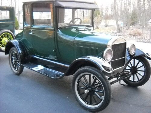

Nobody has mentioned it yet but the body of 1927 coupe from the factory was painted “Channel Green” with black running boards, fenders and radiator apron Since cars with the original paint have dulled, oxidized and darkened with age and there were never any color photos taken of a new factory fresh 1927 T Coupe, nobody is really sure of the actual color, but black and white pictures show a high gloss finish. I found a photo of what your T probably looked like as it left the factory in 1927, only it would not have had running board step plates and the pinstriping would have continued across the front column, then down the column and at the bottom of the column to the rear. The upholstery would have been grey cloth with thin green stripes. Jim Patrick
I prefer the darker, richer green color in the third coupe photo. Of course the red spokes and white walls would not have been been endorsed by Henry. The last photo shows a 1927 Tudor, which was also painted Channel Green at the factory. I think the wire spokes would have been originally painted black, but I think the light yellow wire spokes complements the green very nicely.

Post by BLB27 » Thu Dec 02, 2021 8:42 pm

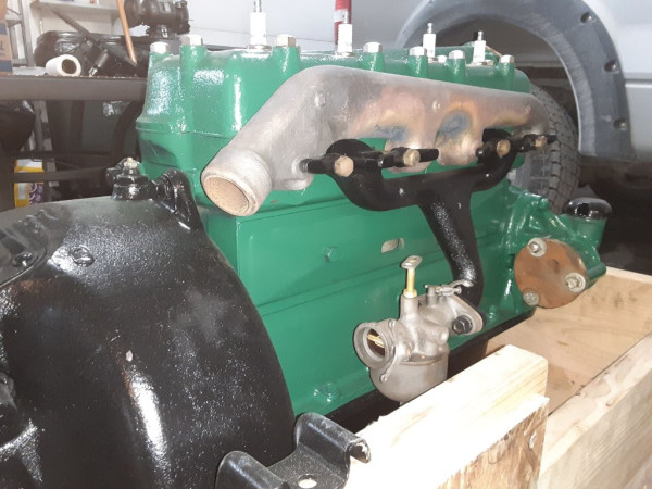

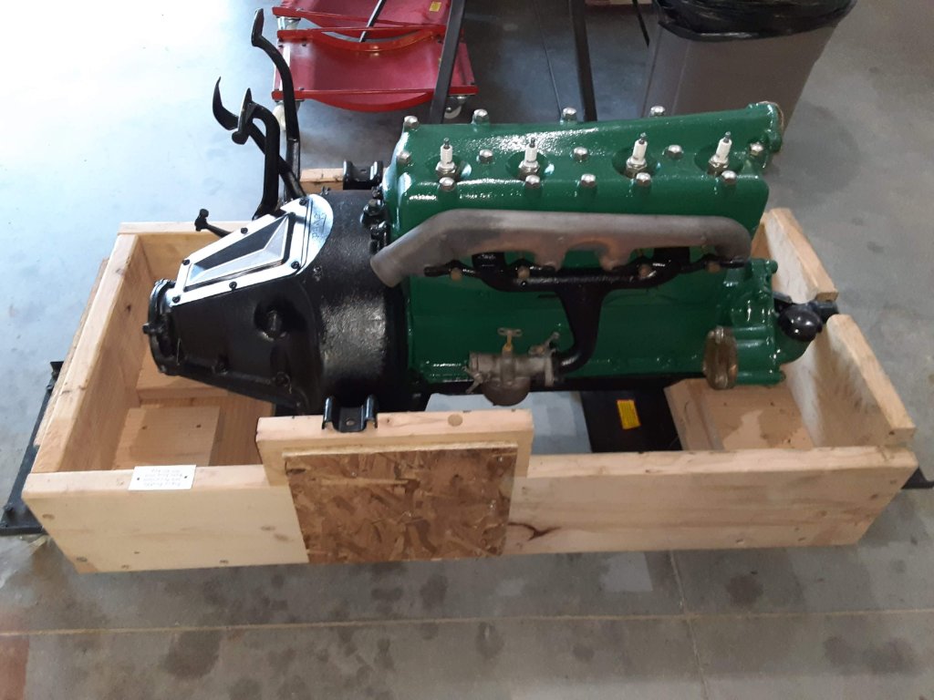

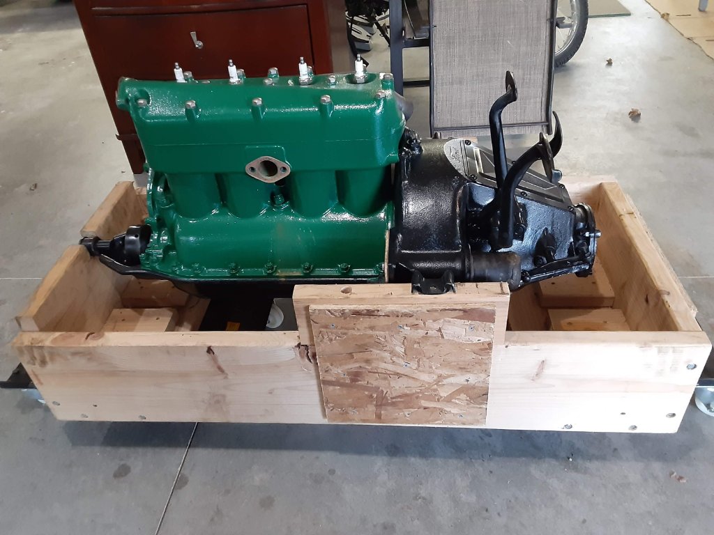

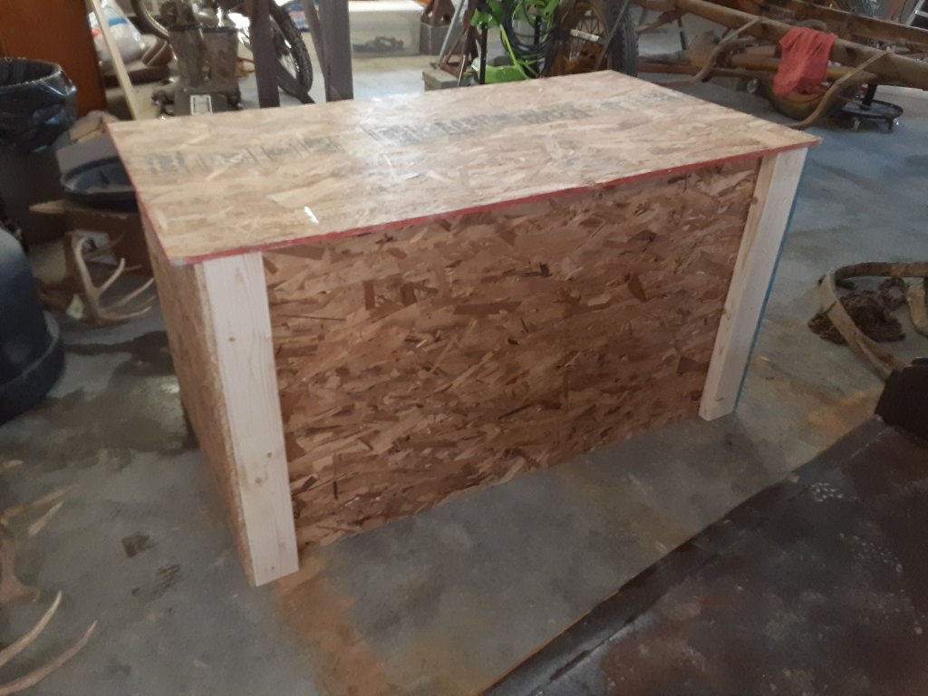

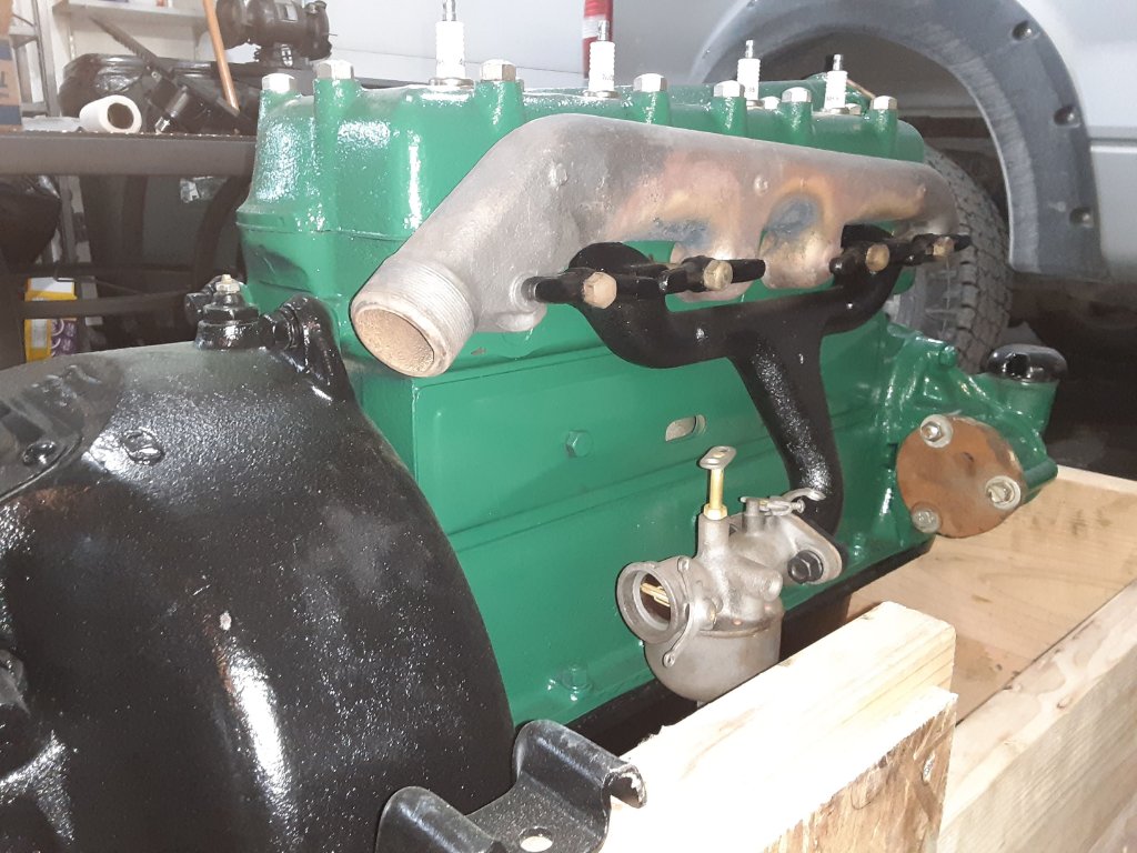

Got the the engine back from the rebuilder yesterday. Used Fastenal for shipping. It was $155 to ship to Ohio and $155 to get back Ames, Iowa. I thought that was very reasonable.
Several photos attached. One with the grandson at the Fastenal store.

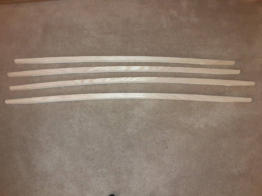

Post by BLB27 » Fri Dec 03, 2021 11:33 pm
New top ribs.

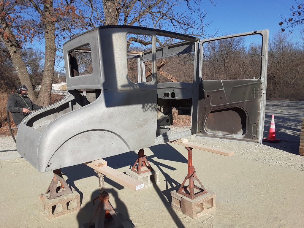

Post by BLB27 » Sat Dec 04, 2021 12:04 am

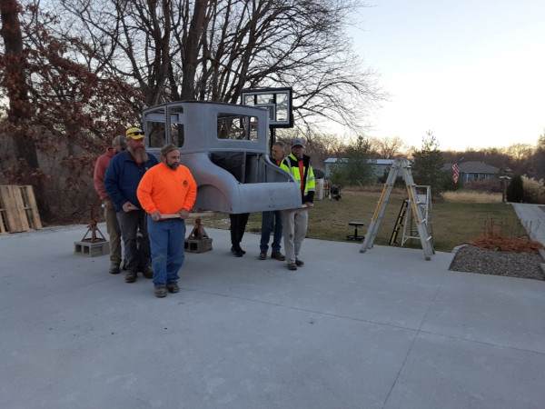

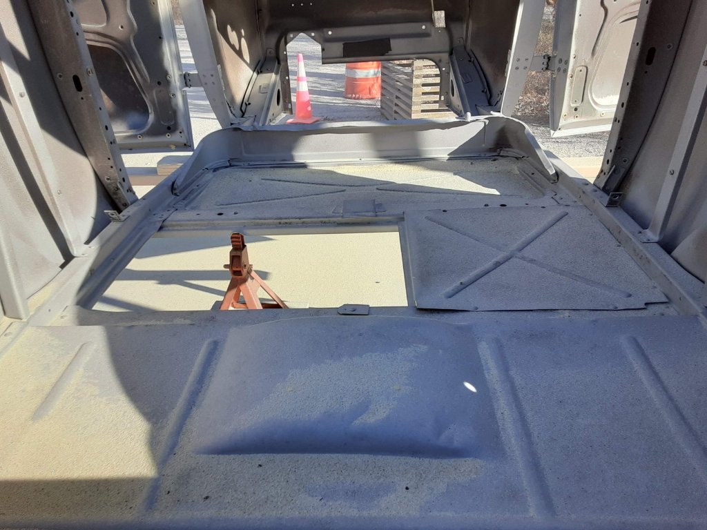

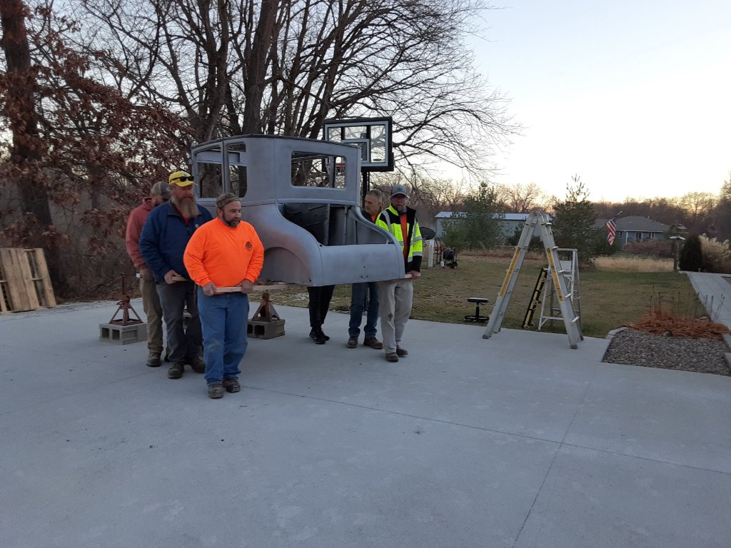

Six guys moving the coupe back into the garage after blast cleaning on 12-1-21. It was a beautiful day, in the 60s!
Used three 2x4s eight feet long.

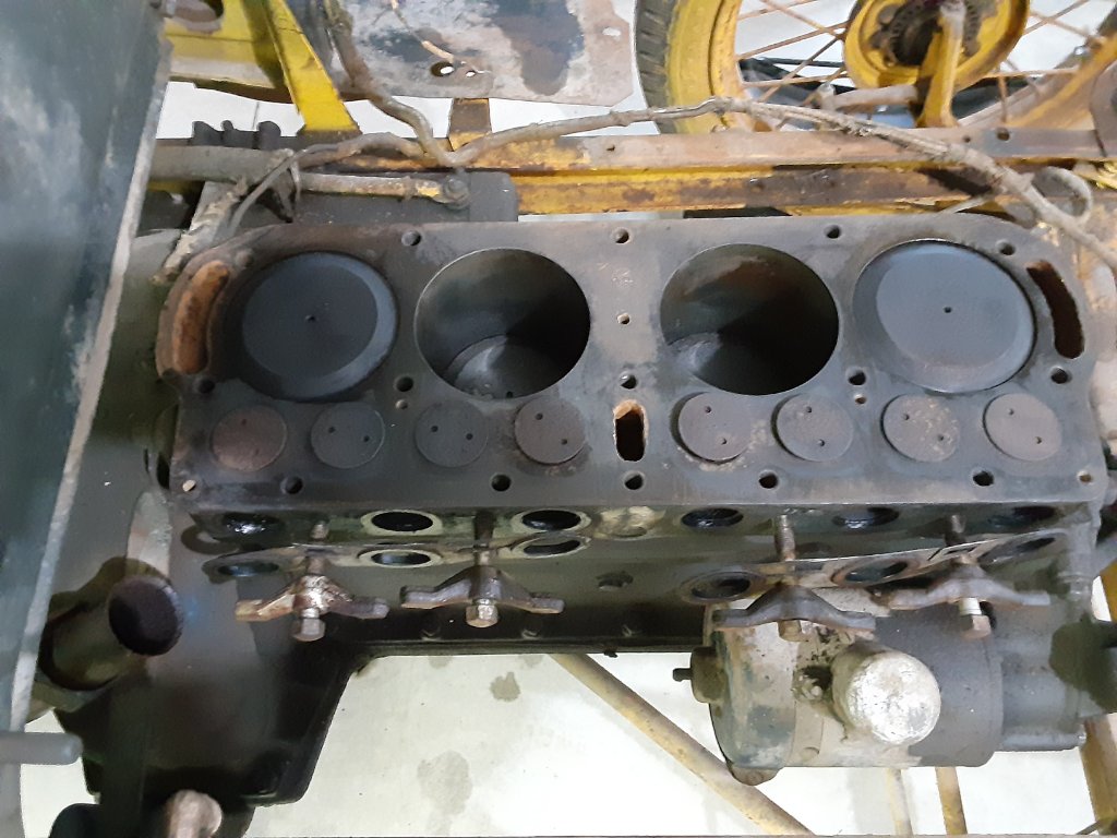

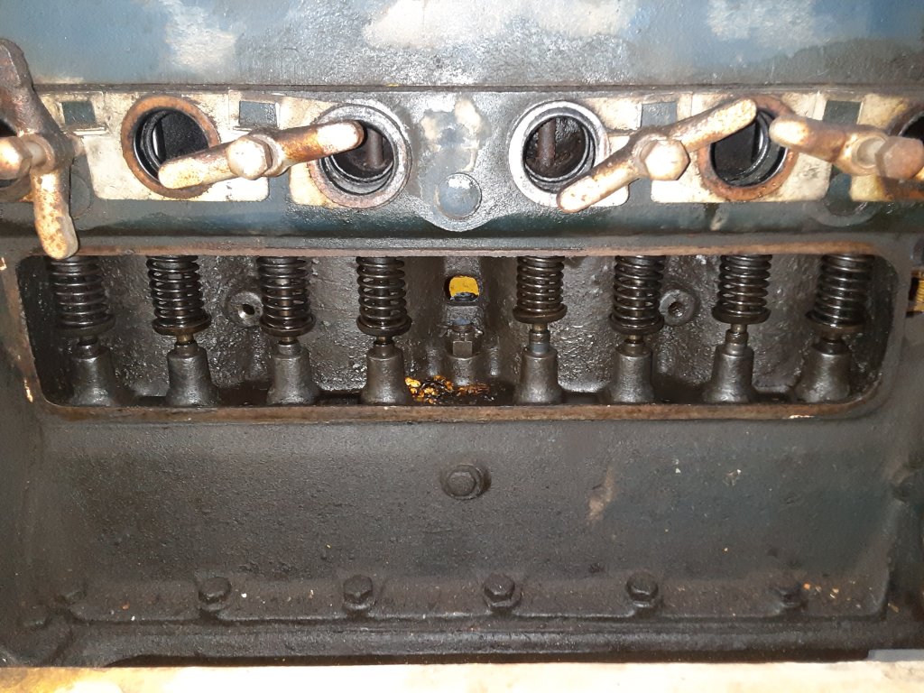

You will probably want to change the needle on the NH carb to the 26/27 type. Do you have the linkage for going over the top or a hole in the block and new arm for the throttle rod? http://www.modeltford.com/item/6213B.aspx
1926 Tudor
BLB27
Posts: 892
First Name: Bruce
Last Name: Brakke
Location: Ames, Iowa
Re: My 1927 Model Coupe
Post by BLB27 » Sun Dec 05, 2021 12:57 pm
John, Yes, I will change the needle, and there is a hole in the block and valve cover as shown in the photo. There already was a hole in the block, and the rebuilder put one in the valve cover.
