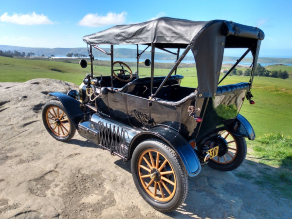

Although installed by Romero last year, my Classtique top seems loose. Can I simply punch new (tighter) holes in the front and back straps to make it tighter? Or, will this common sense approach have unintended consequences?

The rear strap looks very good. If you tighten it, the rear curtain will sag. The front strap determines the distance from the windshield. If you change it, you will pull the second bow forward. Best way to tighten it would be to wait for a very hot day, and park the car out in the sun. Then Go to the rear bow and remove some tacks and pull the material back as far as you can. Might need two people so one can pull back while the other tacks. Be careful to hit the right nail.
This will help. You can also install a snap at the bottom end of the top material at each of the center bows which will help hold the top down in the center of the top. However, you will notice most 2 man tops do appear a bit wrinkled, even in the old pictures when the cars were new.

To me, it looks like your top is missing the pads.
That would cause the sag between the bows as well as the telegraphing of the bow through the top material like a rib on a starving greyhound, most noticeably the third bow in your photo.

I reviewed your picture again and it looks like I can see the outline of the 3rd bow through the top. Do you have the pads installed" With the pads properly installed, you should not see the shape of the bows through the top. Inside the pads should be 3 straps tacked to each bow, and then a layer of cotton which pads everything which are used to keep the entire top aligned. Then over all the top material should be pulled tight on a hot day and tacked to the back and front bows. Lastly the trim strip over the tacks in the front and back bows.

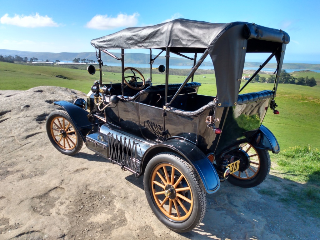

I'm also curious about whether pads are installed (photo 1). My top is not a perfect fit although it looks almost identical to a photo of my grandfather's 1917 Touring (taken in 1918). I also added snaps on the sides to the middle two bows - it doesn't help much with the shape but does keep the edges from flapping in the wind (photo 2). My 1917 uses web straps and I have had to adjust them after having the top up for awhile. Leather straps would be a little more difficult to make "fine" adjustments as you have to use the available holes or add some.
