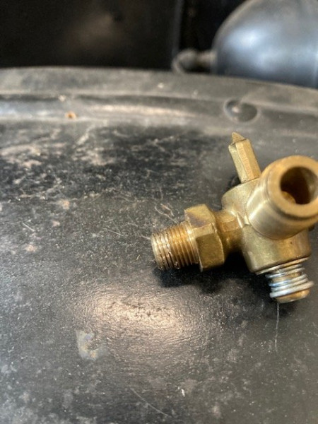

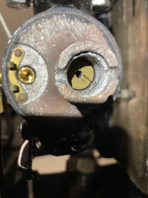

Seat looks clean, see picture. In thinking about this I did recently grease the sediment bulb petcock valve and the carburetor fuel line nut and elbow with fuel-proof grease to stop fuel from seeping. That coincided with this problem. However, I am failing to see how that would be a problem but I have no explanation for the current situation either. Could the grease have traveled and make the fuel valve stick open somehow? I could try a Q-tip on the valve bore.

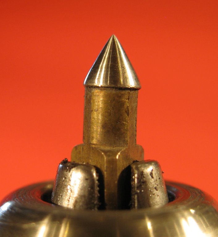

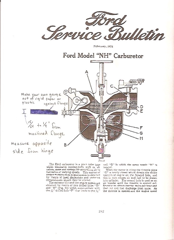

Use some carb cleaner or lacquer thinner, avoid cotton swab due to cotton particles. As posted, a speck of trash, including a dab of gas resistance grease, can stick the needle.
If a Vitron tipped needle, look for white residue around the cone that sets in the seat. That is residue from gas sitting ther, can stick a needle shut, esp. with ethanol in the gas.
Sometimes the brass hinge pin can hang up, after adj. the float to 15/64" so be sure the float can move freely. But not too freely , side to side, as the float can hit the side of the bowl.
Check the float isn't compromised with a leak.
Using the Service Manual method of inverting the carb, allows float to hit the needle, and test with suction from the mouth. Light suction and a well seated needle will stick your tongue to the elbow. When you turn the carb over, the float falls free, and suction won't stick your tongue to the elbow. Of course, carb should be dry for this final test of float adjustment :D

I've had Viton tips stick, but the trouble from that was fuel starvation, not flooding. I was lucky enough to get a few original needles in some auction plunder.
You can resurface a needle by putting it in a drill chuck and turning it against a fine sharpening stone. If I needed a new needle I would get one from Scott Conger.

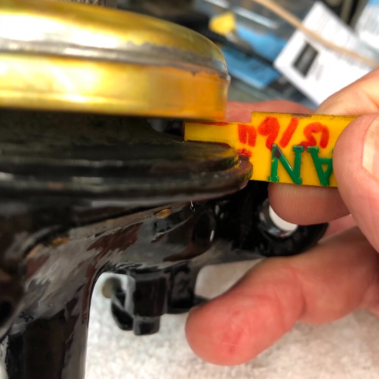

Post by jiminbartow » Tue Mar 16, 2021 2:26 am
Dan, it looks like your gauge is upside down. Square side should seat against the flange and round side should face the float. The way you have it, there appears to be a gap under the gage on the flange side, which will make the gap wider than 15/64. Jim Patrick

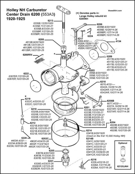

Ignacio. See Dan Treace’s March 14, 4:18 pm post, figure 440. It was a common method found in the Model T Ford Service Manual that Ford recommended mechanics use to test the integrity of the needle valve. The suction should be so good that it will hold your tongue to the fitting. I agree John. The problem is most likely in the needle and/or the seat. Jim Patrick

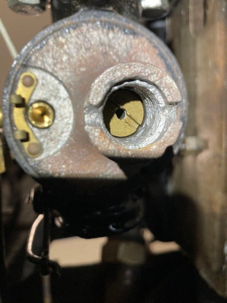

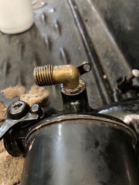

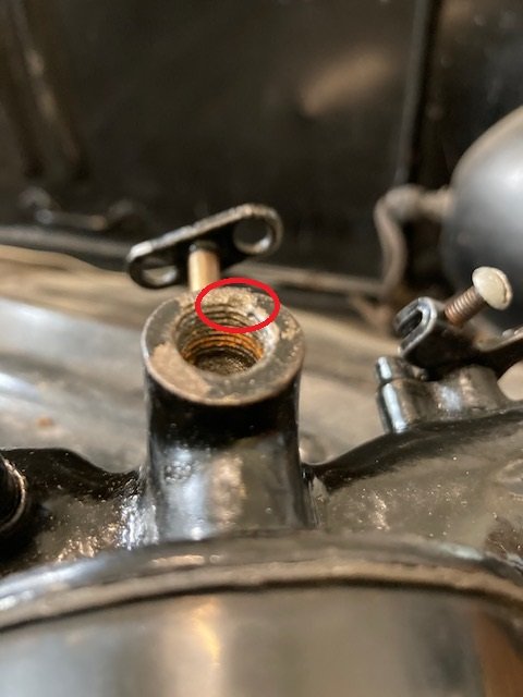

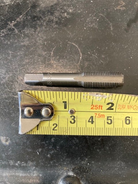

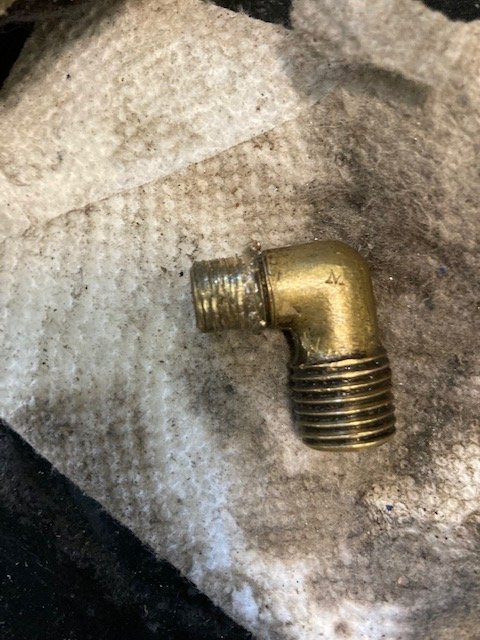

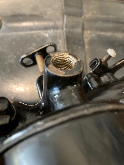

Post by ivaldes1 » Sat Apr 17, 2021 7:00 pm

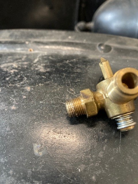

I did the suck test. It is leaking at the elbow threads. I noticed when tightening the elbow more that the elbow threads are stripping. See picture, there is a dent in the threads at the entrance that is almost certainly stripping this out. I think the way to fix this is with a tap to realign the thread? Is there another way? Unfortunately my tap and die set doesn't seem to have the size this is. I think it is 24 pitch but unknown size.

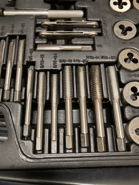

Post by speedytinc » Sat Apr 17, 2021 7:08 pm
thread is 1/8 npt. Taper pipe thread. Most sets have this tap. Being taperd, dont go to deep on the thread chase. Elbow thread looks stripped, needs replacing. Permatex aviaton or similar fuel resistant sealant works well.

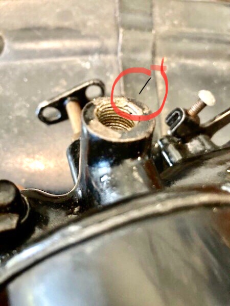

Post by JTT3 » Sat Apr 17, 2021 10:37 pm
Ignacio I enlarged the picture and it appears by way over tightening it you may have cracked the the carburetor where it threads which you may never be able to repair. Don’t ask me how I know. The thread inside are tapered and the elbow will most always will have threads exposed. Trying to get the threads of the elbow even with the carb is instant trouble. If you look closely and there is no crack you’re lucky and may be able to clean it up with a tapered tap. If not order a new elbow and perhaps a rebuilt carb unless you have one to that you can rebuild yourself. You might contact Corey Walker he rebuilds carbs for sale.
Good luck, John

Post by ivaldes1 » Sun Apr 18, 2021 12:04 am
As far as I can tell it isn't cracked, just the thread is damaged. My tap set doesn't seem to have a 1/8 npt. It has a bunch of other sizes. Home Depot and Walmart seem to have them 1/8 27 npt? Is that the right one? Mail order for about $9.

Post by kmatt2 » Sun Apr 18, 2021 1:52 am
You should be able to buy a 1/8 npt tap locally. Your old elbow to carb threads are shot. The new elbow will have to come from a T parts vendor if you don't have another good elbow. Use some gas proof permatex on the threads. You may want to get from the T parts vendor a elbow with shut off to keep from having to crawl under car to use the stock gas shutoff.

Post by Allan » Sun Apr 18, 2021 6:29 am
Having to re-tap the thread in the carb body may be a blessing. Just clean it up first and fit the new elbow. If you have thread still showing, but the elbow is not pointing in the right direction, you can re-run the tap to let the elbow run in a little futher. It may take a few tries to get it to pint to the rear as it should.

Post by TFan » Sun Apr 18, 2021 8:51 am
Ignacio, That tap set you are showing in your pic looks to have an 1/8 tap just below the thread check gage three down from the tap handle. That is more than likely the pipe tap. Hope this helps and good luck. Jim
ivaldes1
Posts: 960
First Name: Ignacio
Last Name: Valdes
Location: Houston, Tx
Re: Bad carb float again?
Post by ivaldes1 » Sun Apr 18, 2021 12:43 pm
Good eye Jim on the 1/8 if it was a snake it would have bit me!

Post by ivaldes1 » Sun Apr 18, 2021 1:28 pm
So I ran the tap through and it straightened it up some. However, it still has a little spur on it that seems perfectly placed to shred the threads on a new fuel valve I happened to have. It seems to shred it less but you can see the ribbons of brass on it. I am not sure what to do next.

Post by speedytinc » Sun Apr 18, 2021 1:39 pm
Possibly your tap bottomed out before you got the thread totally cleaned. Thats a feel thing. If thats the case, you can grind a little off the tap.

Post by kmatt2 » Sun Apr 18, 2021 2:01 pm
If the modified tap doesn't work you can carefully remove the frist one or two threads in that area. Try using a deburing bit in your dremel and just slightly touch the thread.

Post by RajoRacer » Sun Apr 18, 2021 2:27 pm
It appears the threads are already "buggered" up on your new shut-off as if it was cross-threaded. That type of valve is known for opening/closing issues after not too long of usage - Lang's has a very nice one but you get what you pay for !

Post by ivaldes1 » Sun Apr 18, 2021 4:44 pm
The tap did bottom out. How much should I take off of the tap? The Dremel option sounds attractive.

Post by speedytinc » Sun Apr 18, 2021 5:23 pm
Just enough. start with that area where there are no threads. Remember it is tapered. go in only enough to clean the thread. You may have a 1/8 pipe die in your set. Kiss the elbow thread just enough to clean its thread also.

Post by Allan » Sun Apr 18, 2021 7:43 pm
The tap in the photo does not look tapered to my eye, which begs a question. The thread on the fuel tap is tapered, so it would bind on the thread in the carb even if the carb thread was straight, but the engagement would be narrow. If the thread in the carb was also tapered, the engagement would be made through the length of the thread, making a better seal. Does anyone else see a straight tap in the photo? If it is straight, grinding some off the end would be fruitless.

Post by henryford2 » Sun Apr 18, 2021 7:59 pm
For what it's worth the tap appears to be a BSP rather than a NPT. NPT/NPS and BSP threads are not compatible due to the differences in their thread forms, and not just the fact that most diametrical sizes have a different pitch. NPT/NPS threads have a 60° included angle and have flattened peaks and valleys (this is a Sellers thread form); BSP threads have a 55° included angle and have rounded peaks and valleys (this is a Whitworth thread form). Just my humble opinion. Enjoy
Post by ivaldes1 » Sun Apr 18, 2021 8:09 pm
Success! I Dremeled out the burr with a fine diamond tip. The burr turned out to be a sizable bump. It stopped shredding my elbow/valve thread. Suck test -- leak. Put some fuel resistant grease on the threads, suck test -- it held! Put the carb back on took it for a spin and let it sit for about an hour with the fuel valves on -- dry! Alright! let the fun begin. Thanks to all!
