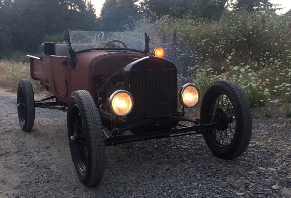

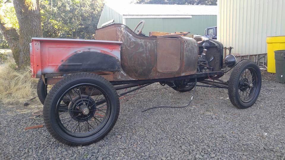

Well finally got my new shop leak free. Rich and I brought Nuthin’ Special back to its new home. Now Carston, Rich and I can get it ready to tour this season. We are talking about doing a run up to Timberline lodge on Mount Hood this summer.

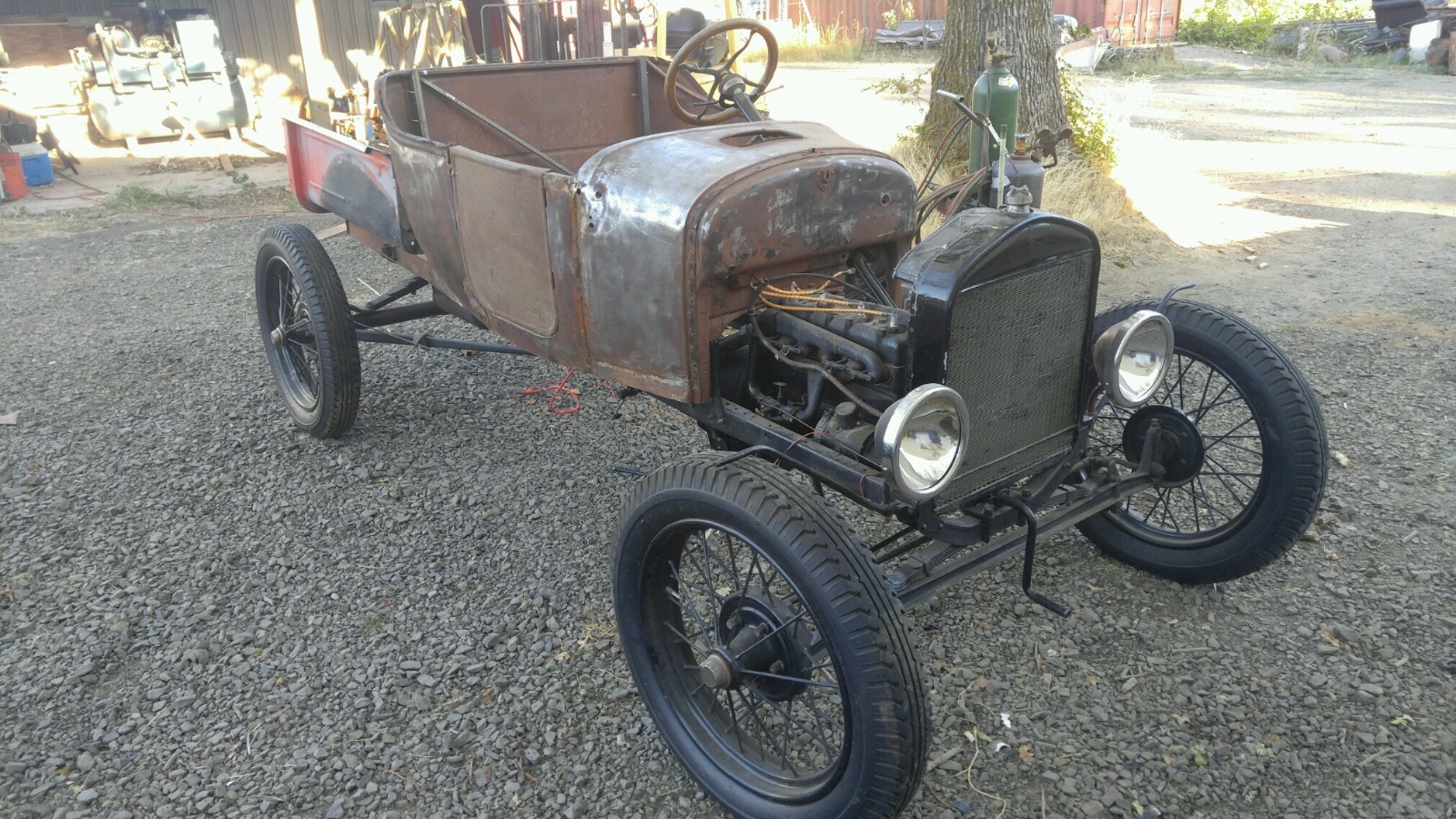

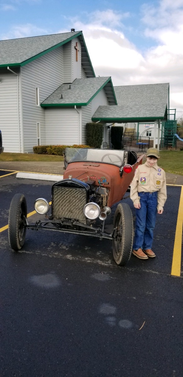

so we took nuthin’ Special to the pinewood derby today. Found out I have a warped exhaust manifold. No matter how I put it on it would not line up. Anyone have a good straight exaust manifold?

Good to see you're getting your shop up to task and to see Nuthin' Special out and about!
That last pic: A boy and his T.

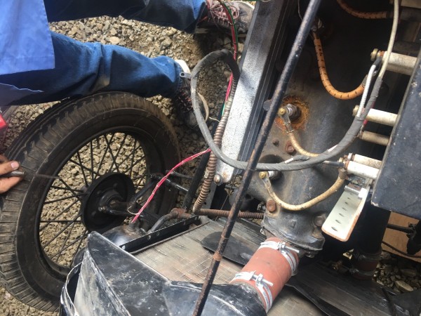

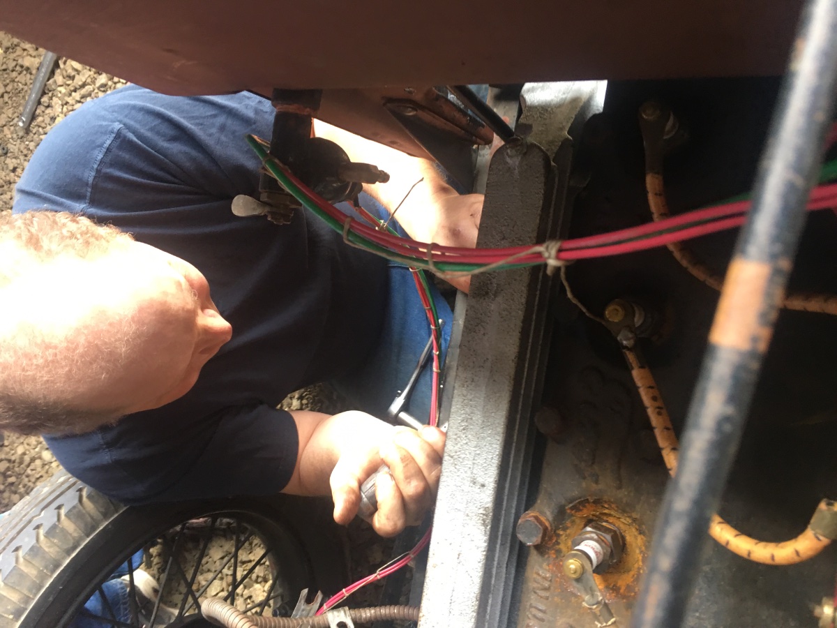

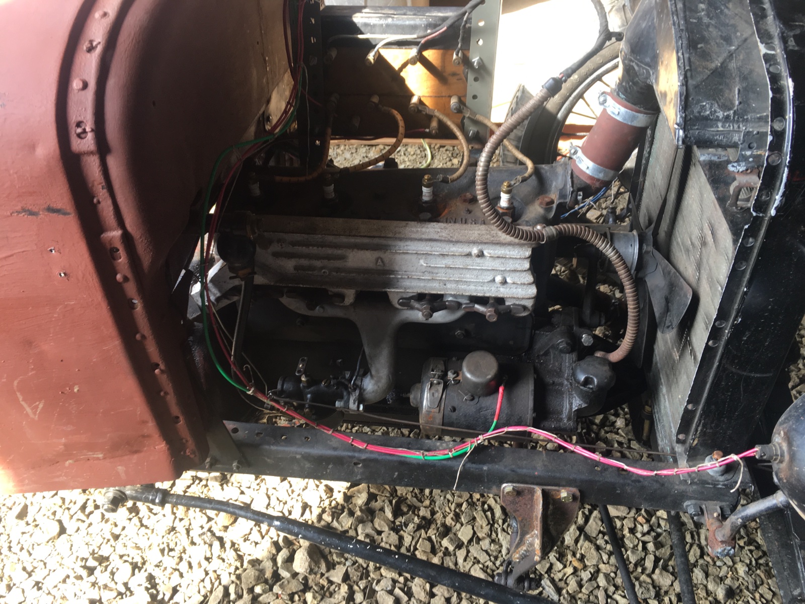

Got together with Tim, Rich, Carston and myself got together and installed the new to us exhaust manifold and a high flow intake. Runs much better now thanks for the help gentlemen.

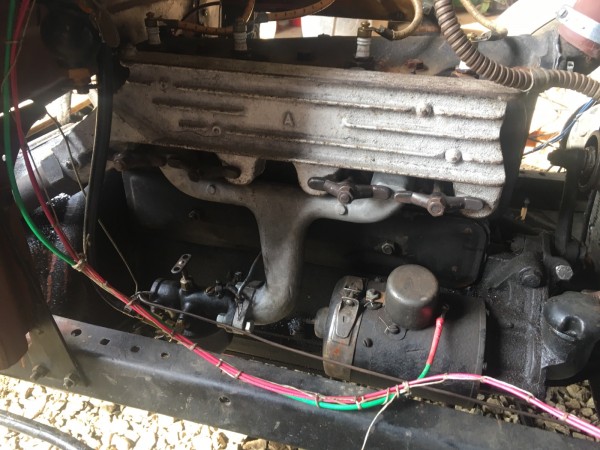

Those are sprint car seats in my speedster. They speedway motor. They do make snap in upholstery for them also.

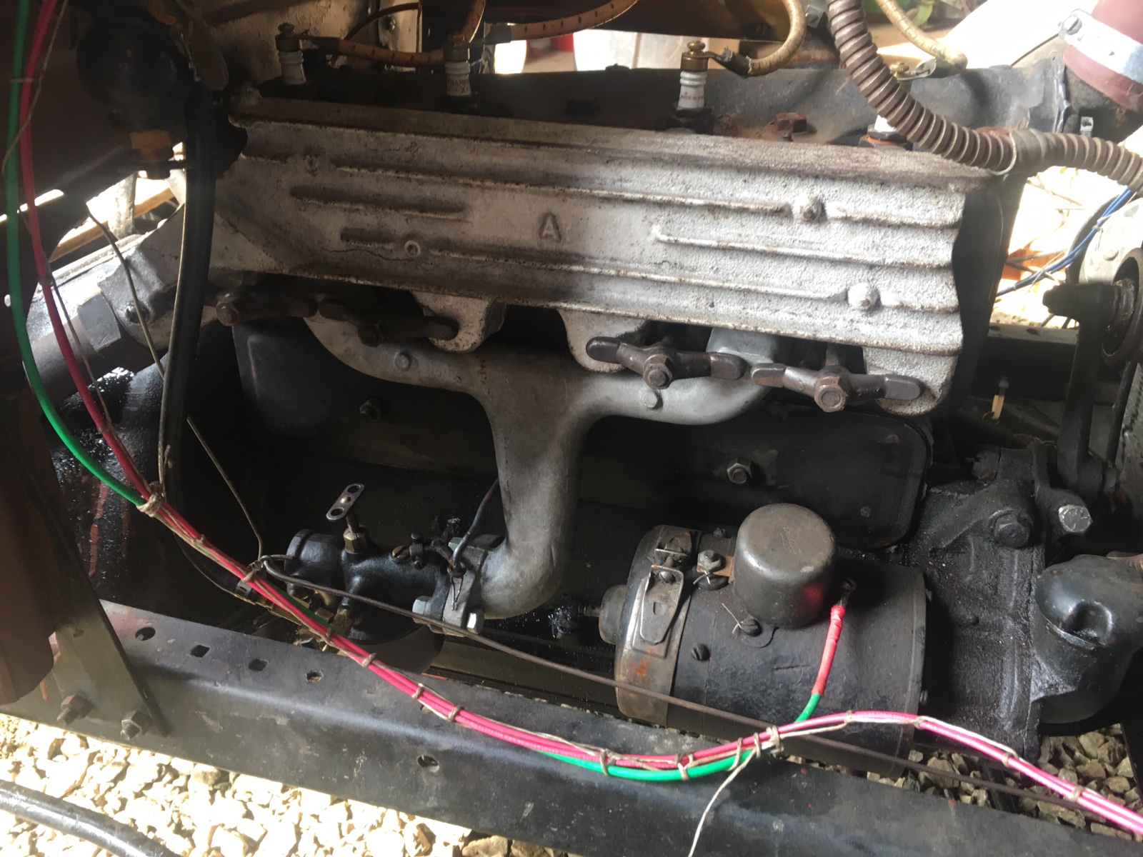

The intake and exhaust manifolds came out good yesterday on nuthin special.

hey guys, That's one racy looking manifold ... :) :) ... glad it worked out for ya'll (Im from Arkansas so ya'll is a correct term for me to use ) ... post some pics of ya'll out driving .... Donnie ....

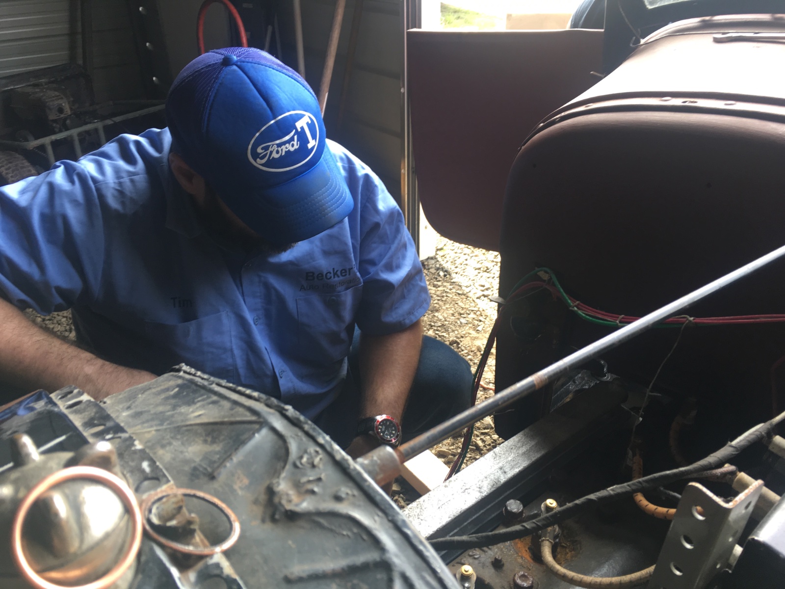

Is the big cable coming from the timer a mechanical tachometer ?
Powerwagonmaniac1
Posts: 84
Joined: Sat Jan 12, 2019 11:48 pm
First Name: Chris
Last Name: Becker
* REQUIRED* Type and Year of Model Ts owned: 1919 touring, 1917 speedster, 1925 give or take roadster pickup
Location: Portland oregon
Re: Pulled Nuthin’ Special out
Post by Powerwagonmaniac1 » Sun Mar 24, 2019 11:22 pm
I wish that was a mechanical tachometer... it’s actually thewires coming to the coil from a aftermarket timer similar to a new day timer. Carston and I worked on tying the wiring harness up some more. Tired of it being in the way. Need to lengthen a few wires toget it totuckunder the dash better. A friend of ours is going to help us make a nice set of floor boards. Took Nuthin’ Special for a drive today & topped out a 47 mph...!! Thanks Donnie Brown and Clayton Paddison for the cool exhaust manifold And the High flow intake manifold. Donnie as soon as we can get sometime when we are not so freakin’ busy I will post some driving pictures. Hopefully with Rich, Tim,and Clayton joining along in the fun!

Last time Rich and I worked on it we did a compression check. We found 1,2, & 4 were consistent but #3 was considerably lower. Put some oil in and did a wet check on 3 and it was about the same as the others, compression wise. We are thinking it needs a ring job. Are there oversized rings out there for .005 oversized cast iron pistons?
