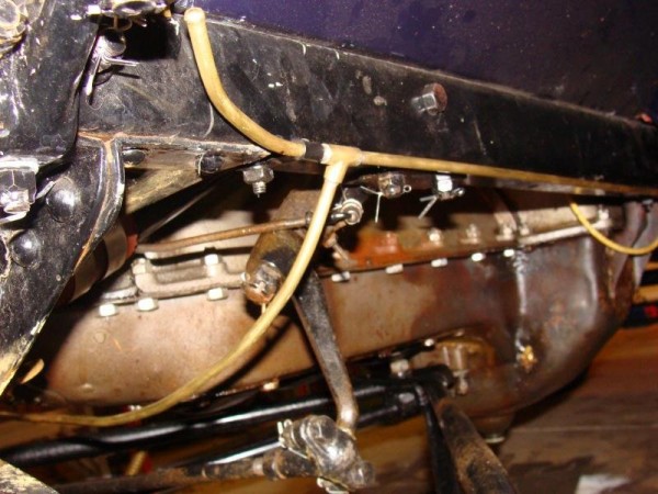

First, I will state that I do not know. The picture below does not show that detail.
One can see that the line does sit inside the frame as it runs forward from its clamp, but the area of the wood block is not in the photograph.
This pictures suggests that the gas line is routed between (or UNDER ???) the wood block and the frame.
Not knowing the sequence of assembly at the plant, we can only guess (using Good Manufacturing Process) WHEN something as long and fragile as the gas headlamp line was installed on the chassis, after the engine but before the steering column? Who knows. Early cars, without the holes in the radiator for the gas hose, apparently had the gas line run below the frame, as shown in these pictures.
What year are you working on, Larry? Your '13? Good luck with your project, Bill

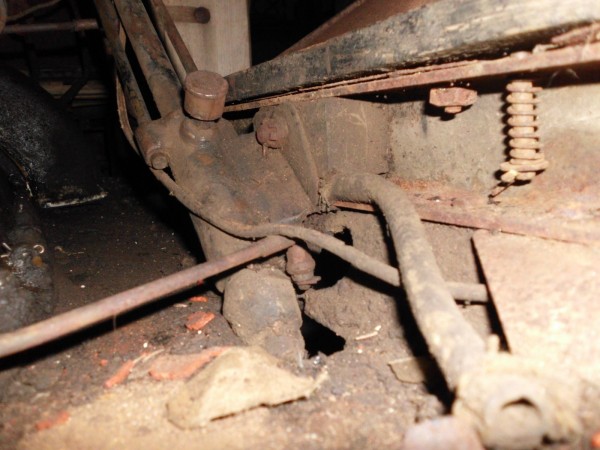

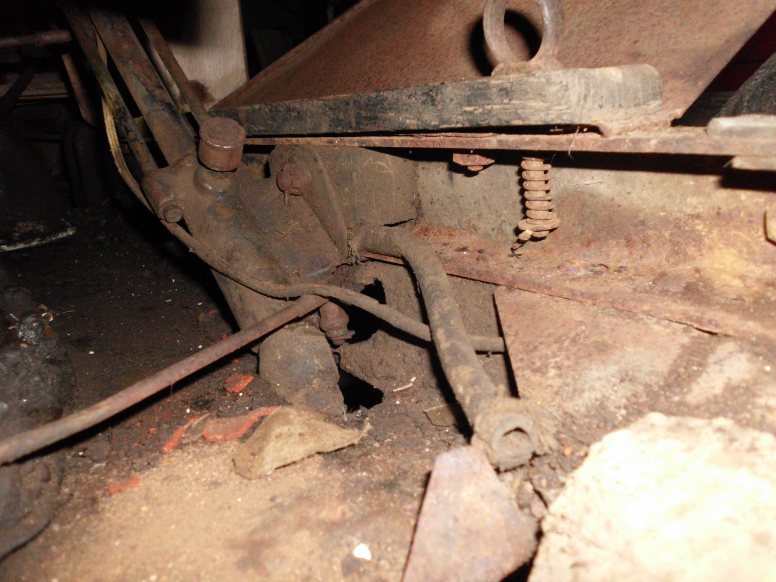

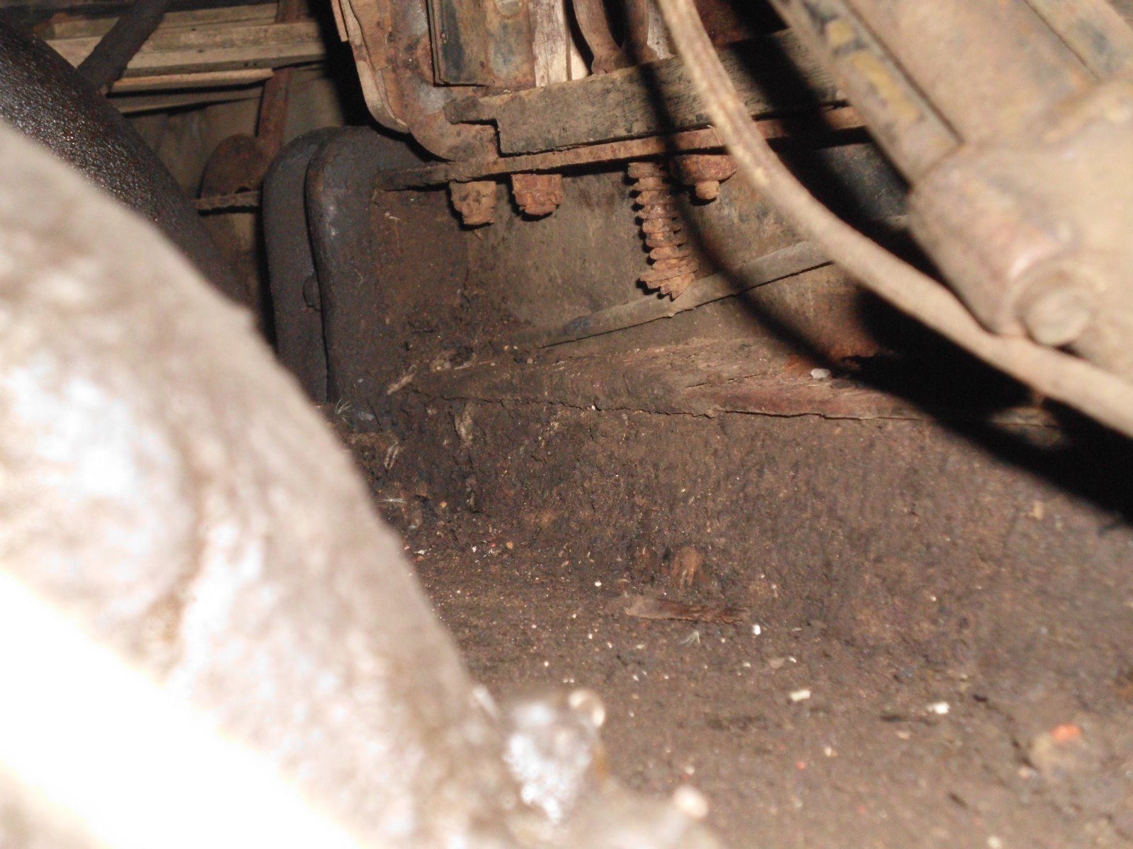

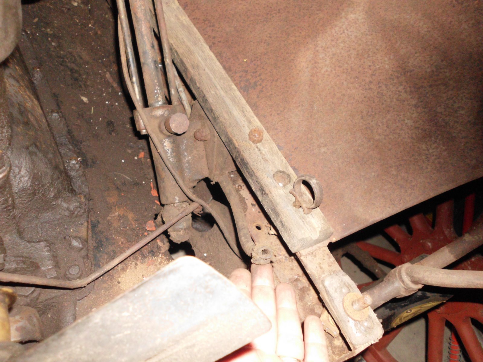

Hi Larry,
Here are some pictures of my unrestored 13 Touring showing the gas line for the headlights running under the wood block at the rear engine mount.
Then it runs under the wood block for the steering mount.
Hope this helps.

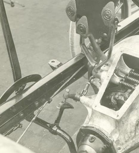

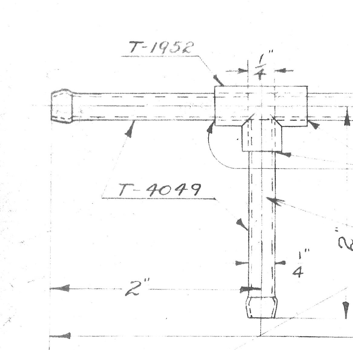

Does the print show the gas line as straight up by the radiator, or a curve, as Bob's shows?
So are there then three short lengths of rubber hose, one going to the bottom of the cross over tube T, than two other that go to each headlamp?
I look forward to seeing pictures.

Thanks for the photos! I think someone has altered the gas line in these photos. I just need to know if the gas line runs along the inside of the frame right up against the rail, or does it start tapering inside, but still next to the two steering column bolts? This is about as trivia as it gets, but that is what I like! That line can actually be on either side of the two bracket bolts, but still be inside the frame.

The last two photos Bob posted are what I was after. It clearly shows the tubing going on the right side of the two steering column bolts, but still under the wood block. Actually, it makes more sense to do it this way, because the tubing will line up better with the Tee on the radiator.

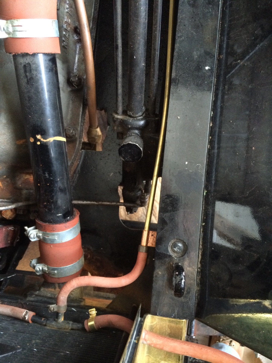

I had my local radiator shop attach the new gas line to the radiator. I made the radiator gas line, and the frame gas line according to the original Ford prints for '13 and '14. Yes, the original material was brass, and in 1913 they specified tin plated, AND, they double flared the ends of the pipes for a total five flares. Prior to 1912 there were no flares, and no tin plating. I couldn't find a plater in my area that would do tin for a reasonable price, so I had it cad plated instead. I just wasn't up to spending $150 to tin plate those tubes! Judging from the most recent photos of the original untouched '13, I'm going to route my frame tube along the right hand side of the two bolt heads, and the steering support bracket. Unfortunately at this point there is NO correct red tubing for Model T's, which require 7/16". I spoke with Ron Gocek at Hershey last year and mentioned that he had it made the wrong size last time, 5/8". That just won't do! The hole in the splash shield is 7/16" which is what Ford specified. 1/2" will fit through the radiator holes, but not real well through the splash shield. Ron is aware of the problem, and I hope he will solve the problem for us soon. Enough raging for now.

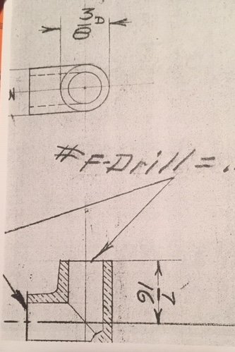

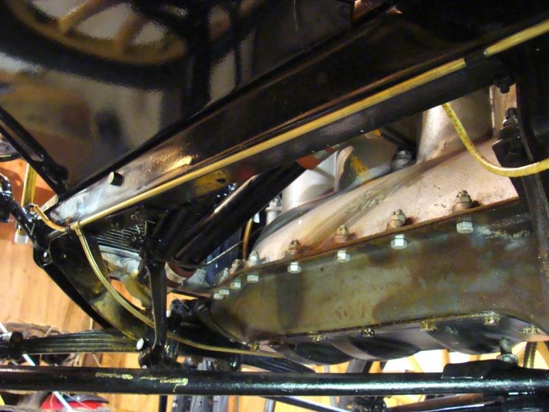

A number of years ago I made a new 44" long "gas lamp tube assembly, rear" used on our T's from July 1912 until the end of gas head lamps. If your 1912 radiator had gas tube holes in the side panels and a cross-over, you had the rear gas tube Larry started this thread about. For mid-1912 thru 1914 gas lamps, it is the only metal part we can make unless you remake the radiator cross-over.
The "flares" on the two ends of the rear gas line look like the detail that R.V. posted of the 1/4" OD tube cross-over on the radiator (below).
I used K&S Metals 1/4" OD tube from the hardware store. It and the 9/32" tube I made the sleeves from is 260 and if I made another one, that is what I would use.
I use a Prest-O-Lite tank because I drive the car at night and can light up in less than two minutes. Drove the 1914 to the barber shop Saturday morning at 5:30a.m. If you use a POL tank and "crack" the valve, I would suggest leaving off a rubber tube clamp at one of the elbows or tank.
Also, the NOS Colt burners & inside screens, Victor stands and elbows are brass on my setup too. I'd be between a rock and a hard place for gas lamps if I didn't use brass.

I don't know when they went to the 1913-14 system, but guessing I'd sometime in late '12. The original print listed above shows the new design, with, the double flares used in '13 & '14. I bought my brass tubing from McMaster Carr, and it arrived the next day in a nice stiff tube. There was enough for the frame, and radiator gas lines with some left over. I bought the 6' length. I have it almost done, except I now need to get some work done on the radiator, which wasn't soldered very well on the drivers side.
The red tubing is the issue now. It is NOT made to Ford specifications, and will not work for a '13-14 because it is 5/8"dia. I suppose it will work for a pre 1912, but maybe not. The hole in the splash shield for my '13 is 7/16", and a 5/8 tube won't fit!
Ron Gocek is aware of the issue, but when he will get around to correct the problem is anyone's guess.

OK. Does anyone know how I can see a copy of the original print?

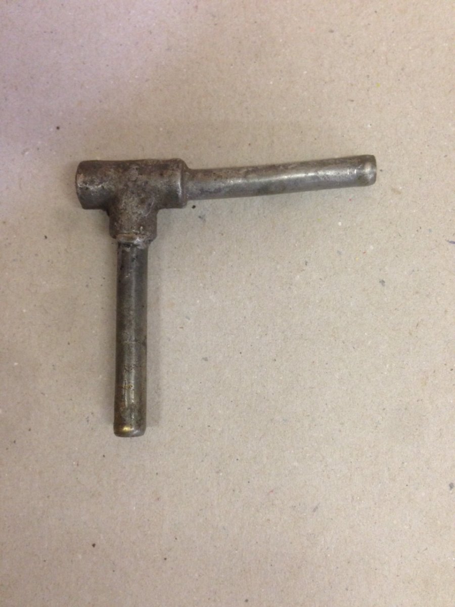

Here is the original plated tee Larry referred to.
Rich C.
Posts: 3954
Location: Lomita, California
Re: Headlight Gas Line Routing
Post by Original Smith » Thu Mar 21, 2019 9:26 am
Thanks for posting Rich. These photos are important, and yes that is the Tee we are planning to make. The O.D. of that Tee is 3/8, and of course, the I.D. is 1/4.

I recently made two complete gas light BRASS tubing assemblies for my 1913's. They were originally tin plated, but I couldn't find a tin plating shop at a realistic price, so I had them cad plated. Can't tell the difference. A few weeks ago I acquired an original '14, with all the original piping, including the red hose. It verifies everything I did on my 1913's.
