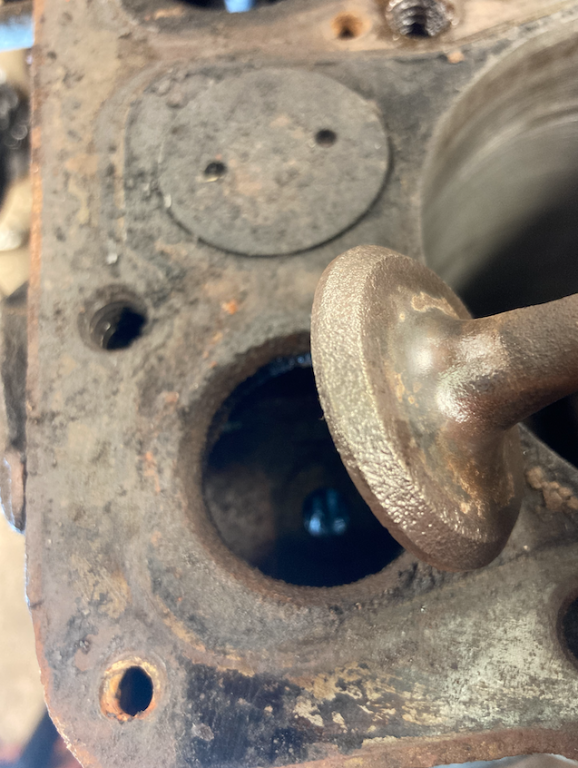

My T sat for a while, and at least one of the valve seats got rusty and pitted. I have all new valves coming, and i'd like to clean up the seats also. I see various valve seat cutters on eBay used for under $100, but I'm leery. I don't want to spend $350 on a Neway tool that I'll probably never use again. Who can help me out?

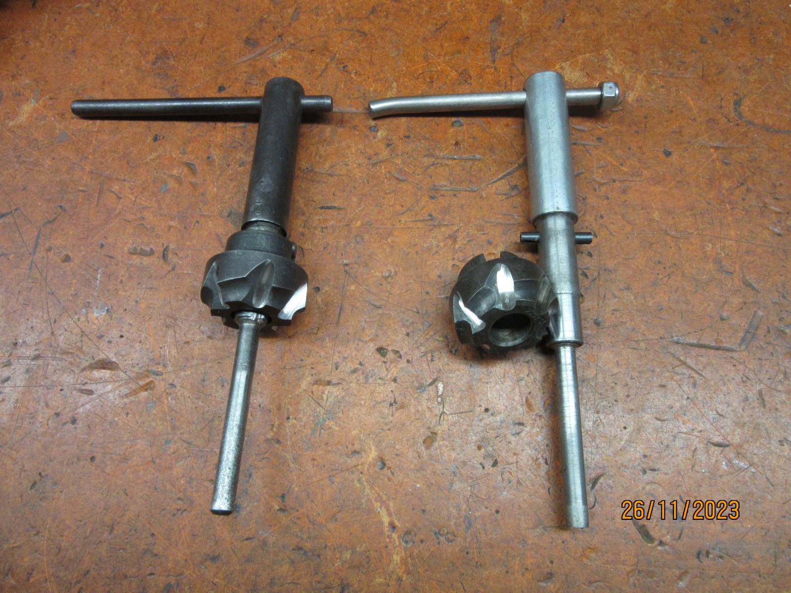

I have lots of used valve seat cutters. They all have one thing in common: they're dull and very hard to get a good result. My advice, either pay to have someone do it right, or buy a new, high quality cutter and do it yourself. If you plan to only use it once, then resell it when you're done. How much is your time & frustration worth when you've spent $100 and the job doesn't last long or work well.
And, BTW, you've got lots of reaming to do in order to clean those seats up! A used, dull reamer will be something like torture by the time you're done.

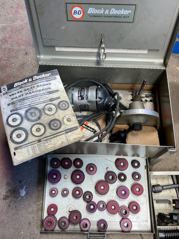

I had forgotten that I acquired this machine last year from a friend. Do I need three angles, or is 45 sufficient?

Your grinder will do the 3 angles. I see a diamond dresser unit in the box. 3 angles will give you a defined width which has a concentric (top and bottom) seating area. So if the valve turns it will still be seating on a clean seat. The width and location of the seat is important too. Cast iron grinds fast, so short bursts and check often. Dress the wheels often as well.

My grinder only has 45 and 30 degree stones, so a two angle valve job it is.
- Posts: 5128
Re: Valve seats

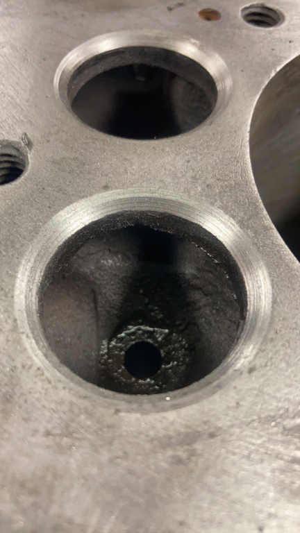

Your set has a stone resurfacer. It can be set for 60 degrees. Seat shown looks good, but is way to wide for reasons already mentioned.
You are 90% to doing the job right.

Need to see what the contact on the valve looks like. You have plenty of stones that can be dressed to the desired angle. The current contact width is too wide .

Here's a bit more. Just kiss with the 60. Fine lap Valve & seat. Note lap line on valve. Should be too wide. Contact should be higher than center. On the upper half of valve, but not to top edge.
Intake contact area should be .060". Exhaust .080-.090".
You move(narrow) the contact area by grinding with the 30 or 60 degree stone.
If contact area extends low, narrow with the 60 degree. If high, narrow by 30 degree stone.
Remove very little at a time. Especially with the 60 degree stone, removes a lot of material quickley.
You can mute the lap line on the valve with a light touch of a fine wire wheel.
Do your finish lap. looking for consistent(even) contact & proper contact width on seat & valve.

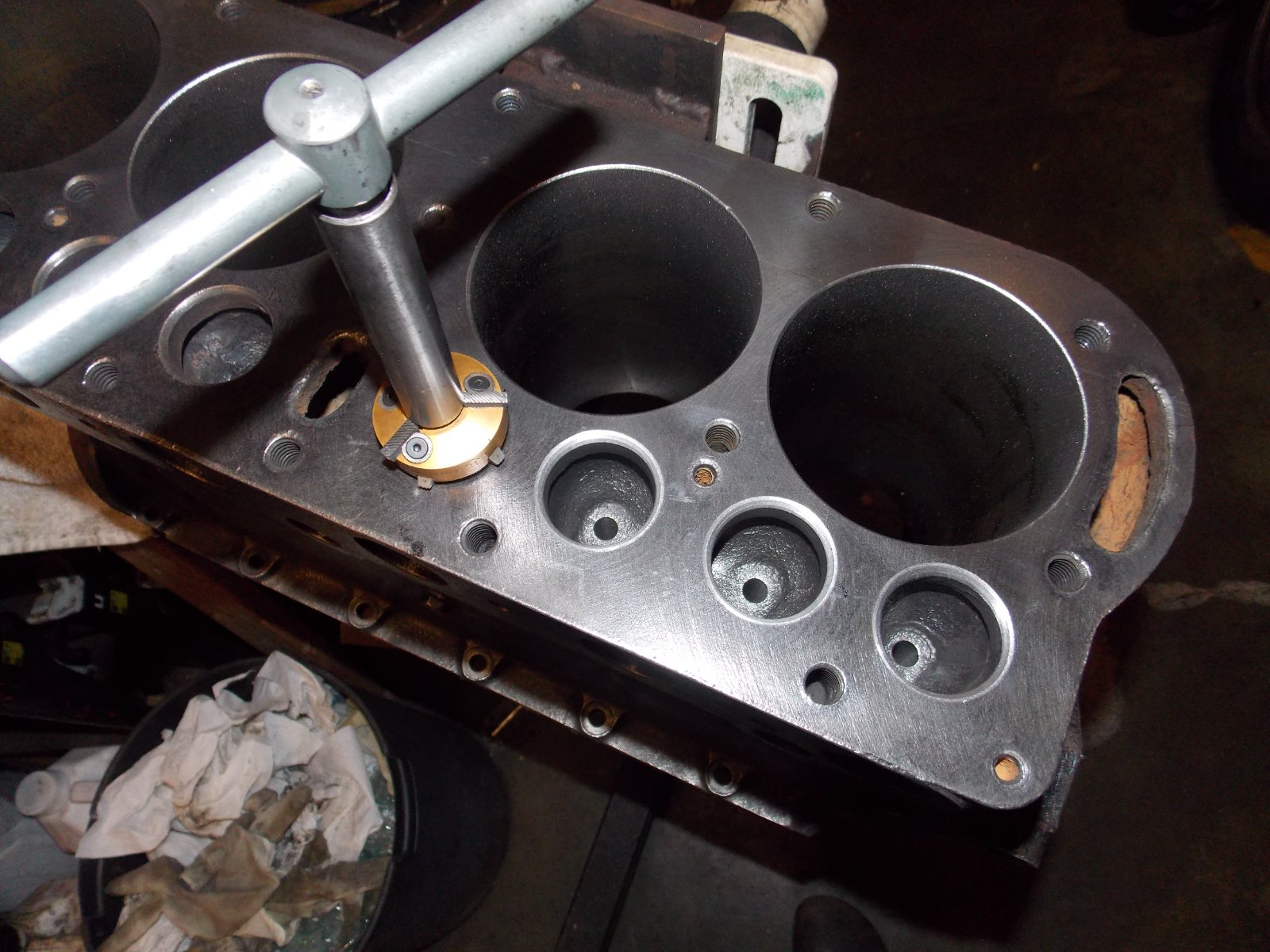

I realize that this is an old thread, but I am about to cut valve seats and I'm doing research. I bought a guide reamer, Neway 30, 45 & 60 degree cutters, solid pilots and I am in the process of making a reaming guide block to hold the reamer in proper alignment. I was having difficulty determining what is a preferred valve seat width.speedytinc wrote: ↑Tue Mar 30, 2021 12:20 pmGREAT. You have restored my faith.

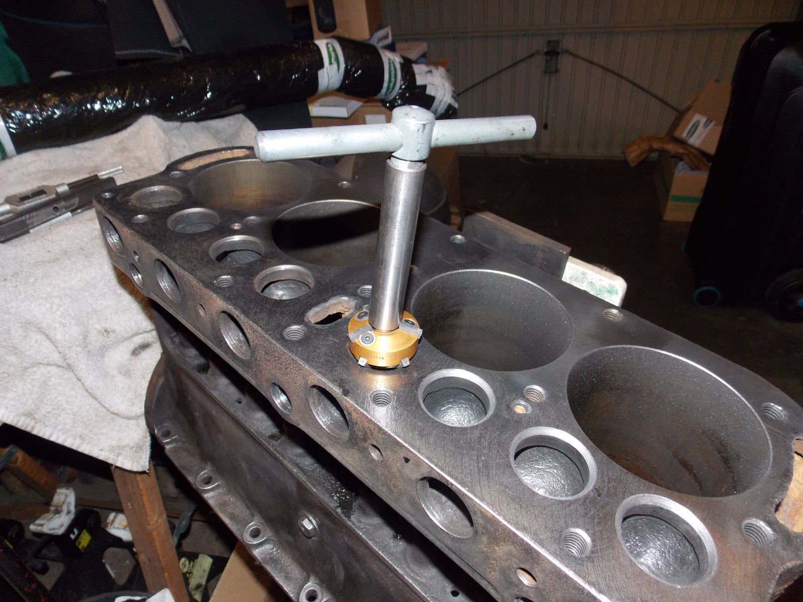

Re: Valve seats
I use the Newark tools to make the seats right.
They are easy to use and make the job right.
Three angles : 45° for te seat; 15° for the top and 60° to finish the job.
Good luck
Andre
Belgium

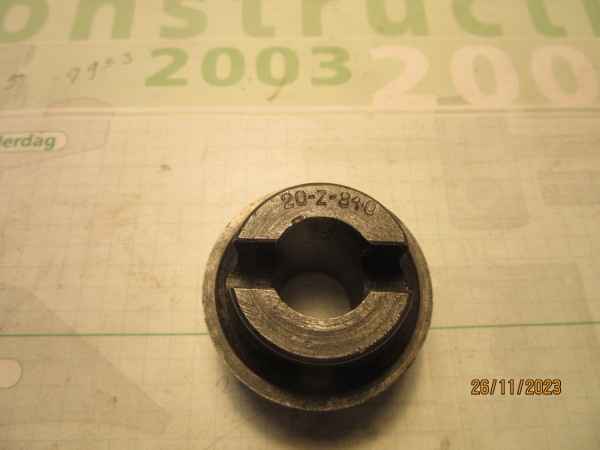

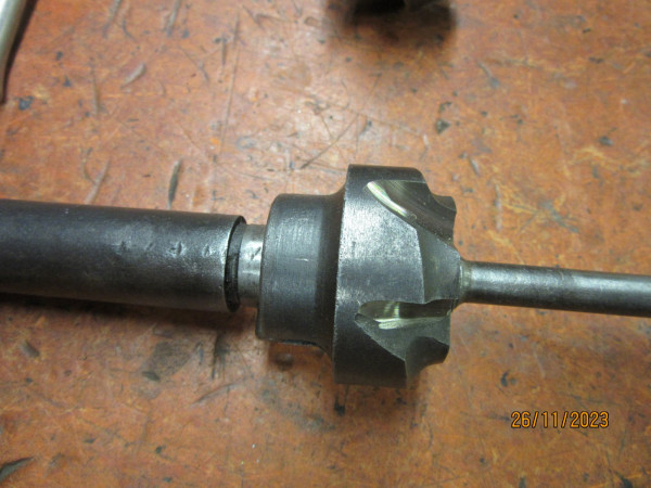

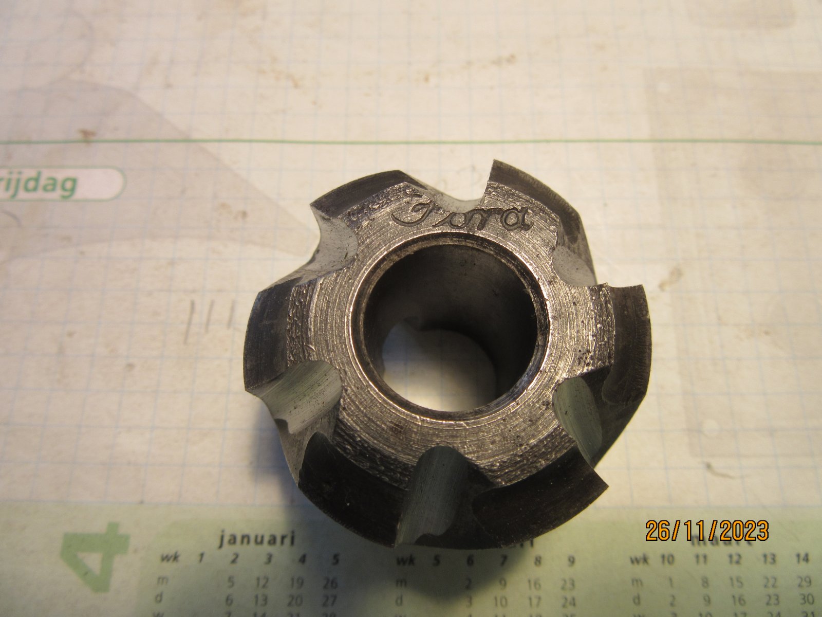

Re: Valve seats
HI ; do one of you us this Ford Tool # 20-Z-340 .
Toon
Toon

Re: Valve seats
Rounded valve seat cutter! First one I have seen. Really neat.
