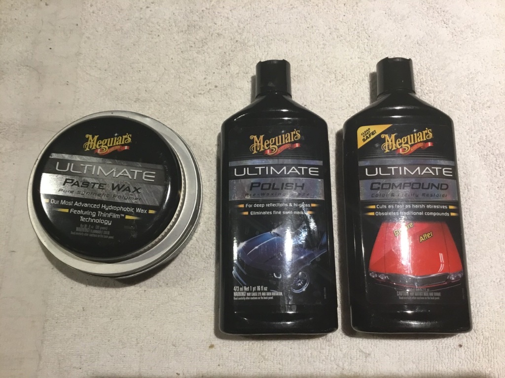

Brass is a very soft metal. Never, ever use any type of wire brush on brass unless you want a permanently scratched surface that will never polish to a mirror finish. Use a small soft paint brush and dab the corners and hard to get to places with lacquer thinner to soften and remove old hardened polish. If your friend used clear lacquer to seal the polished brass from tarnishing, the lacquer thinner will remove the clear lacquer, enabling you to repolish to a mirror shine, then reseal with a new coat of good quality clear lacquer. A poor quality clear lacquer will leave a foggy finish,concealing the beauty of the shine. When I polish any type of metal, I prefer Meguiars Ultimate Compound. To me, it is much less abrasive than Brasso or any type of metal polish. Maguiars also has a polish that is even less abrasive. A good paste wax should slow down the tarnishing process while not obscuring the mirrored surface and allowing the full shine to come through. Jim Patrick
