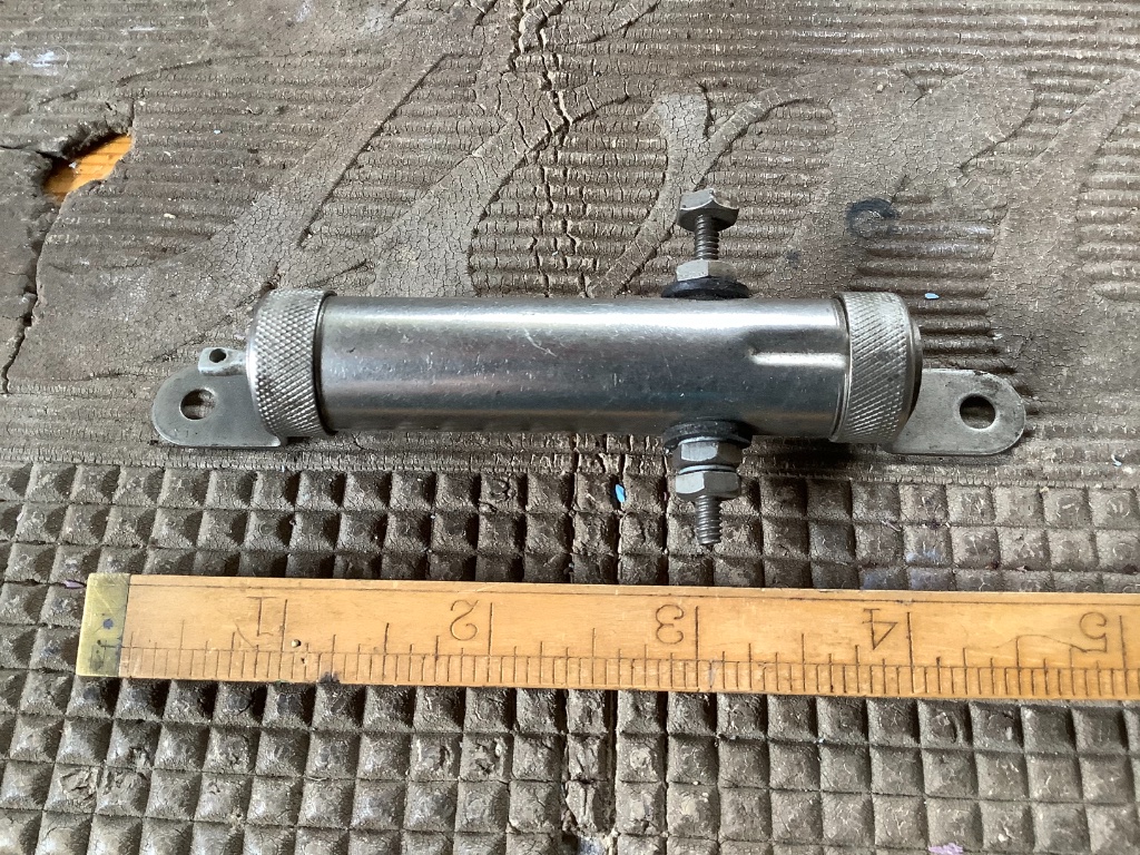

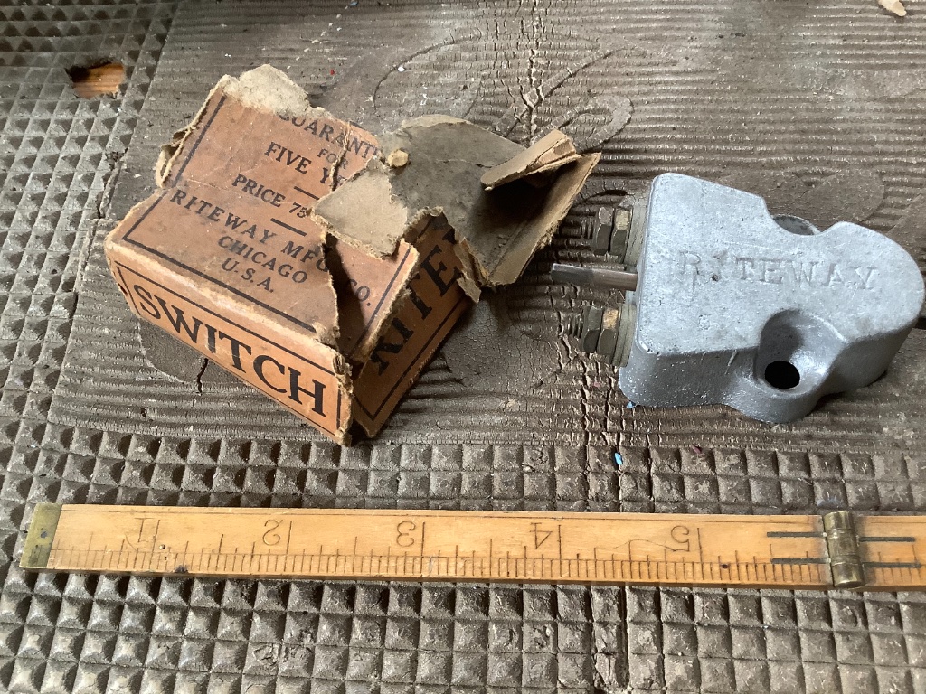

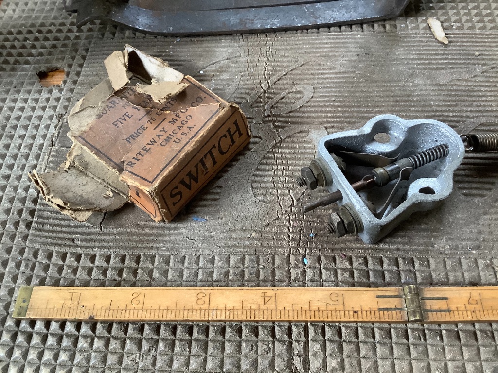

Digging out a brake light switch for a current project. They sure made things better back in the day, I think either one of these would do the job well.

Where do you mount? Underside of floor board?

They probably will work anywhere you mount them, but probably better to NOT be on the floorboard.

While those are closer to period correct, they are bulky and mounting them would be far more difficult than the 80's Subaru one I use. It takes a simple angle bracket and one hole to mount. The metal housing on the switch is threaded at the mounting, so the switch body is adjustable in the bracket. The plunger rests directly on the pedal shaft, and as soon as the pedal is pushed, the switch is activated. Can't get much less intrusive than that, with Japanese reliability as a bonus. Newer switches are almost universally plastic, clip-in pieces which are not adjustable, so the bracket itself must adjustable.
