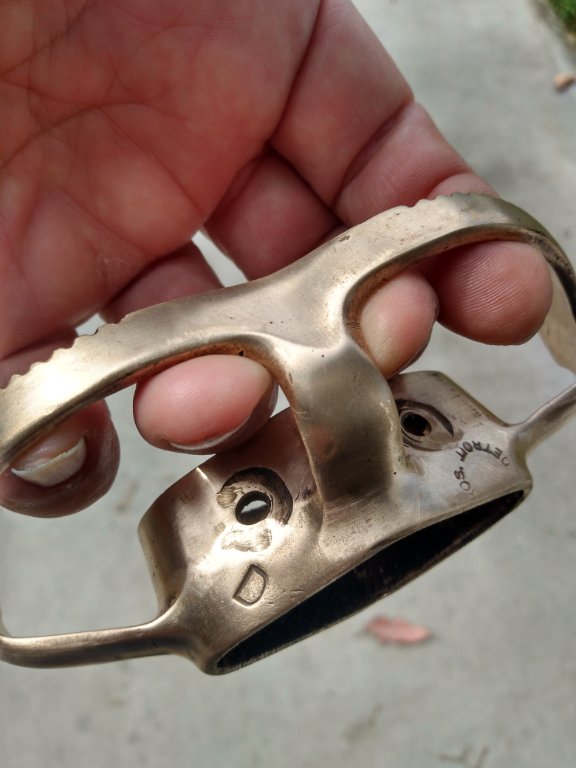

What does the "D" stand for on this original 1913 brass steering column quadrant?
This is a original brass quadrant from a 1913 steering column. Does anyone know why the "D" is stamped on it?

Dodge Brothers? You do have the Dodge Brothers stamping on the other side. Never seen one with a D stamping.

Just a guess, but since your stamp on the other side looks like a Dodge Bros stamp missing the Dodge. Someone at Dodge or at Ford added the D to id the maker. Dan

I have seen another, on a 1914.

Up until the summer of 1914 Dodge Brothers supplied the entire steering column assembly. After the breakup between Ford and Dodge, Ford began making the steering column assembly themselves, and in so doing began to modify some of the steering column parts. The most noticeable changes were the steering gear box (the change from the two-piece to one-piece designs) and the spark and throttle rod quadrants. Ford wanted to replace the cast brass quadrant with a pressed steel design. During the late summer of 1914 a series of different quadrant designs were tried beginning with a pressed steel design that resembles the cast brass quadrant. A little later another design was tried which is more like the later flat steel quadrants, but created the notches by pressing the notches from both the top and bottom sides. The notches resemble “Ruffles” potato chips. That design was in turn replaced with more traditional designs that varied in size. All pressed steel quadrants used through 1916 were brass plated.
The steering column design changes are clearly identified by examining the “Record of Change” cards and part drawing for the various components in the steering column assembly. This information is in the Collections of the Benson Ford Research Center at The Henry Ford.
I know of several instances where the owners of late 1914 cars have changed steering columns because their steering columns did not match the designs specified in the various authenticity guides. Sadly, we lose some authenticity in the attempts by these cars owners to make their cars more authentic.
