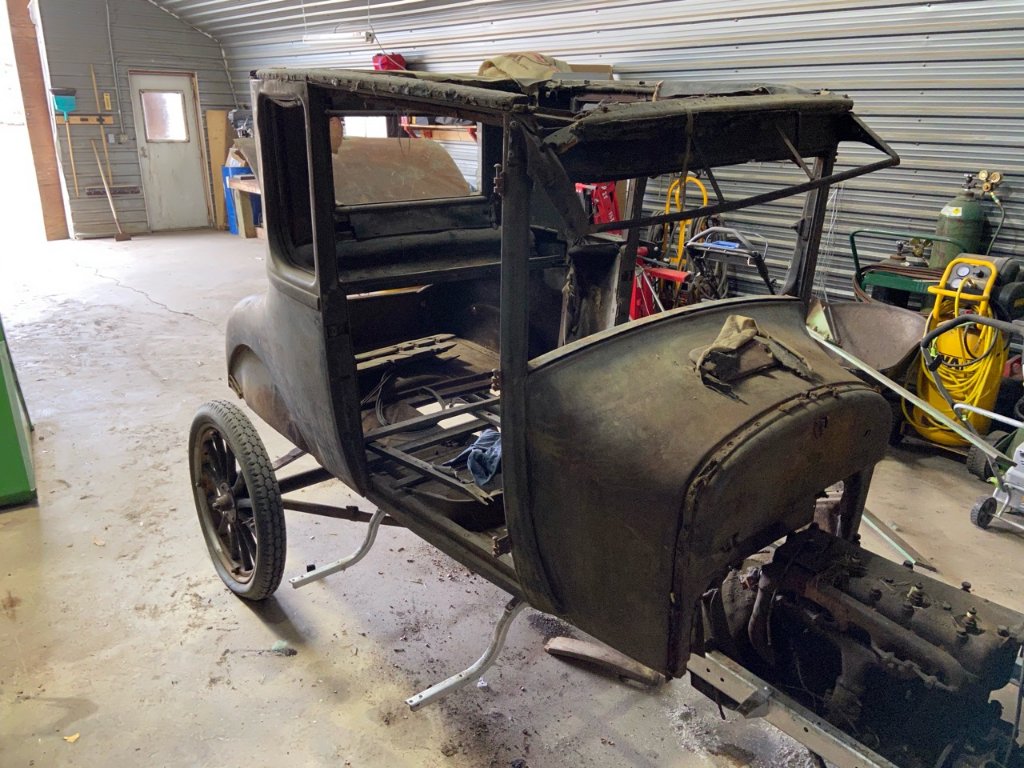

Hi!
I'm new to the Model T hobby, but I recently got a partially complete car with a coupe body and I'd like to restore it. I'm trying to figure out the year of the body. It looks like its slapped together as the serial number on the frame does not match the # on the engine. I'm thinking its either a '26 or '27 just because of the firewall, but I really don't know. Any help would be appreciated, especially with the year of the body. Thanks!

Here are a few more pics

It's an "Improved" Model alright - 1926 - 1927.

Depending on the 3rd number, being hard to read, if 0 then March 1927, if a 9 then April 1927.

So the body and frame probably belong together so a late production 27.

You can see that it has the improved block in it but an earlier hogs head.
Small drum diff?

Madison,
There are three different sizes for the battery cover for the 26-27 coupe.
Yours as seen in photo #2 is about the length of 22-13/16" which means it is the June 1926 to August 1927 variety.

Thanks for the help! I appreciate it! I’ll definitely be checking out the Foothills Model T club. I used to work at Reynolds-AB Museum and I think I helped with a tour for the club one time. This car seems to be a bit of a mix & match. Would it be safe to assume the body belongs with the frame? I’m going to have to do bolt by bolt restoration anyway, it would just be good to date it. Again, thanks for the help!
