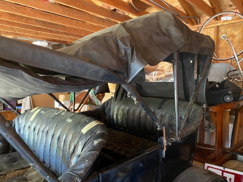

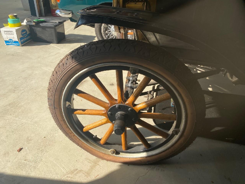

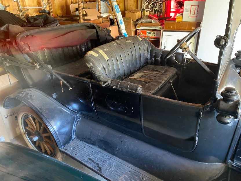

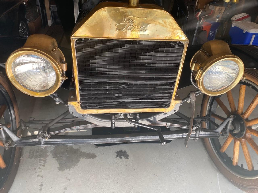

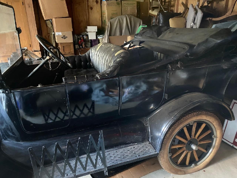

Here is one for sale in California so add shipping + modestly fixing it up. Its listed for $14,900 wonder what members think of it/price as a beginning and what additional repair costs might be
https://classiccars.com/listings/view/1 ... rnia-91108
There are many more detailed pictures just selected some for starters

Obviously the top and upholstery need to be done. The wheels and tires appear to be the later balloon type and are incorrect for a brass-era T. You are looking at about $3,000 or more to make it correct, plus whatever it needs mechanically. I wouldn't go that high for it, but that's one man's opinion.
- Posts: 4388
Re: Buying my first Model T
So many wrong year parts. Seller doesn't know what year it is. Seller hasn't even the beginnings of a clue how to put the top up. Old restoration with too much wrong and too many unknowns. Without solid information that it is IN FACT a 1915, and in solid condition, that could have a few things replaced and corrected? The price is twice what that car is worth.
It does appear to have an over-axle wishbone, one good sign.
Be careful out there.

Fifteen thousand dollars for what is (obviously) a later "nineteen bitsa"... I looked at it about 5 minutes, there's so much wrong, regardless of what year car you're building, that you'll be into it another 10 or so to correct everything... I'm guessing you can sell the hodgepodge of parts and make some of it back (once you decide what year you want to make it into)... Interesting way of shooting the motor so you can't see if it has a generator or not...
The whole "It was built this way by Ford"...
The parts were built by Ford... and other companies... over (from what I could see) at least a 5 (probably 10) year period. Sorry.
If you're looking for a Brass-Era T there are a lot better examples than this one.

Paint is less then 100 years. Wrong steering wheel. Head lights look to have been converted to sealed beam so could be later engine with generator. No photos of engine, rear end or under car leaves a number of questions unanswered, along with no serial number in the ad. The windshield looks correct, riveted to brackets and short arm hinges. Could have 2 speed rear end, but no info on that in ad. The body could be after the first few months of 1915 so can't be a 1914. You can see the head of the carriage bolt just in front of the back door, this post gives information on when that feature was used; http://www.mtfca.com/discus/messages/29/15067.html
No information on title. Depending on your state, titles if the car does not have one, can be easy or hard to get. Not all states will accept the titles form the services back east.
All this is a great reason to come here and ask or find someone that knows Model T's or if looking at different brand, has a familiarity with the brand to look at it with you so you know where it stands as far as what would be correct for the year and price.
That ad was written in my OP to pull someone in that does not know Model T's or the seller has no clue. More then likely it was bought on a whim and over payed now trying to recoup their loss.

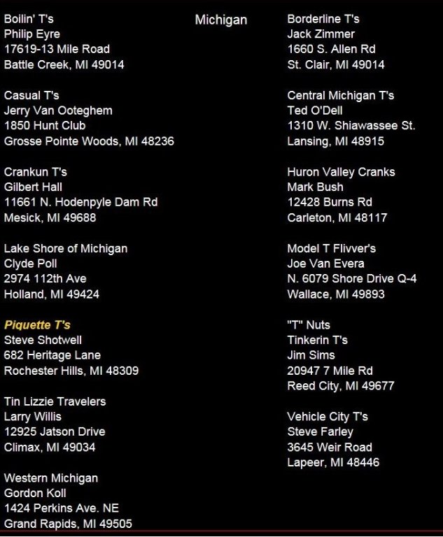

This list was posted in 2017 of T clubs in Michigan
- Posts: 7398
Most of the Michigan clubs remain steadfastly stuck in the last century, but a couple have a phone, email and/or a website.
https://www.modelt.org/chapter-listings.html
