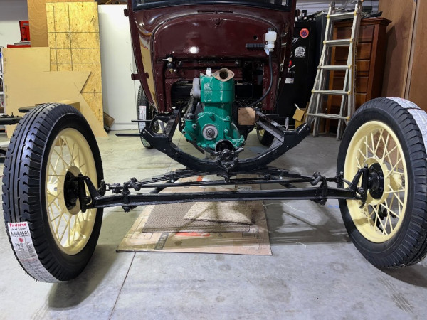

The restoration of my 1927 coupe is underway. I will post photos as it proceeds. Hope you will find them interesting. I have 27 photos to post now. Can I include all of them in one post? Any suggestions on how best to do this and how to continue to record the restoration over the next several months?

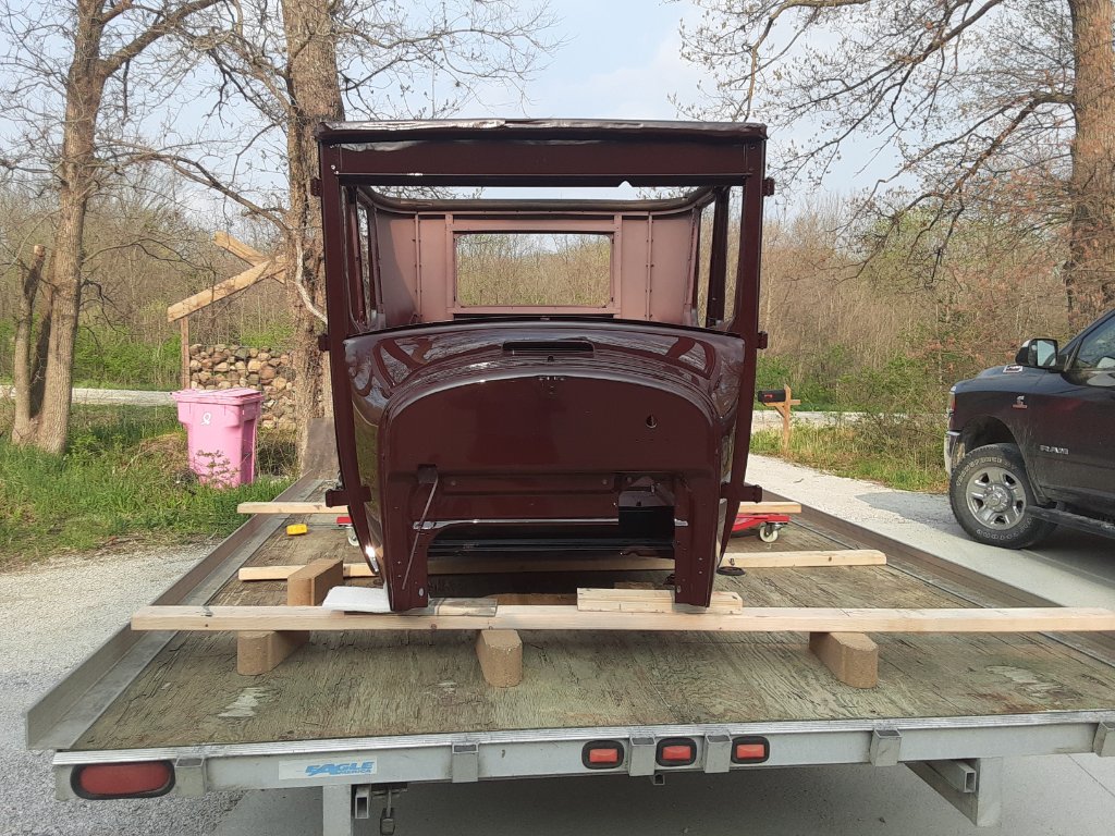

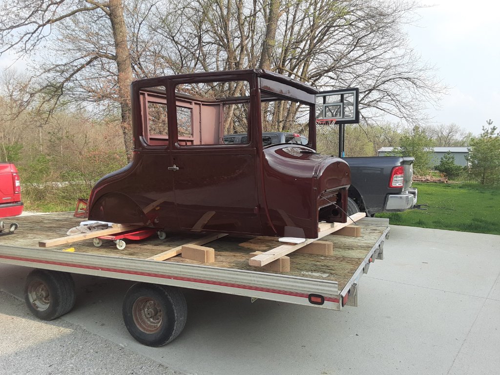

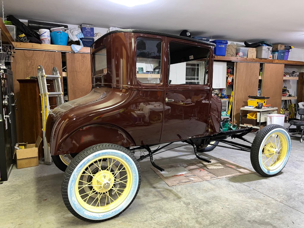

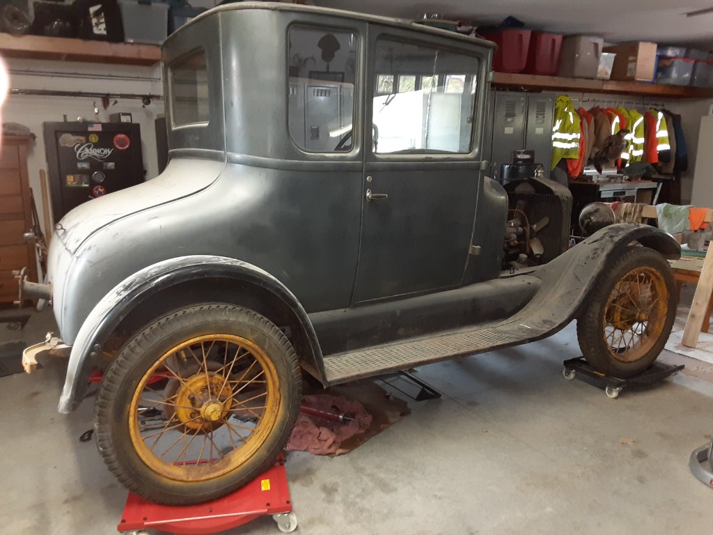

The first photo is of my Mom and Dad with the coupe in 1959 during the 75 anniversary of my home town in North Dakota. It was in the parade. It hasn't been run in the 62 years since. Hopefully, it will be in the next few months. The second photo was taken last fall just before we started to disassemble it.

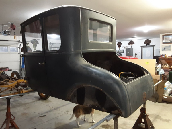

Posts: 8636
Re: My 1927 Model T Coupe Restoration

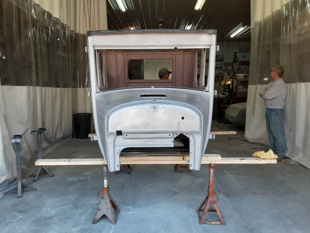

Post by TXGOAT2 » Sat Apr 24, 2021 9:44 pm

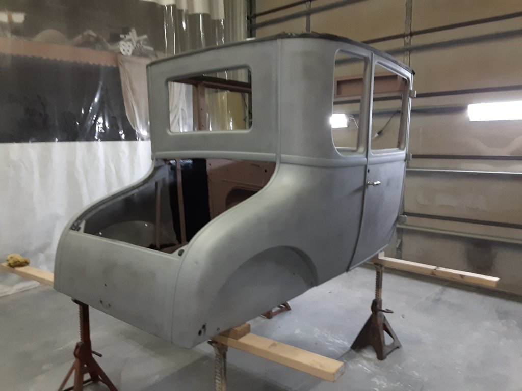

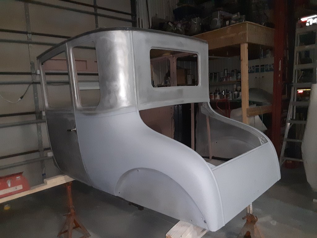

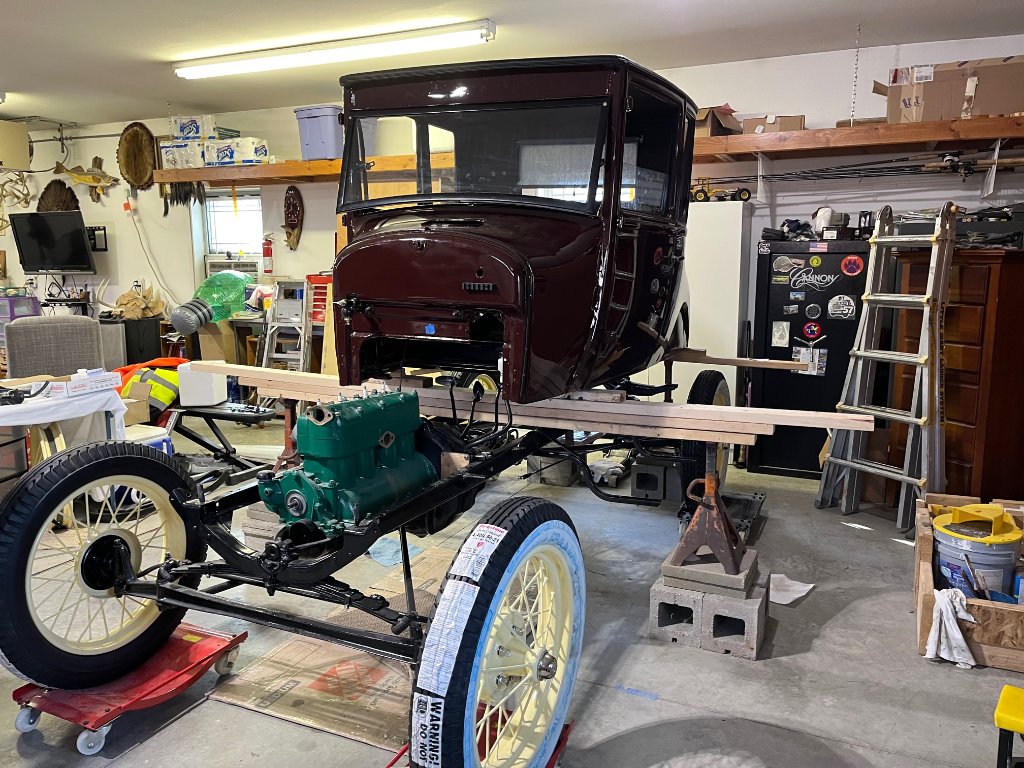

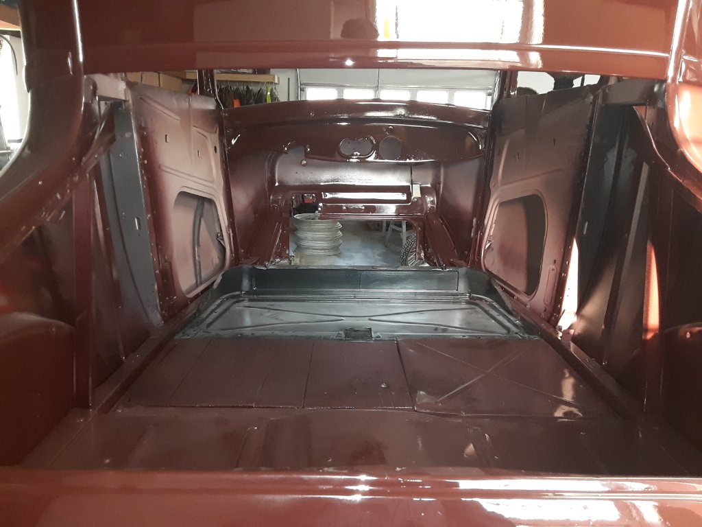

That's a very solid looking vehicle. How did the chassis come to be painted?

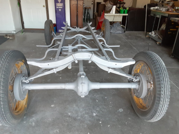

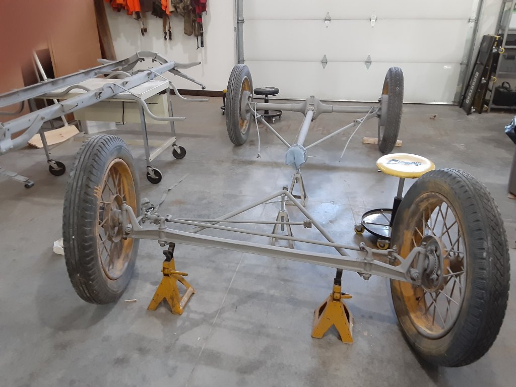

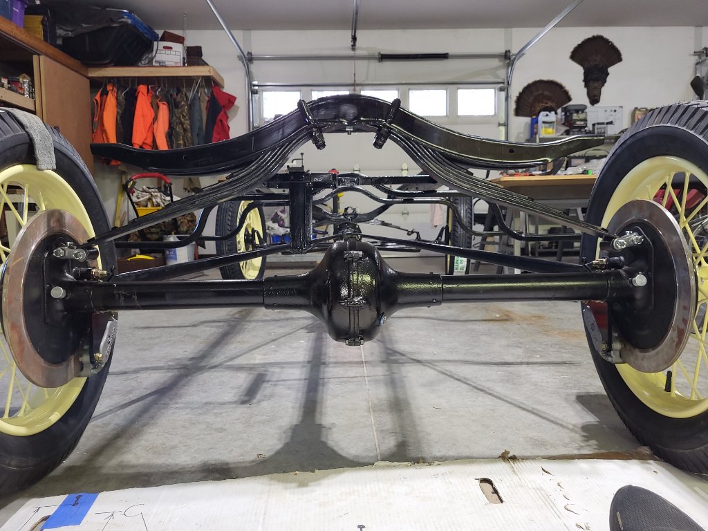

Last one for now. The frame has not been painted. It has just been blast cleaned to bare metal!

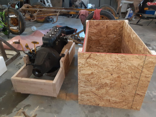

One of engine ready for shipment to rebuilder and one delivered to Fastenal.

Excellent. Very solid, clean body. You’re in for a lot of fun. Jim Patrick

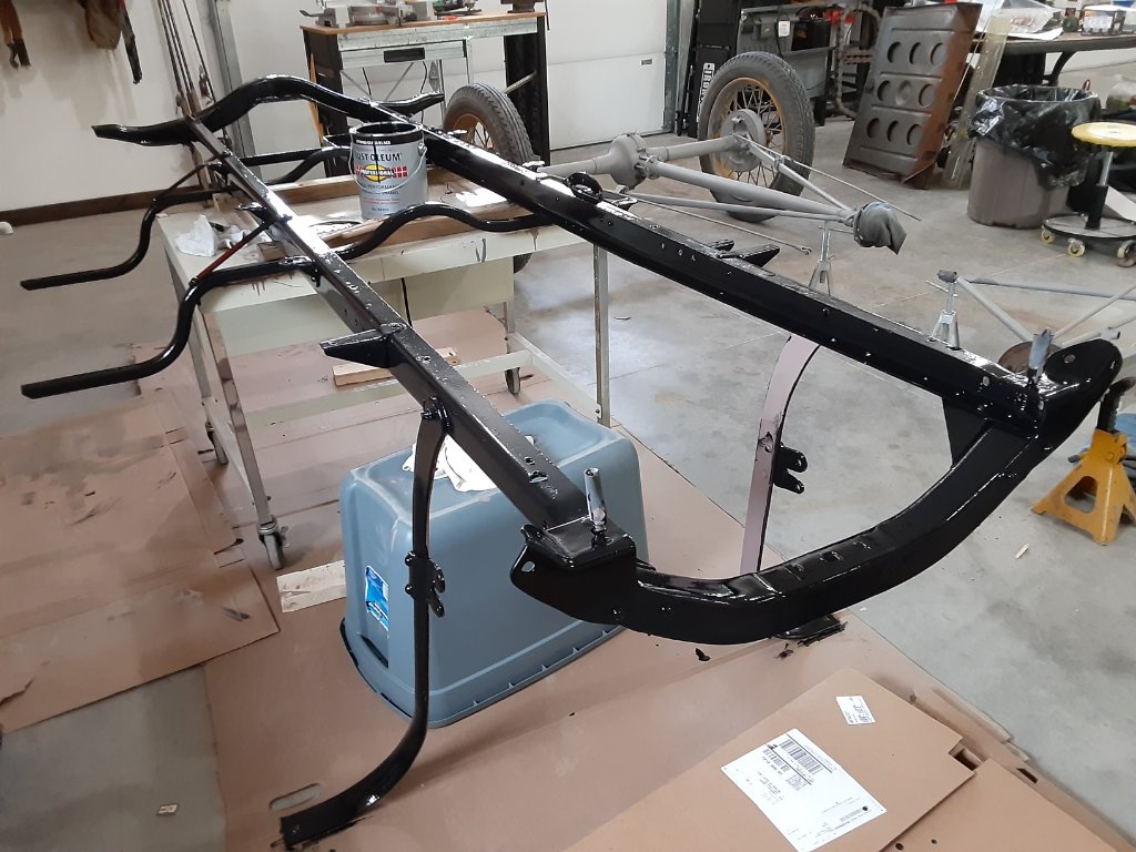

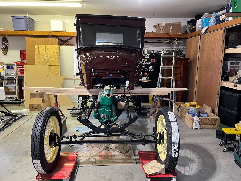

Post by BLB27 » Mon Apr 26, 2021 9:46 pm

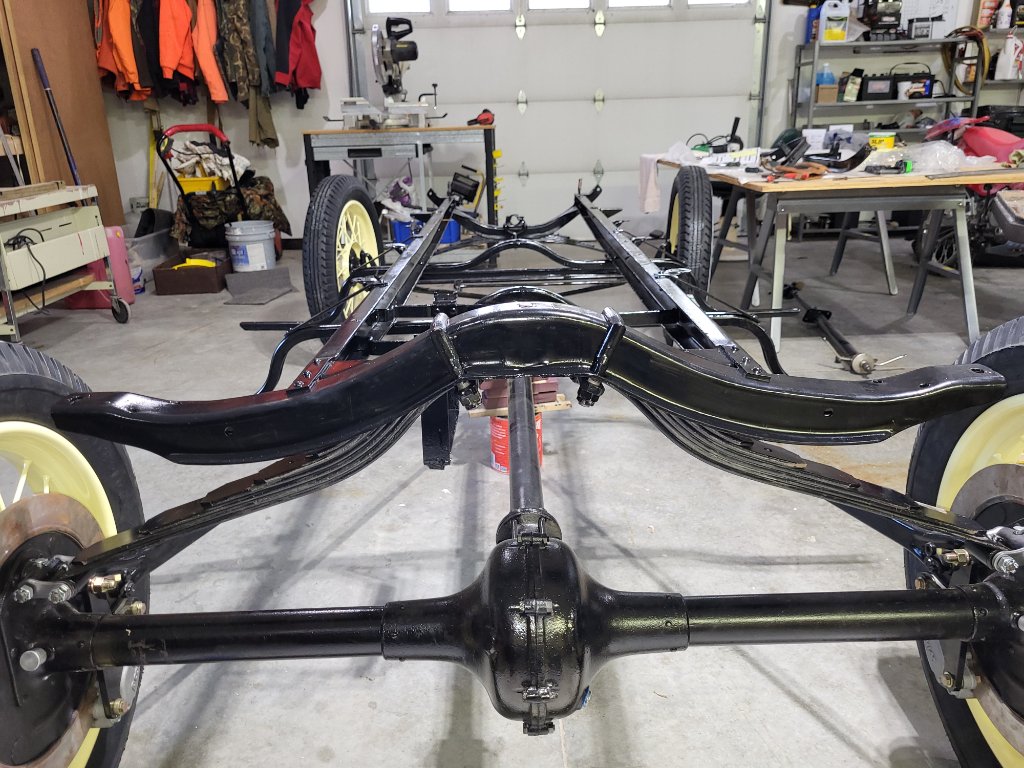

One small step for the restoration project. One large step for us.
Mopar_man
Posts: 1191
Last Name: Govoni
Location: Fredericksburg, VA
Post by Mopar_man » Mon Apr 26, 2021 10:20 pm

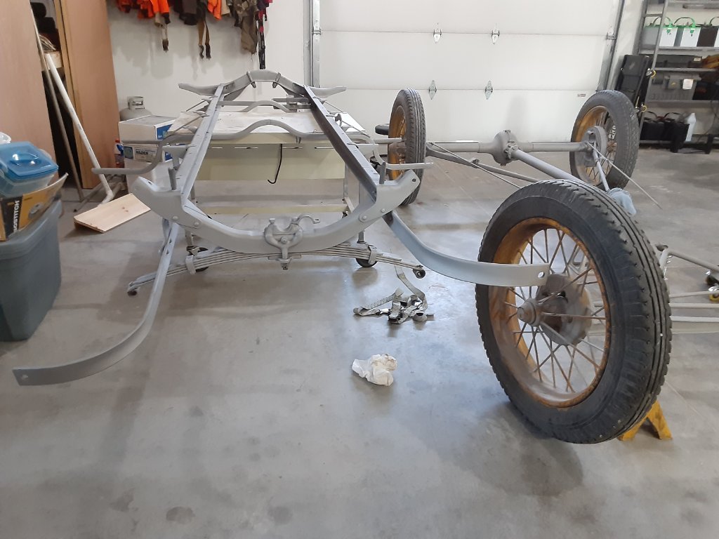

Wow you guys are fast. Nice work on the frame. Are you going to pull the rear end apart?

Post by jiminbartow » Tue Apr 27, 2021 10:12 am
Nice, clean floor.

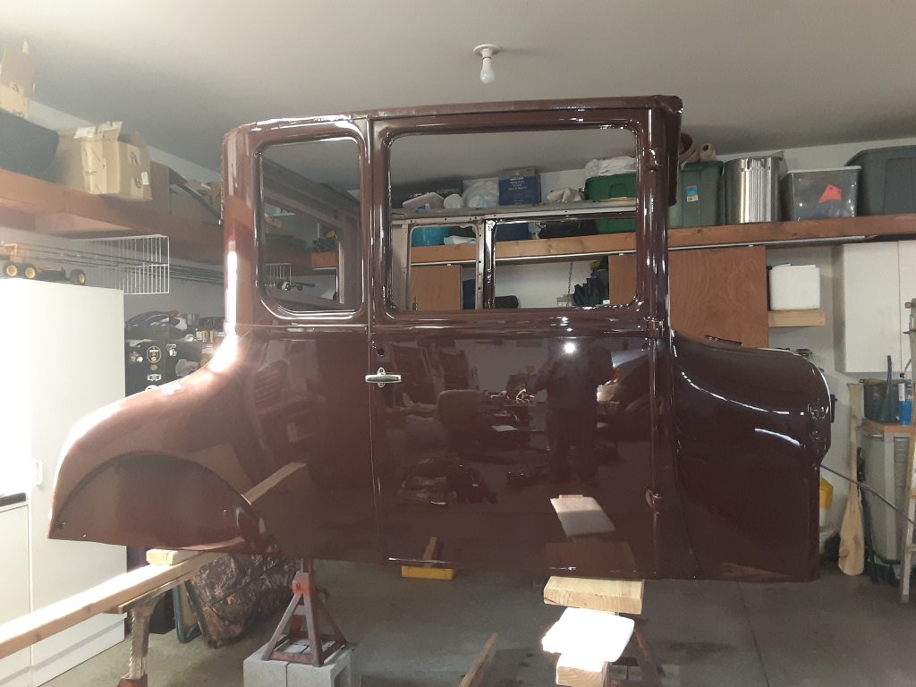

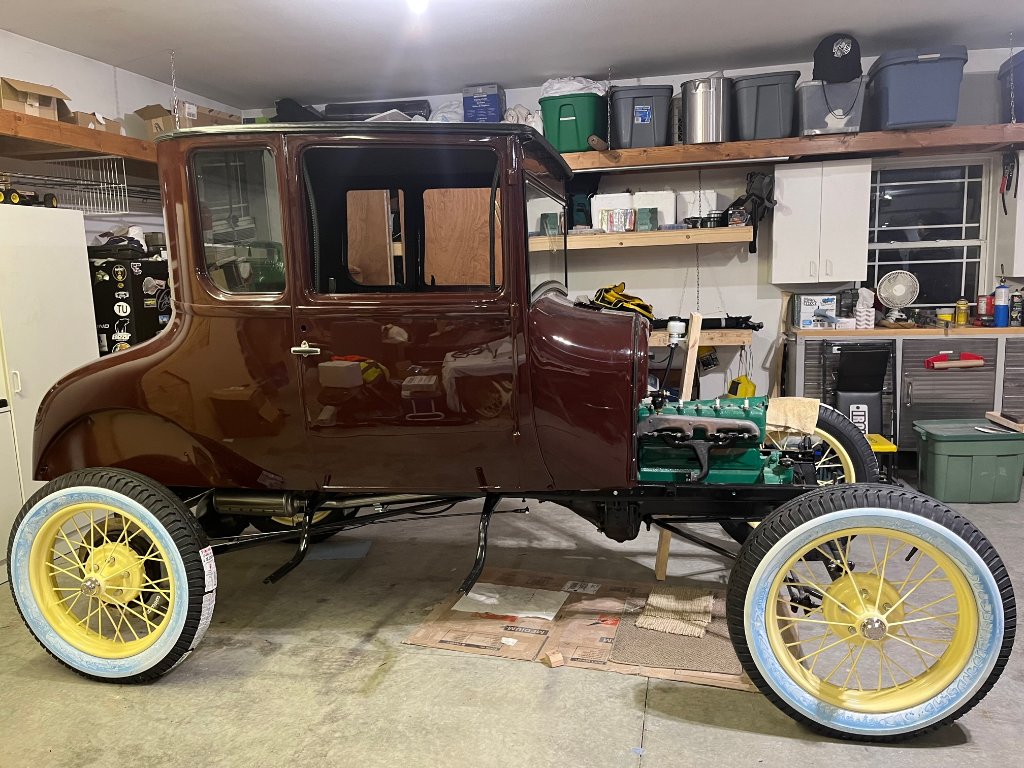

BLB27
Posts: 892
First Name: Bruce
Last Name: Brakke
Location: Ames, Iowa
Post by BLB27 » Tue Apr 27, 2021 10:20 am

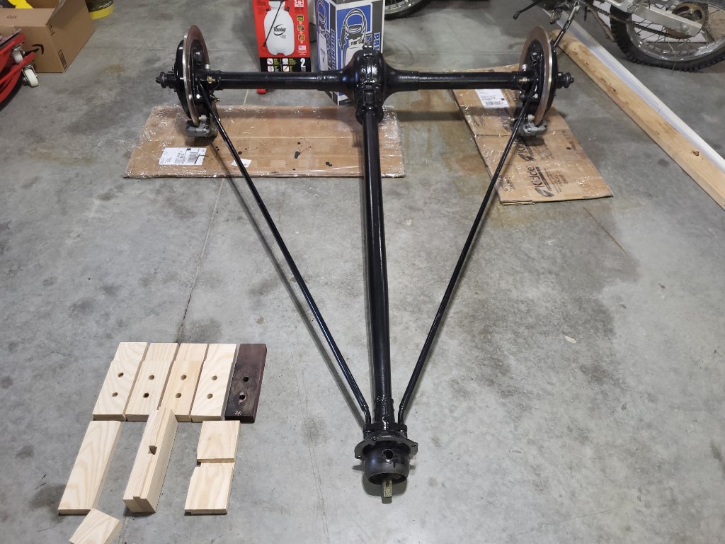

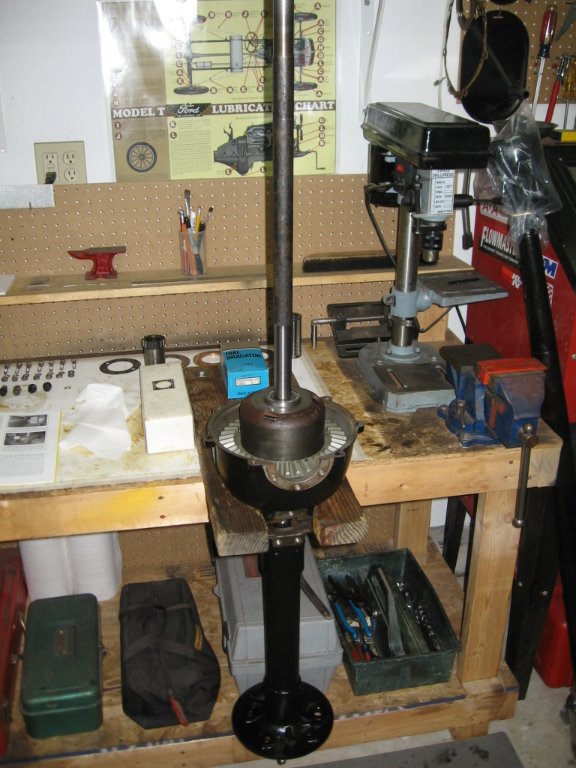

Robert, I have watched the three Model T-Tips videos about rebuilding the driveshaft/rear axle and am undecided on what to do, do it ourselves or by a professional.
Posts: 2549
Last Name: Strange
Location: Hillsboro, MO
Post by CudaMan » Tue Apr 27, 2021 11:29 am
Based on the pictures you have posted, doing the rear axle will be a snap, just dive in and learn. When I broke an axle shaft on my standard rear end, I decided to buy a used small drum Ruckstell and rebuild it to install in my T.

Post by BLB27 » Fri May 07, 2021 11:18 pm
Pat, I forgot to answer your April24 question. The frame was not painted. It was blasted cleaned to bare metal. It does look like gray paint. The primer is going to be Rust-Oleum gray, so I have added two half pints of Rust-Oleum prime brown to have a contrast when painting it.

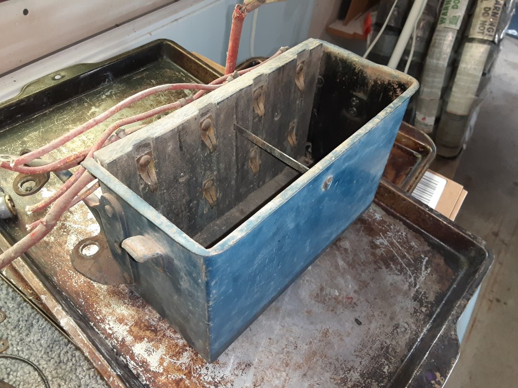

Post by DHort » Sat May 08, 2021 2:26 am
I prefer the washing machine tray I got at home depot. It is deeper than the metal trays, and I add oil-dri to catch the drips.
I think they are about $20 each. I have three under each car.
Your choice. Metal or plastic. Both will work.

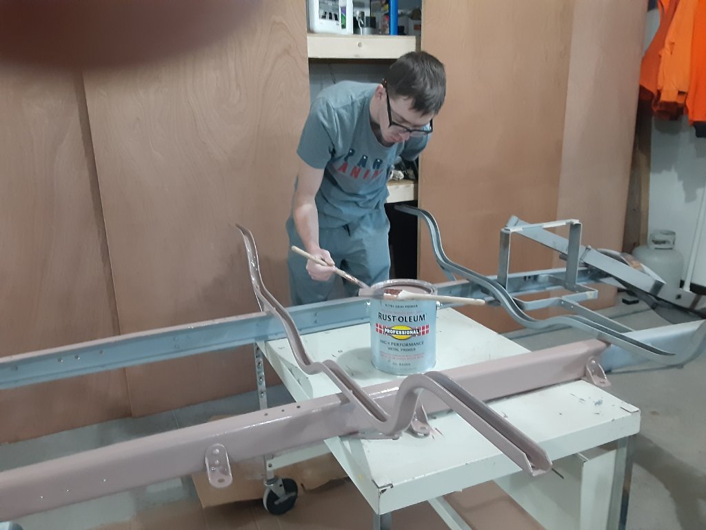

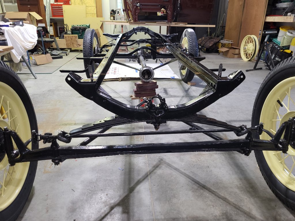

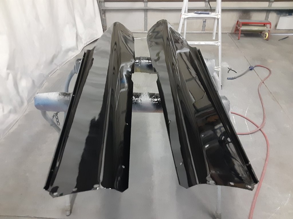

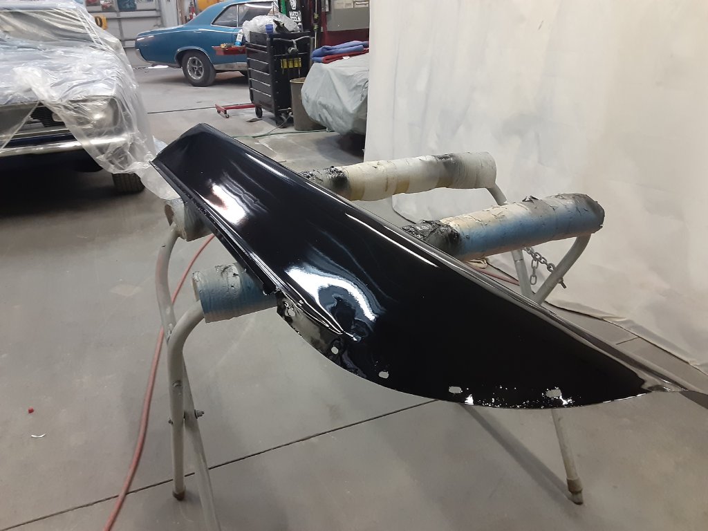

Post by BLB27 » Mon May 10, 2021 9:12 pm

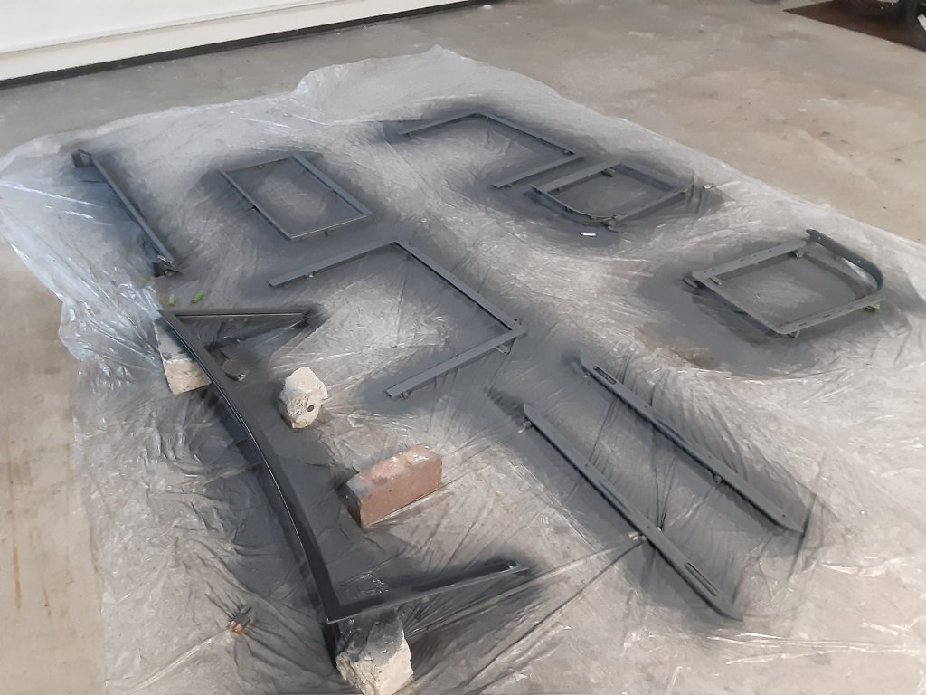

Prime coat being applied. The odd color of the prime is because I tinted the gallon of gray with two half pint cans of rust color. I did this because the gray was almost the same color as the sandblasted bare metal.
BLB27
Posts: 892
First Name: Bruce
Last Name: Brakke
Post by BLB27 » Sat May 15, 2021 8:40 pm
Painted the frame.

Post by jiminbartow » Sun May 16, 2021 7:14 pm
Brush applied Rustoleum Gloss black Enamel. Great choice. Looks great! Jim Patrick

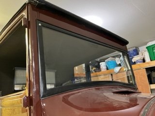

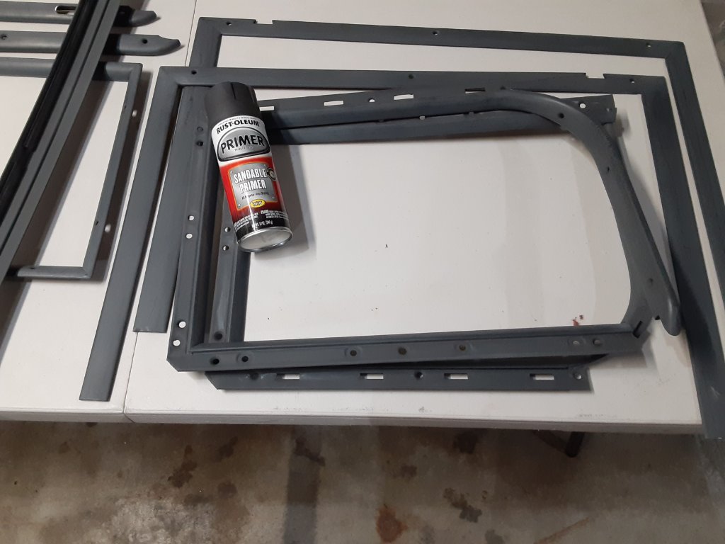

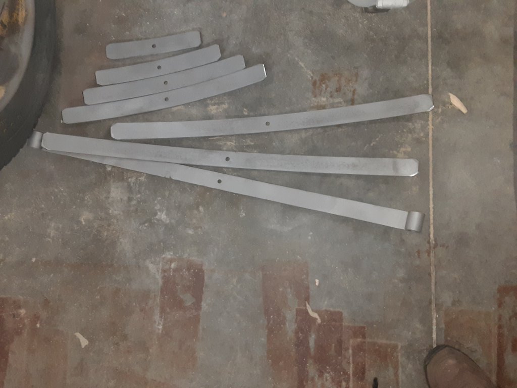

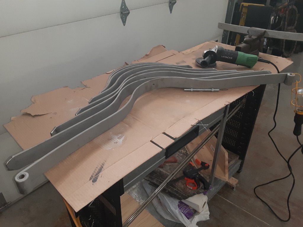

Windows and springs. Springs blasted cleaned.

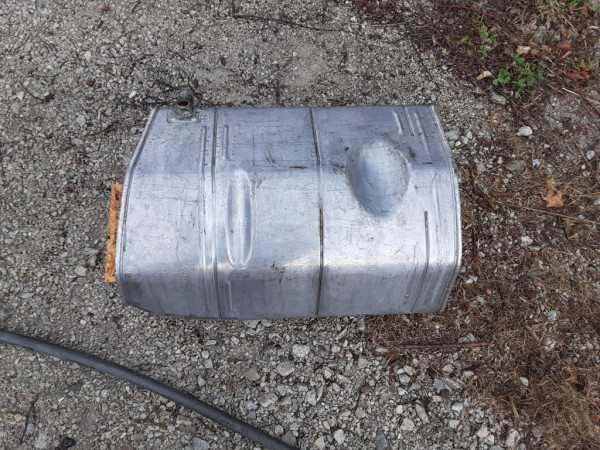

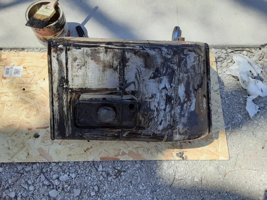

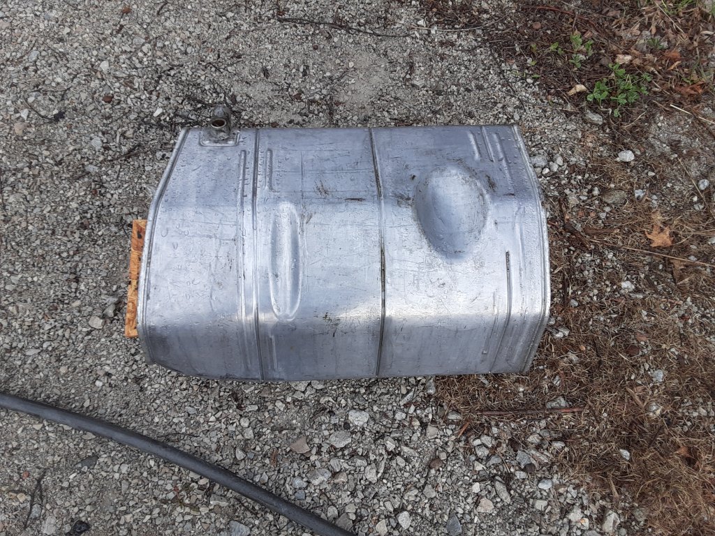

Post by Norman Kling » Fri Oct 08, 2021 2:07 pm
Did you check out and clean the gas tank? If old fuel was left in the tank, it could set up like varnish and be very hard to clean. Also the fuel line and vaporizer must be completely clean too.
If the tank had been drained, it could have had water or condensation in it causing rust.

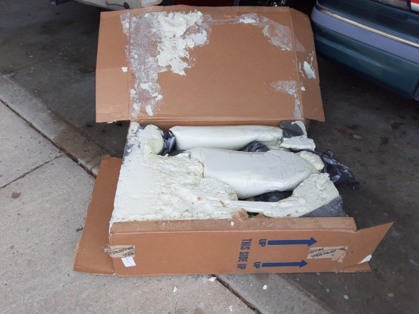

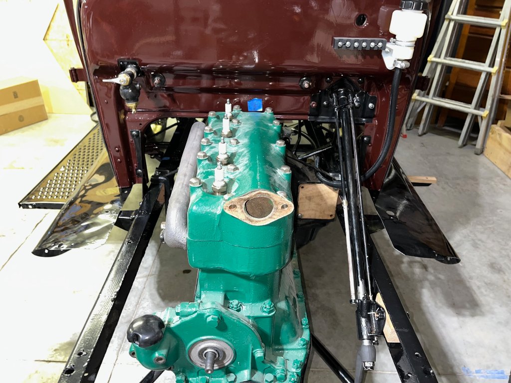

Up date. A photo by the rebuilder showing the engine being boxed for shipment to me! I am anxious to see it!! Complete rebuild with new upgraded camshaft. I shipped it by Fastenal and being returned by Fastenal. I found them very accommodating and very reasonable cost wise.

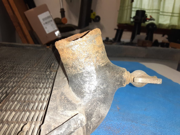

Chris, I decided to use NH carb.

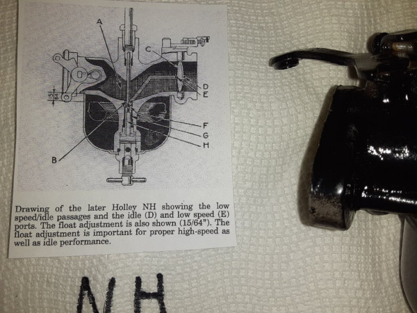

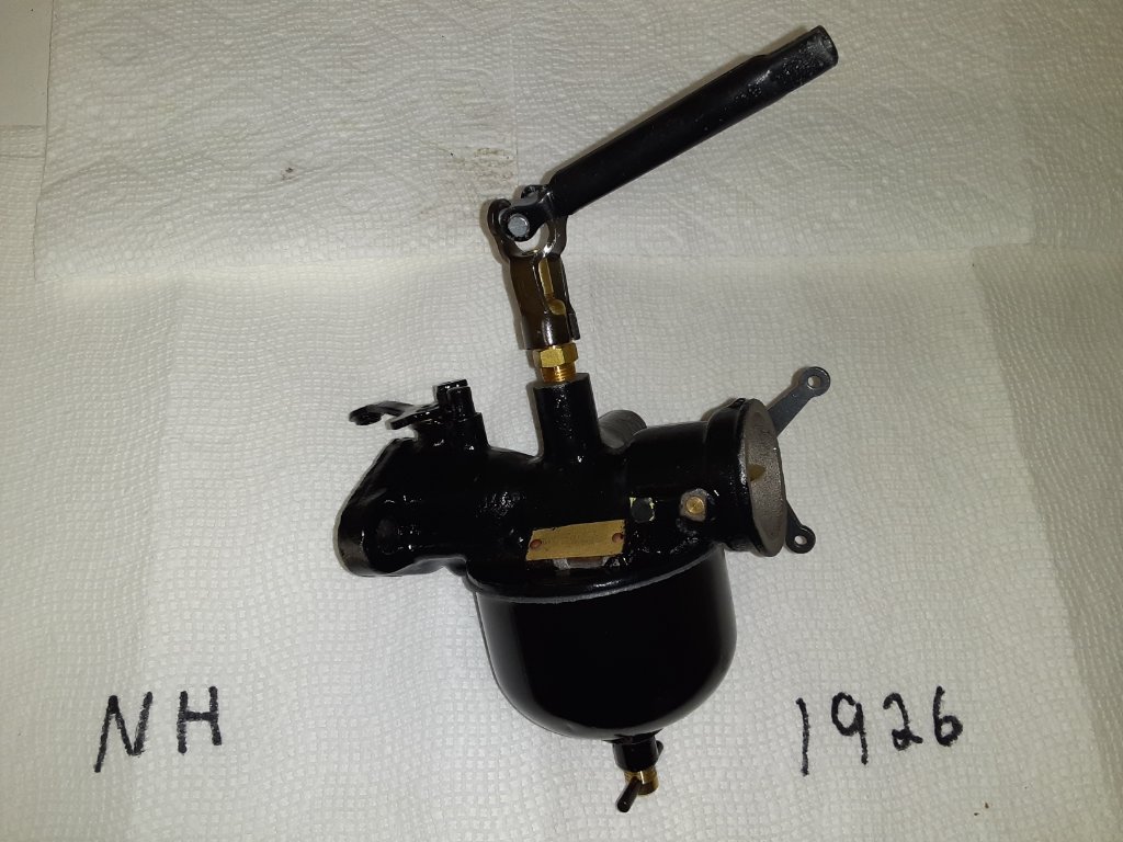

Post by BLB27 » Sat Jan 29, 2022 5:29 pm

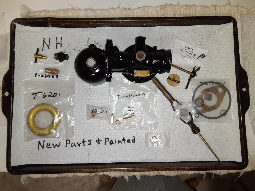

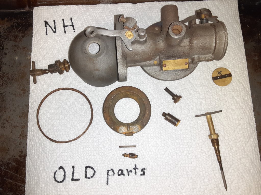

I rebuilt a 1926 NH carb for my 1927 coupe. Here are some photos.

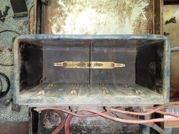

Last Name: Brakke

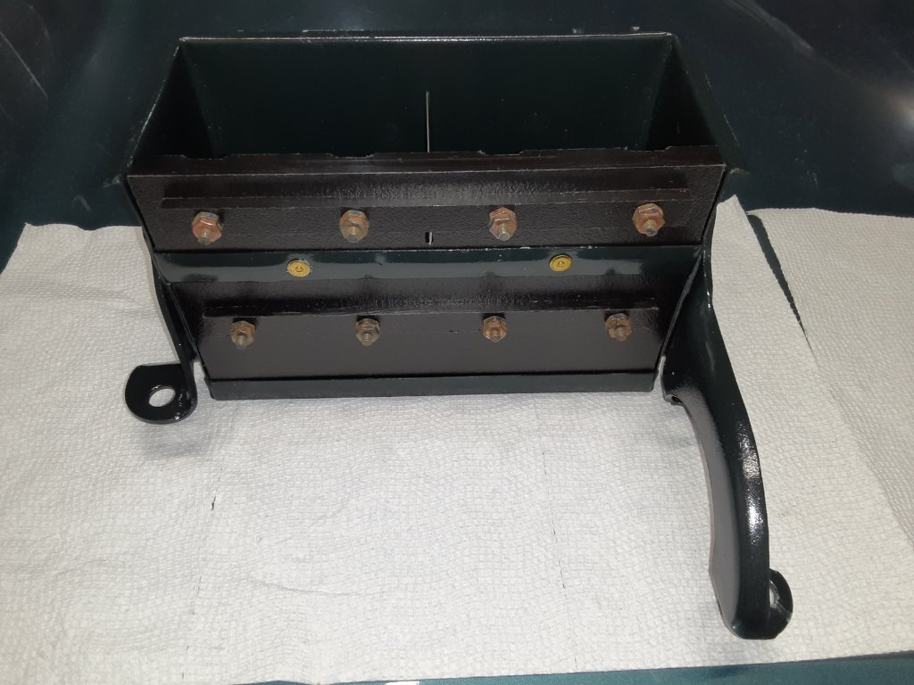

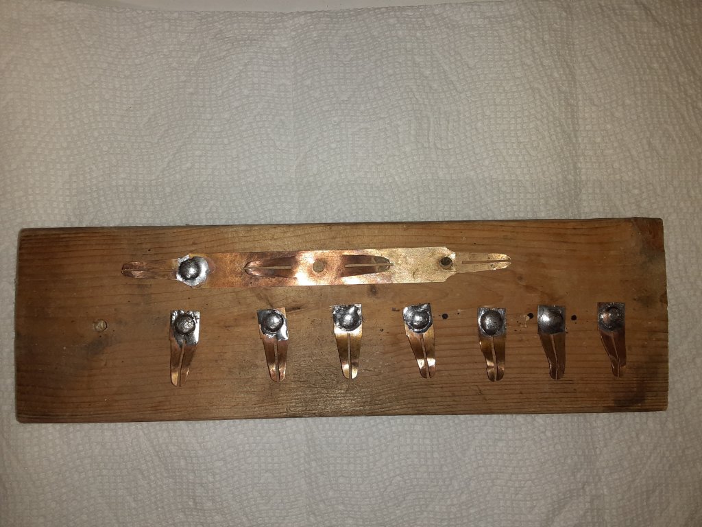

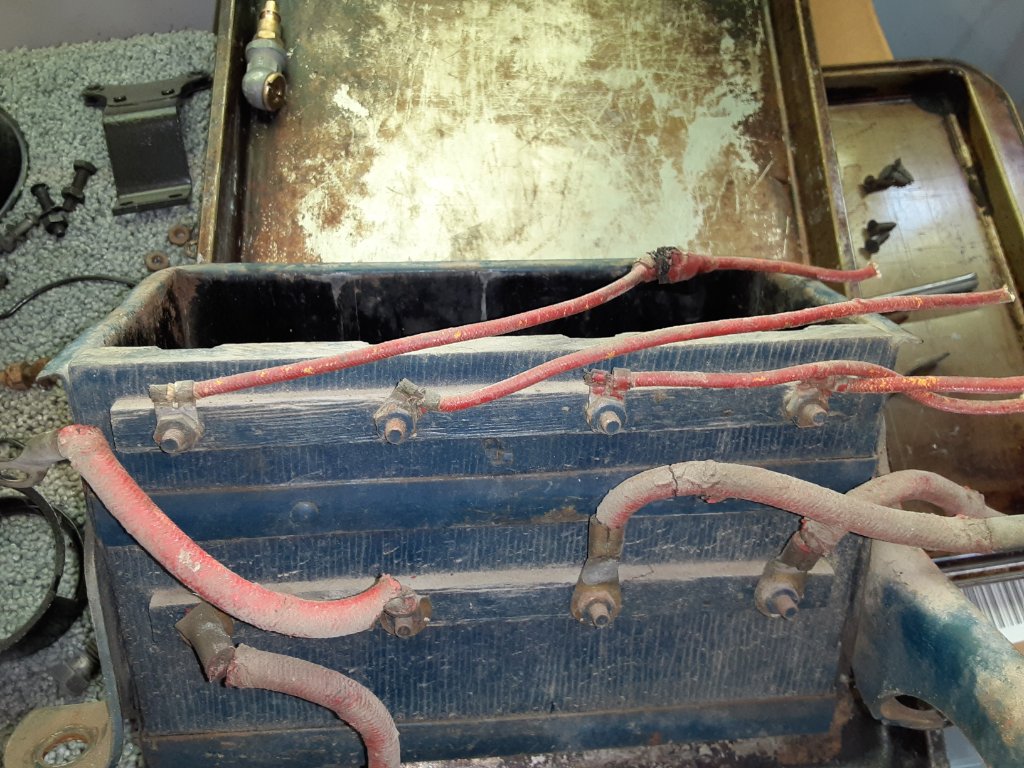

Post by BLB27 » Wed Feb 16, 2022 10:18 pm

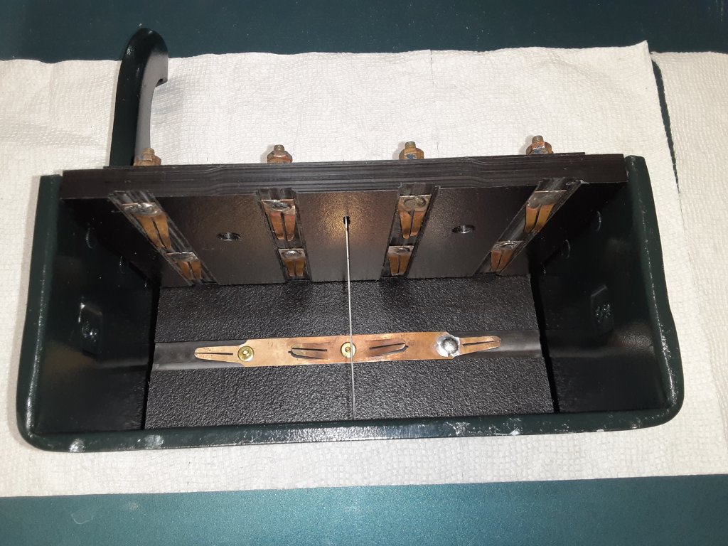

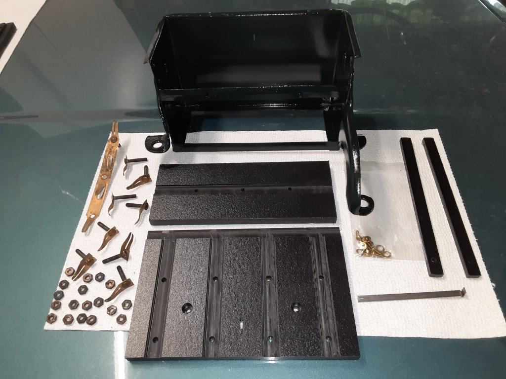

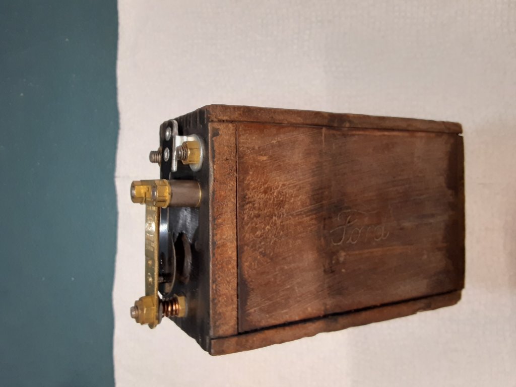

I rebuilt the coil box using the waterproof material and the original contacts, photos attached. I cleaned the contacts using the toilet cleaner, "The Works", per a suggestion by the Coilman. It worked great. He rebuilt my coils. What a great man to work with, very professional and always willing to answer questions and offer helpful advice!! I will coat the coils using linseed oil per his suggestion.
The contacts are soldered. I used the screw rivets that came with the rebuild material to attach the contact strip to the bottom and the vertical contact plate to the box frame. I may replace them with pop rivets.
Four more photos on next reply.

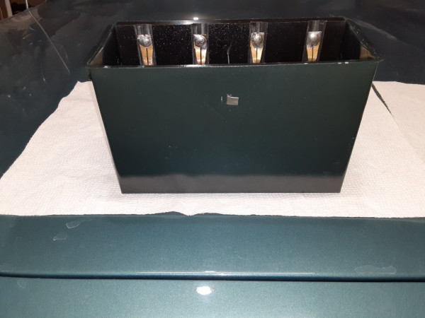

BLB27
Posts: 892
First Name: Bruce
Last Name: Brakke
Post by BLB27 » Wed Feb 16, 2022 10:22 pm
Coil box rebuild continued:

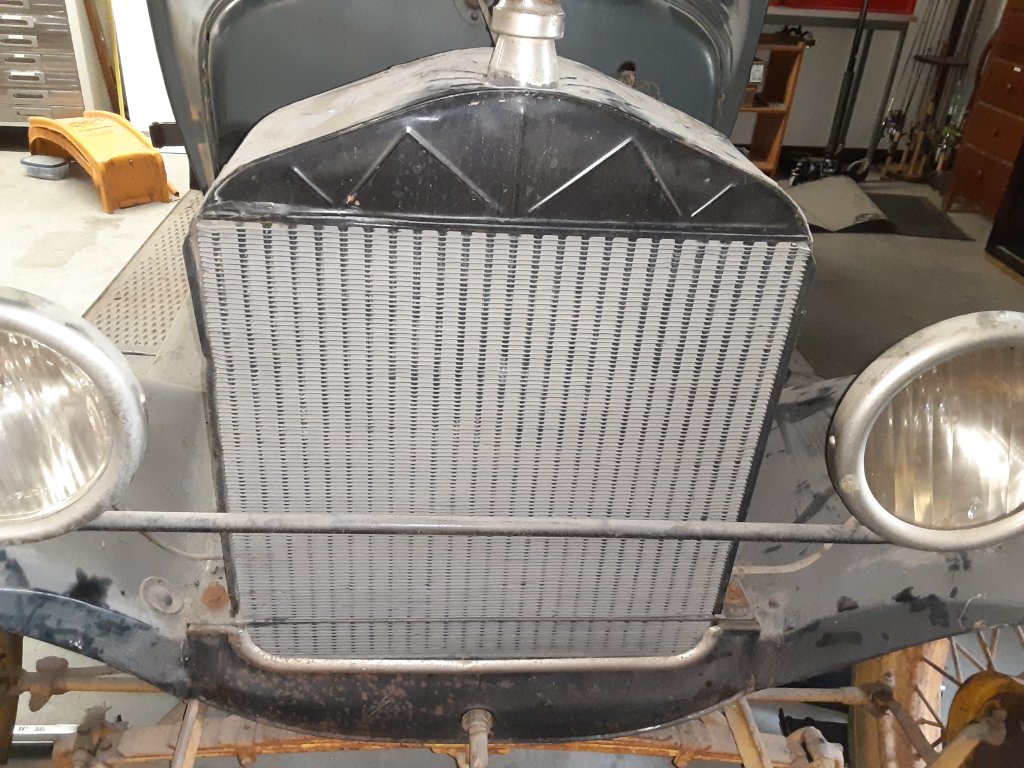

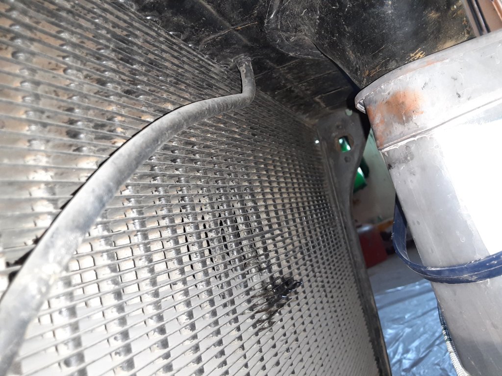

Post by BLB27 » Tue Apr 05, 2022 9:06 pm
More photos. Two leaks in the round tube radiator.

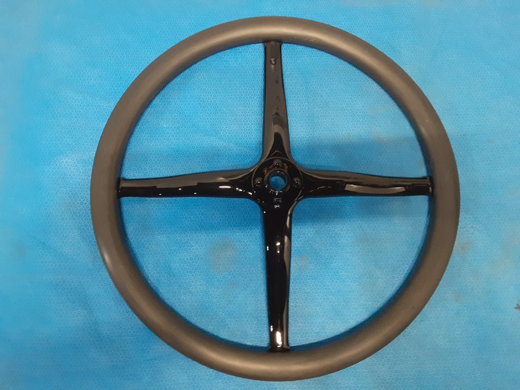

Post by BLB27 » Thu Apr 07, 2022 10:59 pm
Sanded the handle with 220, 400, 800, and 1000 grit.

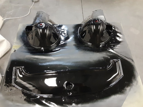

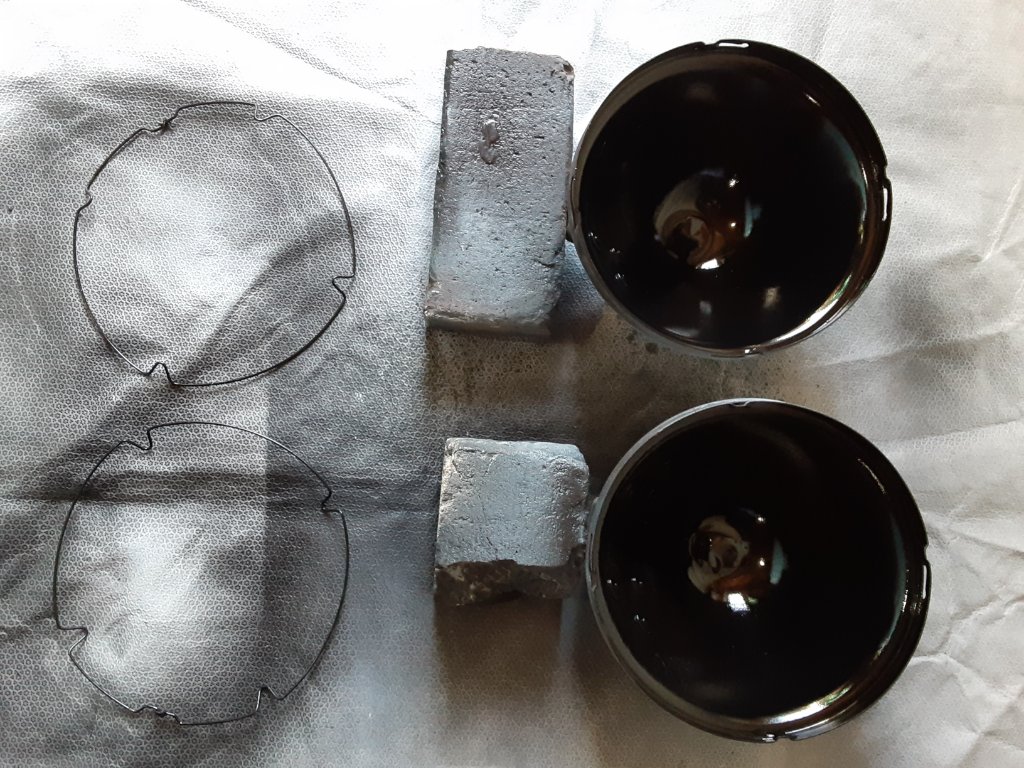

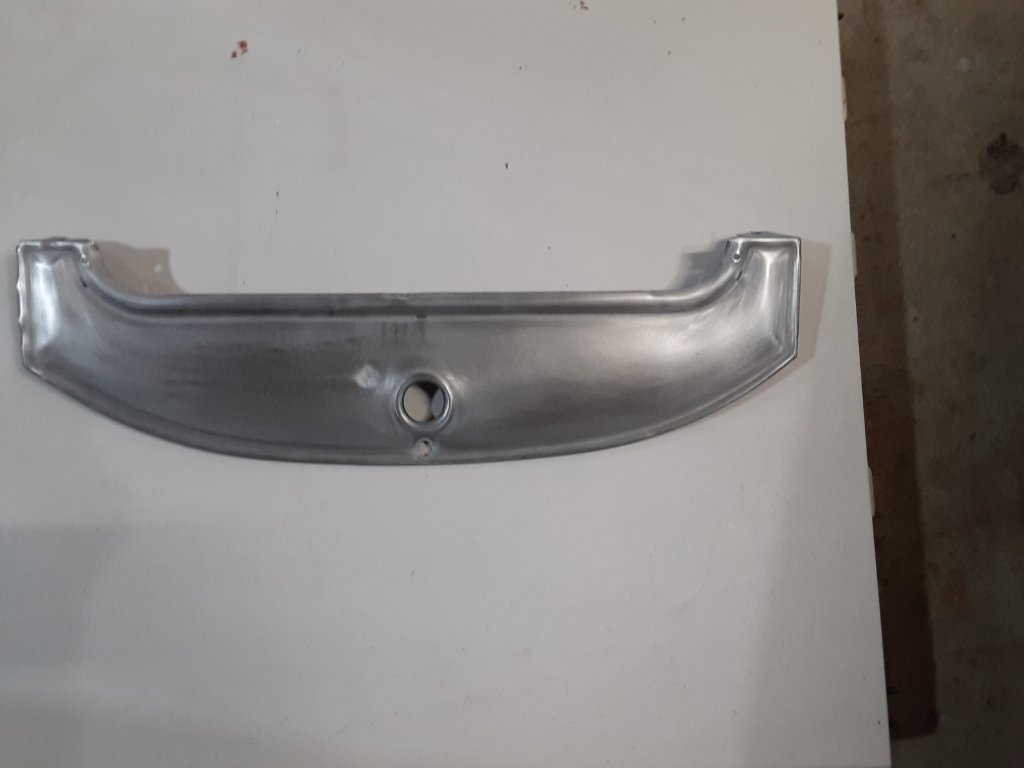

Post by BLB27 » Fri Apr 08, 2022 12:06 pm

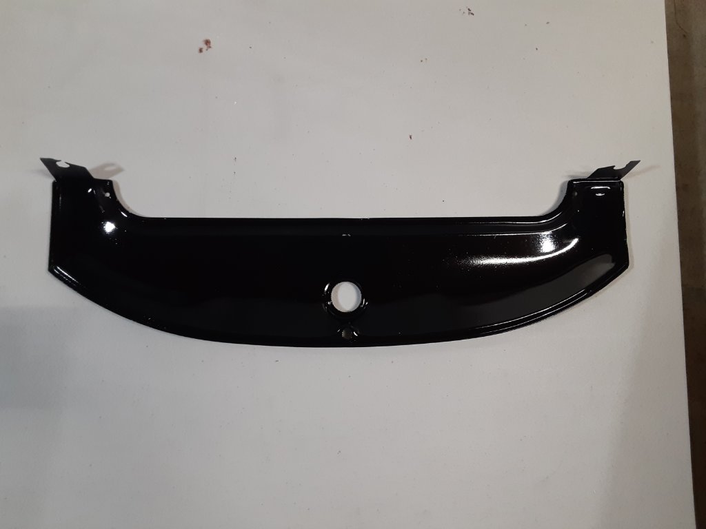

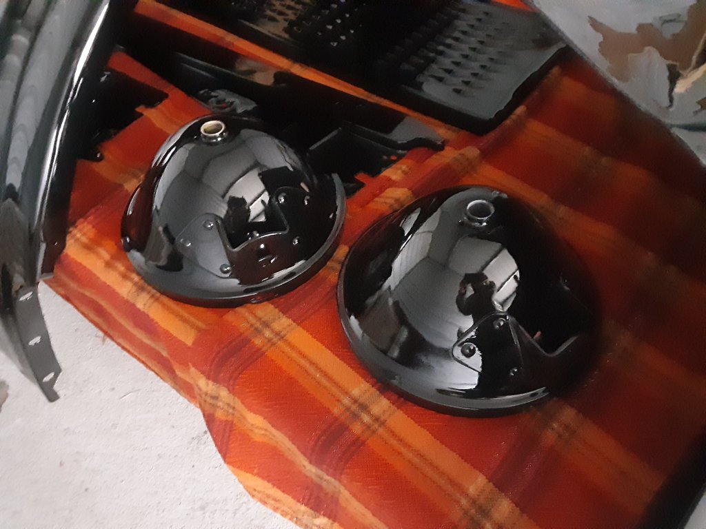

Head lamps and radiator apron restoration. Back side of apron primed.
BLB27
Posts: 892
First Name: Bruce
Last Name: Brakke
Post by BLB27 » Fri Apr 08, 2022 12:15 pm

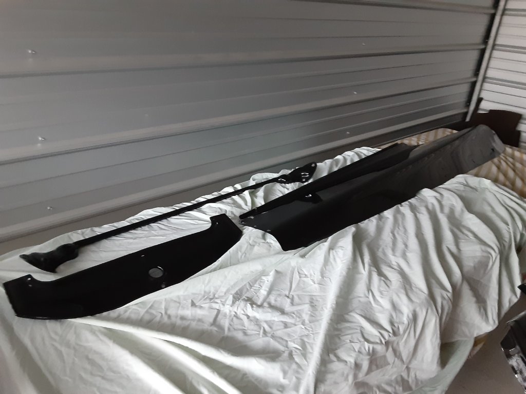

Apron, head lamps and splash panels.

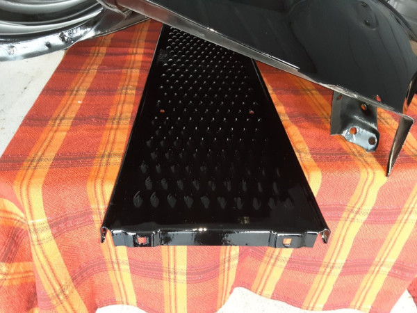

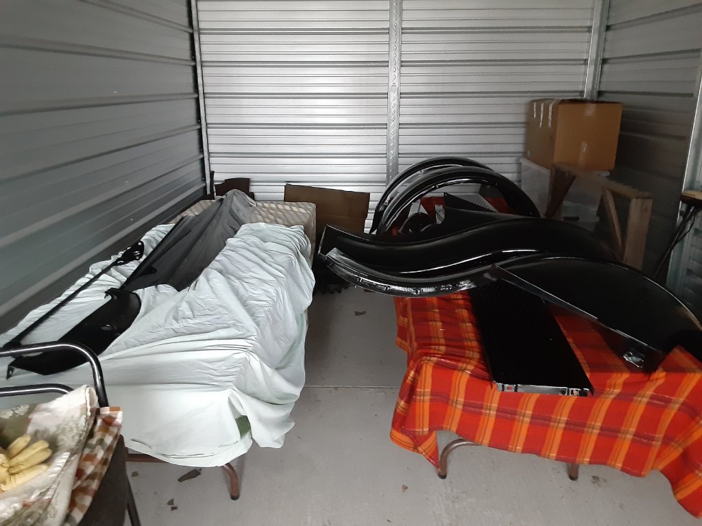

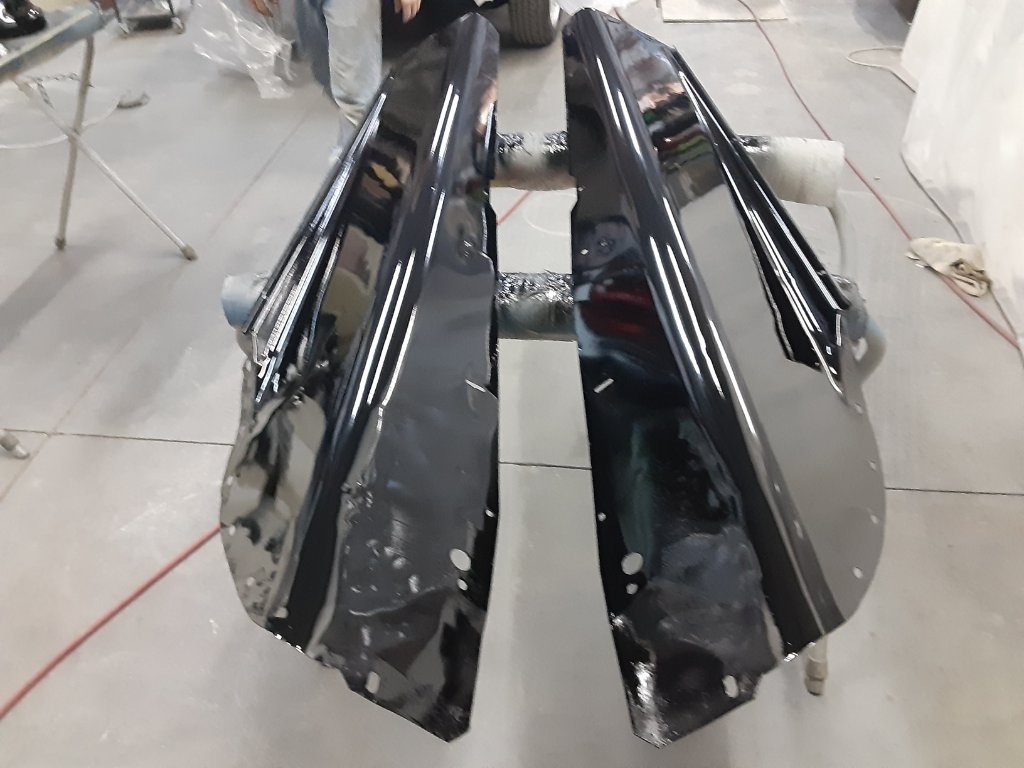

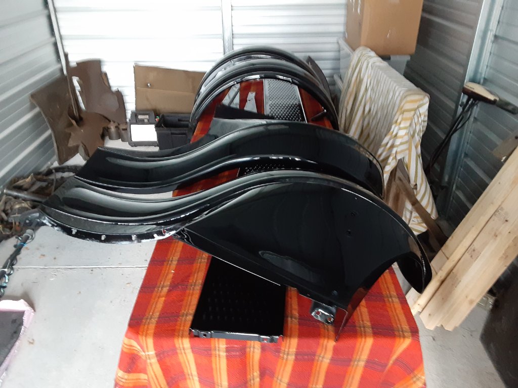

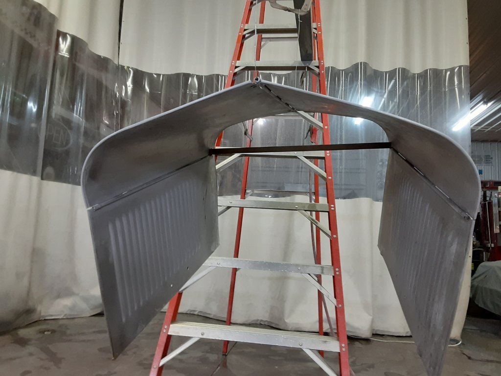

Post by BLB27 » Fri Apr 08, 2022 12:29 pm
Splash panels painted and restored items in storage shed waiting for body to be painted.
BLB27
Posts: 892
First Name: Bruce
Last Name: Brakke

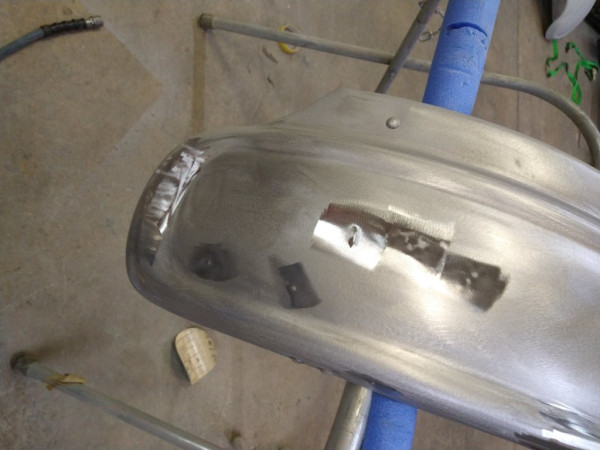

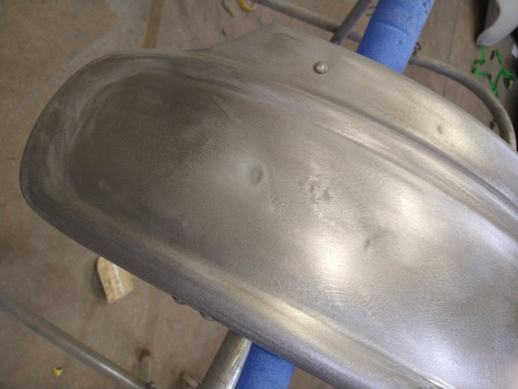

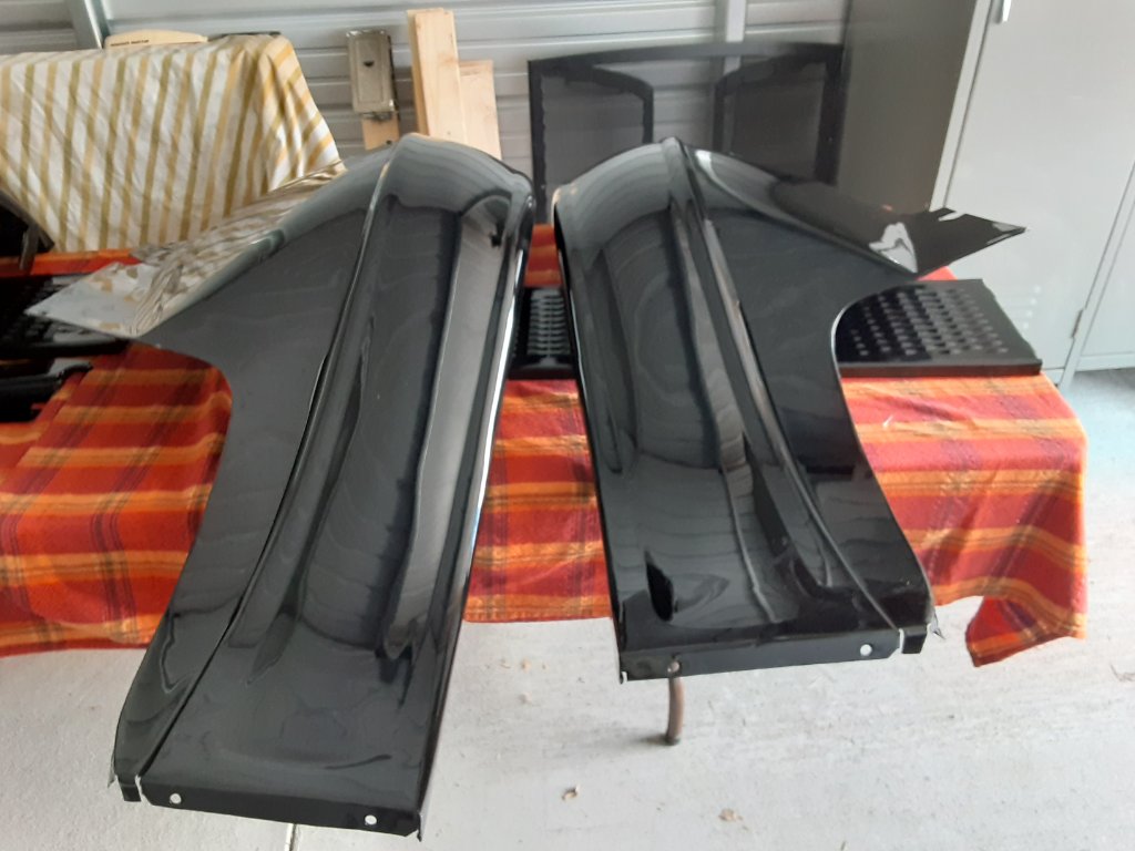

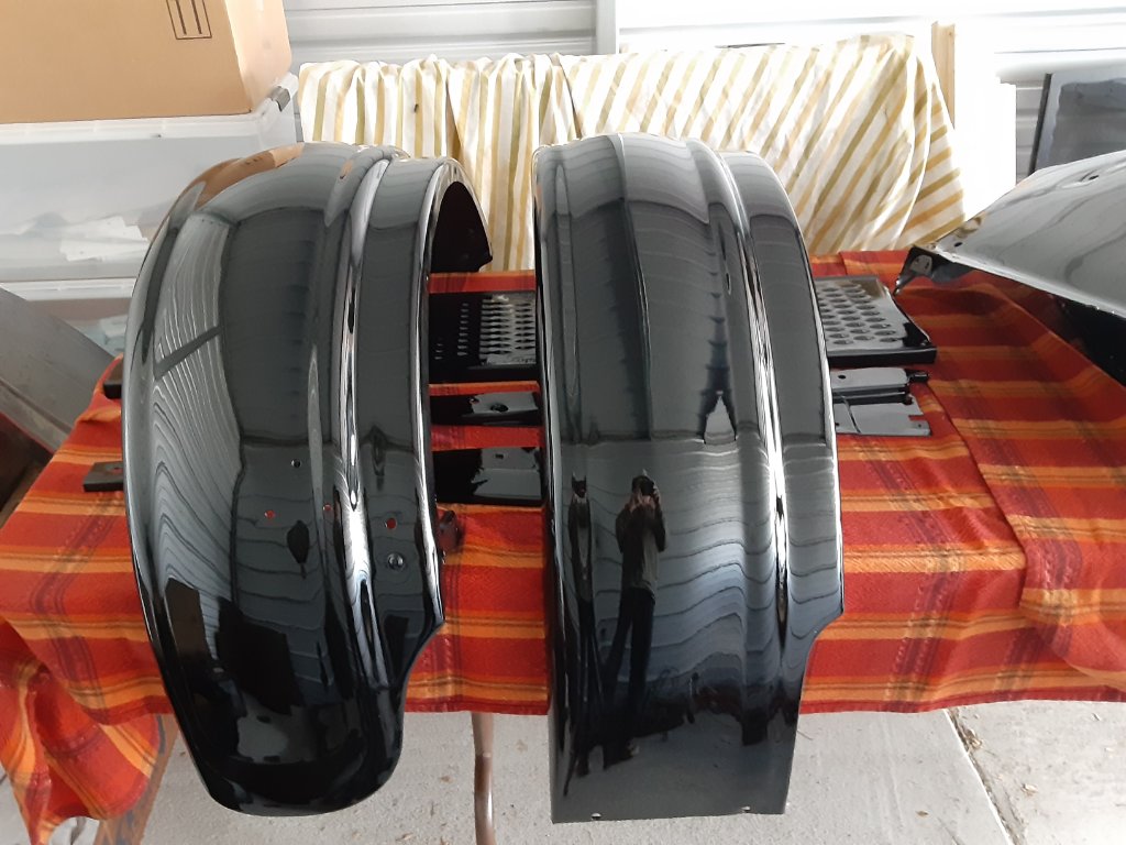

Post by BLB27 » Fri Apr 08, 2022 12:56 pm
Fender restoration.
Posts: 2549
Last Name: Strange
Post by CudaMan » Fri Apr 08, 2022 1:01 pm
Wow, great job on the paint! :)
BLB27
Posts: 892
First Name: Bruce
Last Name: Brakke

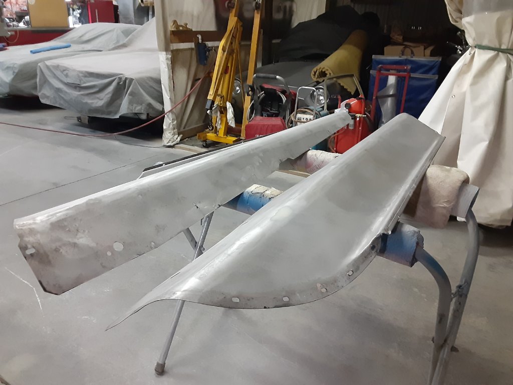

Post by BLB27 » Fri Apr 08, 2022 1:31 pm
Fender and running board restoration and headlamp rod, apron, and splash panel.

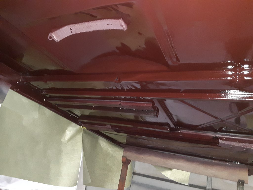

Post by BLB27 » Sun May 01, 2022 10:07 pm
Body delivered to shop for painting.
Post by BLB27 » Tue May 03, 2022 7:43 pm
Photos in the paint shop. First one shows the sample of the maroon color for the body.

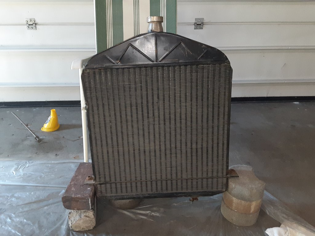

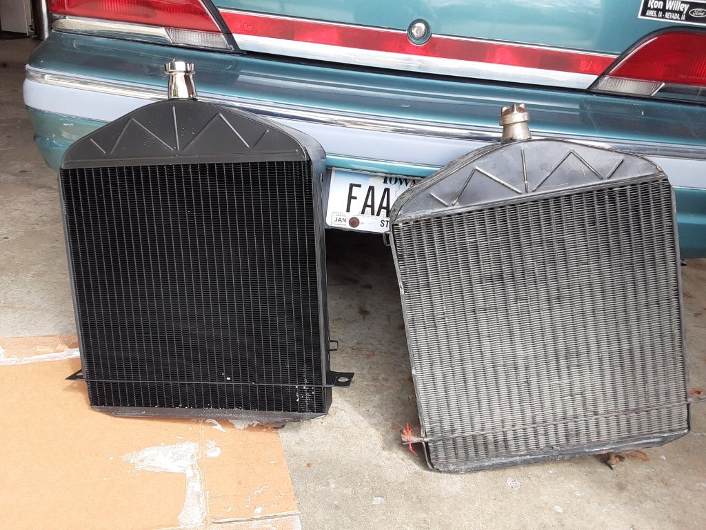

Post by BLB27 » Thu May 05, 2022 8:31 pm
New radiator. It was very well packed!

Post by Joe Bell » Thu May 05, 2022 9:48 pm
Look like twins.

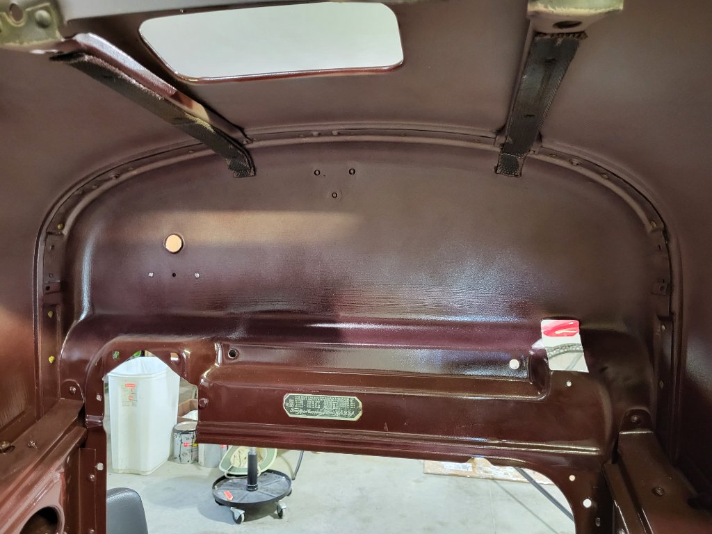

Post by BLB27 » Fri May 06, 2022 9:44 pm
The body is painted. I took Ardith to see it at the paint shop. She liked it! Will bring it to the garage on Monday.

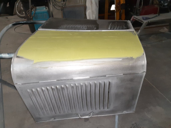

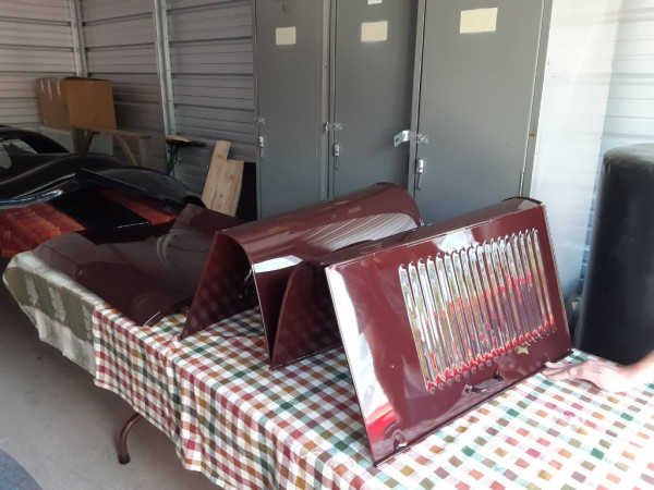

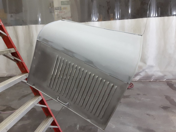

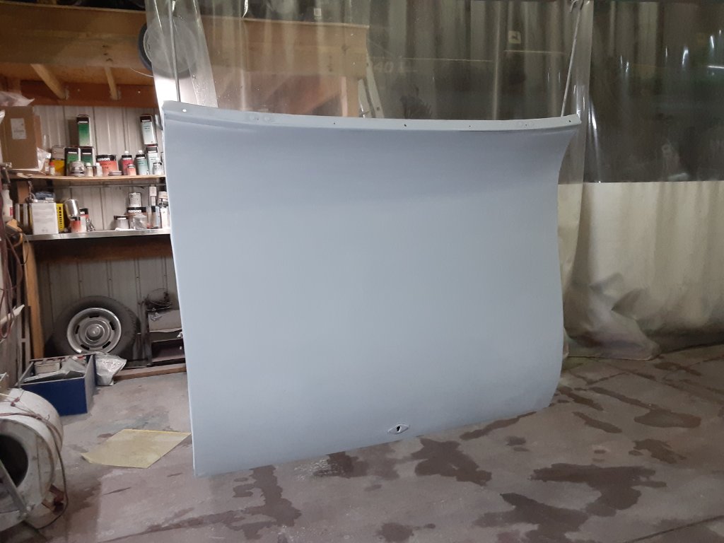

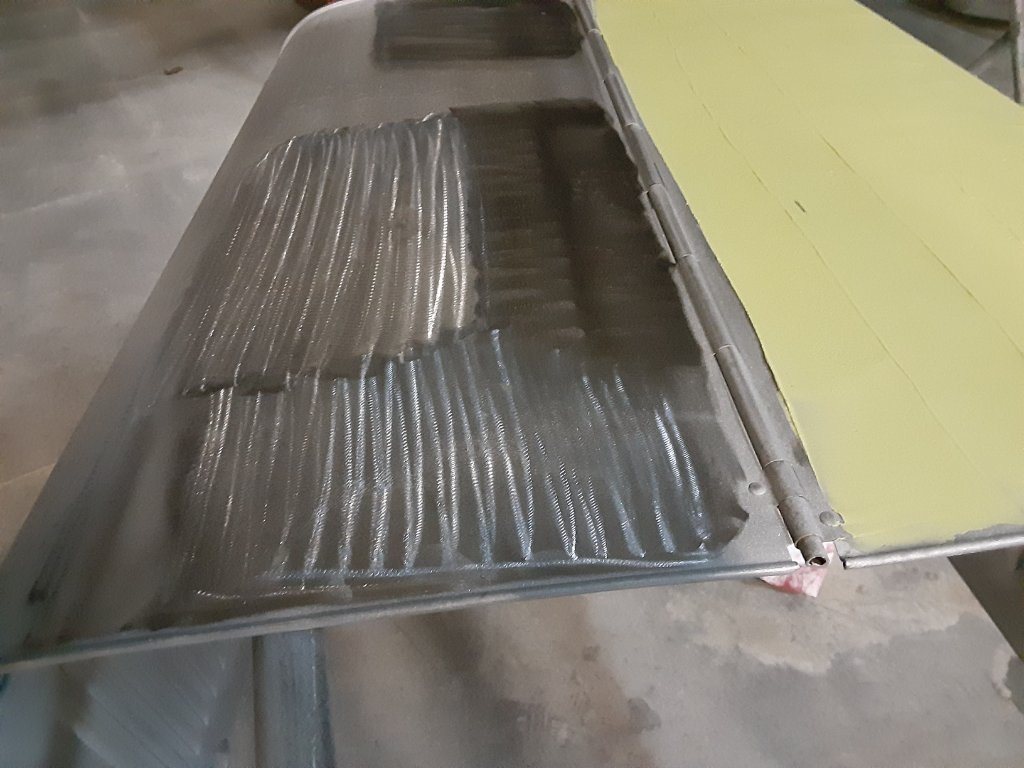

Post by BLB27 » Wed May 18, 2022 9:58 pm
Hood and trunk lid repaired and painted.

Post by BLB27 » Wed May 18, 2022 10:29 pm
Photos of getting the body home in the garage.

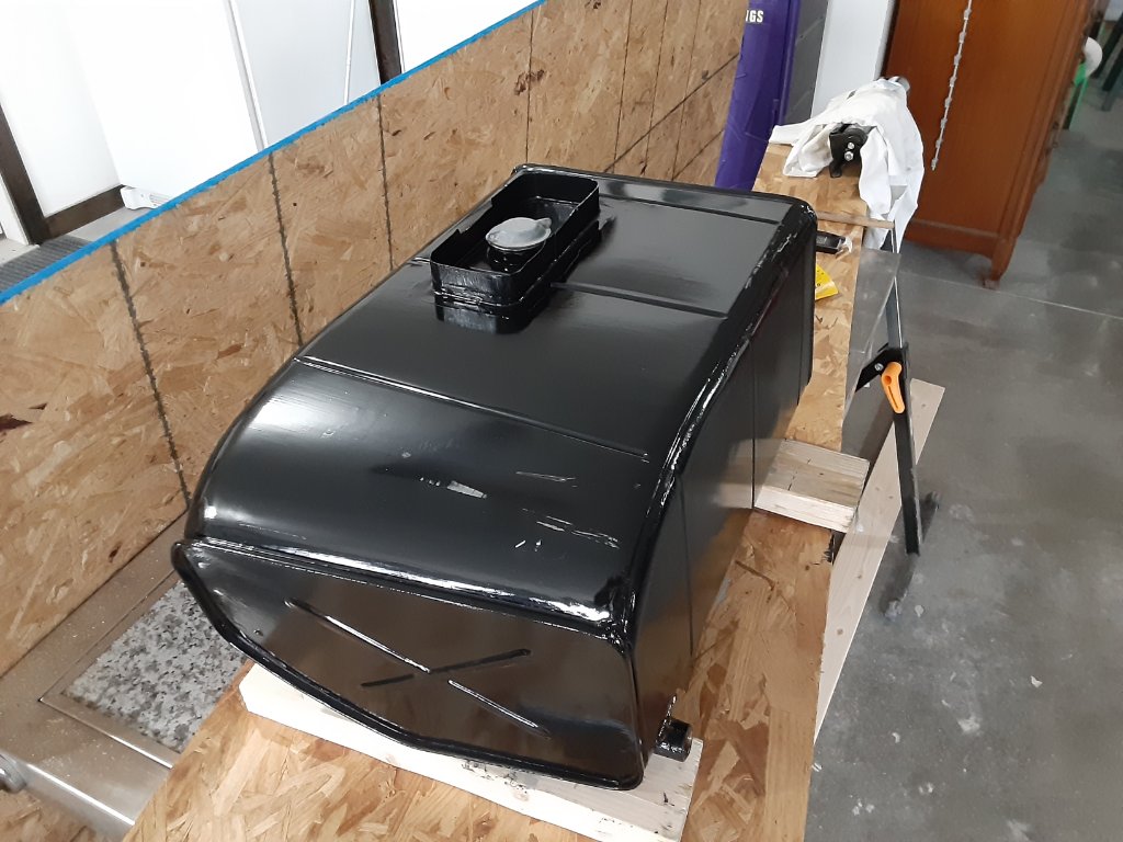

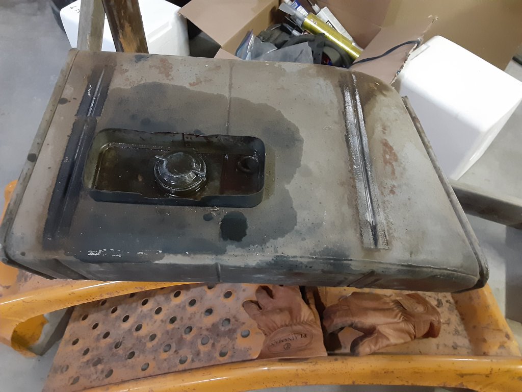

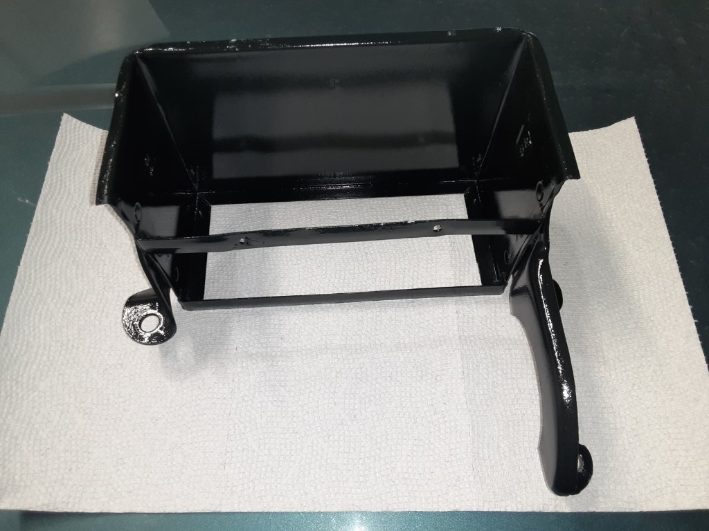

Post by BLB27 » Fri Jul 29, 2022 11:00 pm

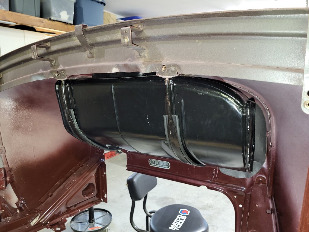

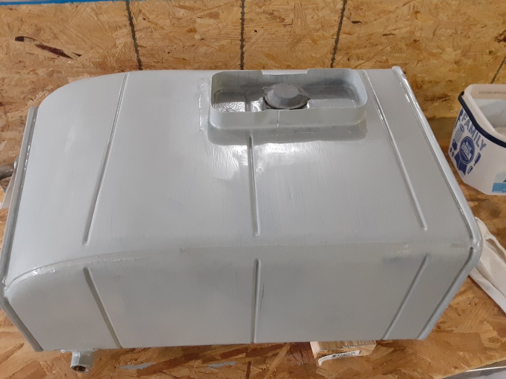

Reinstalled the gas tank. New pad between the tank and cowl, new pads on the straps, new adhesive pads on upper tank supports, and new sediment bulb.

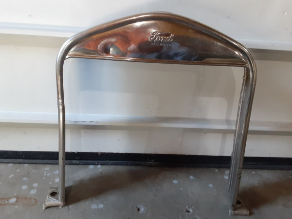

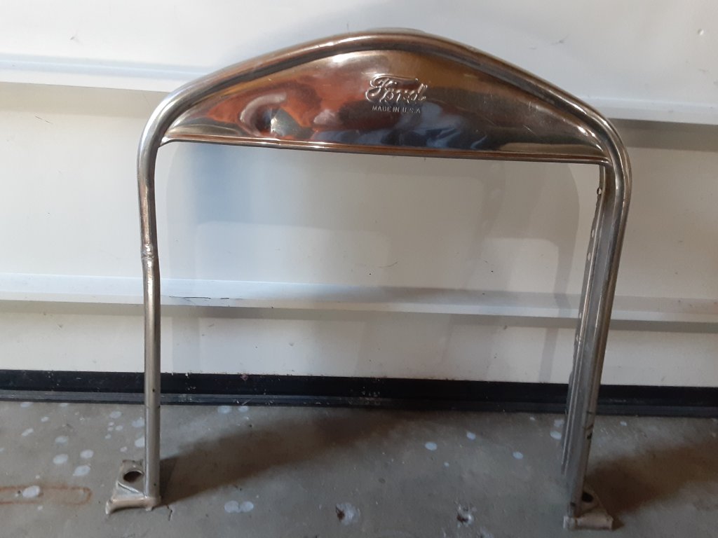

Post by jiminbartow » Fri Jul 29, 2022 11:32 pm
Bruce. How do you plan to remove the dents from your radiator shell? The dent on the front is very deep. It can be done. Have you nickel plated it yet? Jim Patrick
Check out: Www.Paulschrome.com. A place like this specializes in putting out perfect work.

Post by jiminbartow » Sat Jul 30, 2022 12:26 am
Bruce. Be sure to install the chrome (nickel) plated trim piece on your radiator apron. It makes a real difference in the appearance of the front of your T by framing the radiator in silver, all the way around and across the bottom by joining the legs of the shell. I have posted pictures of a T with the trim and a T without the trim to illustrate the difference the trim makes. They should be available from Lang’s or Snyder’s. The 3 pictures I posted of the trim are of one I sold on eBay last year. Notice the hole on the left to accommodate the brass choke wire. Jim Patrick

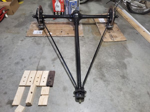

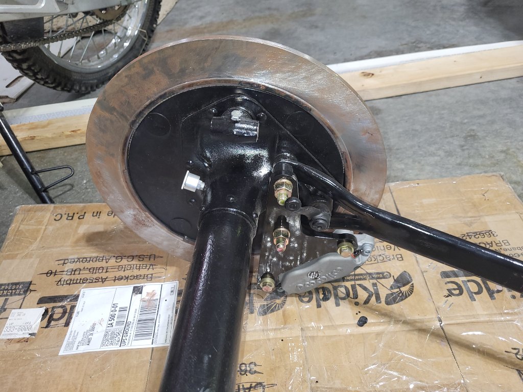

Post by BLB27 » Sun Jul 31, 2022 8:24 pm

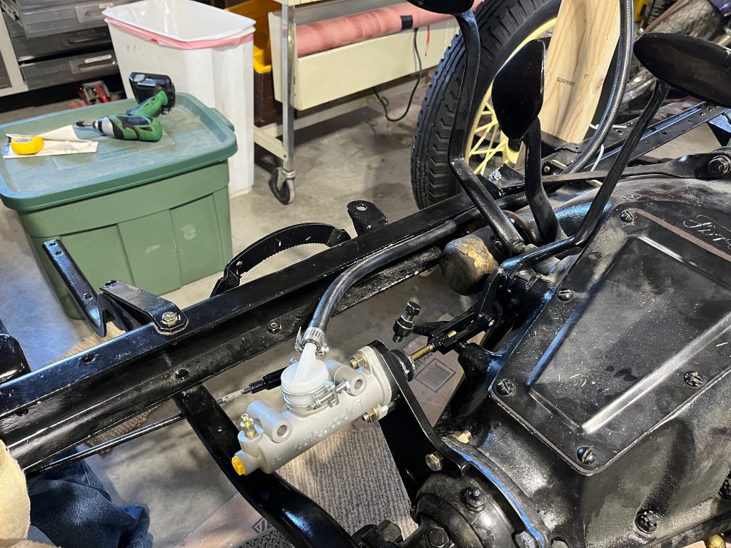

Got the rear axle back with disc brakes.
jiminbartow
Posts: 2479
Last Name: Patrick
Location: Bartow, FL
Post by jiminbartow » Sun Jul 31, 2022 9:28 pm
Bruce. You may find that the right and left rear body blocks will not fit. At least that was the way it was for me. Hopefully, you saved your old rear body blocks so you will have a perfect pattern with which to revise the new ones to the right size. Please see the following thread I wrote back 2010 when I was seeking advice as to why the rear block did not fit, so you can see what I mean. It turns out others had the same problem and it was not my imagination: www.mtfca.com/discus/messages/118802/125665.html. If you find you are in the same predicament, you will need a table saw to revise the rear blocks so they will fit. Good luck. Jim Patrick
PS. It is possible that, in the 12 years since 2010, the problem has been corrected and the correct size rear blocks have been provided. If so, you can disregard this thread.

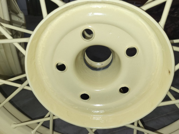

Post by BLB27 » Sat Aug 20, 2022 9:21 pm

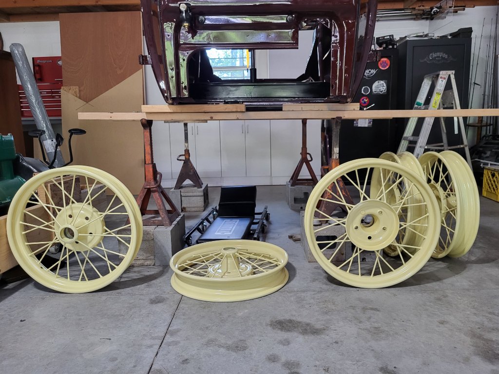

Powder coated the wheels. One small step, but a huge step for the restoration project!

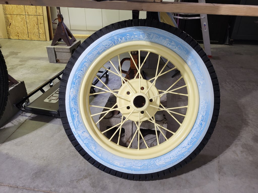

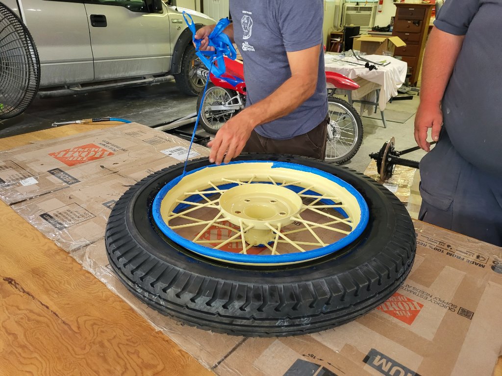

Post by BLB27 » Sat Aug 20, 2022 9:39 pm
Another small step, mounting tires on four of my wheels.

Last Name: Brakke
Post by BLB27 » Mon Nov 21, 2022 11:02 pm
Frame back on the axles.

jiminbartow
Posts: 2479
Last Name: Patrick
Post by jiminbartow » Tue Nov 22, 2022 5:06 pm
Looks great! Don’t forget to install the spring leaf alignment clamps on your springs to keep the leafs in line. Jim Patrick
Posts: 7269
Post by Allan » Tue Nov 22, 2022 7:07 pm
For others' information. Modern tyre changing/mounting machines will accommodate 21" wheels . With a bit of tape on the three mounting claws, powder coating can be protected. The fitter can adjust the machine so no other part ever touches the rim. It will roll the tyre around without ever touching the powdercoat. The tube can then be inserted and the outside bead rolled on in the same manner. No masking neded. No damage to the paintwork and best of all no cussing because of damage. Much safer than wrestling with them yourself.
Allan from down under

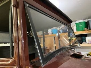

Post by BLB27 » Fri Feb 10, 2023 7:41 pm
Windshield Installed.

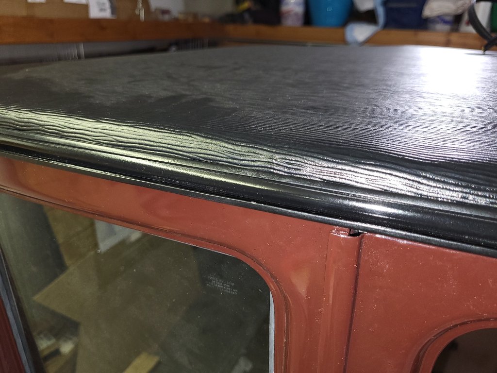

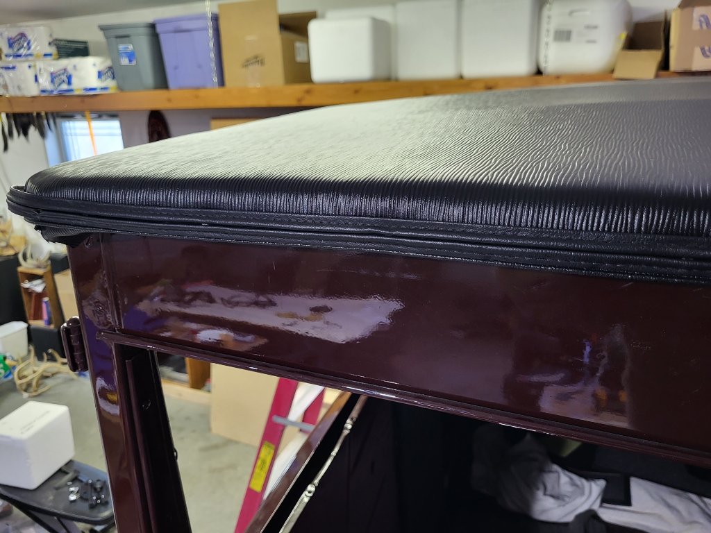

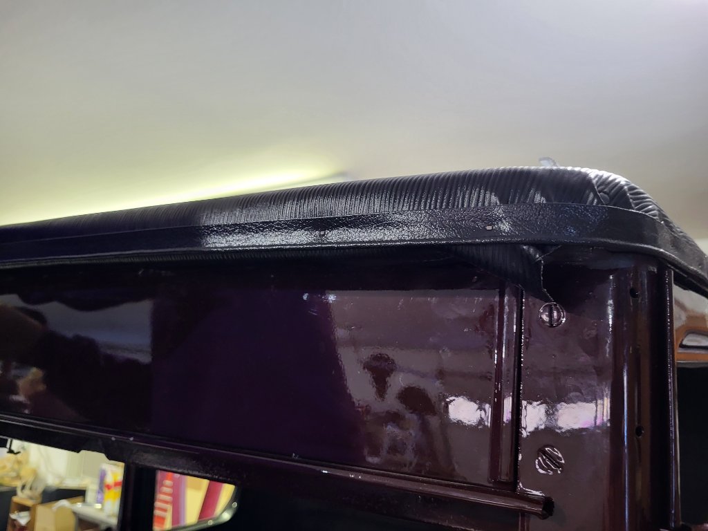

Post by BLB27 » Fri Feb 10, 2023 11:29 pm

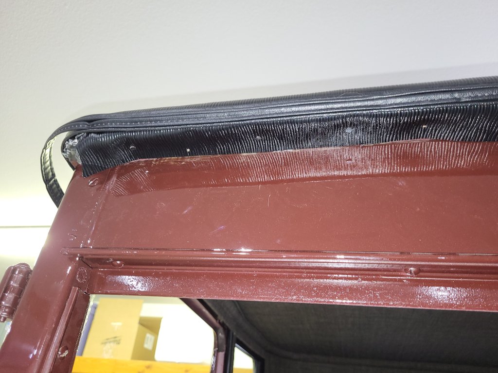

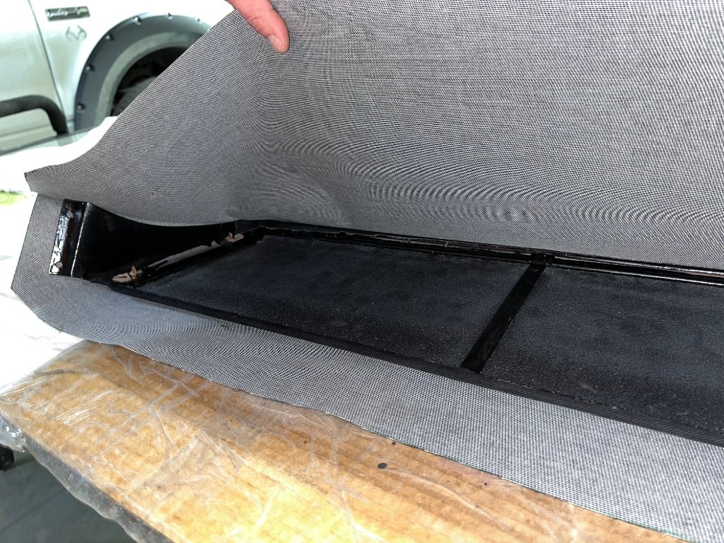

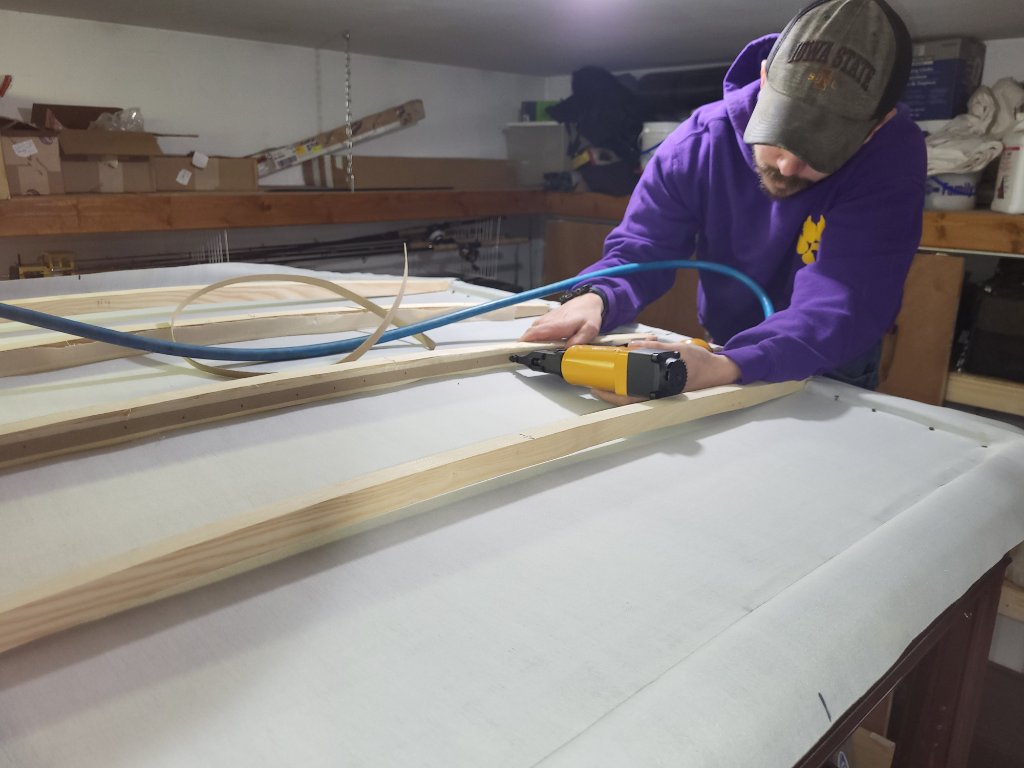

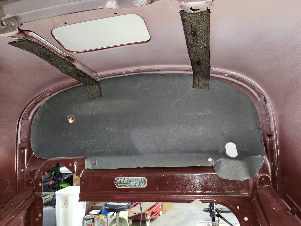

Photos of installation of top.

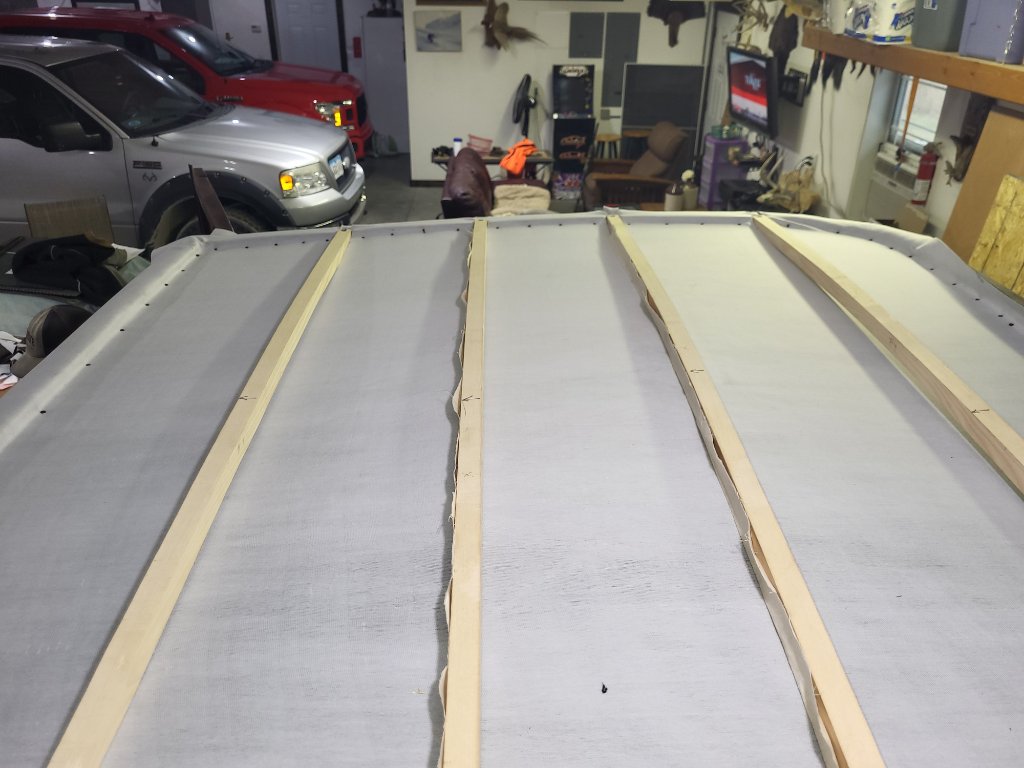

BLB27
Posts: 892
First Name: Bruce
Last Name: Brakke

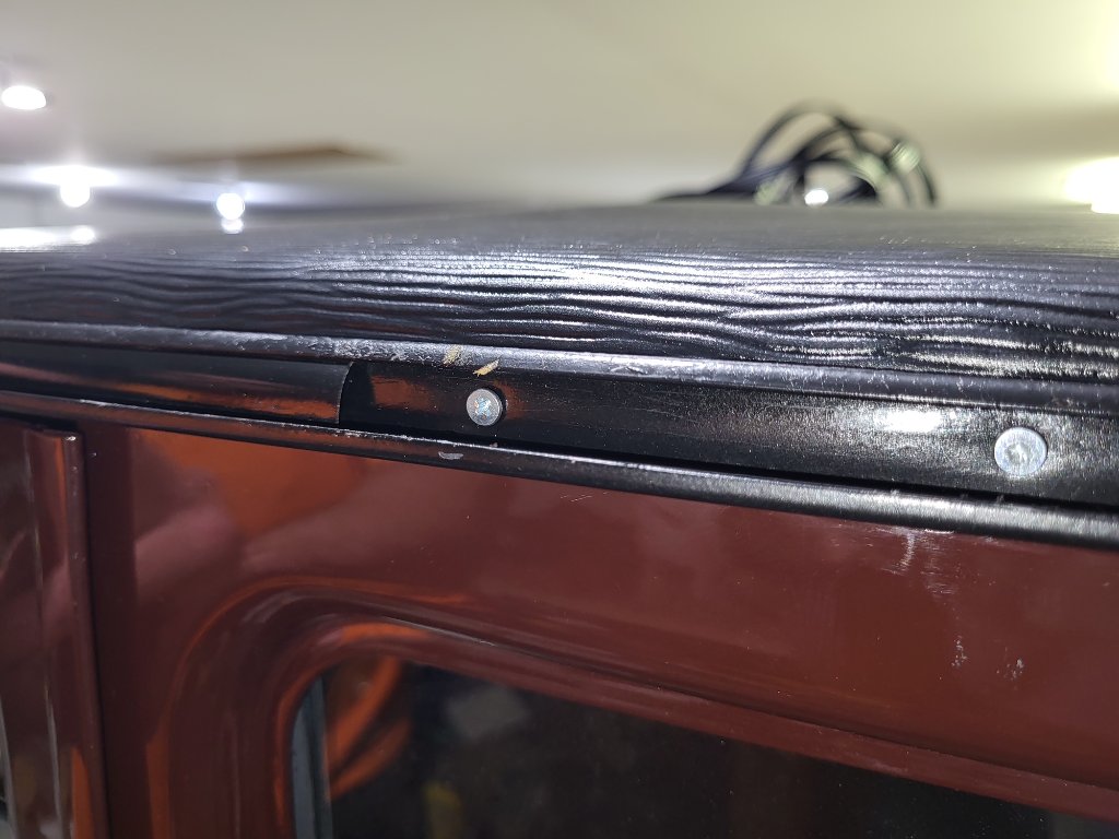

Post by BLB27 » Fri Feb 10, 2023 11:48 pm
More photos of the installation of the top.
BLB27
Posts: 892
First Name: Bruce
Last Name: Brakke

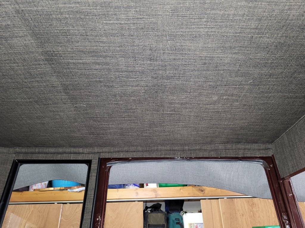

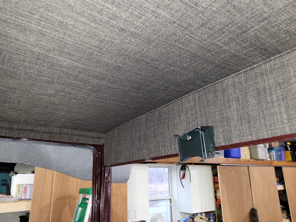

Post by BLB27 » Sat Feb 11, 2023 12:04 am

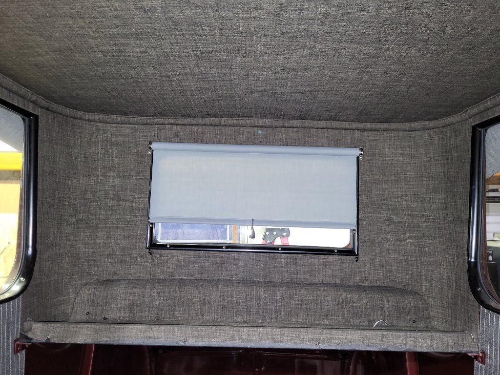

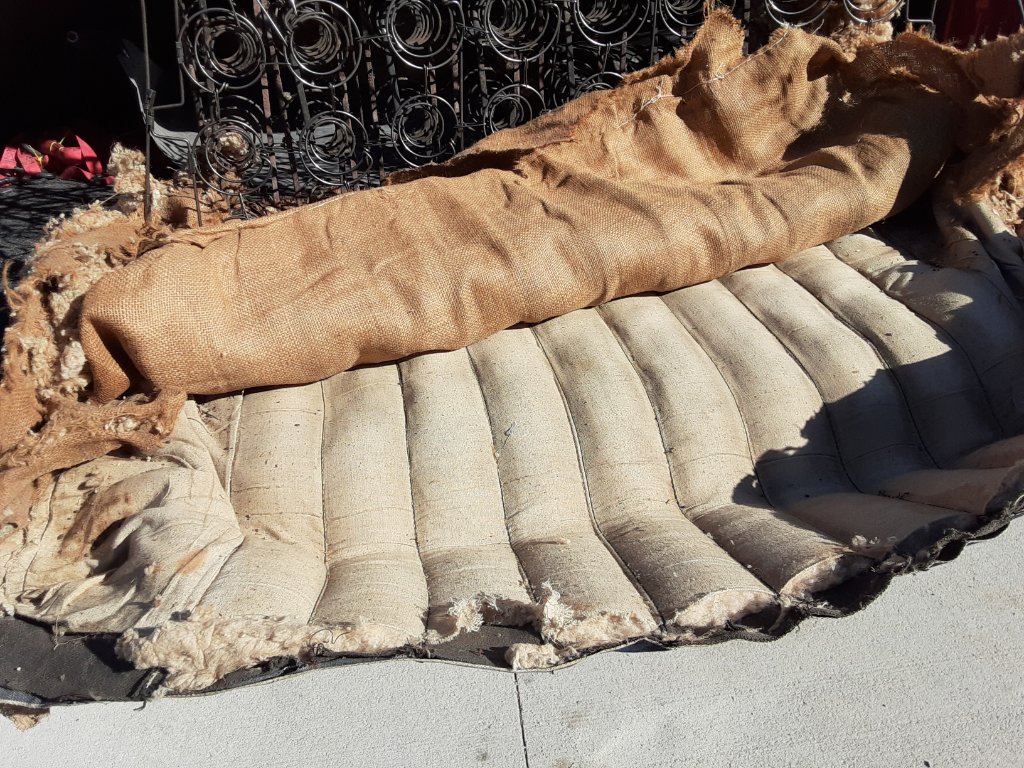

Photos of installation of top and interior material.

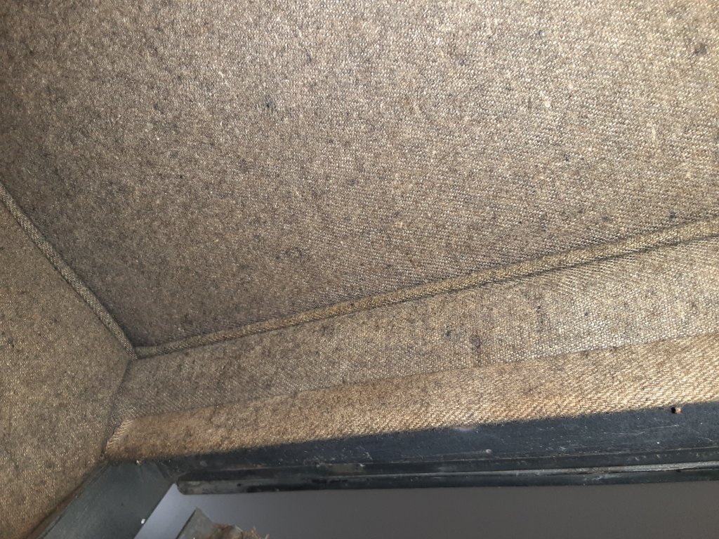

BLB27
Posts: 892
First Name: Bruce
Last Name: Brakke

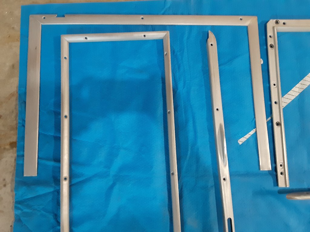

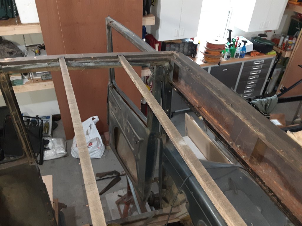

Post by BLB27 » Sat Feb 11, 2023 12:29 am

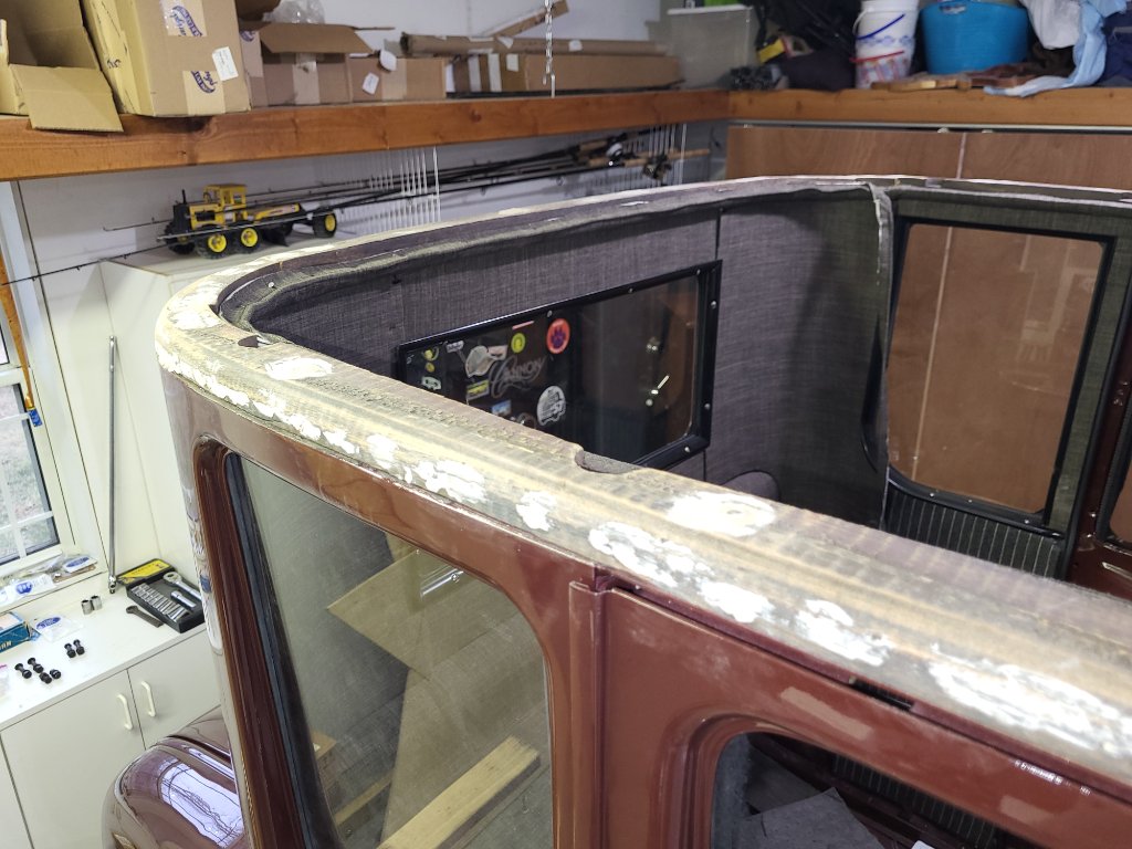

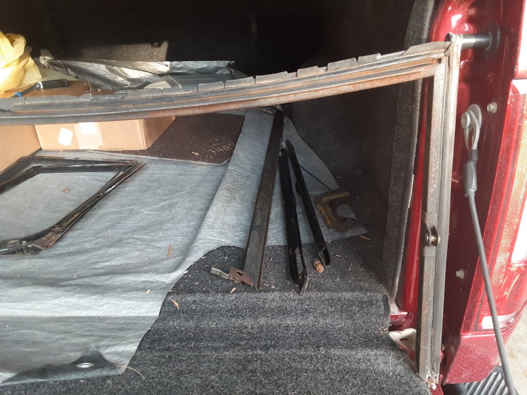

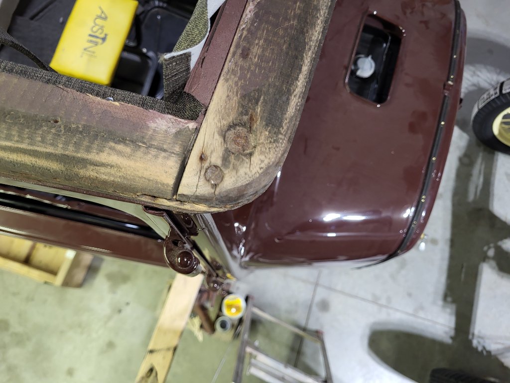

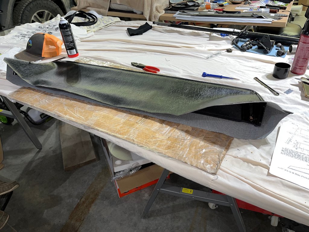

Photos of top installation. First photo is taking the original rain gutter apart. The inside piece was replaced with a piece of tape measure.

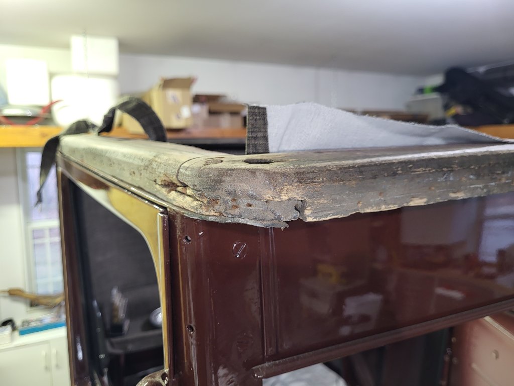

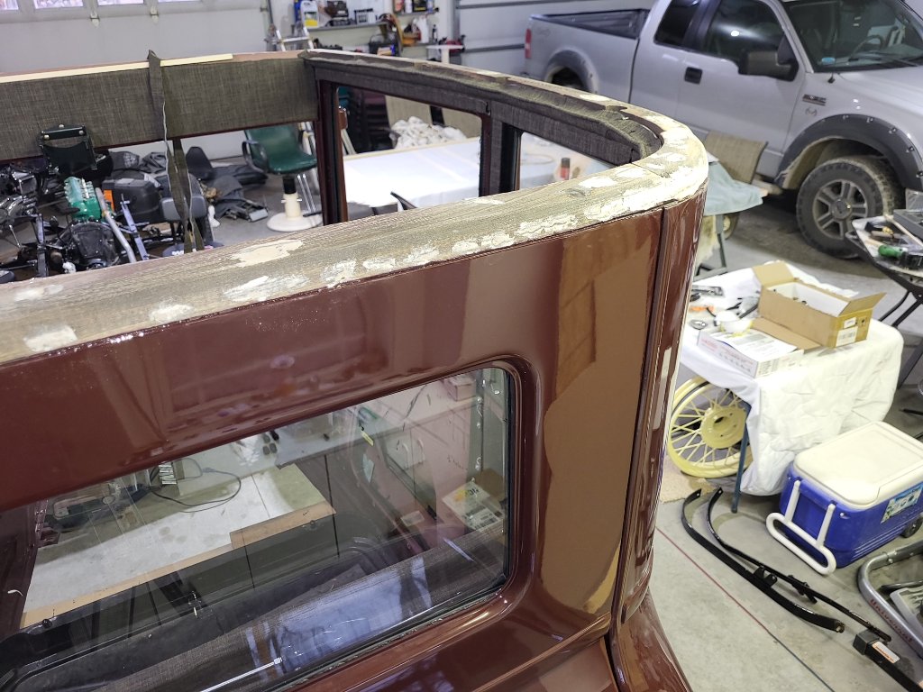

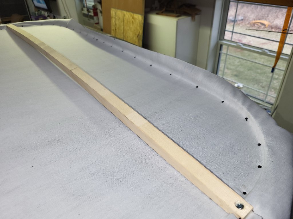

Post by BLB27 » Sat Feb 11, 2023 1:27 am

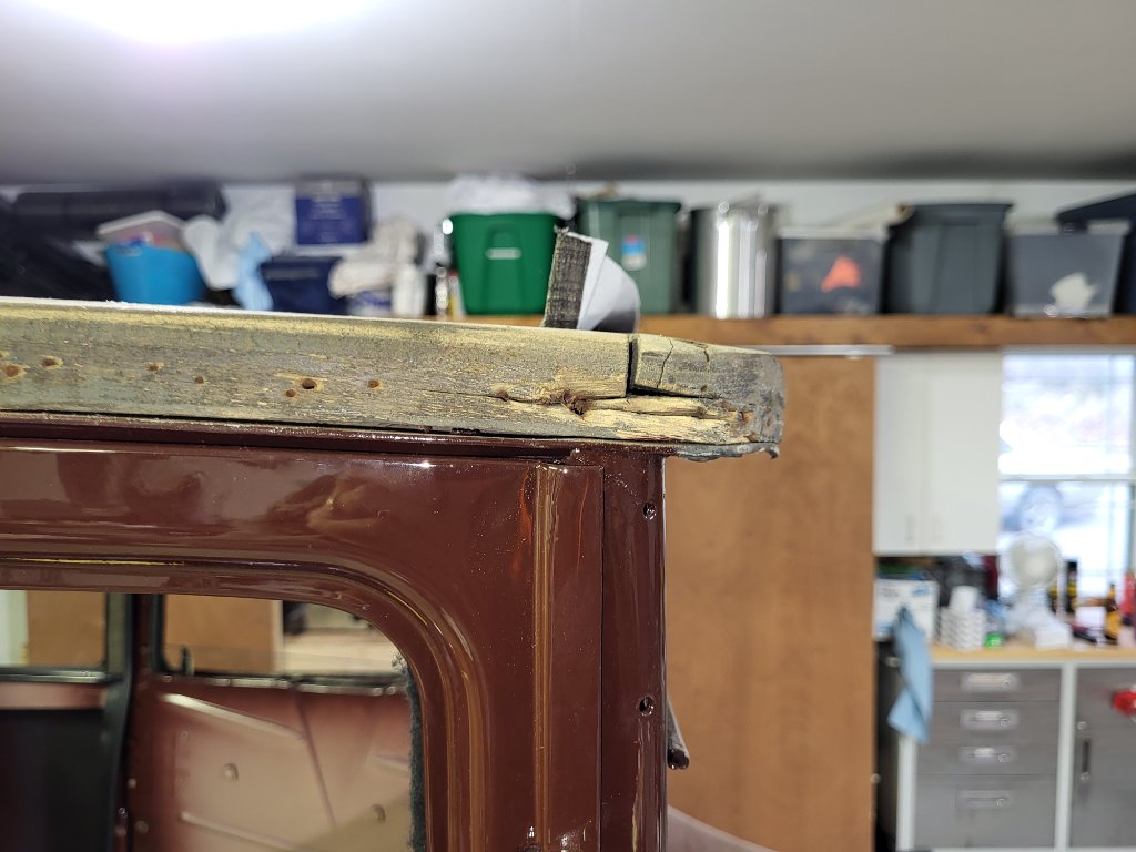

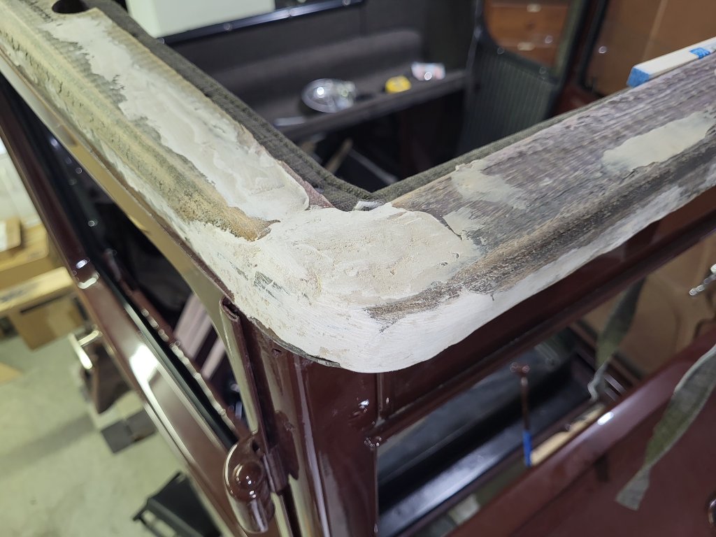

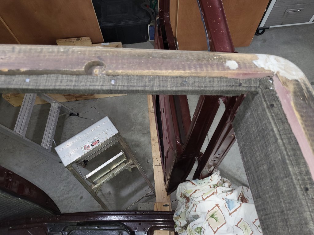

Repair of top wood. The last photo is the corner after soaking it with the "Wood Harder".

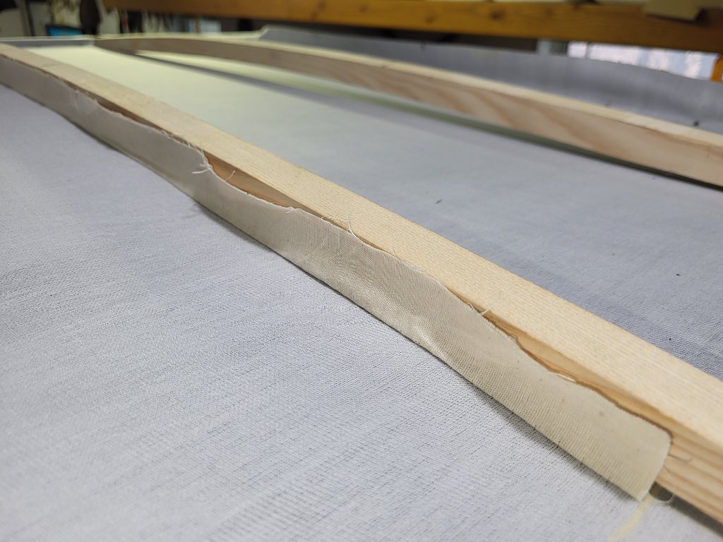

Post by BLB27 » Sat Feb 11, 2023 1:50 am
Repair of top wood frame with "wood harder" and "wood filler".

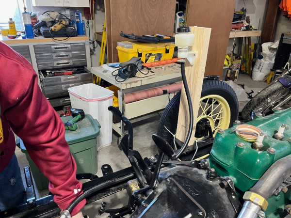

Post by BLB27 » Sat Feb 11, 2023 9:25 pm

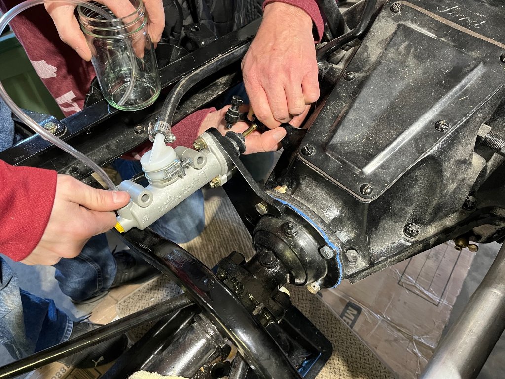

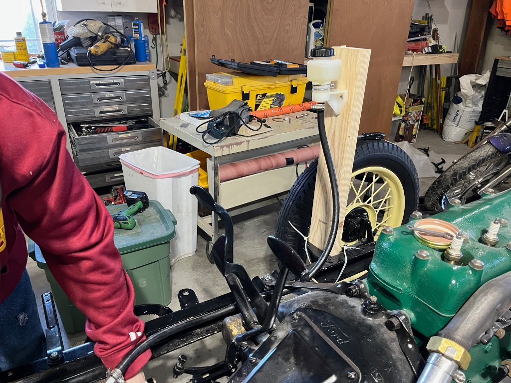

Bleeding the "SURE-STOP' disc brakes by Birdhaven. The first three photos are of bench bleeding the master cylinder and the fourth is bleeding the calipers.

Moving the frame under the body.

Post by BLB27 » Thu Feb 16, 2023 7:52 pm
Yesterday, we installed the body onto the frame.

Post by BLB27 » Thu Mar 02, 2023 9:40 am
Yesterday, we installed the visor onto the body.

Post by BLB27 » Fri Mar 03, 2023 9:44 pm
Starting to put the splash pans, running boards and fenders back on the coupe.

Post by BLB27 » Sun Mar 05, 2023 9:22 pm
Organized in preparation to install the fenders and radiator!
