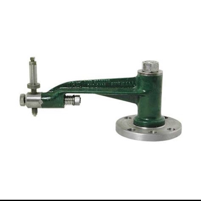

Hello Forum, I’ve been looking for a new or used KRW reproduction gap gauge. So far to late or no luck. I’ve checked with all the vendors and they say not in stock or not available. Are they still reproducing the gap gauge? As of late we have lost a lot of craftsman through retirement or passing. Just checking if anyone has any information concerning this item.

It is my understanding that the person that was reproducing the tool is in poor health and probably won't be making anymore.

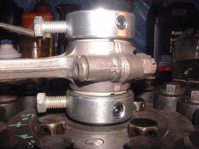

I made one like described. I used 1-1/4 ID collars above and below the connecting rod on a cut off crankshaft to keep the rod in place. Put just enough tension on the two collars to allow the rod to swing but not move up and down on the shaft. Using the rear piece of crankshaft you will need to use a spacer under it. The pins are stepped. I used a transmission shaft to fill the space. If you have a bad one, just cut the shaft part off it. Otherwise, you will need to drill a hole in your work bench for it to fit thru.

I use one of the repops. I also put a trans shaft underneath it. Be sure to true up the flange first.

Dan you’re right, used one the other day decided I need one. So far no luck. Thank all for your suggestion but I’d like to find ACC reproduction if possible. Best John

John. Friend say he got one from Lang’s about 3 weeks ago. Dan

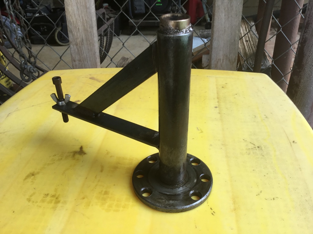

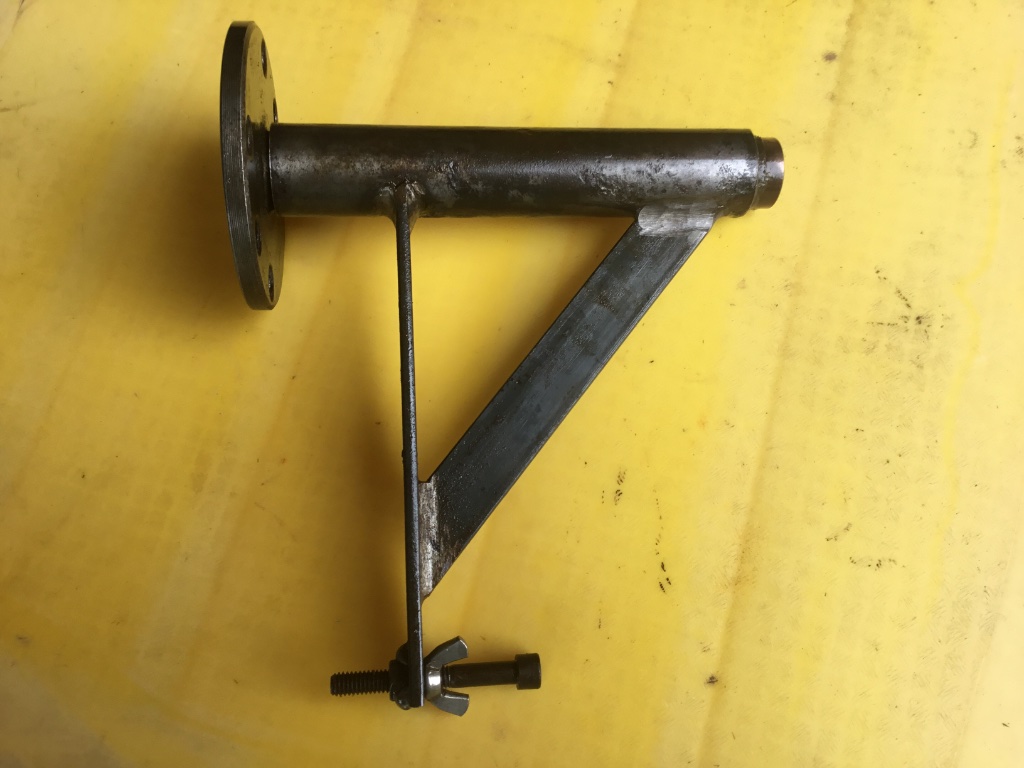

How about some photos from you guys who made your own?
Some of us follow pictures better than words.

Post by Mark Gregush » Sun May 23, 2021 10:55 pm

Post by BobShirleyAtlantaTx » Mon May 24, 2021 12:21 pm
