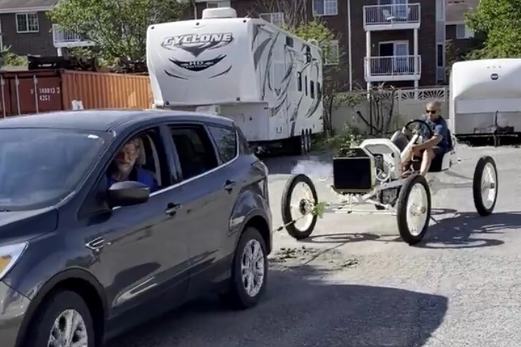

Our first start of a 1910 Ford Special racer. We haven't had this on the road since the Milwaukee mile in 2019. I overheated the motor and scored the cylinder walls and needed new aluminum pistons. :shock:
Hopefully we'll be ready for the Speedster Reunion in a week and a half. Click on the link to see the first start. I was surprised when it fired up after only a few feet pulling:
https://www.dropbox.com/s/pbulrz6amcn50 ... M.mov?dl=0
A few more driving around the lot:
https://www.dropbox.com/s/nerdwrktdziy8 ... M.mov?dl=0
https://www.dropbox.com/s/e4ibbmcpij1l4 ... M.mov?dl=0
https://www.dropbox.com/s/tbxjfzpitaqme ... M.mov?dl=0

Thanks for the videos! You made the tow start look easy, I may have to try it when I finally get my 1912 Flanders back on the road. :)

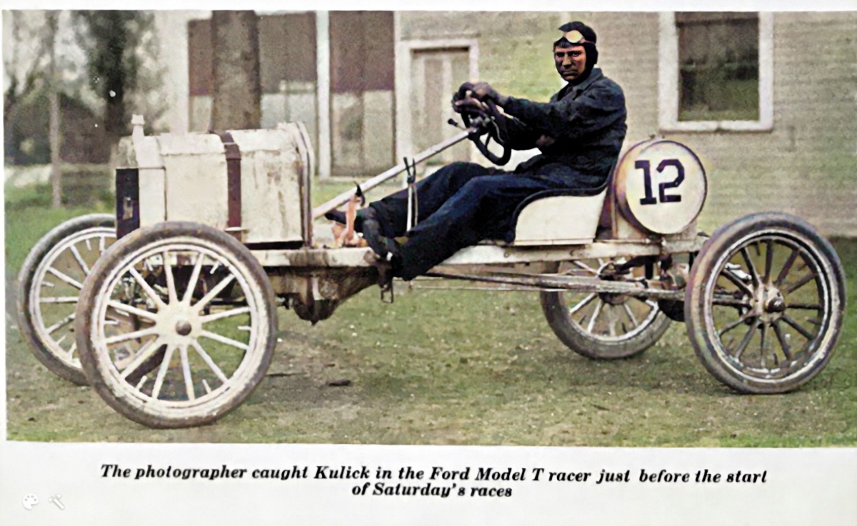

This photo appeared in newspapers, beginning in early June, 1911, of the 300 cubic inch motor racer, with Frank Kulick at the wheel. I don't know if the photo was taken in the spring of 1911, or in 1910. It appears the vegetation along the track is pretty mature, so my guess is it's a late summer/early fall 1910 photo (taken at the Michigan State Fairgrounds track), but that's just a guess:

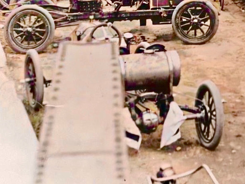

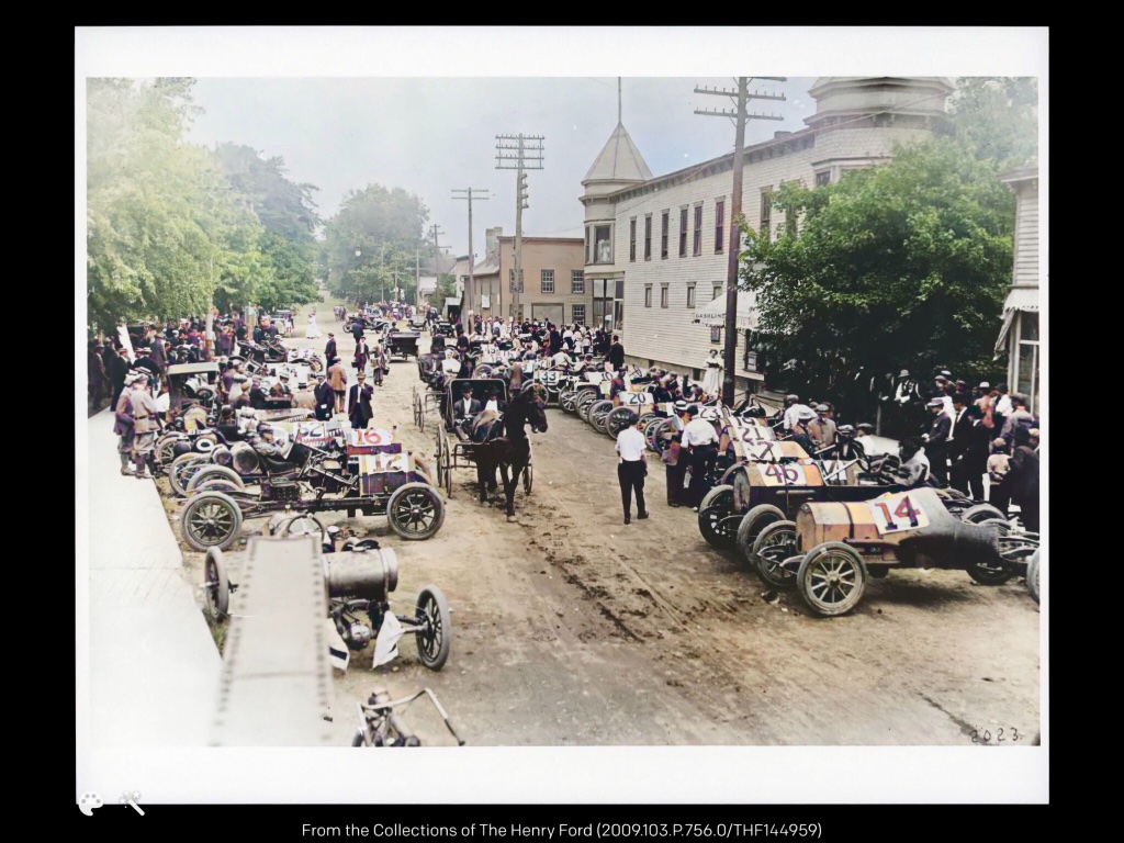

Below is a photo taken at the 1911 Algonquin Hill Climb, with a closeup of the 389 c.i. racer differential. The racer was using a 1 1/2 : 1 ratio rearend, explaining the large pumpkin. This racer, unlike the 300 c.i. above, also has external brakes, only seen in the last two 389 and 410 c.i. racers:

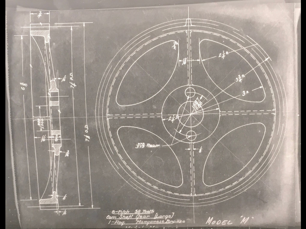

I know our motor matches Ford drawings labeled "M-III." There are also drawings for M (389 c.i.), M-1 (410 c.i.) M-II, M-IV and a few for M-V. There are also drawings for a "3 13/16ths engine," which I believe is the special racer sent to France in 1911.
Below is a drawing of the flywheel used on all the motors (other motor numbers listed at the bottom, cut off on this photo):

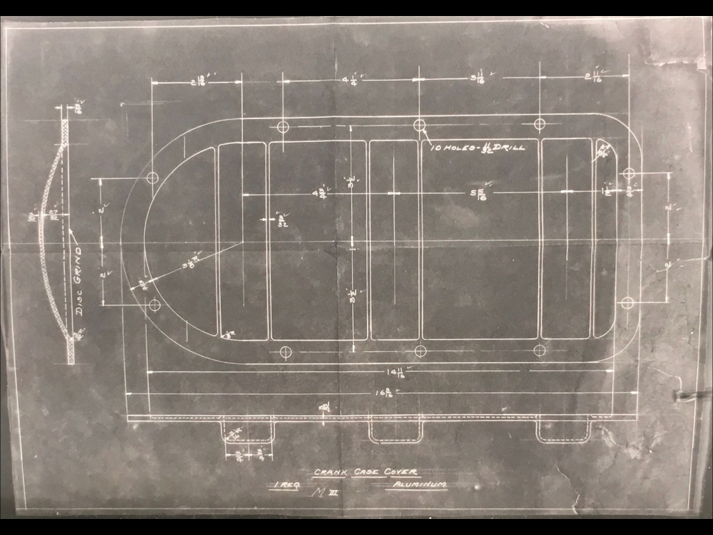

This drawing for the M-III three dip pan matches our pan measurements, as do the other M-III drawings. The last and largest M-1 motor (410 c.i.) had a four dip pan and the front wishbone was attached under the axle. This racer first raced in September, 1911, beating the Blitzen Benz in a one mile match race for time. That was Ford's last track race with the special racers. The next year the big racer went 109 mile an hour on ice, and won Algonquin Hill Climb, setting new records in doing so, beating several of the best racers in the world, including Mercer, National and others.

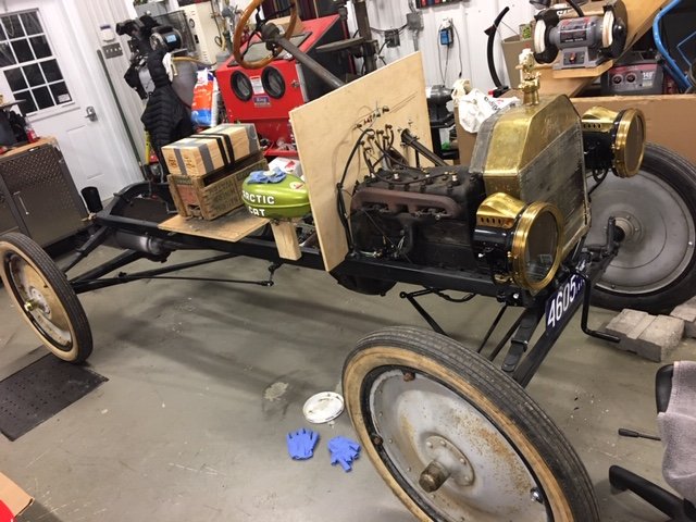

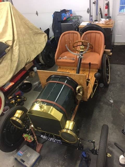

Awesome Rob! Thank you sharing the video. I'm close to finish my 1914 Ford racer either. Maybe this week-end he will fire for the second time. Just need to fix the rear axle to the engine.
Here picture before and after.
