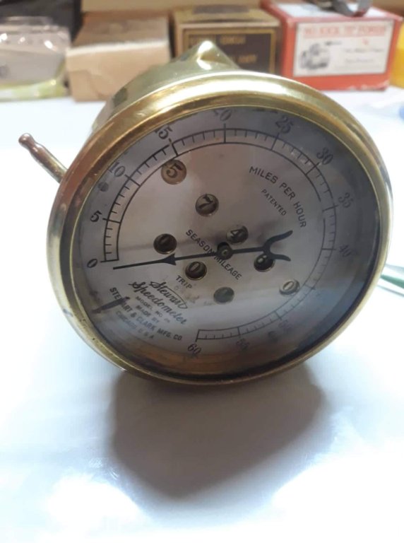

Just piecing together a brass speedometer for a car, we are not worried about it being operational but aiming for visually complete.
How is the bezel attached to the main housing? The one I have here looks like it may have had 3 copper pins holding the bezel in place? were these screws, rivets or soldered in place?
Many thanks for answers / pointers

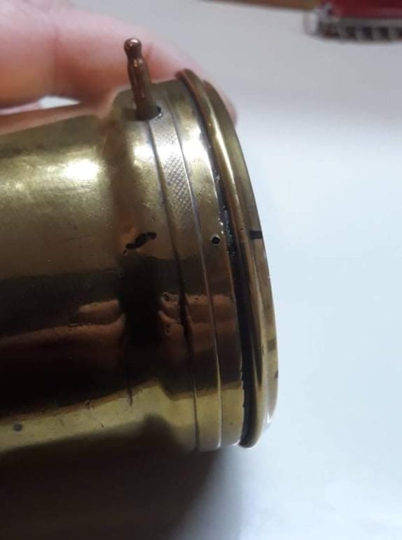

Here is a couple of photos of the one I am working on
Many thanks
Glen

Three small brass pins are pressed into the case and bezel to hold the bezel in place. The holes in the bezel must line up with the holes in the case.
