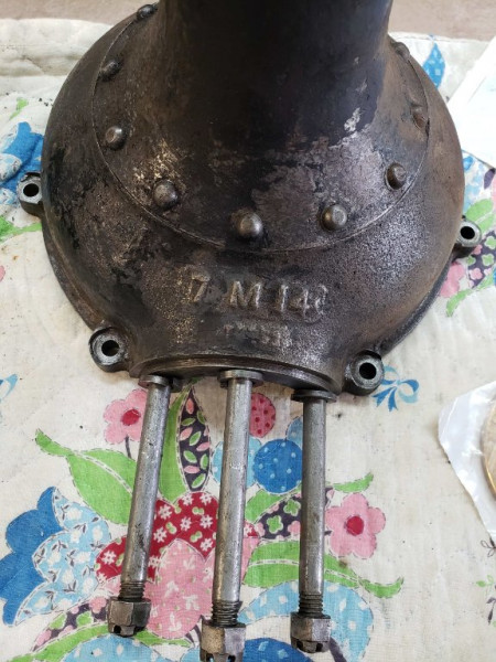

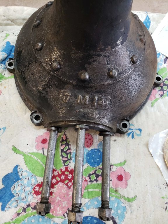

Was working on the rear axle today and dad and I were wondering if the casting numbers on the one half of the shell translate to a casting date. 7 - M - 14 shows clearly on one half above the part #. Just curious if July 1914 would be a translation, or is the set of numbers and letter have no significance.

The half with those casting numbers

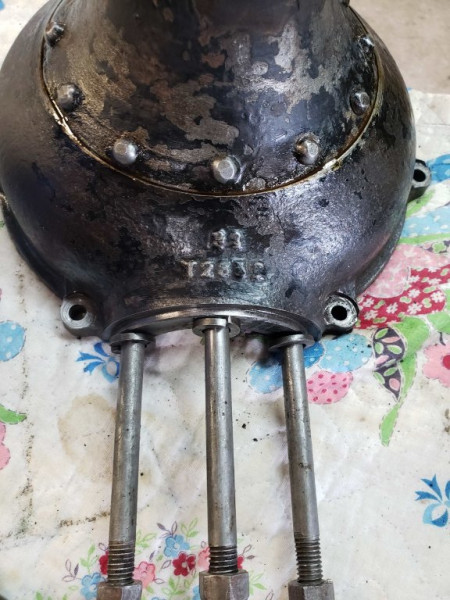

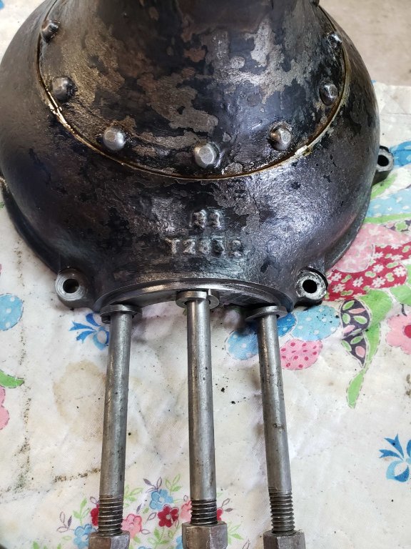

The other housing.
The other housing.

Don't use those lock washers!

The stud type bearing sleeve retainer studs have holes for safety wire. no lock washers untill later with hex head bolts.
Casting date likely. 7/13/14. Dont assume it helps date the assembly of your T. My early '15 WIDE TRACK roadster has a 13 rear end with a 2 piece D/S. Due to its rarity & low production, I believe it to have been factory installed, absent of other information. "Last in first out inventory." Wide tracks discontinued '15 or '16.

Thank you Speedy. Understood on car assembly. Just was curious about the axle only. Was thinking it might be a casting date and know that there are some great and knowledgeable people on here whom are willing to lend their opinions.
