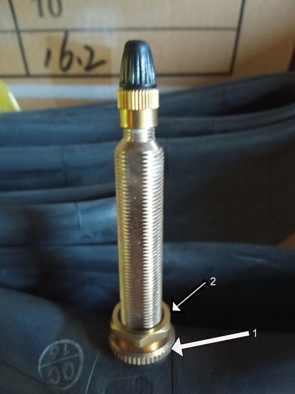

I asked Lee at Blockley whether they used Bridge washers and he said "no." I wonder if any of you who have purchased Blockley tubes have used bridge washers in your installation. Did I mention I also have flaps :-) You'll notice that the lower knurled nut (1) in the photo has a bit of a collar which I suspect would fit in the hole in the flap and rest against the rim. My understanding is that nut (2) goes on the outside of the wheel side of the rim.
Any thoughts vs a vs the importance of a bridge washer with these tubes? If you're Steve Jelf the bridge washer squeezes the tube to make an airtight seal but that isn't the issue here.

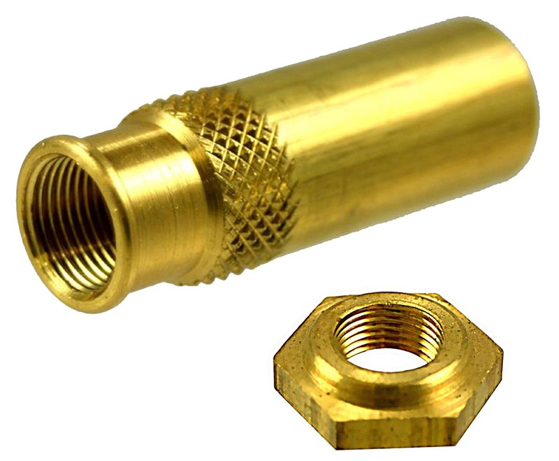

I would not disturb the factory installed knurled nut. If you want to fit a bridge washer put one on and hold it down with the plain nut supplied. Even the cheap and nasty repop bridge washers without the raised ridge would suffice. I don't know how a flap would interfere with this fitting. if you follow Blockley's instructions, flaps are not needed. My guess is that does not apply with wire wheels directly laced to the rims.

With the stem vulcanized into the tube, what would be the function of a bridge washer? I would do as Lee suggests and skip it.

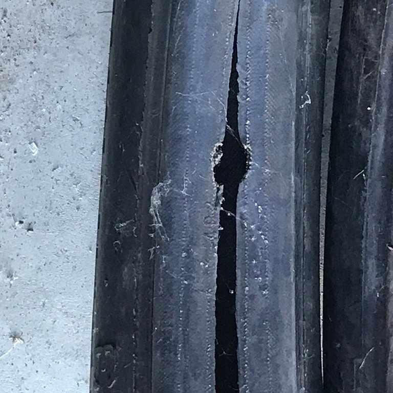

Some clincher tires come together at the beads when installed on the wheels. That situation can pinch tubes and cause them to fail. I know this is true, because it happened to me on a car which I bought which had no flaps. Rim liners won't help in this situation.

I installed my set with no bridge washer, just the way Blockley shipped them. Additionally I used flaps and had no problem. They seem just fine to me. I trust Blockley researched this out already.

I used metal stemmed tubes and flaps when I put my tires on. The tubes were new ones and the stems were vulcanized to the tubes. I installed a bridge washer over the flap after sticking the stem through the hole in the flap. So, the bridge washer holds the flap down on the tube. My thought here was to use the bridge washer as a spacer to help keep the tube area around the stem up above the clincher part of the tire.

Besides locking the tube to the stem, don't the bridge washers also help keep the stem from turning when you put the outside nut/cover on? Of course, if the stems don't have the flats on each side, bridge washers are not going to help; https://www.mtfca.com/discus/messages/4 ... 1402150243

The bridge washer is necessary to sandwich the tube between the washer and the flange on the valve stem to provide the seal between the two parts.
Blockley valve stems are vulcanised into the tube, so a bridge washer is not required.
The Blockley threaded stems are the same size as the larger Schraeder stems, which are the most common size. Any original combination will fit, just not the smaller less plentiful size used on original T tubes. I can understand Blockley rationalising their inventory and using stems suitable to a greater range of tube sizes.

I know Blockley says no bridge washer required, but looking at the photo of the cross-section of a Universal T-Driver there is a pretty good space between the bottom of the tube / flap and the rim. It seems to me that a bridge washer would relieve some of the strain on the stem when you snug down the rim nut.... Maybe it doesn't matter....still thinking it over.

Rubber valve stems have no bridge washer, obviously. They also have no extra nut. If that is OK with them, why does a metal stem require the extra nut? None of the current vulcanised metal stems have the bridge washer or the extra nut. It would appear that the wholly threaded stem may just be so the dust covers can be utilised. I solve the fitment of these by using Dill covers, which thread onto the small valve cap thread on the end of the stem. In brief, none of my cars has the threaded nut. I would like to know why/how it is supposed to be of benefit.
