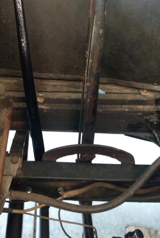

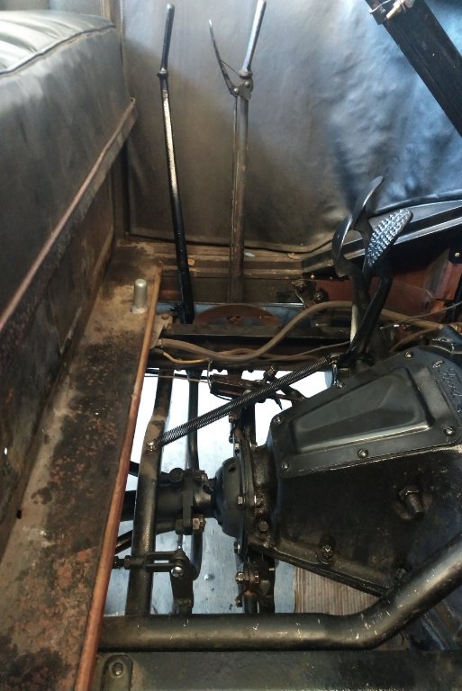

O my God. I finally got some pix to load.
A ways back, I mentioned building left side rux shifters in a discussion. Pix were requested.
Why a left side shift? To shift a rux, you have to be able to use your throttle. With a center shift, one must go thru a bunch of unsafe contortions, unless there is a foot throttle. Left lever takes no room from the driver. Easy to hold steering wheel & use the throttle with the right hand & shift the lever with the left hand.
It is made from a second parking brake/ clutch unit. Mounts directly behind the original. (4 holes)
Pawl, & lever are removed, holes welded up & handle shank reshaped. Brake actuating levers bobbed.1/4"x1"x 3.5' plate with a few 5/16' clevis holes welded on as shown for shift rod.
Makes for a really clean set up. Lever is bent out board of parking brake lever. Its handy & out of the way.
Shift rod is made from 1/2" thin wall conduit. Rux end has 5/16" clevis welded in the end. Front end has a 5/8"x 3/4" cold roll steel piece threaded 5/16-24 welded in the end. A short piece of 5/16-24 all thread into another clevis for fine tuning hand lever angle. There is a slight bend @ the sediment bowl to clear.
If anybody asks, you tell them its a 2 lever 3 pedal T.
Only down side is having to drill 4 new holes.
For my 14, I wouldnt drill new holes. I mounted 2 short pieces of 4" x 1 1/2" U channel To the bottom of existing brake lever mount holes & mounted the 2nd brake lever unit on top. Lever is inside(right of) & inline with the original lever. It is shortened to match the brake lever height. This configuration does take away from compartment room. & lever cutout needs to be widened, instead of lengthened.

Tom Carnegie from Spokane made up a similar left-hand shifter utilizing the same holes holding the original cross shaft with the addition of a steel plate - completely "bolt-on" pretty slick !

After buying my first T with a Ruckstell, with left shifter, I have to say with what few times, twice, that I've used it, I can definitely see the advantage to having it on the left side. And of course it doesn't take up room in an already tight area anyway.

For Oldavator.
Past post on the subject with pictures.
The e brake slot gets lengthened back about an inch.

I have 5 T's with Ruckstell axles. 3 have LH shifters, 2 have RH shifters. I'll have to admit that the LH is easier to manipulate than the RH units. But both are easy and well worth the expense.
