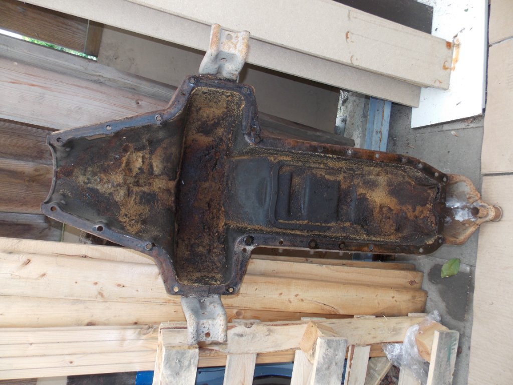

Since last week I am a member of the two pieces crankshaft club.
A while ago I bought a 1917 engine for a few $$. Last week I started to work on it.
Now I know why it was that cheap but here they say that you can't control the teets of a given horse.
Photos in attachment.
Andre

Looks like it was in pretty good condition before the crank broke! You are probably better off that it broke now rather than later. Since it appears to have had serious water in there, it really needed to be taken apart and cleaned up properly.

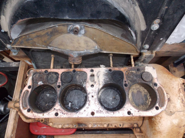

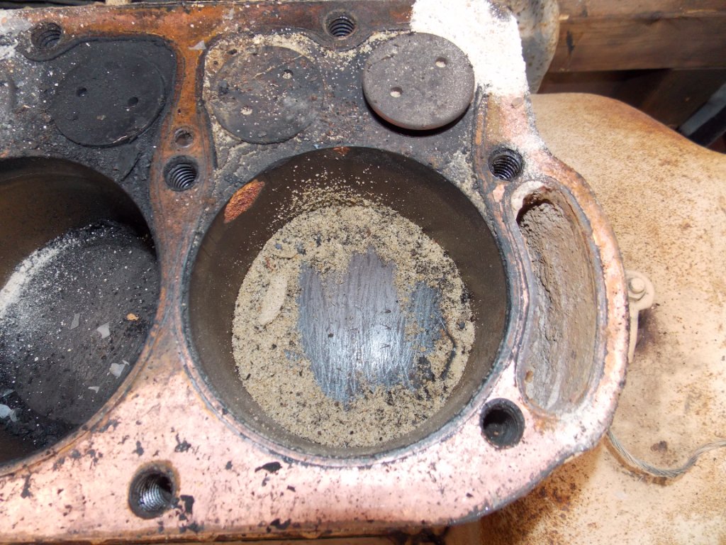

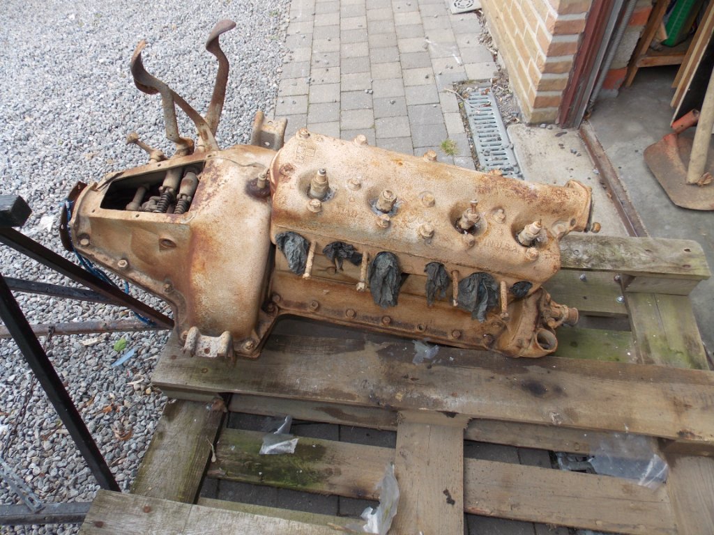

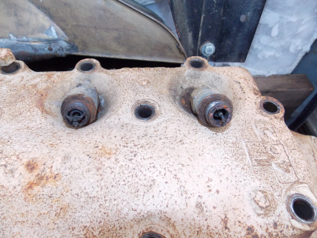

I never tried to make it running.
I paid $40.- for it in the state as it was, (photos in attachement)
Somebody asked me if it was a boat anchor. As I took off the head I found a lot of "desert" sand in the cilinders and the water jacket and no oil .
The head has 18mm spark plugs.
Andre
Belgium

Looks better than a few I have rebuilt. If the crankshaft breaking didn't do too much other damage? It may be a great buy? Otherwise, it looks like some nice almost early parts at least!

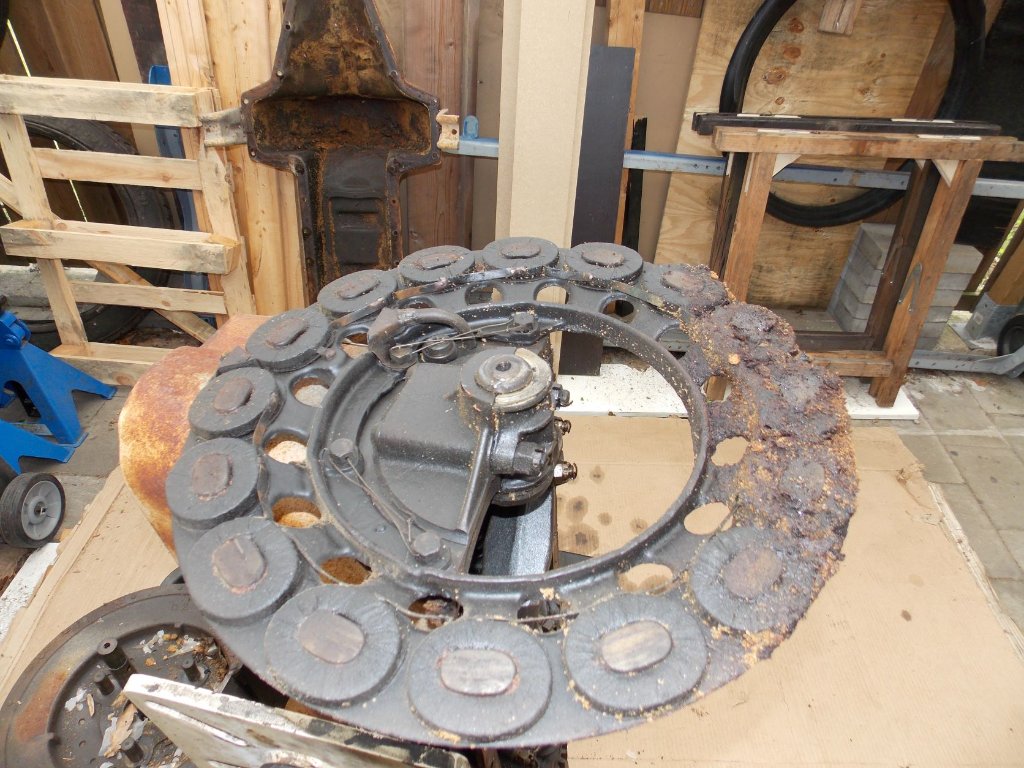

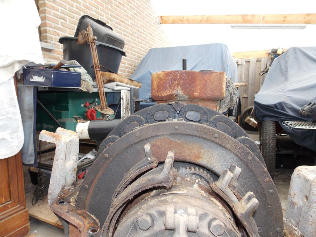

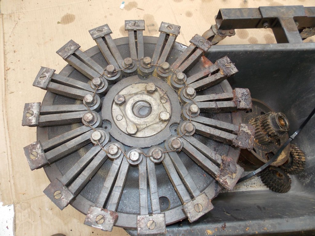

I think I found the reason of the broken crankshaft.
As I took the flywheel of the broken crankshaft part, I found a gasket between the crankshaft and the transmission shaft.
The four bolts were secured with a wire but were not realy tied. Flywheel and transmission were not tied to th crankshaft and lived there own
way.
I will take photos later and post them.
Andre
Belgium
way.
Andre
Belgium

Andre.
Sounds like a Volkswagon mechanic was the last one to assemble your engine. The VW engine is the only one I can think of that used a paper gasket on the crank to flywheel.
