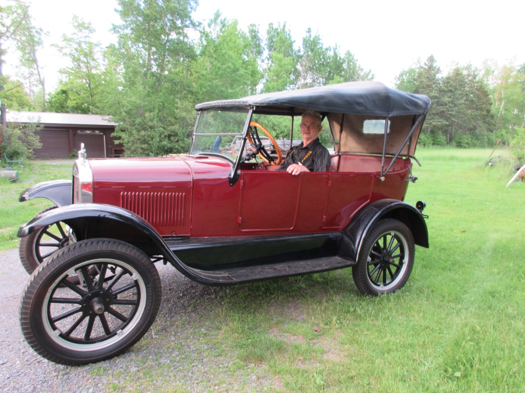

Help! Yesterday while driving my grand children the clutch made a noise and began to slip somewhat until it would no longer grab at all. I believe the spring may have failed. Looking for the best way to determine if this is so and how to best repair this. [image][image]
[/image][/image]My wife is hoping repairs can be done without removing engine as she has helped with two engine swaps this month. Thanks, John
