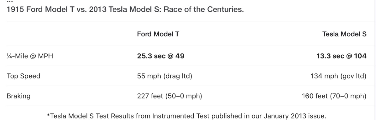

Famous race results found on line gives some indication of speed timed over distance. Not sure if this 1915 T has stock 3.63:1 rear axle gearing, but likely an impressive time. Top speed and time measured might indicate this Ford had 3:1 gearing, the engine was enhanced with aftermarket distributor ignition and Rayfield carburetor. Typical Ford top speed is 40-45.
As for reverse speed, the Ford reverse drum gears down to 14.5:1 ratio, so about 3-5 mph top speed can be done if luckily. Speed in reverse with the T is unsafe due to the caster of the front wheels. The front wheels will violently rack from side to side going backward at speed.

I appreciate the help. Thanks! But there’s a small problem with that image and that is it says the T could go 55. I’ve seen that result when googling it but I know most Model T’s didn’t actually go 55.

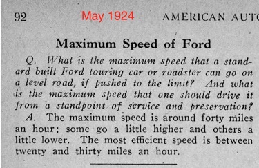

Main reason for lack of info on 'timed' speed of the Ford T is its lack of relevance to owners. Back in the early days, Fords were driven by owners in contests of 'hill climbs' to test power, these were timed but speed wasn't.
Timing the flat out top speed of a Model T on level won't be easily found in records anywhere.

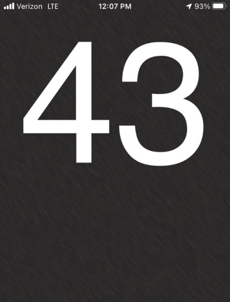

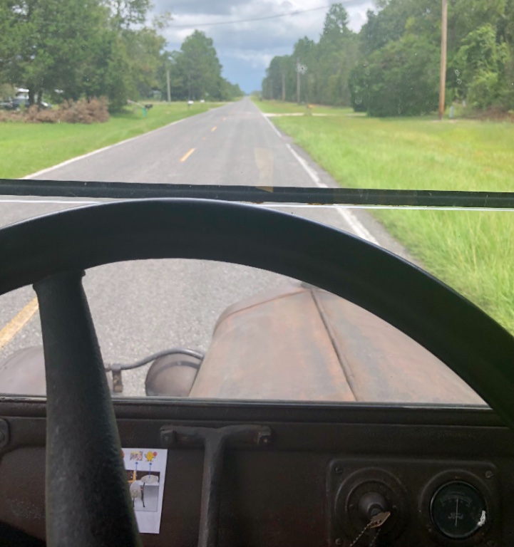

Tanner
Results of timed test, my T is stock for a 98 year old car, engine is rebuilt with alum pistons, but all other chassis parts are stock.

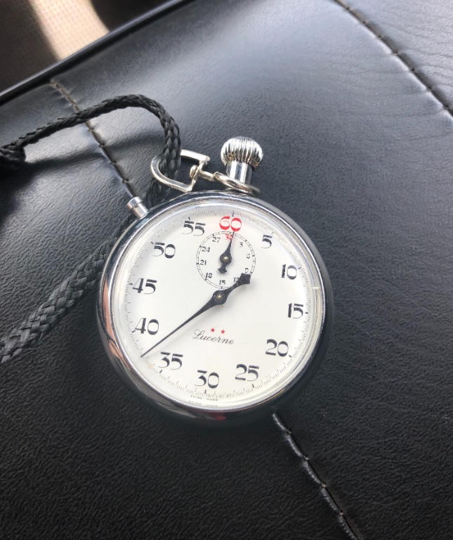

Test today was hot, but got top road speed up to 43-44mph. Time from zero to top speed was 37 seconds.
For the reverse time, it took 5 seconds to back up at a top speed of 6 mph, any more speed and steering control was getting difficult.

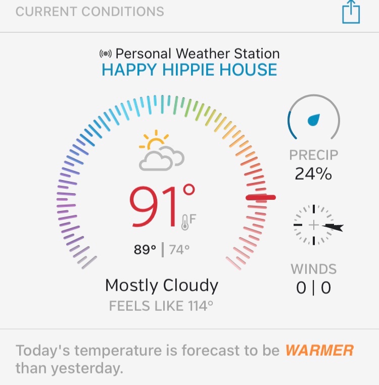

All testing done on flat level pavement. On a hot FL noon day, humidity at 78 percent.
Did several timed runs, all about the same, 43-44mph topped out and took about 37-40 seconds.

Dan, if you're still under Fred's influence, the car might do a little better when the barometer rises.
