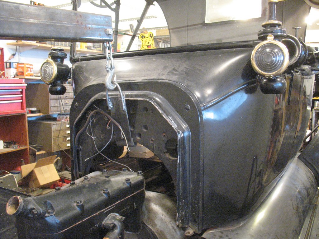

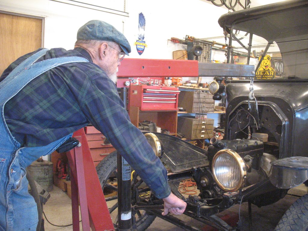

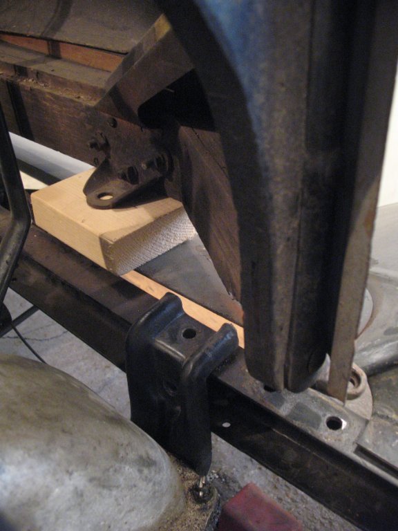

I recently pulled a motor on a 15. Remove steering gear. Loosen the fire wall to body bolts & the hood former slid up & off. Remove firewall bolts & F/W brackets to frame bolts. Lift off the F/W. There was no need to lift the whole body.
- Posts: 7413
Re: Lifting the body from metal frame ?
Unless you car has been altered, it's like my 1915. I've had to pull the engine several times, so I know the routine. The major steps: Remove the coil box, then the radiator support rod and the radiator.* You can leave the headlamps, but now I like to get them out of harm's way. Detach the steering column and pull it back with the steering wheel resting on the seat. Remove the engine mounting bolts fore and aft, and the ball cap bolts. Remove the four bolts holding the firewall brackets to the frame. Remove the four front body-to-frame bolts and loosen the rear two. Raise the front of the body with a lift. I made a lifter that hooks under the firewall. Set the front of the body on a pair of 2 x 4 blocks.

Well just as I tried to post practically the same advice as speedy...it got bummed from his as we must've hit the submit button at the same time! So Rainer...there you have it...two guys did the same thing on idea tidal cars to your 16, without raising the body.

When I reinstall my engine in the 1925, I too am going to make a threaded steel bar, but for the pan mounting. I snapped one of the through bolts on the starter side off, just long enough that I couldn't get the wood block out, so had to pull the hogs head. I am done screwing around with that bolt every time an engine is pulled or installed on starter type engines.

Oh yeah, the dash shield. I forgot to mention that. It's attached to the firewall with three little wood screws. I don't remember the size, but they have to be pretty small to fit the little holes in the shield.

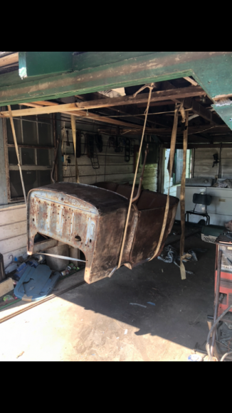

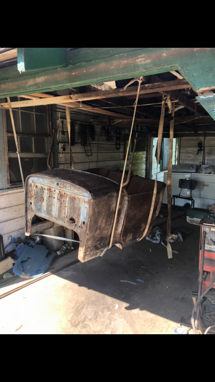

I know this isn’t a T but I use this method for lifting bodies. I’ve used it on my 14 runabout and an Overland Model 91 touring body and this Overland cut off body. I tie one end of strap to a rafter then under the body. I lift the side of the body on the opposite side and have the loose end over the rafter. After I raise it I pull the slack and tie the end to the next rafter. Then I raise the other side of the body. Then back to the other side, raise up, take out the slack and tie again. Repeat until it’s as high as desired.

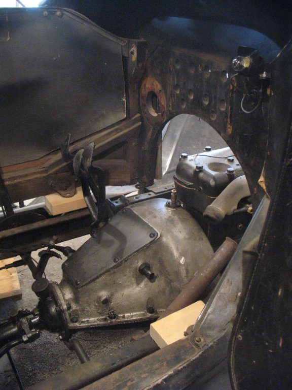

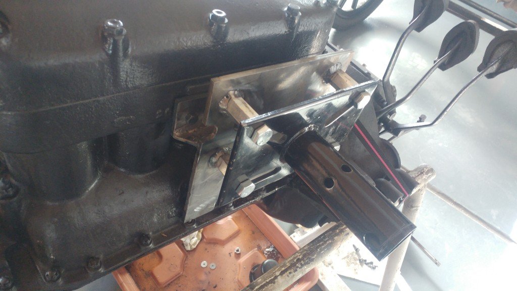

I did it exactly as described, I had to unbolt the "firewall" brackets, lift the upper chassis, ... I immediately found out that removing the coilbox was also needed. I used a long belt looped multiple times through the opening between cylinders 2+3 and lifted the engine there. This allowed me to get the engine into the right angle to lower the pedals sufficiently.
Then I had to build an adapter plate. I made it of 8mm sheet iron with welded-in pins (in distance of 4 oil pan screws). A lot of work, but perfectly now.

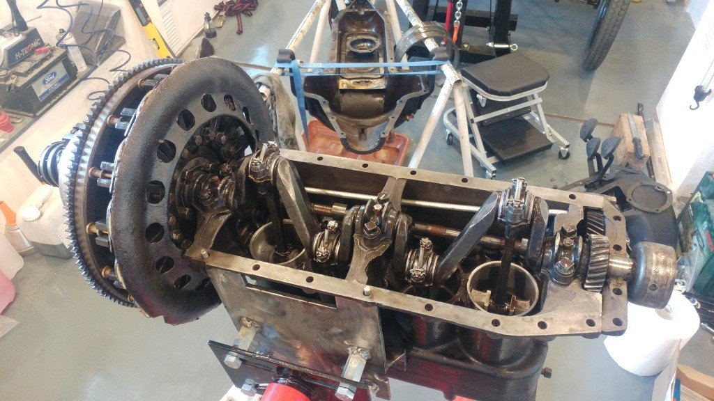

I got out the engine, removed the Hogs-Head and Oil Pan, replaced the entire High Speed Clutch, replaced it by a new one (now original steel clutch), reapplied and checked internal securing wires, ... So the engine is currently still without oil pan, but ready for mounting the oil pan..
I will try to attach a few pictures.
I really wonder what this former owner did. There was a modern clutch inside, with 9 inner clutch disks (something similar to Jack Rabbit). But the clutch assembly was only 25mm instead of 27.5mm (as my steel clutch is), the clutch ring is only 25.5 mm high (including the pins), so in total, the pins slipped out of their holes while the entire clutch was actually unused (still rough friction surfaces), while clutch fingers in addition had 10 mm space(!) on their tips to the sliding ring. Now all measurements are correct and the clutch is operational (so I assume), the pins on clutch ring are almost leveled with the flange's holes when fully spring loaded and the spring is compressed to 50mm length.

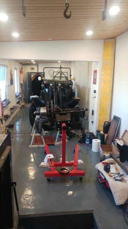

Here a picture of my garage. In the background you see Lizzy, in foreground the disassembled engine. The engine crane is standing in front of Lizzy. It is not the hook visible in foreground.
My self made engine adapter plate. Material 8mm sheet steel.
Here the engine is turned upside down on my motor stand. Just a question of interest. I can see a bolt besides the upper eye of every connection rod. Is the upper eye clamped strong to the stud crossing the piston (does this stud move inside the piston's bore), or is this bolt used for adjusting the radial play of upper eye? Three bolts were secured with a very loose piece of wire. One of them with COPPER wire. One bolt was not secured at all. I re-secured all of them properly without turning them.

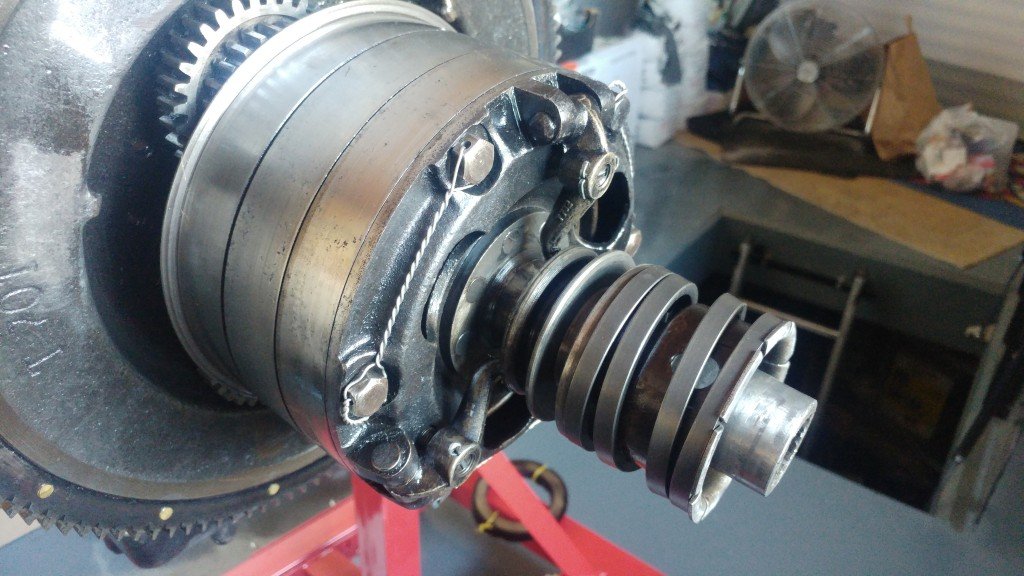

Here the ready-assembled gearbox end (without oil pan and hogshead mounted). Hope the securing wire is done well.

Rainer
good that you mentioned the wrist-pin bolts!
you do NOT want wire through them as it will flop around and eventually fatigue and break. While you can get at them, remove the wire and insert cotter pins through the bolt heads and bend 1 leg of the pin so that it is against the rod...this keeps the bolt from backing out.

Though, your suggestion with cotter pins is definitely lots better, I will follow your advice.
The hole through the bolt head goes everywhere almost parallel to the piston stud (whatever it is correctly named). So I will insert the cotter pin, and bend one end around the bolt head (clockwise) to prevent the pin from rotating, while the other end will be bent in approx. 90 degrees until it touches the rod. Did I understand correctly?
