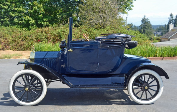

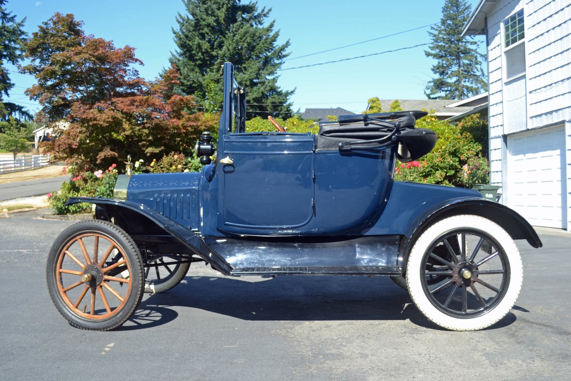

I have also made the outside look better. I polished the brass for the first time in years. I have buffed 4 fenders, both splash aprons and running boards, and the top and rear of the turtledeck. I removed about 30 years worth of oxidation from the black parts and stains in the turtle deck lid where some liquids had been spilled on it. Now instead of looking cloudy and greyish black the black parts are a nice, very shiny black. I also took a brush and touched up some chips in the sides of the fenders.

Included are a couple of pictures before and after buffing.
