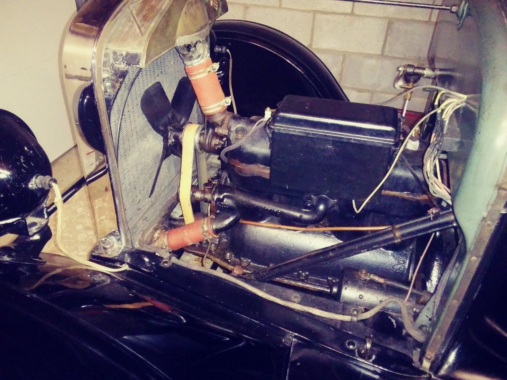

Can someone please post some pics of proper generator/headlight wiring harness routing, from the firewall down the frame beyond the steering column frame attach point , on a '26? Do I need clips?

Anybody have an actual photo of their set up?
I'd like to see along the frame by the steering column.

This is the wire routing on my 27 tudor. 2 clamps on drivers side...wire loom goes up to radiator ...then runs along base of radiator (3 metal tabs on radiator hold wire loom) to right hand side (generator and head lamp)

Mine is routed like your pic now. Might add a clamp to hold it in place.
