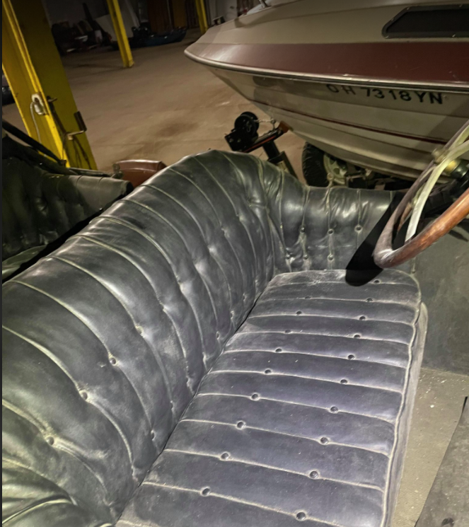

I post the rest of pictures from post viewtopic.php?f=2&t=23791

What is interesting is that the replacement upholstery has double rows of buttons on the cushions and seat backs. The early 1917 Fords that were produced starting in August 1916 had double buttons which was a carry over from the 1916 model year. They eventually went to a single row of buttons some time during the 1917 model year.

Thank you for the 1917 upholstery lesson today Erik. I learned something.
