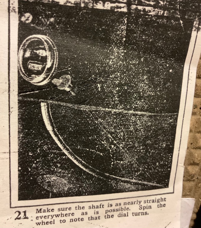

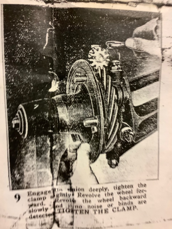

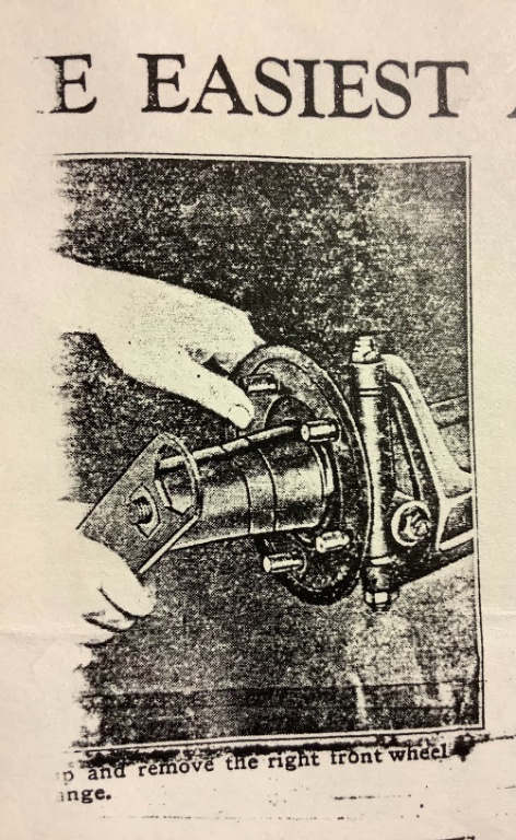

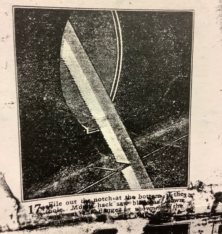

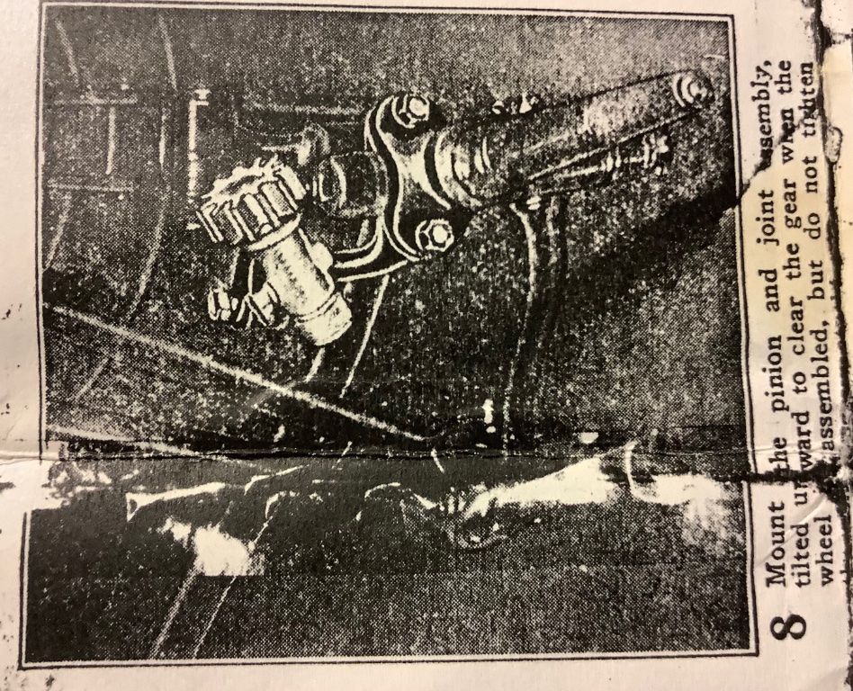

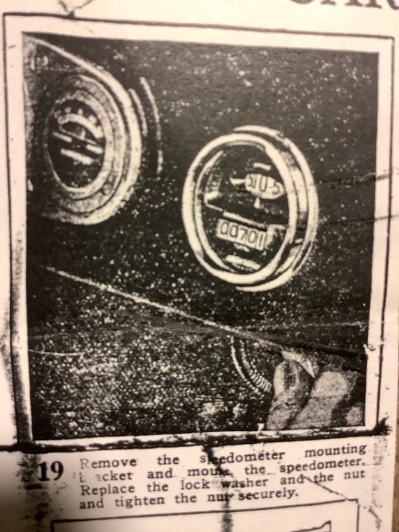

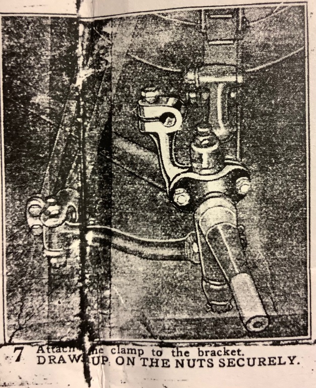

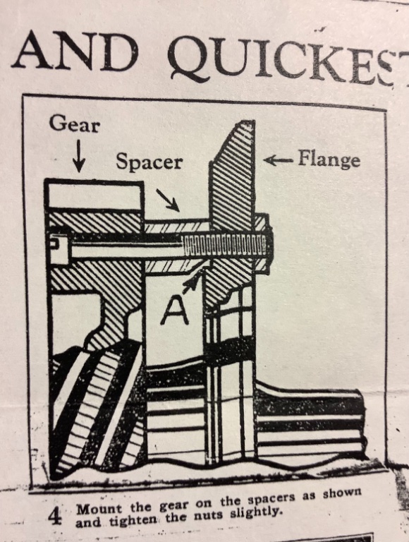

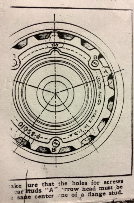

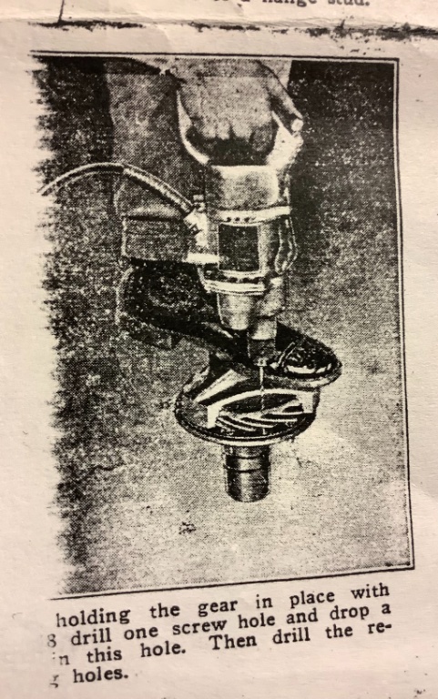

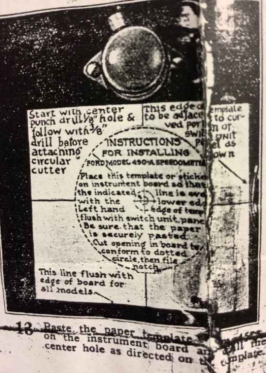

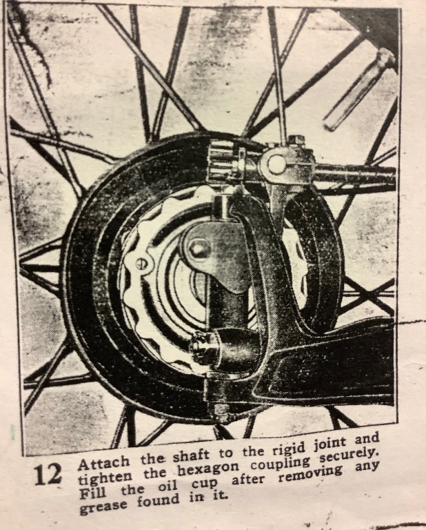

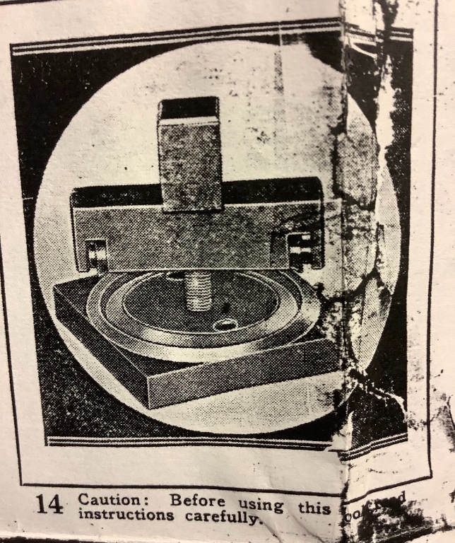

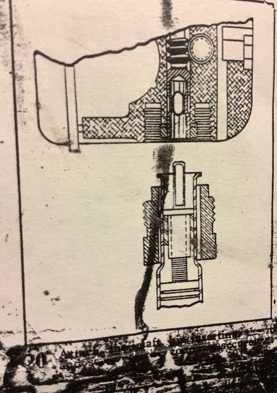

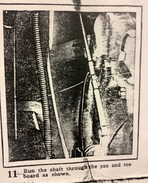

Post by Dropacent » Sun Nov 07, 2021 5:42 pm
Someone mailed this to me years ago, and I cannot remember to give a shout out to. Anyway, a big help if installing one of these neat setups. I didn’t have any luck using the reproduction drive parts, as could never get things to mesh right. After I replaced with real stuff, it was a great running setup. The search is half the fun!
