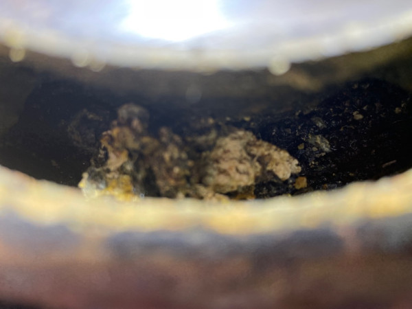

keeping the engine and radiator rust free,
Noticing large flakes of rust in my radiator I drained and flushed my cooling system. Then I refilled it with a mixture of RUST911 concentrate. I left it in for 24 hours, and even drove the car with it in without any problem. When drained the clear concentrate came out black. I repeated the operation and this time it was light grey. After the third application it drained clear. By removing the hoses I could see sparkling clean block and head. The radiator was also rust free. No flakes at all. I chose to refill the system with Waterless coolant. No water = no rust.

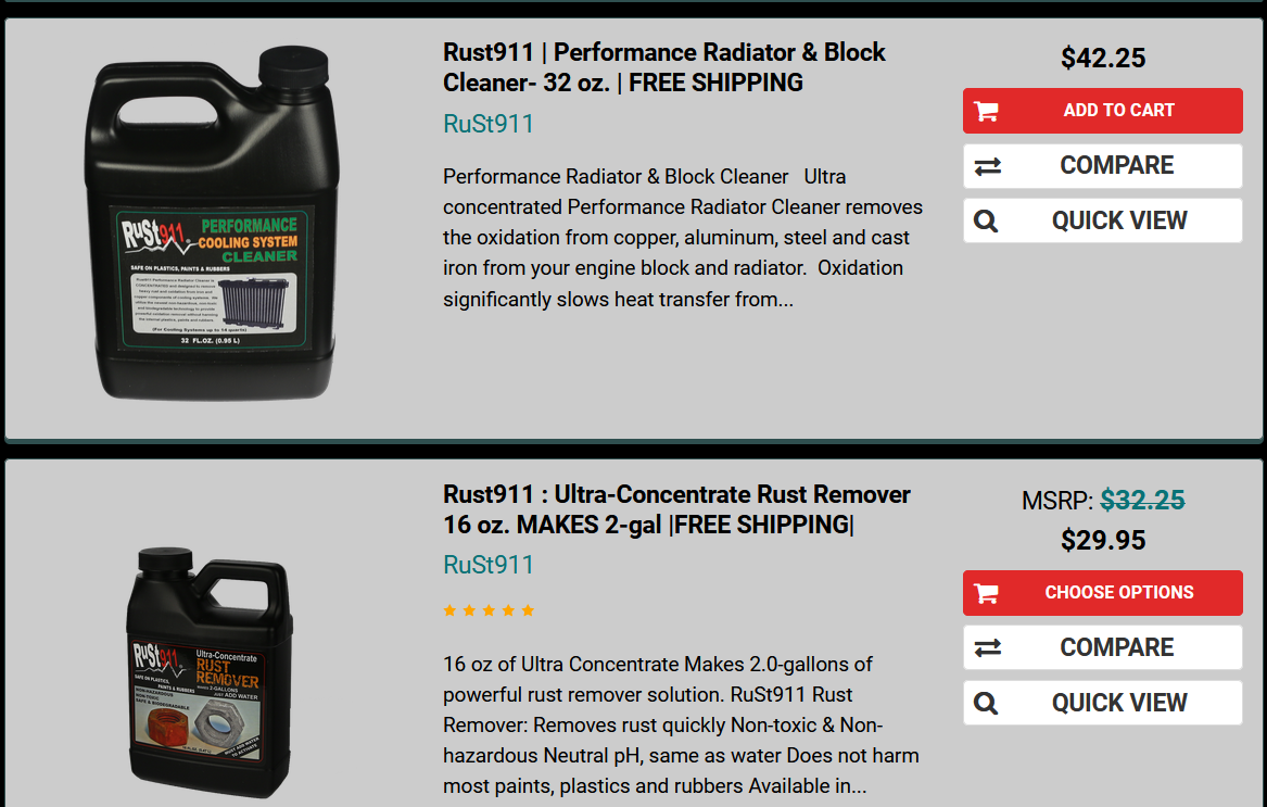

https://www.amazon.com/Rust911-16-gallo ... 0cnVl&th=1
https://www.amazon.com/EVANS-Coolant-EC ... 91865&th=1

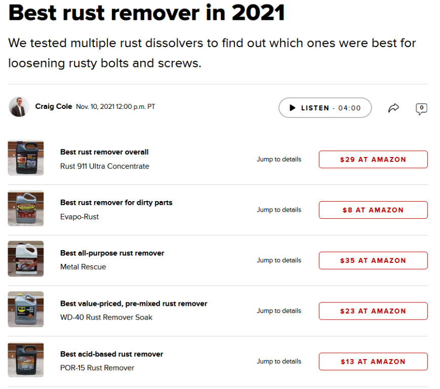

https://www.rust911.com/rust911-home-page/ https://www.cnet.com/roadshow/news/best-rust-remover/

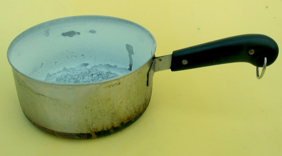

Whatever you use to prevent rust, it's important to use something. The head on my 1915 was so rusted away inside that it developed a leak near the rear, which I patched. Recently it sprang another leak between #3 and #4. I replaced the head, I hope with a better one. In addition to antifreeze to prevent rust, I also use distilled water because the tap water here and in many places has a lot of minerals that form scale.
I heat tap water to make tea in this pan. Notice how bits of mineral scale have broken loose, perfect for clogging radiator tubes.
