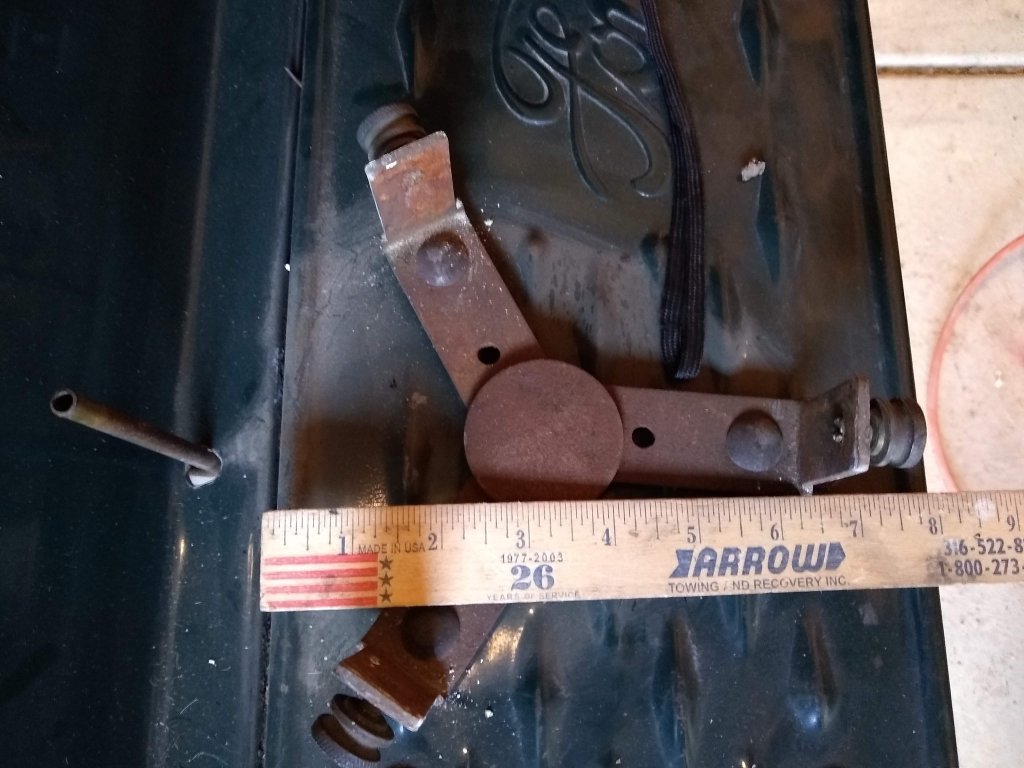

Re: Proper Position of the Gas Generator on 1911 Touring’s Running-Board?
Steve,
Your tank is a bit different than the one on our 11 touring, but here are the dimensions of where the bracket that holds the tank are on the driver's side running board:
