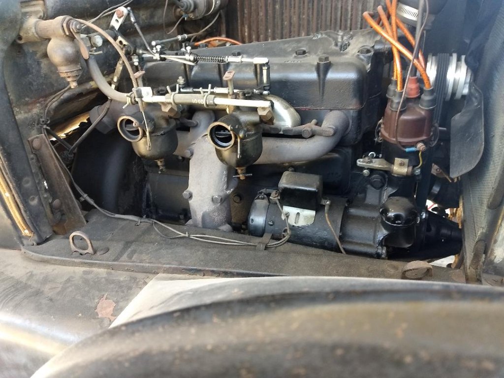

This is the set up for carb and intake I was considering. Reading a little bit the T and A are interchangeable??.
Carburetor/manifolds
Bryant
Topic author - Posts: 1216
- First Name: Bryant
- Last Name: Shafer
So Iam wondering if anyone that has tried a model A carb and manifold set up? I was thinking about this option and wanted to see if there was any draw backs to it. Iam not worried about being a purist so I’d appreciate positive feedback

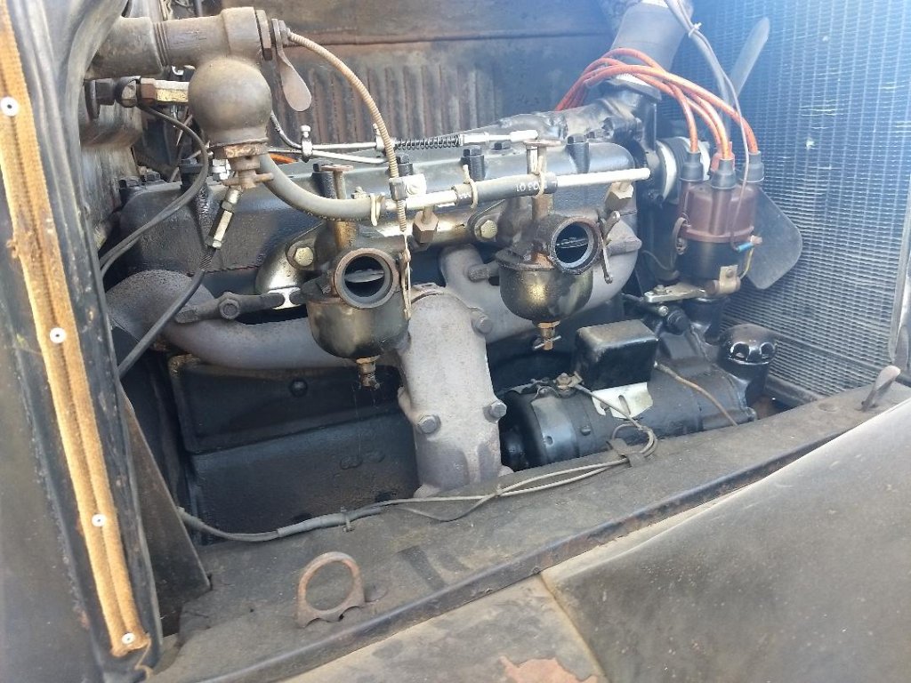

Ideally you add an extension to lower carb to not need a fuel pump. Make it at least 1" lower than a stock carb. (n/a 26-7)Bryant wrote: ↑Wed Nov 24, 2021 2:32 pmSo Iam wondering if anyone that has tried a model A carb and manifold set up? I was thinking about this option and wanted to see if there was any draw backs to it. Iam not worried about being a purist so I’d appreciate positive feedback
This is the set up for carb and intake I was considering. Reading a little bit the T and A are interchangeable??.7239C0A7-D79F-4AF6-9E18-E299B3DA4B19.jpeg
Use an A exh manifold. Can use a C manifold, but A gets the pipe away from everything. No need for header plate. Outer stud holes need to be widened. Its a bolt on. Works very well.

John,I was wondering about exhaust manifolds. C manifold? Firewall clearance issues? The car is a 26 so gravity fuel should be ok?
- Posts: 5246
Re: Carburetor/manifolds
With the A manifold, the pipe comes down & forward a little, then around under crankcase. The whole pipe can be run lower & still not seen. Out of the way with no extra heat. I found an adjustable main jet for that carb. Runs real well. Of course, it was to wake up & work in conjunction with a high compression head, 5/8 valves, & hot cam.
I have the C on a 23 touring. Took a lot or finagling to get the pipe over the HH. I believe the 26-7 floor boards are lower. I wouldnt go that way again.

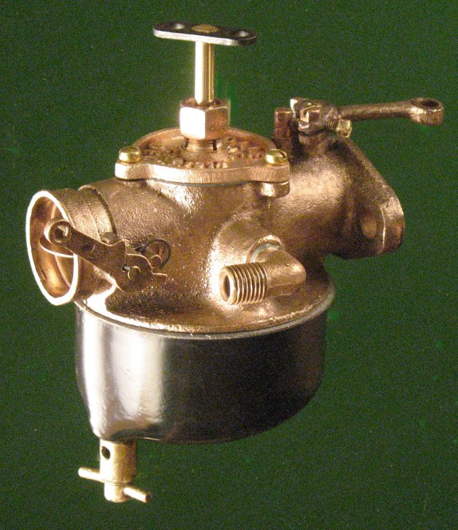

regarding accessory carbs, there are none available with off the shelf parts availability, but there are folks who can manufacture parts as-needed. There are plenty out there that are restored and have been put on the shelf due to the owner seeking "better". "Better" is subjective...as in more power? more speed? more economy? more reliability?
Any of these carbs look great on the car, perform far in excess of any stock carb and are correct for the era...
Since I have neither owned nor run every one of the above carbs, opinions above are partially my experience and other's opinions in whom I trust.
- Miller Master and Winfield are considered the "ultimate" performance carb, but not easy to keep in tune and hard on fuel. Expensive and Rare.
U&J is considered "nearly ultimate" with benefit of being pretty much trouble-free but not particularly easy on fuel. Uncommon and a little rare, not terribly expensive but not cheap either.
Rayfield UF (uncommon but not rare), and Zenith S4BF are considered a hot carb with OK fuel mileage
Stromberg OF gives more power, more speed, more economy than stock carbs and maintains its adjustment. Lots of Stan Howe and other's rebuilds available. Considered best all-round carb by many.

Scott; You pretty much nailed it in your carb performance rating except for missing the Wheeler-Schebler FAX8 which I would rate ahead of the Strombergs and the Stromberg RF that I would put slightly ahead of the OF. With the exception of the first one on your list , I've restored and tried them all and am keeping a U&J and RF for my own two cars although I may be sorry for letting the Rayfield go.. Actually the roadster I have now came with a butchered Model A manifold and carb and although it ran OK, I couldn't wait to get it off and replace it with any of the great period correct carbs you mentioned. To me, a Model A set-up just looks wrong on a T and makes me think that back in the day, if you could afford to modify you T with A parts, you would be better off just buying an A.

I like the period looking ones. The brass is great! I like the model A one. to me it looks fine. Just a little plain and simple. Seems very available. But when the hoods down it’s the model T I like. If you have any pictures of these carbs I would love to see them.

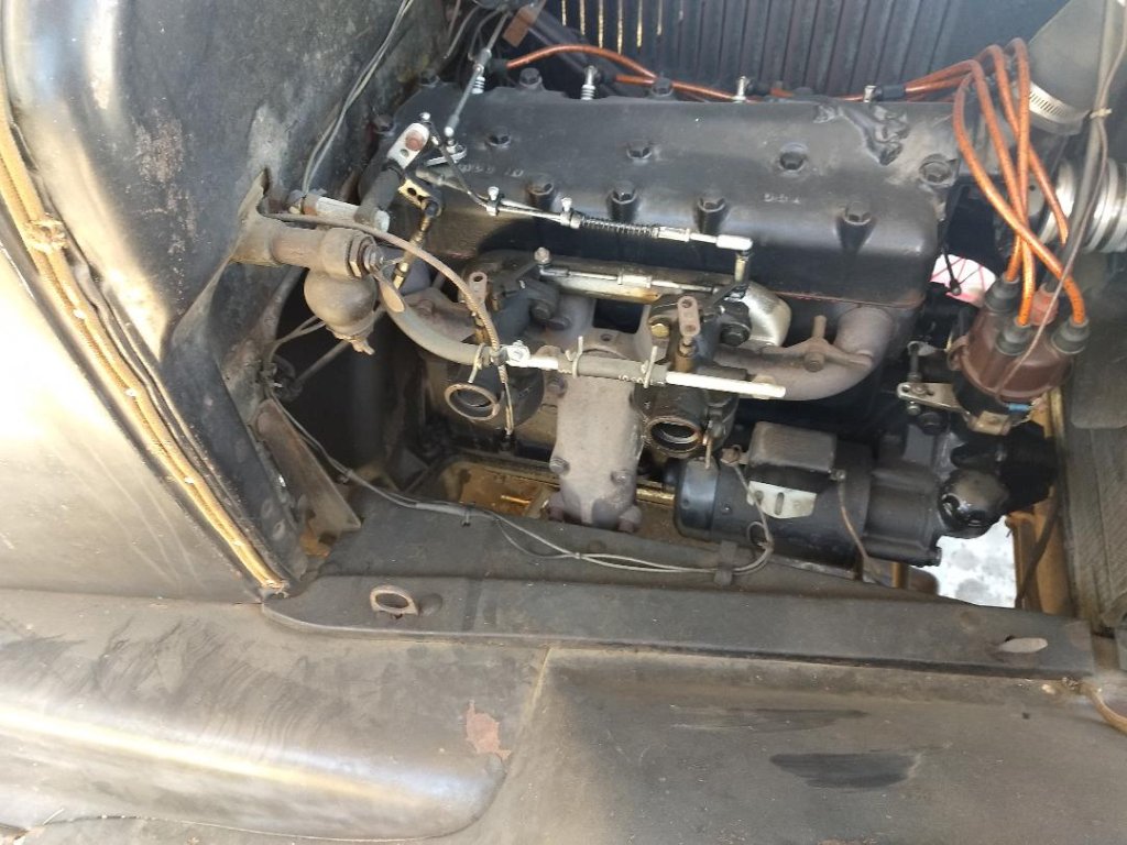

Bryant, many have done this conversion, the best setup I have seen was the B intake and exhaust manifold, the intake is larger for more air flow and the exhaust manifold kicks it out behind the engine like a T does. I would not go through all this unless you have went to larger valves, cam, head or hi comp pistons, the engine will run but to get the flow out you need these upgrades. Hope this helps?

Bryant : The carb/manifold pictured in your original post is a B set-up, not Model A. One of the biggest mistake guys make in looking for a performance improvement is to over-carburate, (an old mechanic buddy of mine used to say "it's like puttin' a 650 CFM Holley on a lawnmower and expecting it to run perfect"). Those that have mentioned bigger valves and cam profiles are on the right track for a modification like this to a T motor, but don't forget that paper-clip crankshaft. As well, you mentioned a Z head but you might want to look close and compare a Prus head, in combustion chamber shape, head gasket surface area as well as machining tolerances. Good luck: Bruce
- Posts: 5246
Agreed. Prus head. I didnt catch the B carb. An A works well.Bruce Compton wrote: ↑Thu Nov 25, 2021 8:46 pmBryant : The carb/manifold pictured in your original post is a B set-up, not Model A. One of the biggest mistake guys make in looking for a performance improvement is to over-carburate, (an old mechanic buddy of mine used to say "it's like puttin' a 650 CFM Holley on a lawnmower and expecting it to run perfect"). Those that have mentioned bigger valves and cam profiles are on the right track for a modification like this to a T motor, but don't forget that paper-clip crankshaft. As well, you mentioned a Z head but you might want to look close and compare a Prus head, in combustion chamber shape, head gasket surface area as well as machining tolerances. Good luck: Bruce
A B/C carb. May be too much. Like I said. An A works on a T & a B/C works well on an A.
You might gain top speed but low end performance may suffer. That would be the over carburation Bruce is warning you of.

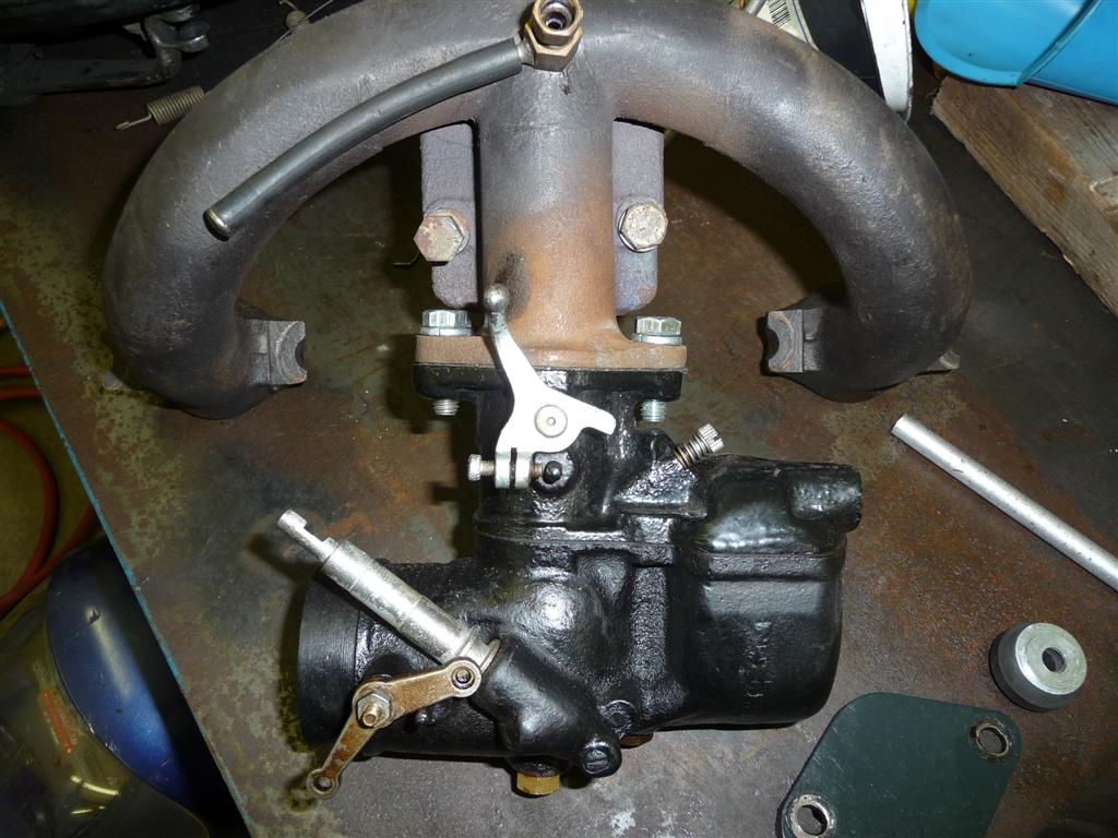

I developed this configuration in my post model A carb experimentation period.
Why hasnt any body.....I wonder if........... It met certain criteria, like period & no fuel pump, simple & cheap to build. IMO, neat looking.
The "package' consists of an iron lizard hi compression head. Capped vaporizer manifold center exhaust out A 2" pipe to a wheeler type can. Intake is built from 2 stock manifolds. 1.5" exhaust & 1.75" intake valves. Scat crank. Stipe 280 cam? 2 NH's with exact fuel levels & synchronized. Hand throttle with an over riding foot throttle to shift the rux. 8V battery.
I wanted speedster performance from a fully loaded roadster P/U. She serves me well.
An important thing I learned on the first test drive was the front end needs to be "tight & right" to enjoy/control the extra horses.

I have several. 2 had spark plug water jacket leaks. All the sharp machining needs to be cleaned up. Nothing special otherwise.John bevardos wrote: ↑Mon Nov 29, 2021 9:56 amJohn,
How did you get the lizzad head to run properly?
I have a couple I want to give a try.
Thank you, John
Be aware, as I became, They were made in many compression ratios. One of mine is near 8-1 (will have to check specs) Good Idea to CC if you dont know.

speedytinc I love that manifold & carb setup. I have tried many setups on my speedster. I find a adjustable large carb to be very good if mated with a good exhaust. But takes some tinkering while driving. My number one concern is getting equal flow to #2 & 3 as 1 & 4.Thus making two cylinders run richer than the other two. This seems to limit performance gains as the manifold flow is one direction then the other. Most all four cylinder engines are now firing 1-3-4-2 or 1-4-3-2 to even out the manifold flow and balance the air fuel charge in the cylinders. ( this is one of the reasons Ed Windfields 2 up 2 down engine ran so well ) Short of making a cam to change this or reversing the flow ( 4 INTAKES & 2 EXHAUST ) Has anyone tried making a manifold to improve this issue? Large plenum or directed flow.? Will 2 carbs help with this? ( it still seems you will get a on off flow) Just some random thoughts.
Craig.
Craig.

O yea. I have 2 3' rods to tune the 2 carbs while testing different speeds/conditions. The 2 carbs are manifold equalized. I suspect 1 & 2 or 3 & 4 can be richened/leaned for some effect. Plugs show same burn on all cylinders.

No. 2 stock manifolds cut up. The updraft, curved leg portion cut off & the edge (1/2 round) used as a filler on top as pictured. All brazed together.Bryant wrote: ↑Mon Dec 06, 2021 9:27 amDo you have any pictures of your intake build?speedytinc wrote: ↑Mon Nov 29, 2021 11:00 pmTinkering while driving.O yea. I have 2 3' rods to tune the 2 carbs while testing different speeds/conditions. The 2 carbs are manifold equalized. I suspect 1 & 2 or 3 & 4 can be richened/leaned for some effect. Plugs show same burn on all cylinders.
