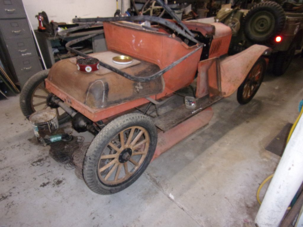

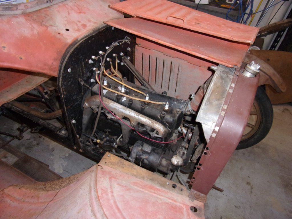

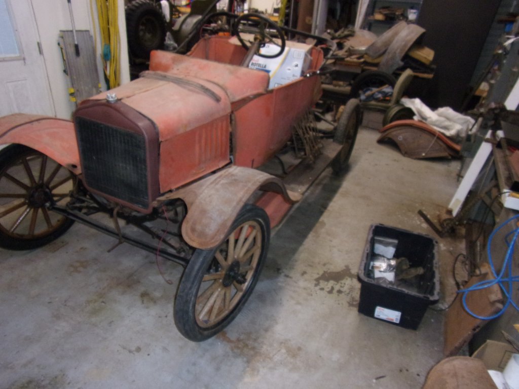

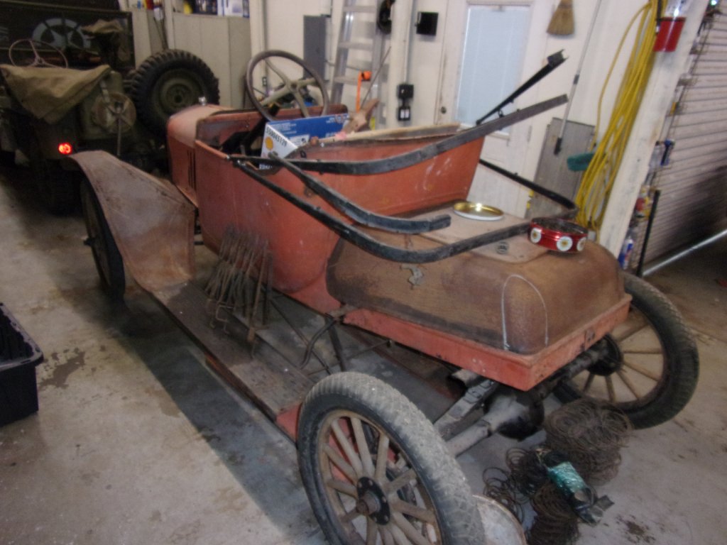

Re: Any issues mounting 26/27 roadster body on 20 frame?
This is what I have to work with. Engine runs great and trans works well. It's all sheet metal and upholstery from here...
The whole car looks like things line up pretty good, so, put on the splash aprons and consider a wood pickup bed instead of a turtledeck, paint it and enjoy what you have. I painted mine with a brush and a small short haired roller, or have it painted. Most onlookers haven’t the foggiest idea what you have, if it is the right conglomerate of parts or even the year. It is your baby and do what you want with it, as long as you enjoy it and the wife is happy.
Looks good to me. Your first description I thought you only had the chassis. I think you can restore what you have and add a few missing parts, if you don't have them stashed away. Even if it is not exactly correct, it would be more correct than using the earlier chassis and running gear with a newer body which does not fit. And if you have already bought the later body, can probably sell it to make up for the additional parts you need to purchase.
That body doesn't look bad in the pictures. Hoods other parts are available new in sheet metal.
Robert I have still a few 1926/27 nice frames left. I am up on the west side of Chattanooga. But it sure does not not look like a 26/27 roadster from the photos.
Hank, I may just have to come up and see you one day and discuss what I got and what you got. It is NOT a 26/27 roadster that I have. It is a 1920 frame and motor. I believe the body parts to be around 1920 as well. It's all the little things that I don't have and don't know I do'tt have them like seat frame, riser, top bows, etc. There is a turtle deck, but I do not think it is correct for the frame/body I have. I may just throw all these loose parts in my pick up and drive up and stock up. I've done a 1915 light express, but I built most of the body out of wood. I've got a Depot Hack in the shop, again, wood. It's the bit of tin and bit of board and upholstery that is causing me concern.
Another thing about a 26-27. They have a unique gas tank which is hard to find a good one. The y haven't been reproducing them for those years, however New ones have been available from the vendors for the round and oval tanks. If not, they are much easier to build than the 26-27. Your other parts look correct and the seat springs and seat back is available from vendors as well as wood kits unless you are good at wood working, you could make your own. Most important thing about the earlier bodies is to have good wood, because the sheet metal is tacked onto the wood frame and good wood cut and fitted correctly supports everything.
