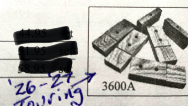

Does anyone have a diagram or dimensions for the blocks?
The last paragraph of the link you posted for install instructions and the diagrams states all the dimensions for the blocks. Or buy a set from the vendors.
Really no tricks needed, easy to place once you lift the body. Some are fastened in place the larger use just the body to frame bolts. Advantage of the wood blocks is they are also used to hold the wood screws with fender washers to lock the splash shields in place to prevent sheet metal rattles too.

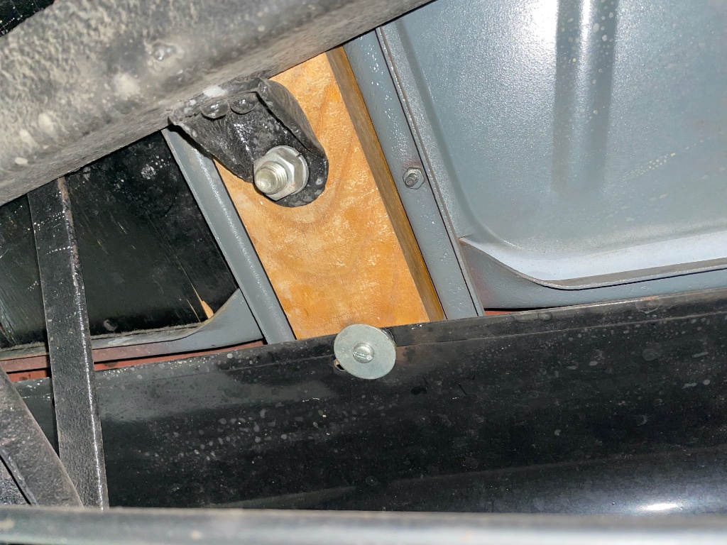

You are correct, the Touring wood block set is the A and B in that sketch. Here is photo from Lang's catalog, (cat. # 3600A) used a similar set of these pre- made pieces on my touring, but don't remember the supplier as my parts were rather plain blocks without the reduced section on thickness. Believe the reason for that end is to clear rivets on the main channel? But don't recall as I did this work in 2003!
Main body blocks, these fit into the main cross channels of the touring subframe. Rough dimensions 1 1/4" thick, 2 7/8" wide and 7 1/2" length.
Note the screw for holding the rattles of the splash shield, place that into the wood block.

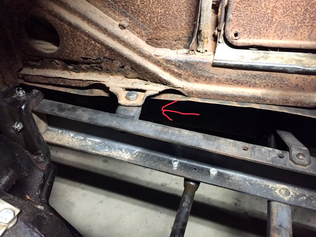

1. Should there be any spacer where the front bolt connects (see red arrow):

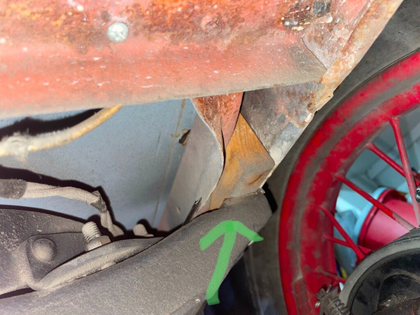

2. Back to my original question. Are spacers used in addition to blocks. It seems like you have one here (indicated by green arrow):
3. I need to measure my washer stacks, but some reason it looks like my frame is much different than original. I might just make custom blocks based on what is working. But I am trying to figure out if I am missing something.

1) The front connections do not use a spacer.
2) The wood blocks are used to mount the body without any additional spacers.
If you have a bent frame, or a crooked body, you may not get things to line up. If you need to use additional spacers one or both of those problems may exist.
