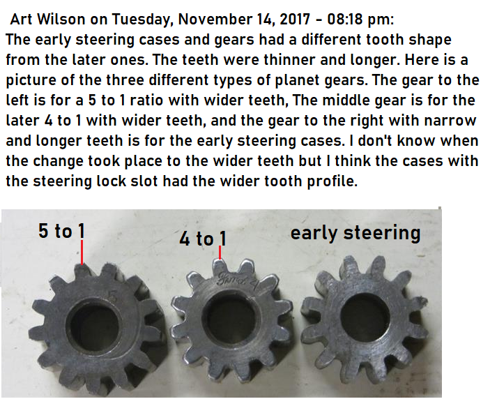

Also be sure you have the correct parts. Older Ts had 4:1 steering and the 26-27 had 5:1 steering gears. The parts look about the same and can be mixed up, with bad results.

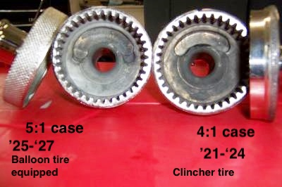

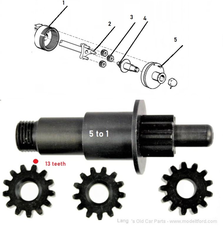

This sounds a bit contradictory "Everything is new and tight .... standard gears will not eliminate the slop". Thought it might be easier if we had a talk sheet to work from. You can use the numbers too for clarity in your answer.greenacres36 wrote: ↑Sun Dec 19, 2021 11:05 amEverything is new and tight but it appears that the teeth in the box itself has enough wear that standard gears will not eliminate the slop.
so
What is new & tight?
How many teeth on the gears and do they look like the 5 to 1?
Where is the slop?

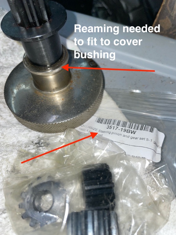

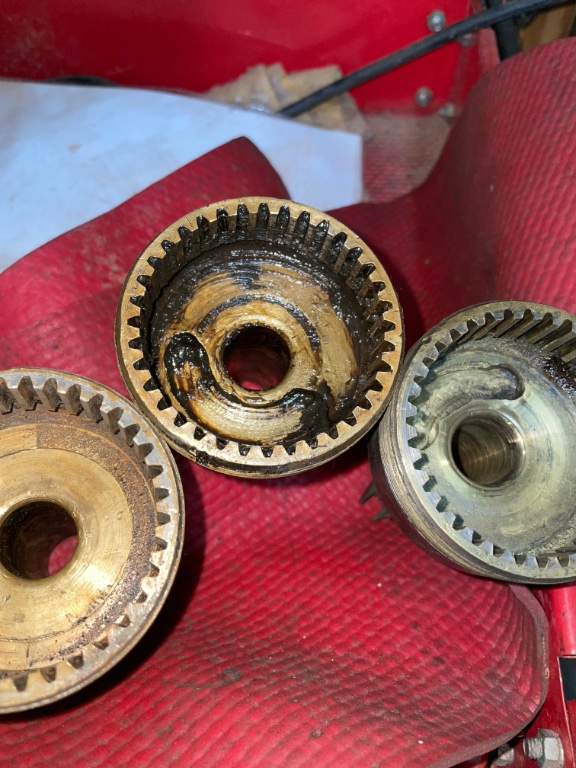

Sometimes odd to find the steering case brass teeth to be too worn, with sharp tooth form, does happen. So if yours is that worn the only fix to to replace that steering case. Two styles, the later after about 1921 have the groove for the long pin shaft on one of the triple gears, to provide the over lock turn of the earlier cases. The cases shown are very usable, esp. with new gears.

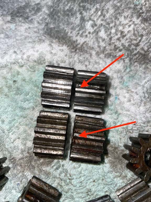

Those triple gears most times have the wear, as they spin within the fixed in place gear case, you can mike those and know if they are toast.
The new gears are real nice, but the gears themselves are stock dimension, but since heat treated they fit real snug in your typical worn steering case. Most all times with new pin installed, you have to lap the new gears to get the proper fit, for easy turning of the wheel and no slop.
Only an 'oversize' pinion shaft is avail, it comes with the new gears of stock size. You have to ream the case cover to fit that new pinion, and that will really make your steering case and gears work almost like NOS! Lots of time the looseness of that steering pinion that holds the steering wheel is what can cause the wobble feeling of control as you turn the steering wheel.

Thank you so much Dan! That was exactly the information that I needed. I’m just going to go ahead and put in new gears and I’m sure I need to go with an oversize shaft. I work in the machine shop so I’ll just take it in and bore the cover to fit the new shaft.
