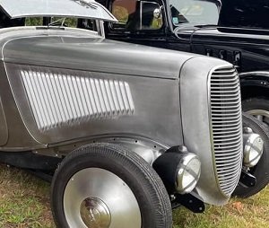

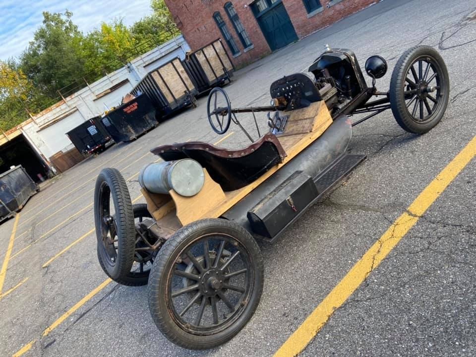

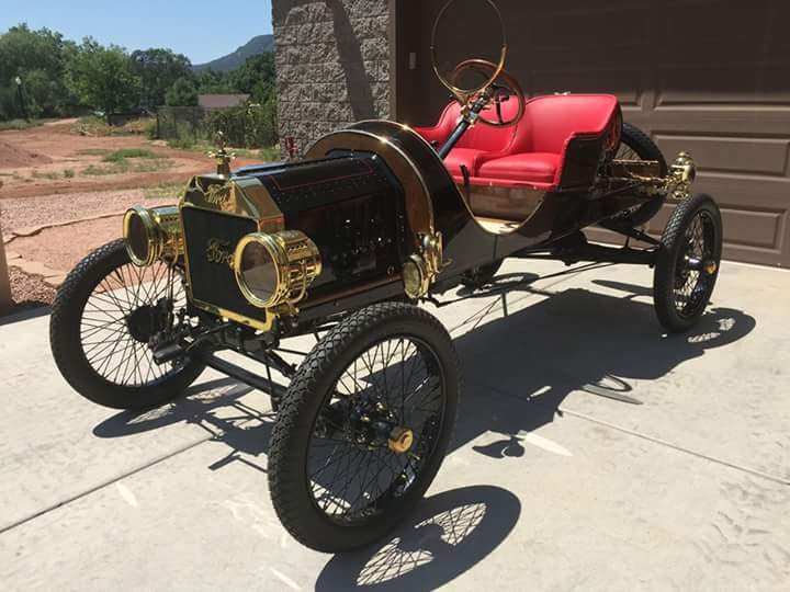

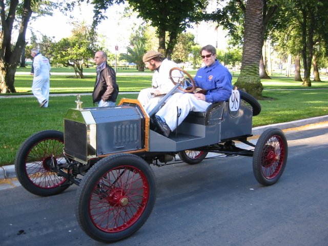

Anyone have detail plans for the type/style of speedster pictured below, scale plans would be great, floor looks to be most of it. I would make seat riser to fit me. Anyway, any help would be great, middle/top ones (steering column/seat height) is more along the lines I would like to build.
Posts: 5543
Last Name: Gregush
Location: Portland Or
Re: Speedster plans wanted
Post by Mark Gregush » Wed Dec 22, 2021 2:07 am
Go down to Dan's post and work from there; http://www.mtfca.com/discus/messages/80 ... 1251942872
Someone might have a set, but most just build their own, as were the 2 samples you show. Most every one is different.

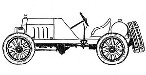

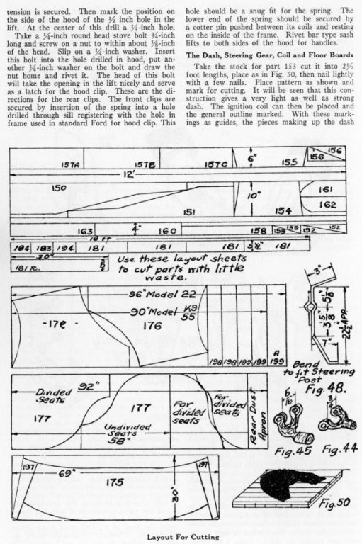

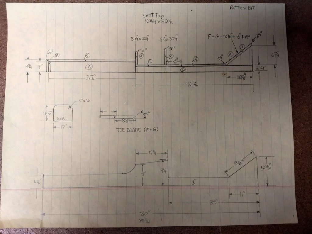

Here you go

All that's missing is the width which is 32" Firewall height depends on which radiator you use .

On the diagram I presume the side view at bottom is 3/4" ply, is the inner also 3/4" (pieces A-B-H-J and K) and again presume it produces
a lip/shelf for floor/deck to sit on, do you have lateral stringers? I also do not see signs of carriage bolts for attachment to frame, the black car is very nice work by the way.

All wood is 3/4 .

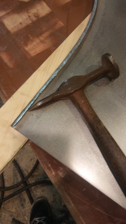

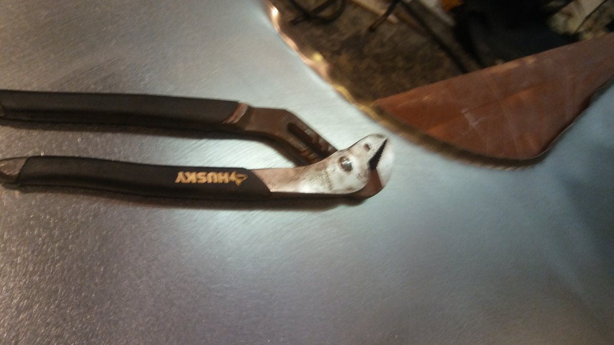

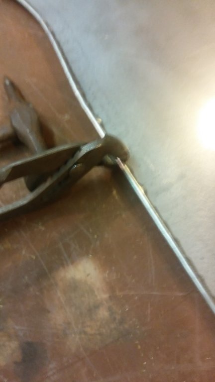

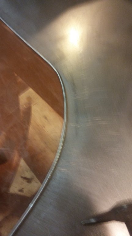

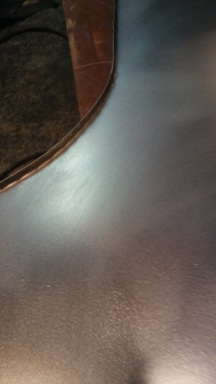

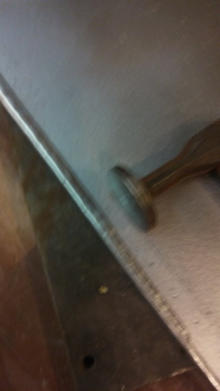

Saw this on Facebook I use channel locks to bend metal up and trap the wire in. I scribe a 7/16 line on the metal and use tension wire for fences from home Depot.
https://m.facebook.com/story.php?story_ ... =827407807

How do you attach brass trim? On some speedsters I see screws, but is there a method so no screws show for a nice smooth look?

Isstead of the wire I use 7/16 thin wall brass tube and mill a small slot and solder it on. Fit it first then solder it on. Pain in the butt but looks great

Use half inch conduit tubing that is sliced lengthwise and slip cut tube over the straight metal edge and tack weld the tube on. Much faster and cleaner than tapping out a wire edge with a hammer.

If you invest in a “bead roller”, the wire edging becomes pretty darn easy!

I have a bead roller need 3 people to help. I can do it all in 1 1/2 hours .by myself . I'll sell my bead roller .

If you tilt your seat back like shown in Tom's diagram, you will be more comfortable on long drives. Having a seat perpendicular to the floor is not conducive to comfort.

Yep it sucks on a long ride the riser for the seat and buckets are slanted back as well

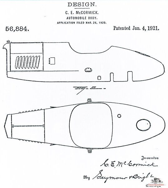

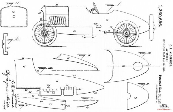

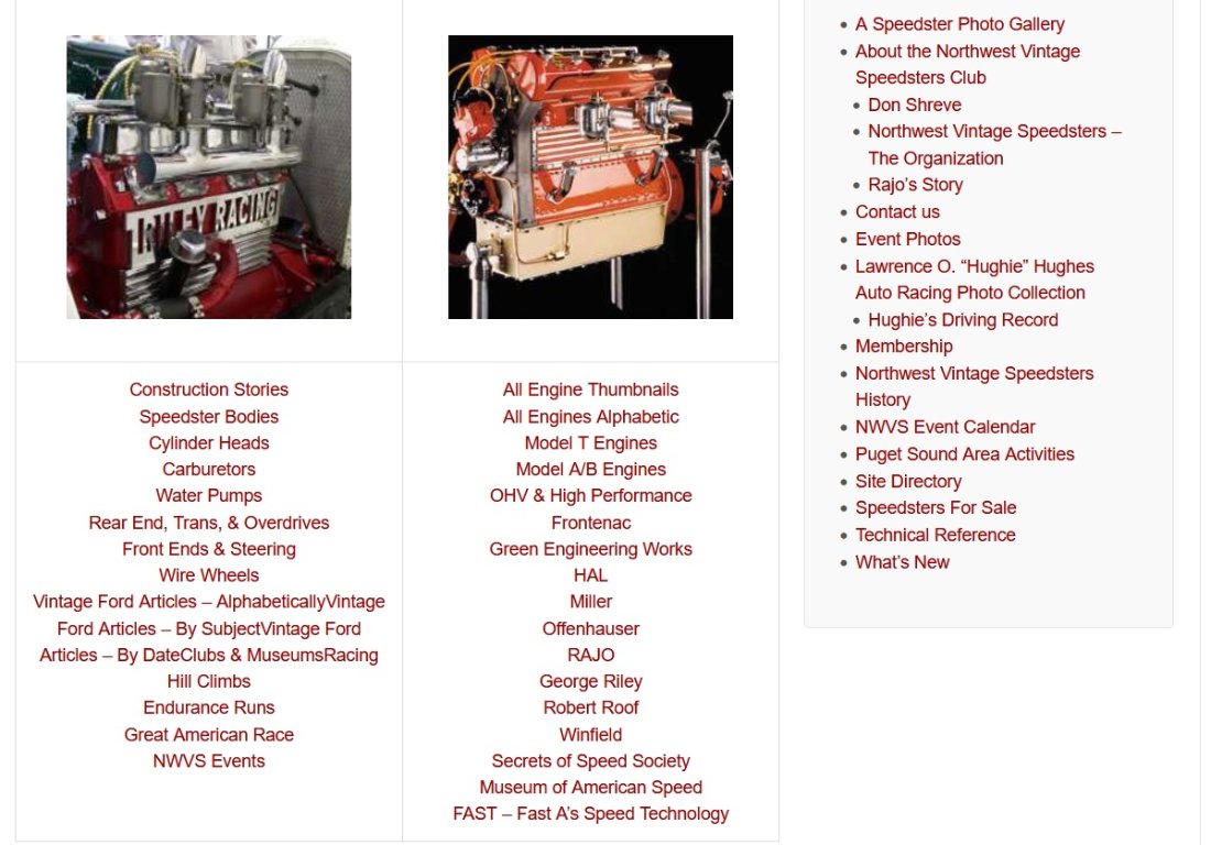

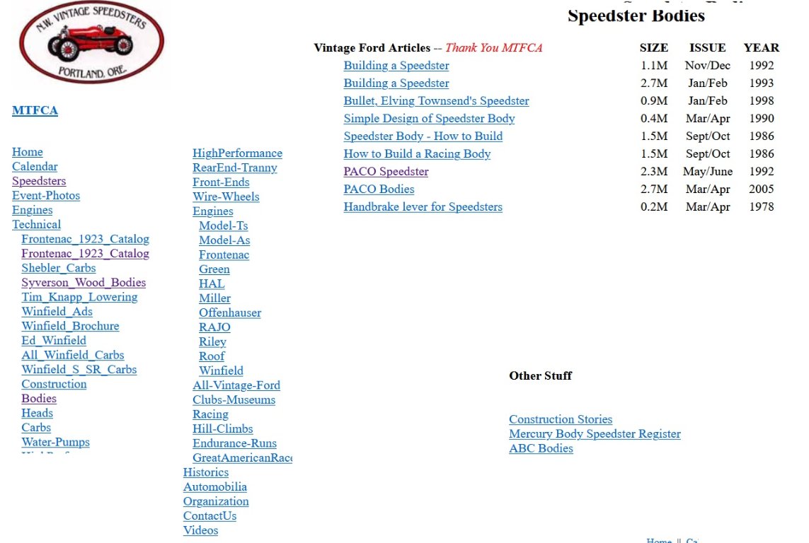

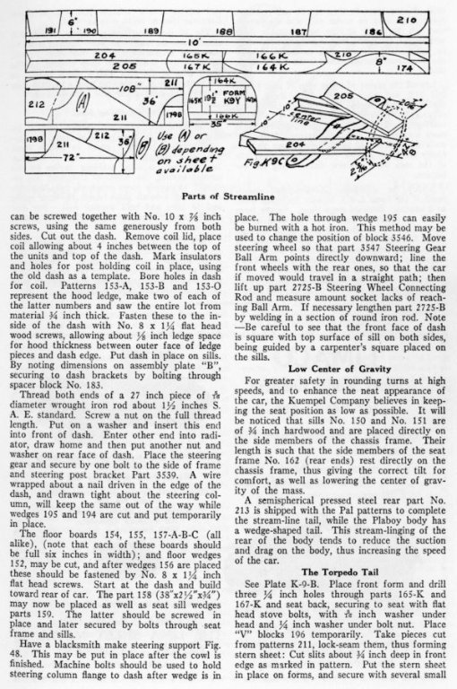

The Mercury Speedster Plans
Posts: 6579
Post by TRDxB2 » Fri Dec 31, 2021 1:39 am

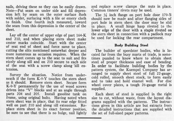

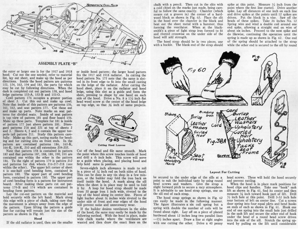

Secrets of Speed plan
Posts: 6579
Post by TRDxB2 » Fri Dec 31, 2021 1:54 am

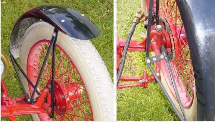

How to build cycle fenders details in the link https://mtfctulsa.com/Tech/speedster_fenders.htm
This a PDF of that link
How to build Cycle Fenders.pdf
(537.69 KiB) Downloaded 170 times

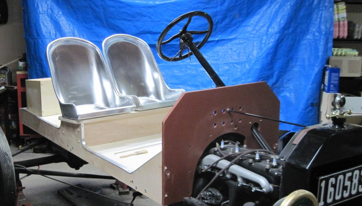

Post by Caswell » Thu Jan 13, 2022 2:51 pm
Model T Tom wrote:
Wed Dec 22, 2021 6:10 am
Here you go

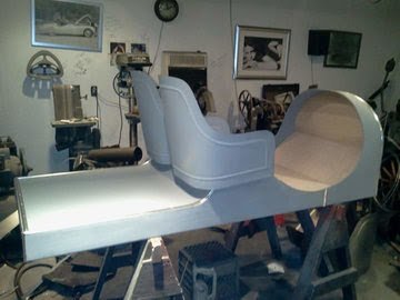

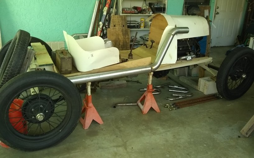

A big Thank You to Tom, what you shared in the diagram you posted gave me a big head start, I needed to modify it a little but the info was invaluable.
Now if I can find a set of paper/card patterns for a boat tail I'll be in tall cotton.

Post by Dan McEachern » Thu Jan 13, 2022 3:50 pm
Looks like you are pretty far along on the base, but consider dropping the seat platform all the way down to the floor level. Your seats are going to be pretty far up in the air as it is now.

Post by Caswell » Thu Jan 13, 2022 3:59 pm
I'm too old to sit on the floor ;) I'm not sure it's any higher than the first two pictured above or the black car.
Edit, change picture with seat shells on.

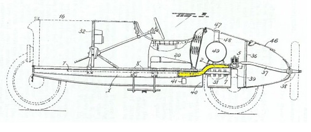

Looking to build a long-nosed speedster like this one. Anyone have diagrams for the floorboards, risers etc. Also, measurements to cut firewall for shape. Prefer to use boards rather than plywood. My friend will make the hood around what I build but have no idea who made this speedster. I like the shape and lines of this hood.
Mine is a 1916. Plan to move the lever outboard of the frame, use buckets on angled riser low on the floor and no sideboard as in this one. Thanks for any suggestions.

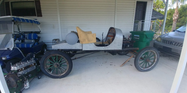

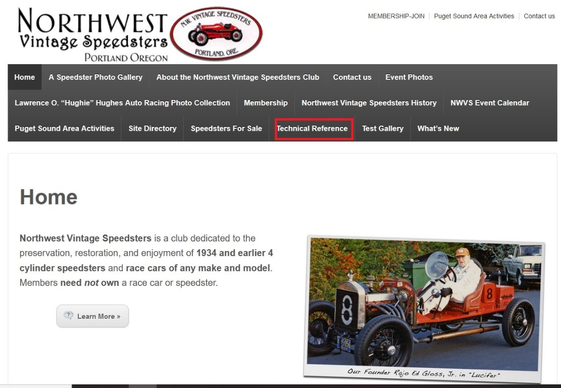

While your reviewing this discussion one of the members has a speedster, partially built, like what your're looking for for sale. He is a well known speedster builder. The parts and their condition of what he has assembled for his build would take you at least 2 years to obtain. AND yo would need to ravel to several of the most known swap meets in the country to possible find them. The hub caps aren't made anymore, they're priceless. It is located in Florida
https://mtfca.com/phpBB3/viewtopic.php? ... 88#p263846
Model T Tom provided the plains used to build it in this discussion

This is a basic sketch of what I am going for. Obviously, it's not to scale.

This one is pretty straightforward. Rusty Berg's Chevy headed speedster at Piquette a couple years ago.
