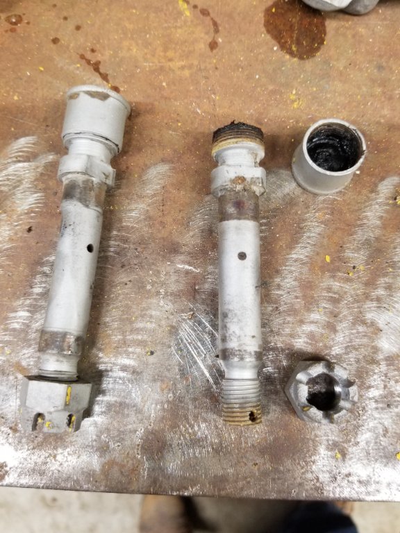

Can anybody tell me if the bolt with the grease cup HB-FT listed in Langs is the same for Twin and Single Hassler front shocks? Mine measures 3" long as stated in the catalog. I am restoring a set of Twin Hasslers for the front of my TT.
Thanks Dallas

This is what I have. Hard to tell from catalog if they are the same. These have flats in the head of bolt on grease cup end. I would like to braze these up and turn to proper size. Just looking for a backup plan.

The same bolt work's on both single or twin Hasslers
The 3" bolt is for the front and the 3-1/2" is for the rear

Thanks Bill! That is the answer I was hoping for.
