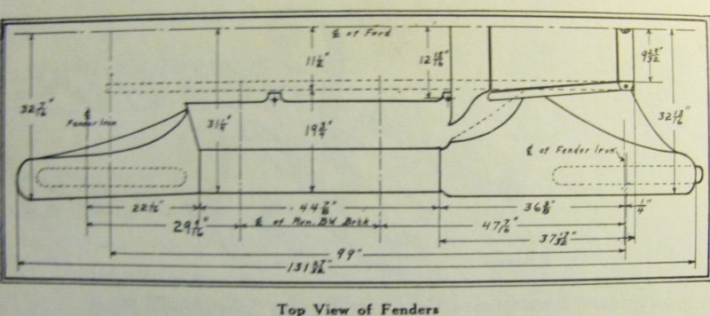

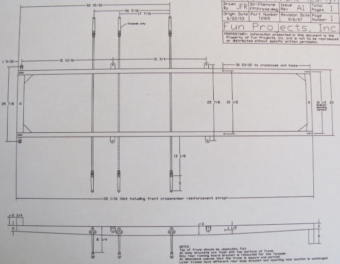

Easy way is cold bend, just bend a bit more in the direction, as the steel will want to rebound to the prior shape.
What really matters is the height of the brackets from level surface or frame top, and the Center Line (CL) of the bracket ends, so that the running boards fit flush to these brackets at each hole.
Of course, a frame out of whack and twisted will affect the running board brackets and the running boards fit.
Earlier frame, but spacing of the brackets is the same.
Approx '22 fender and bracket positions.
This sketch, out of focus some, but shows distance from CL of fender brackets too to the CL of each end of the running board brackets.
